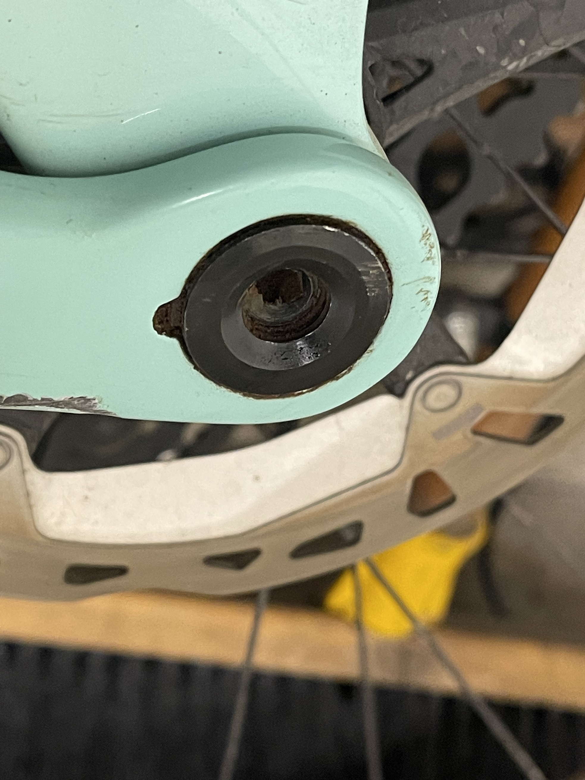

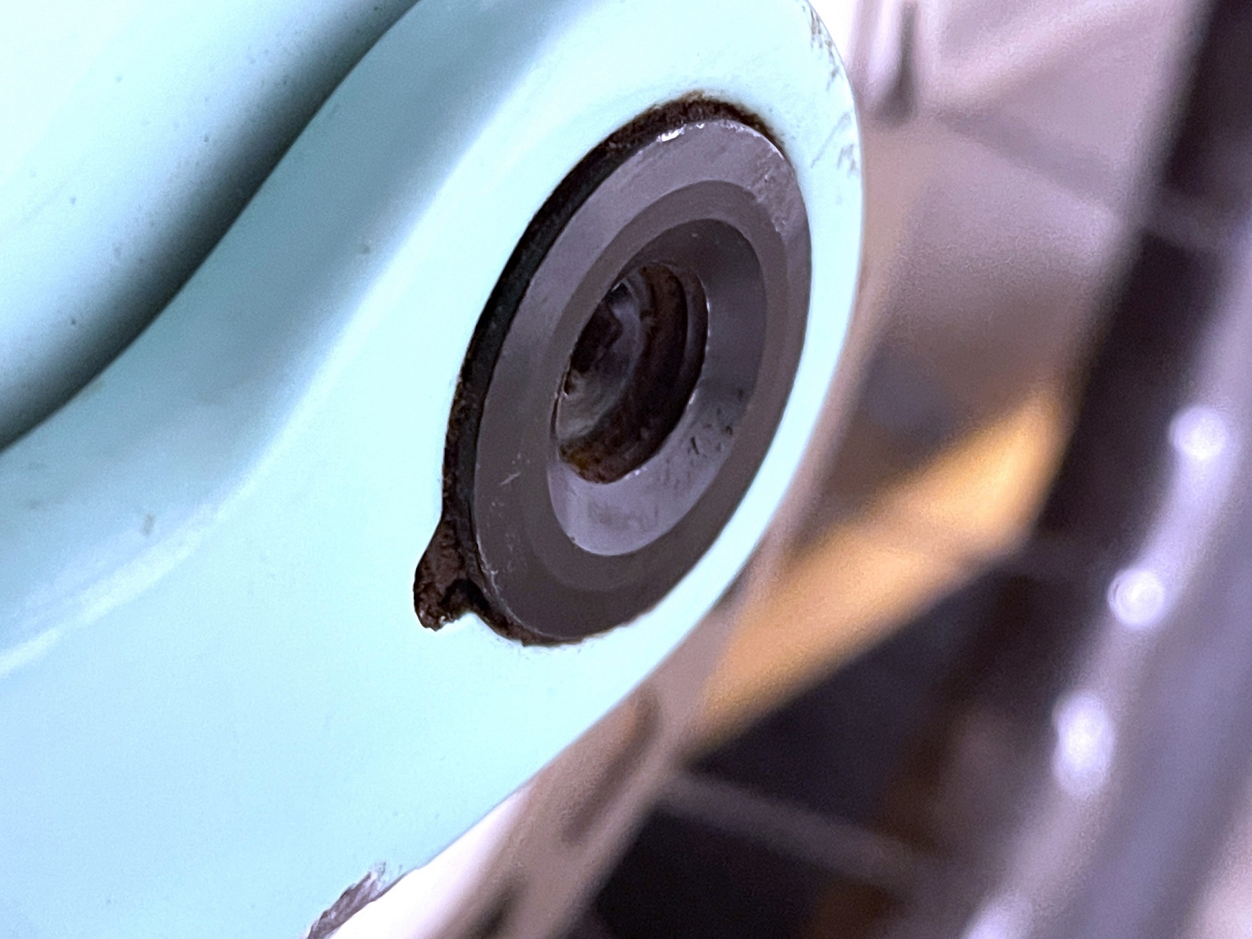

Thanks, Rod. Really appreciate all the knowledge you're putting on here.
Can you please share a photo of how flush (or not) is this left-side nut on your bike? I'm pretty sure the indentation is seated correctly on mine, so I would not be surprised if this small gap I see is how it is supposed to be. Would be great to cross-check with another bike.

N16BS,

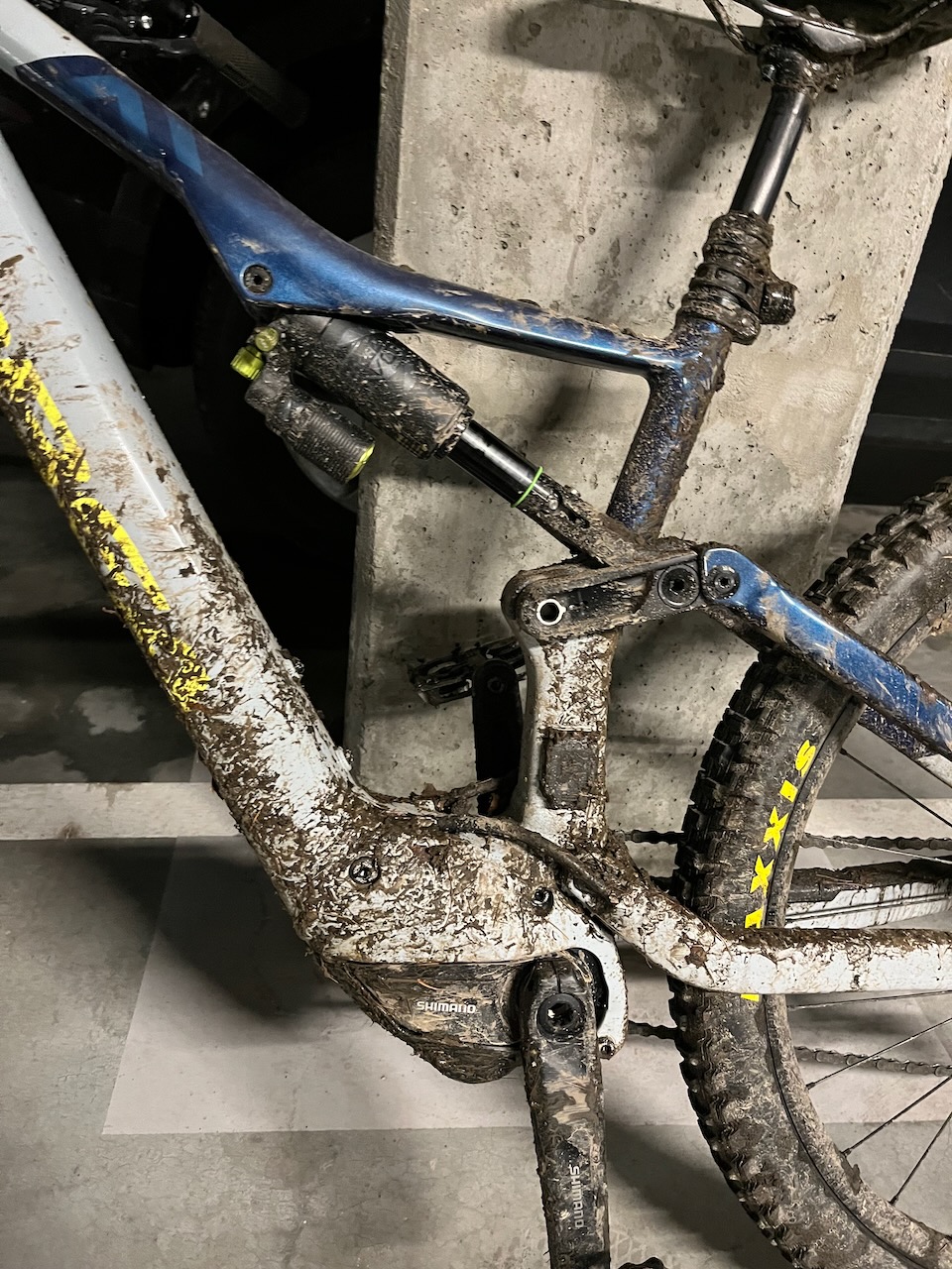

I'm sorry about the delay in sending you the requested pictures. My brother now has my Rise and he was away for the weekend. Here are the pictures you requested.
My brother likes to wash his bike once a year, whether it needs it or not....I feel like a parent seeing their child being abused...
