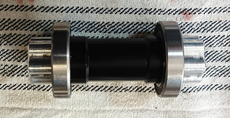

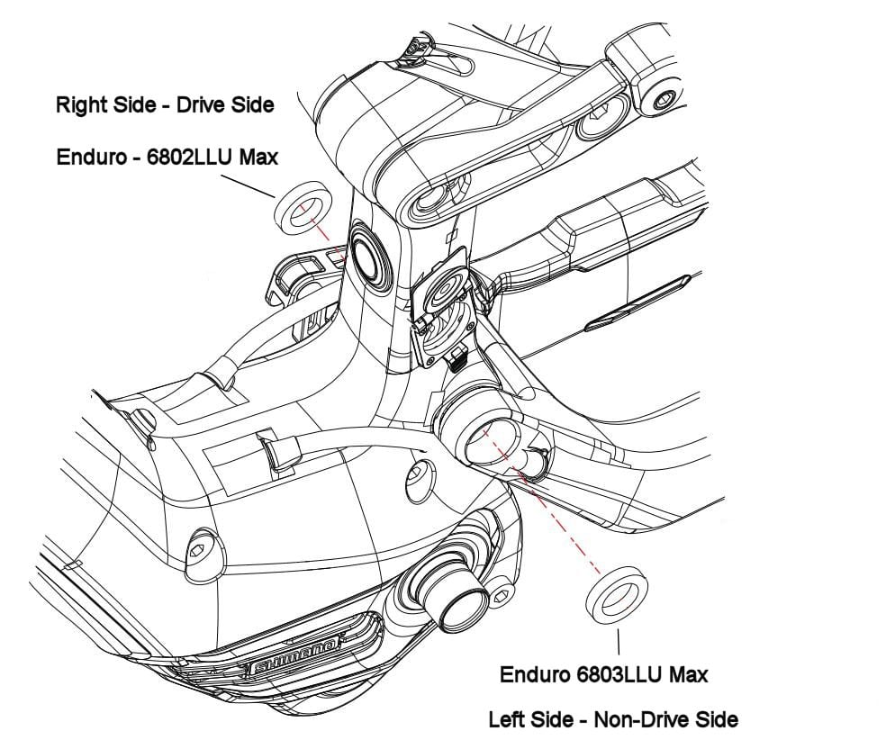

The Lower Main Pivot Assembly:
The lower main pivot axle bearing assembly consists of two Enduro bearings which are housed in the main frame. The two bearings differ in size. The left, non-drive side of the frame, uses is an Enduro 6803LLU Max BOSL (Black Oxide Coating) bearing. The right, drive side of the frame, uses an Enduro 6802LLU Max BOSL bearing.
Note: "LLU" refers to the seal design used on the bearing, which is a "Dual Lip" and "Full Contact" seal. This is one of the better designs at keeping contaminants out of the bearing. "Max" refers to the absence of an inner bearing retainer and allows room for the "Maximum" amount of bearings to be installed in the bearing. Refer to Part One in my series for further explanation on "LLU" and "Max" terminology.

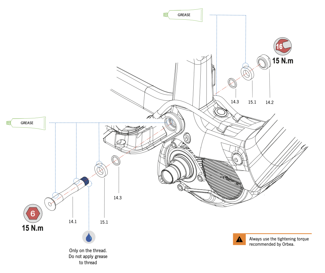

How the lower main pivot axle functions:

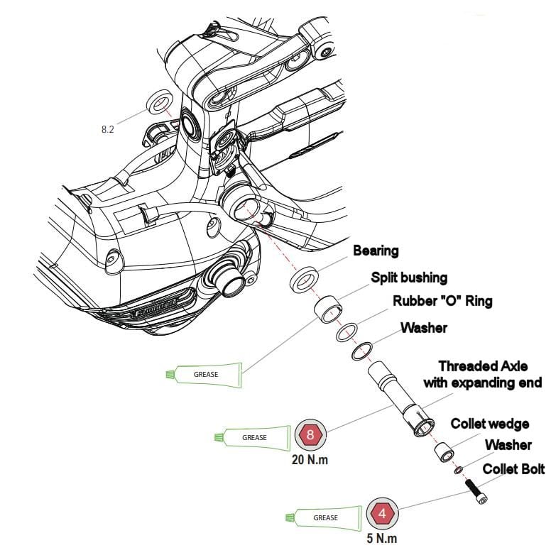

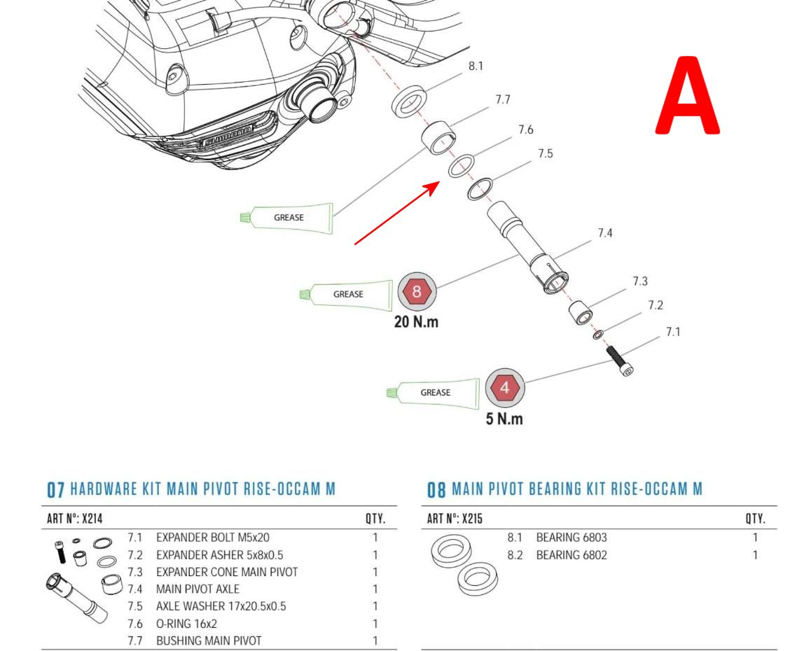

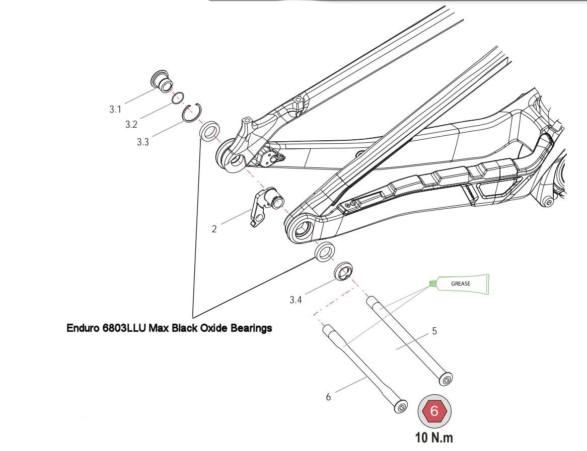

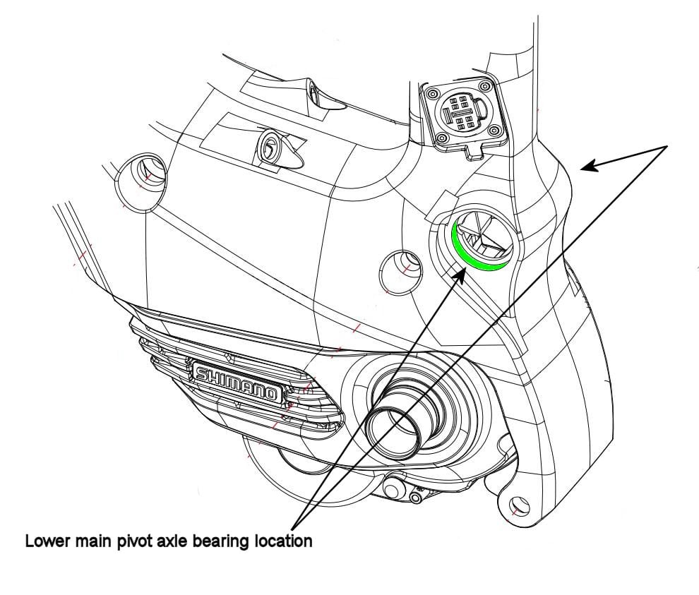

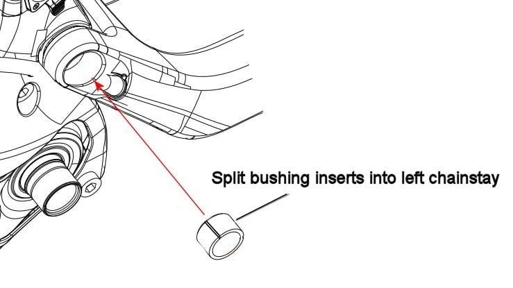

The Orbea Rise, Blue Paper diagram below details the lower pivot axle assembly and grease points. Also listed are the proper torque settings.
How it all works:
A split bronze bushing is inserted into the opening located on the left, "non-drive" chain stay. The lower pivot axle is threaded on one end and machined on the inside to accept an 8mm hex wrench. The axle is inserted through the bushing, the left chain stay, through the two frame pivot bearings and threaded into the right, drive side chain stay. A 8mm hex driver is used to tighten the axle to the correct torque setting.
The axle is prevented from backing out due to the split bushing and collet wedge. After the axle has been threaded into the chain stay, the collet wedge and collet wedge bolt are threaded into the end of the axle. As the collet wedge is tightened, it expands the head of the axle outward, which in turn expands the split bushing and locks the axle in place. Some mad engineering going on here.....

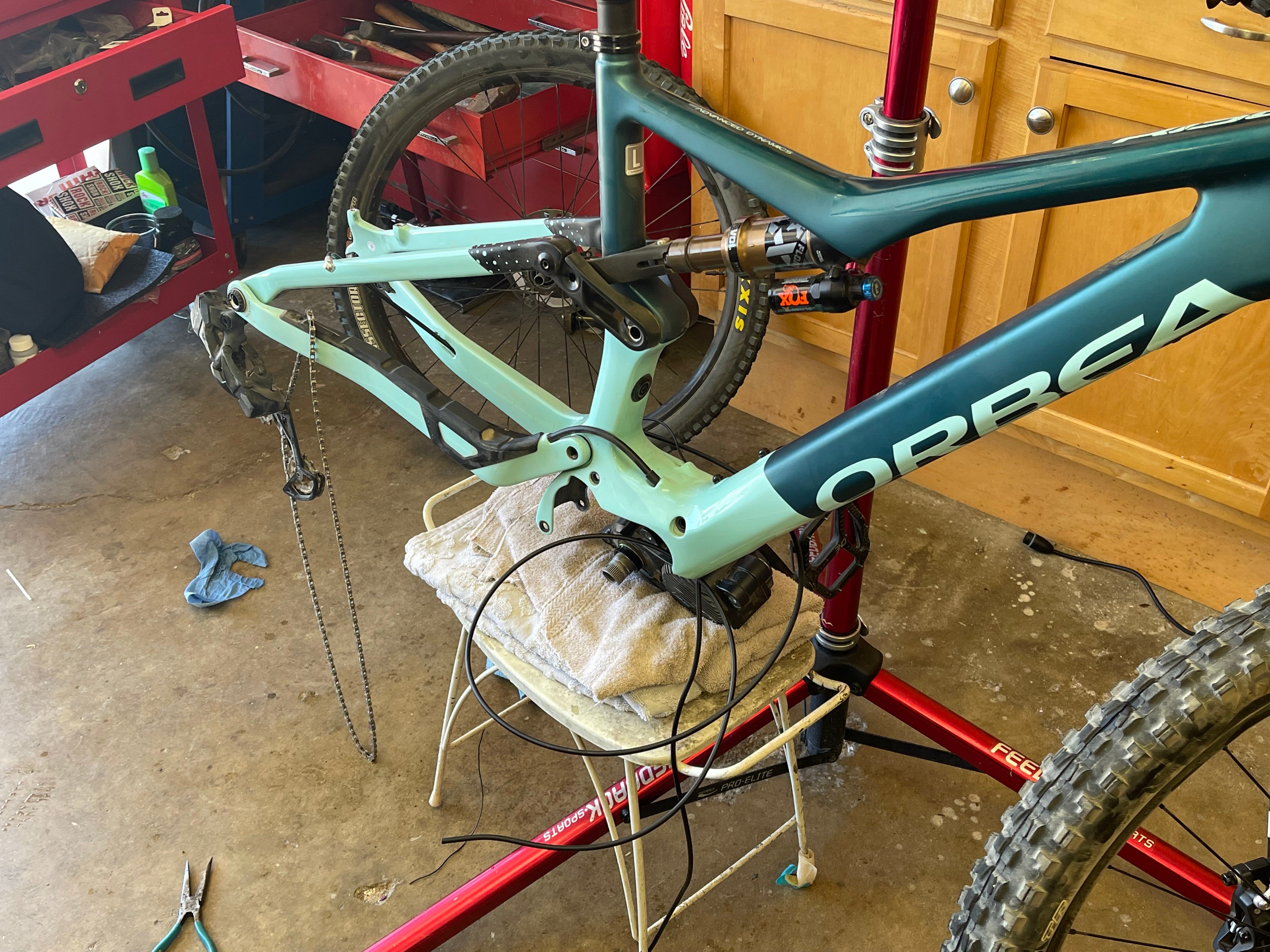

2. Wrap a rag around the front of the rear shock to cushion it. Remove the from shock mounting bolt. Lower the front of the shock until it rests on the downtube.
3. Using a hex driver, remove the collet bolt from the lower pivot axle. Remove the collet wedge from the axle.

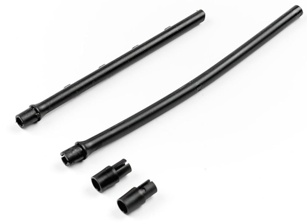

4. On the left, non-drive side of the motor a black rubber routing tube which will hinder removal of the axle. The routing tube is used to route the rear brake hose from above the motor to the rear triangle. Clipped to the bottom of the routing tube is the small speed sensor wire coming from the rear triangle speed sensor to the motor.
Right and left routing tubes
In order to remove the axle, the left side routing tube will need to be folded slightly out of the way. Don't go crazy with the folding, you don't want to damage the brake hose. You want to fold it over just enough to be able to remove the axle.
The speed sensor wire is attached to the routing tube and held in place via small press fit rubber clamps molded into the bottom of the routing tube. Unclip the speed sensor wire from the clamps. Push excess brake hose from the rear caliper towards the routing tube in order to add slack in the brake hose at the routing tube. Pull up on the routing tube and out of it's mounting holes in the frame. Fold the routing tube slightly over and out of the way. Unthread the axle and remove it.
5. After removing the axle, you will see a split bushing located on the left (Non-Drive) side of the swing arm where the axle is inserted into the triangle. Remove the bushing.
6. With the axle removed, you can now lower or raise the rear triangle out of the way enough to inspect the lower pivot bearings. If the bearings spin easily and smoothly, you need only wipe the surface of the bearings to remove dirt and grime and place a small dab of grease on the inner part of the bearing where the axle will contact it.
If the bearings are rough or hard to spin, remove the rubber seal and clean the bearings. If after cleaning the bearings they still spin roughly or are hard to spin, you should replace the bearing(s). If the bearings spin freely after cleaning, repack the bearings with grease and reinstall the rubber seal with the correct side facing the ball bearings. Wipe excess grease from the bearing and bike frame using a towel.
5. Clean the lower pivot axle, all hardware, the triangle where the axle is threaded and where the bushing is inserted.

Rear Seat Stay Bearings:
Two Enduro 6803LLU Max, black oxide pivot bearings are located at the end of the chain and seat stay triangle. The pivot bearings facilitate a slight pivot movement between the chain and seat stays at the rear triangle. They do not see a lot of movement, but are important in maintaining rear triangle stability.

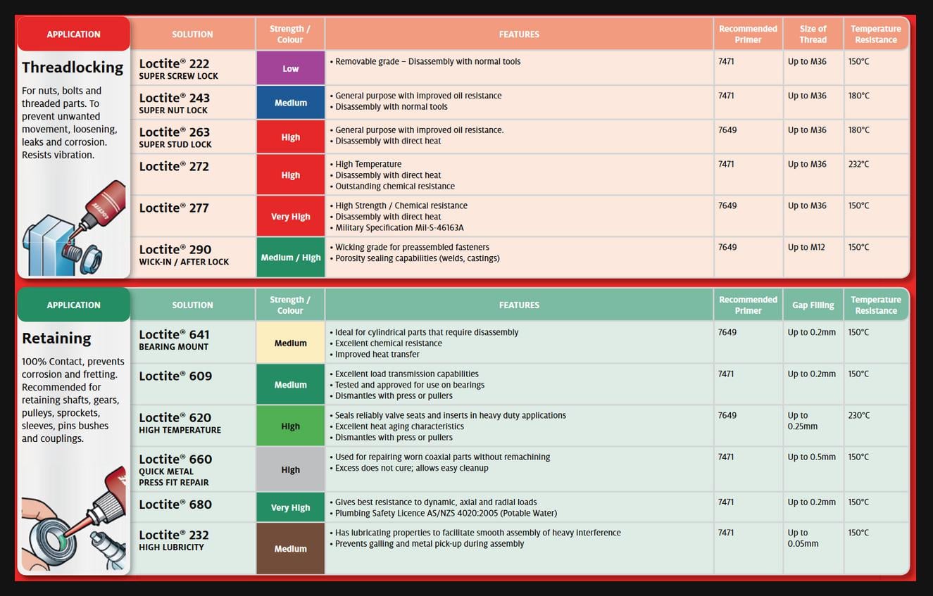

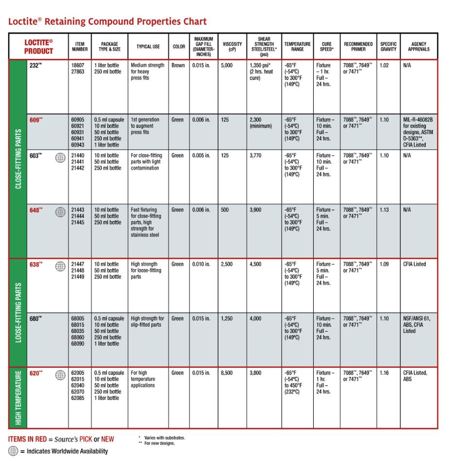

Is this for the new 2023 Rise or the older 2020 to 2022 version? I ask this because the new 2023 Rise has a new upper linkage design and I am not familiar with it yet. If your Rise is a brand new 2020 to 2022 Rise model, then I would apply a cylindrical retaining compound such as Loctite 638 to the upper axle splines.
My thought behind this is that if you push your new Rise fairly hard, the upper linkage will slowly begin to open up. This in turn will cause wear to the splines on your upper axle. Fix it before any axle wear can begin.
I want to be clear here...Use only a drop or so of the Loctite 638 and spread it around the splines with your fingertip. It doesn't take much, go very light with the stuff. If you go heavy with the stuff (Which I did on my first go around), you'll have to really work hard at getting the arms back off.
The issue of the linkage arms opening up is not something that happens immediately. It took about two months worth of rides for it to happen on my Rise. Once the linkage arms opened up, then the creaking would began. Each time this happened, I would clean the suspension, re-grease everything, set pre-load and it would be pure, quiet time bliss for a month or so. Then it would begin again. As time progressed, the linkage arms opening up would happen within a shorter time span between each suspension service and pre-load reset. This was because the splines on the right side of the upper pivot axle and the splined inlet on the right side linkage arm, were wearing more and more with each opening up, removal and pre-load reset.
I like to give credit where credit is due. I believe it was Rich who pointed out to me about the use of a cylindrical retaining compound on the upper axle. Prior to this, I was greasing the splines on the upper axle to prevent wear (Don't do this). Once I used the Loctite 638, I never had another issue with the linkage arms opening up.
When I refer to "Opening Up", I am referring to the linkage arms shifting/loosening on the upper axle. Orbea specifies a very specific pre-load adjustment width which is obtained using the pre-load tool provided with the bike. When the linkage arm(s) loosen and shift on the axle, this causes the pre-load to open up, i.e. the width between the linkage arms becomes wider and this introduces play/slop into the rear triangle.
It's been my experience that the right, drive side linkage arm will be the one to loosen up. The left non-drive side linkage arm has never loosened up on my Rise. I believe this is because the majority of wear occurs with the splined inlet on the right linkage arm and the ride side axle splines. I've always made it a practice to never separate the left linkage arm from the axle. There's no reason to separate the two items. To do so causes needless wear to the splines. The right side linkage arm however, is removed during servicing and it's the arm which has to be shifted back and forth on the axle splines during pre-load setting. All of this causes wear to the right side axle splines.
I would apply a very sparing amount of Loctite 638 to both sides of the upper axle splines on your new bike (2020-2022 Rise). Once applied, I would never again remove the left side linkage arm from the axle unless required. Using Loctite 638 or an equivalent, you will not have an issue with the linkage arms opening up. You will however, need to service the upper and lower axle pivot bearings, So go sparingly with the stuff.

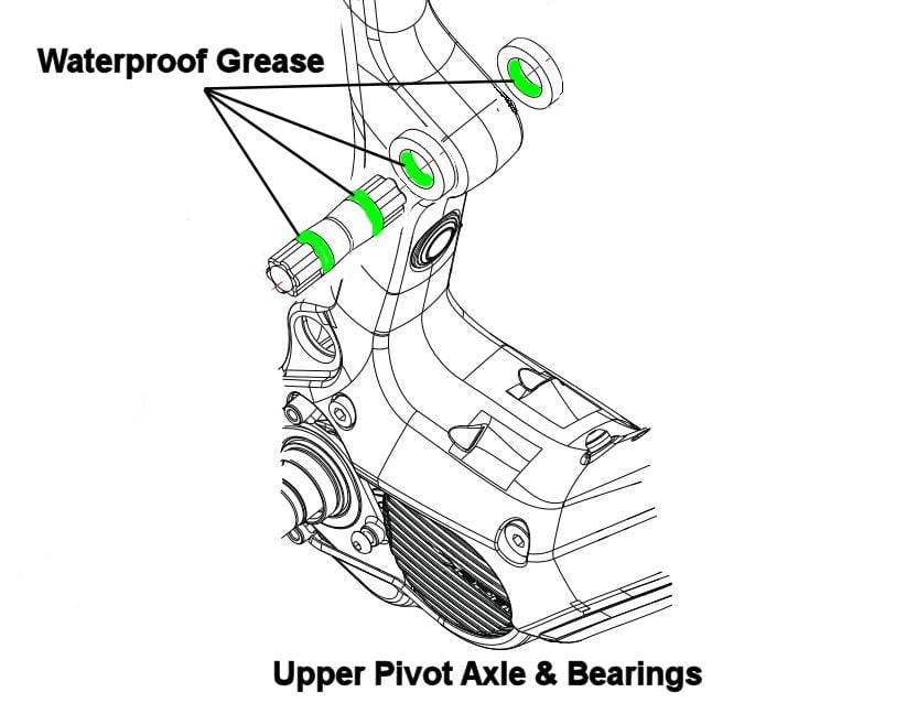

For those curious, attached below is the Rise Blue Paper section on the upper pivot axle and advisement that the threaded portion of the upper axle should face to the right.

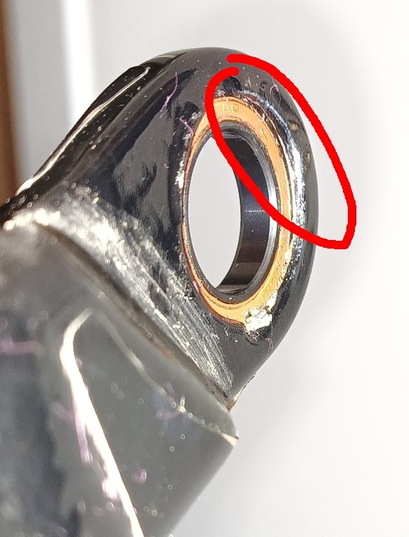

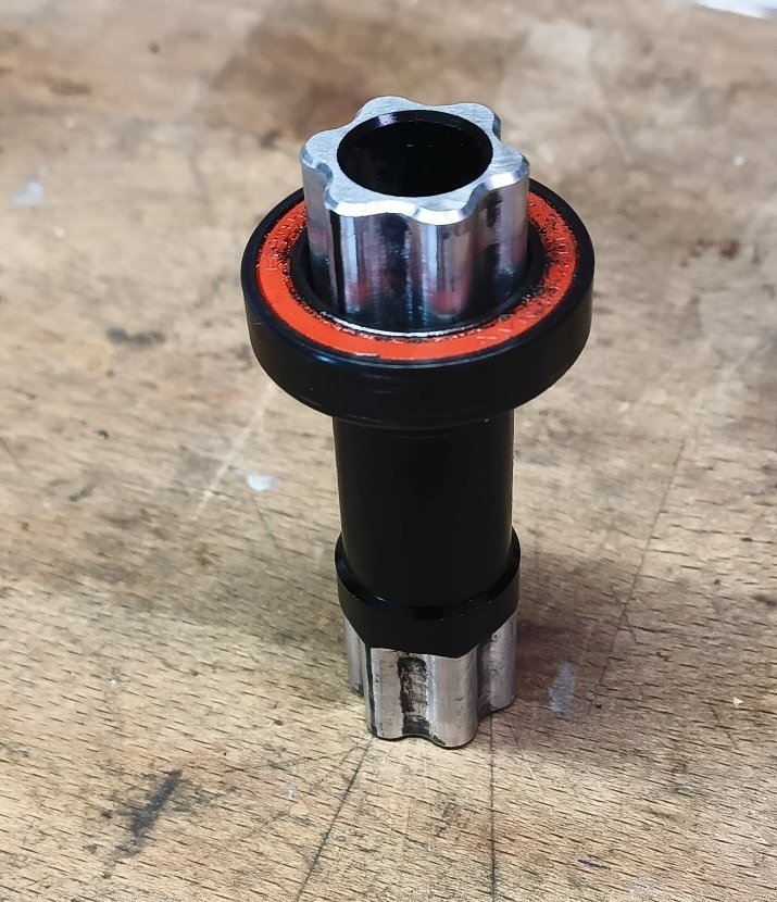

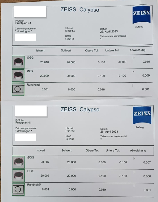

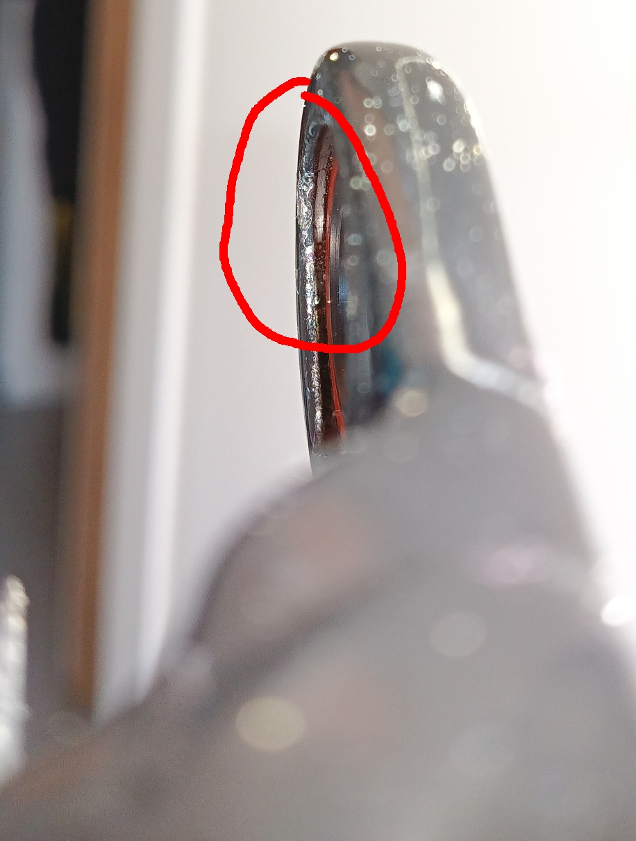

Hi Guys,

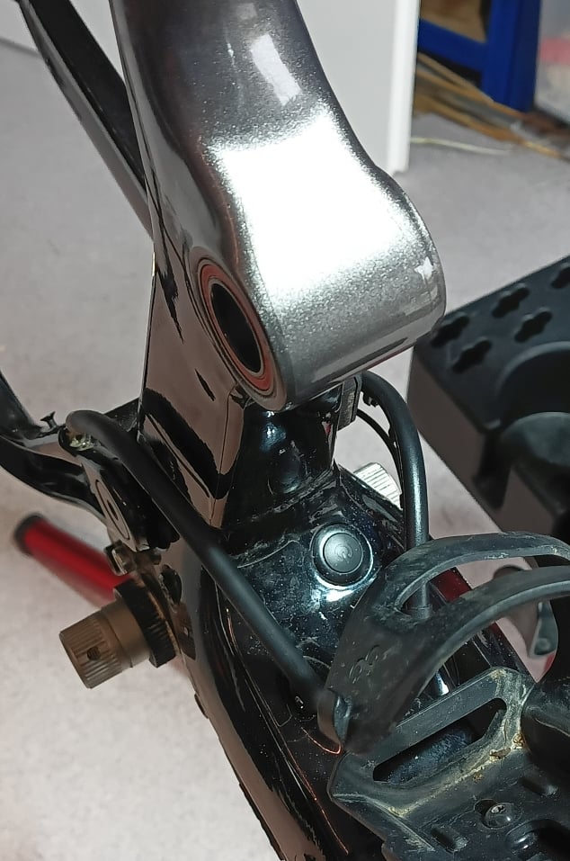

I´m new here in the forum. I read a lot about the bearing change procedures. Thanks a lot @Rod B.

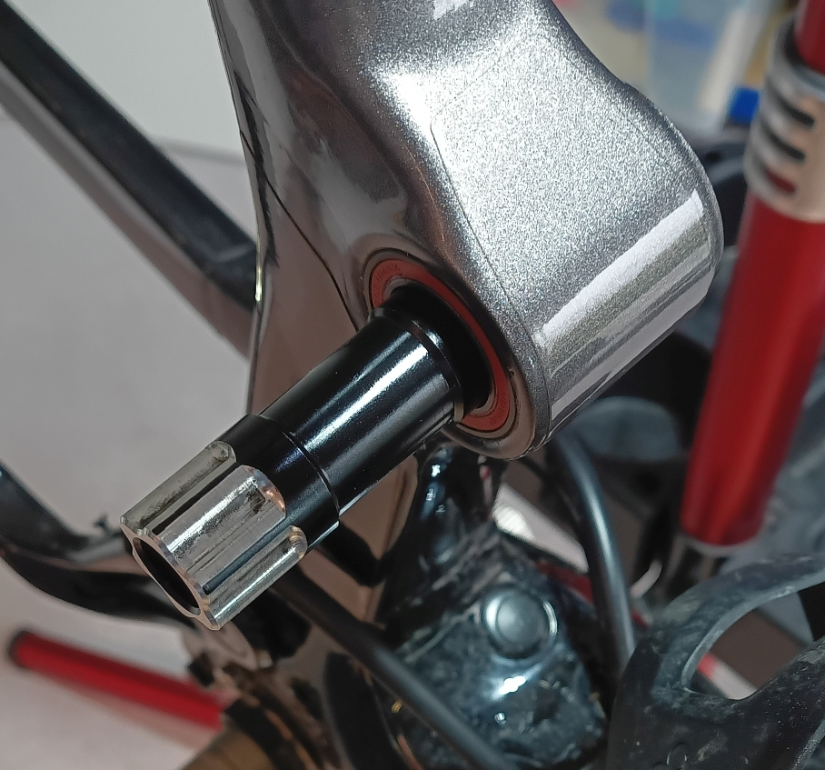

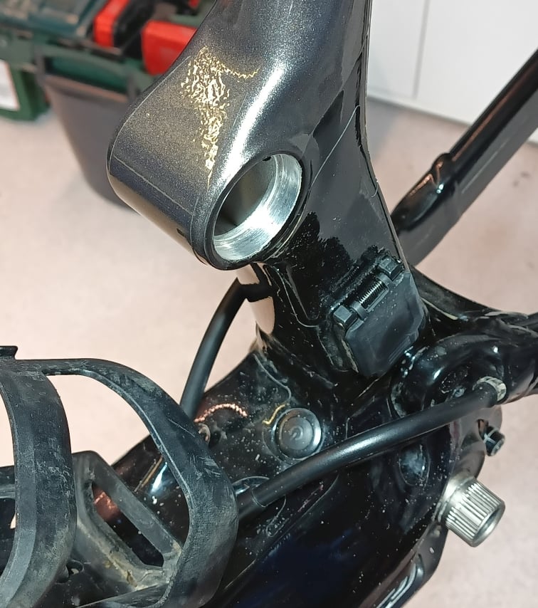

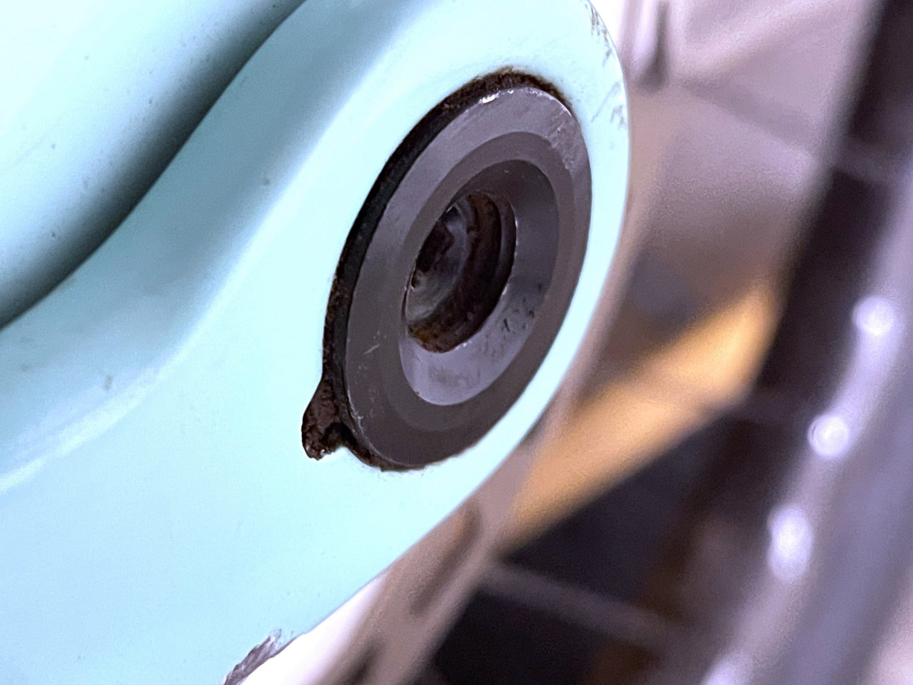

On my Rise H15 2022 which I ride since December 2022 I did a deep inspection of the bearings during the fork and the shock were disassembled for servicing.
I found out, that both bearings in the split pivot are obliquely. The one on the drive side still has some rust inside.
Further I had issues with the axle of the main pivot. The axle sticked so hard on the bearings, that when I used a soft hammer to remove it one bearing of the main pivot came out of the frame.
When I tried to fit a new bearing on the axle I couldn´t push the bearing on the axle by hand. Also, when I tried to push the axle through the remaining bearing in the frame it is not possible by hand.
Today I will take my bike to my dealer for further investigation.
Regarding the inspection of the bearings at the lower main pivot I dissembled the axle. But I couldn´t move the swingarm so that I have easy access to the bearing. The cable of the speed sensor shows a lot of tension, when I want to flip the swingarm.
I´m already thinking about how a bearing change would work here. Does someone of you have further experience here?
Regards
Oliver
Picuters sticking axle
IMG_20230419_111449_264.jpg IMG_20230419_111458_720.jpg IMG_20230419_111538_220.jpg IMG_20230419_111656_831.jpg IMG_20230419_111747_540.jpg
Pictures Split Pivot

Hi Guys,
View attachment 112572 View attachment 112573 View attachment 112574 View attachment 112575 View attachment 112576
View attachment 112577 View attachment 112578
Water can and will work it’s way past any bearing and axle interface or bearing that is placed into a bore or blind hole. Rust will form on the inner side of any bearing‘s steel face, especially if there is not a lot of air circulation to dry things out. I‘ve never had an issue with the rust and it doesn’t have much of an impact on the bearing‘s performance as long as the bearing is maintained, lubed and cleaned of grit contaminants.
I’ve found that any bearing whether a bottom bracket bearing, or pivot linkage bearing which is subjected to moisture will rust, this includes some stainless steel bearings which use a combination of steel and stainless alloys.. This goes for just about every manufacturer, i.e Yeti, Santa Cruz, Pivot etc.
In regards to the Rise’s rear chain stay and seat tube axle bearing. Even brand new, the bearings do not spin well. I think this may be attributed to the very thin width of the bearing race and the close tolerance fit of the bearing bore which the bearing is pressed into. When the bearing is pressed into the bore, this compresses the bearing race and warps it. The warpage causes the bearings not to spin freely.
The fit between the upper pivot axle bearings (Frame bearings) and the shoulder of the upper axle where it rides on the bearings is a very close tolerance fit.
It’s not unusual to encounter a situation where you may encounter difficulty driving the upper axle out of the bearings. I highly suggest pre-soaking the axle and bearing interface prior to attempting removal of the axle. I’ve used penetrant type lubricants such as WD-40, PB Blaster, Kroil, etc., with grest success.
If it should happen that an upper axle pivot bearing comes out of the bore during removal of the axle, simply press it back into the bore. The fact that it came out of the bore during the axle removal process does not damage the bearing. Be sure to clean the bearing bore and apply a light lubricant to the bearing race before re-inserting the bearing back into the bore. Additionally, be EXTREMELY careful to insure the bearing is positioned straight and true to the bearing bore when pressing the bearing back into the bore. If the bearing is inserted off-angle, it will damage and gall the bore hole.
One of the issues that will impact the interface between the aluminum upper pivot axle and the steel race axle bearings is electrolysis. Electrolysis occurs when to disimilar metals contact each other and moisture is introduced. Without going into great detail, when electrolysis occurs, one metal will take material from the other metal. This can cause corrosion and a welding together of the metals. A penetrate lubrication assists in dissolving the corrosion and will help free up the axle.
Note, the axle is made of an aluminum alloy. If you pound hard on the axle when driving it out of the bearings, you can warp, i.e. mushroom the axle and warp it. If this occurs, the axle should be replaced. Attempting to install a warped axle can damage the upper axle pivot bearings due to the force needed to drive the warped axle through the bearings.
If you suspect the axle is not warped, but it does have a slight bit of corrosion or build up on the axle’s shoulders, I’ve used “0000” steel wool to polish the shoulders and remove corrosion or build up. 0000 steel wool is a fine grade steel wool used in wood refinishing. It’s a soft steel wool and will buff and polish the axle shoulders. Do not use it aggressively as it can remove material from the axle shoulders.
When working on the lower pivot axle assemble. You should first remove the rear wheel. This takes weight off the assembly. You can leave the upper linkage assembled. To swing the lower chain stay out of the way of the bearings, you will need to unclip the “Speed Sensor“ wire and separate it from the black rubber brake hose guide that comes out of the chain stay and into the top of the frame’s motor shell. After separating the speed sensor wire, pull some slack in the rear brake hose and remove the black rubber hose guide from the chain stay and motor shell. This will give you just enough slack to remove the lower pivot axle and slide the chain stay back and out of the way of the bearings. Note, if you cannot pull enough slack in the brake hose, you make have to unbolt the rear brake caliper to gain slack.

I´m working as a mechanical engineer, so I can follow your explanations. The theory with the electrolysis sounds interesting.
To prevent corrosion the new bearings I´ve bought are stainless ones. I know that this type of steel is less hard than the 100CrV6 from the standard ones but I want to give it a try.
I had the axle measured on our coordinate measuring machine in my company. The result is that the diameters are 20,007mm and 20,010mm. The bearings usually are between 19,990mm and 20,000mm. So, I have an oversize that definitely would not fit easy.
I also visited my dealer. They told me, that everything is fine and they would assemble it with a hammer. As you mentioned above if they would do this the new frame bearing would be damaged.
My dealer is not highly interested in such a deep technical discussion.
So I took the bike home with me and ordered a new axle. The new one should be delivered next week. I will try if that one fits better. My other option is to take the old axle with me in our sample shop and sand it down till I have a proper fit with the bearings.
I also tried to cool the axle down. This only reduces the diameter a little µm. It will also be hard to assemble. I still have no chance to preload the bearings as mentioned from Orbea when the axle has such a tight fit.
Here you can see how far I´m able to put the bearings on the old axle.
I´ve done some bearing changes in the past so it should work out. At the moment I have no bearings in the frame because I first want to try the new axle or fit the old one to the bearings.
After the bearings will slip to the axle I´m going to press the bearings in the frame and put everything together.
I´m hoping that I will solve all problems in the next one or two weeks. Then I will have another talk with the shop owner from my bike dealer about that topic.

since 3 weeks I have my problem solved.
As mentioned I ordered a new axle in the orbea online store. In the meantime I had some calls with orbea in spain. Here I got no direct help but they gave me the option to escalate the topic with my dealer with the help of the area sales manager.
Before I used this option I had a call with the shop owner. First I thought he would also do nothing but a day after my call I received an mail in which he told me that I will get a complete new linkage hardware.
The hardware surprisingly arrived before the axle I ordered days before.
As expected the new axle fits well and I was able to reassemble the bike. Since that I enjoy riding my bike with a freshly serviced and tuned suspension setup.
After the other axle arrived I did a test with the new bearings which I have for further replacement. The axle goes harder than the other one I assembled.
I think as rob mentioned the fit is very tight and sensitive for tolerance fluctuations.
What I not did was using Loctite 638 or similar on the interlock of the axle. I have some thoughts that I would have problem to loosen the right arm for bearing change.
Maybe I will try this in future with the Loctite 641, which is a little weaker than the 638.

Oliver, that's great news on the new linkage. I do find it interesting that the dealer got his parts much faster than you. It takes me three weeks to get parts here in the USA.
In regards to the bearing retainer compound. I do suggest using some form of retaining compound on your upper axle and linkage arm interface. If the retaining compound is not used, the interface will eventually loosen a slight micro amount over time. When this happens, the parts will begin to work against each and cause wear and material loss. This leads to noise related creaking issues and eventually linkage arm slippage and chronic loss of pre-load. Best to take care of it before anything can happen.
As you know, Loctite make various strengths of cylindrical retaining compound. Below are two charts which I'm attaching for those interested and following this thread.
The first chart depicts cylindrical retaining compounds of various strengths. Orbea recommends the use of Loctite 638. I know of several other Rise owners on this forum who have used 641, which a weaker strength retaining compound. They reported that product worked initially, but with time, the weaker product eventually failed on them.
The second chart depicts bearing retention products. Ideally these bearing retaining compounds would be used for issues related to creaking bottom bracket press fit bearing cups or possibly a pivot bearing which has loosened significantly in it's mounting bore hole.

Thanks again for this guide. I've just done the main pivot on our two Rises. Mine had had an occasional squeak for a while and last weekend I'd noticed for the first time that there was actually some movement in the lower pivot.
My bike - first time I've looked at the main pivot. 3950km. Drive side was seized, non drive was notchy. Replaced both. The drive side had worn the black coating off the axle but I figure most of the load is compression and theres no movement now it's back together so should be fine.
SWMBO's, just under 3k. Slightly better condition on both (no wear to axle), but both still needed doing. Unfortunately noticed cracked motor axle while doing the work :-(
So - additions to your guide.
"Remove Collet Wedge". I couldn't work out how to do this for a while but it's got an 6mm Allen bolt socket - insert an Allen key to dislodge it.
"Remove axle" this needs an 8mm Allen key (quite a long one) and was really tight (it's 20nm) so I needed a long bar to start it.
The O ring on both bikes had been caught by the bushing and wasn't reusable. Worth getting a few of these in before you do the work - I measured it at 12mm ID, 1.6d BUT I bought a 125pce assortment of o rings from Euro car parts (about £4) and it was the 16x2mm that fitted best.
