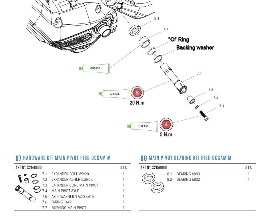

Rich how's it going? Thus far, I've greased my lower pivot about six times, I've never had to replace the "O" ring yet. I'm wondering if there's another issue.
1. Confirm that the thin steel backing washer is installed first onto the axle and then the "O" ring?
2. If the two items are installed correctly, then it's likely something is cutting the "O" ring. With your finger, feel inside the carbon fiber cavity on the chain stay assembly (where the bushing inserts) and make sure a loose fiber isn't cutting the "O" ring. I would check the shoulder on the bushing where the "O" ring makes contact to see if a sharp edge is cutting the ring. Lastly, I would feel the castellation splits on the lower axle and see if one of those isn't slicing and dicing the "O" Ring.
3. If everything checks out fine, then we need to next look at torque settings. The "O" ring's purpose is to seal the outer diameter of the axle where it makes contact with the bushing. This keeps dirt and water from getting into the inside of the bushing. Neither the axle or bushing spins or moves when the axle is tightened and torqued. The correct torque setting for the axle is 20Nm. If the axle/bushing isn't tightened enough it could be moving enough to work back and forth on the "O" ring and cut it. Also if the axle is over tightened, it could be pinching the "O" ring. I'd barrow another torque wrench and check it against your torque wrench. In the past I've had torque wrenches go out of calibration.
4. Examine your bushing and axle for wear. Does it look like the bushing may be worn enough so that it's sort of wobbling on the axle and creating a grinding motion?
5. Lastly, I'd grease the living shit out of the "O" ring and bushing, both outer diameter and inner diameter and see if this prevents the "O" ring from being cut.

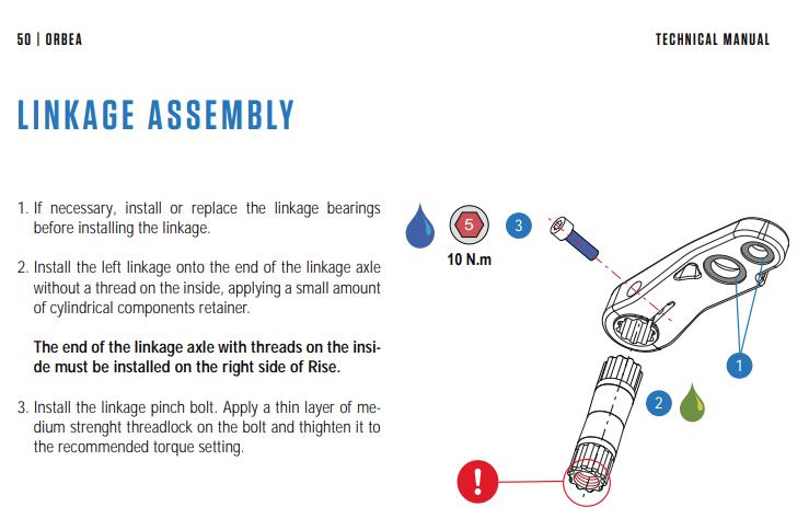

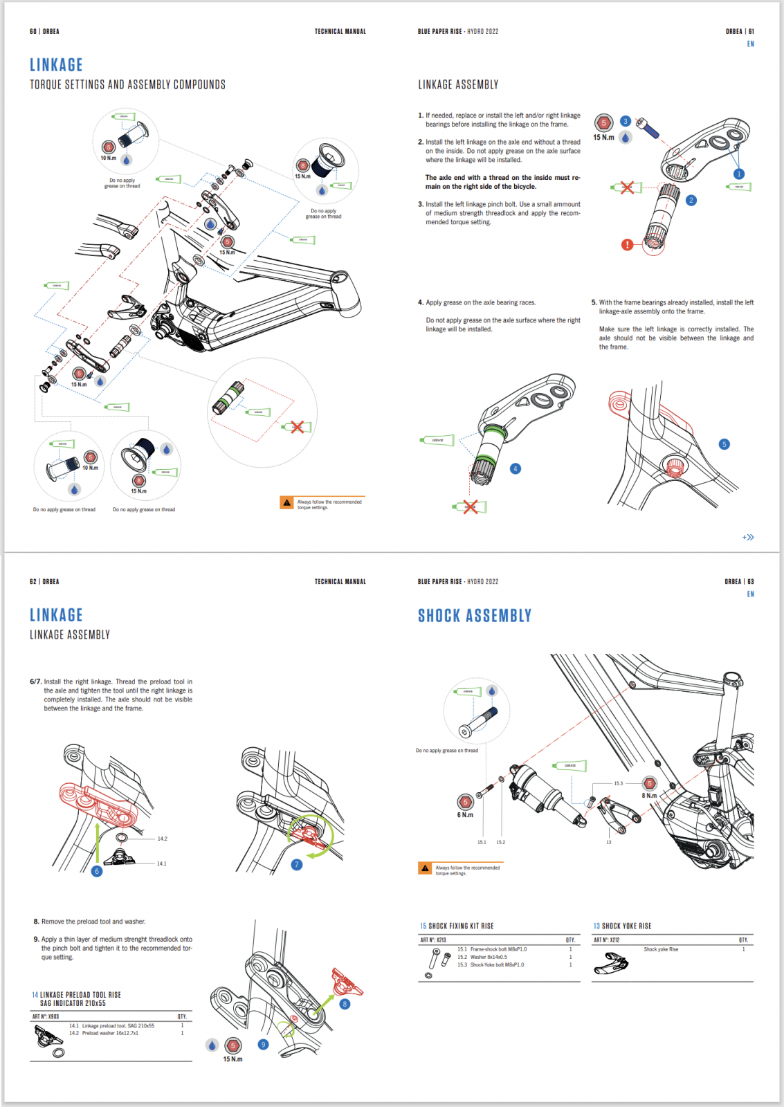

3) Hold the left (Non-drive side) linkage arm in your hand and insert the axle into the left linkage arm. Apply blue thread locker onto a linkage arm pinch bolt and thread it into the arm. Insure the axle is fully seated into the linkage arm and torque the pinch bolt to 10 N.m
Hi Rod, just want to check the right torque setting on these pinch bolts. Your picture says 15 Nm but the text says 10 Nm?
Cheers.
Rod B.
Aug 18, 2021
538
940
USA, Orange County Ca.
Cheers.
Neilo,
The correct torque is 10Nm. I cut and pasted that diagram from the Orbea's Rise Blue Paper, months back. I never noticed the inconsistency. I checked Orbea's newest Rise blue paper and it's been corrected to 10Nm. Thank you for letting me know. I'll edit my post and throw up a new diagram with the correct torque.

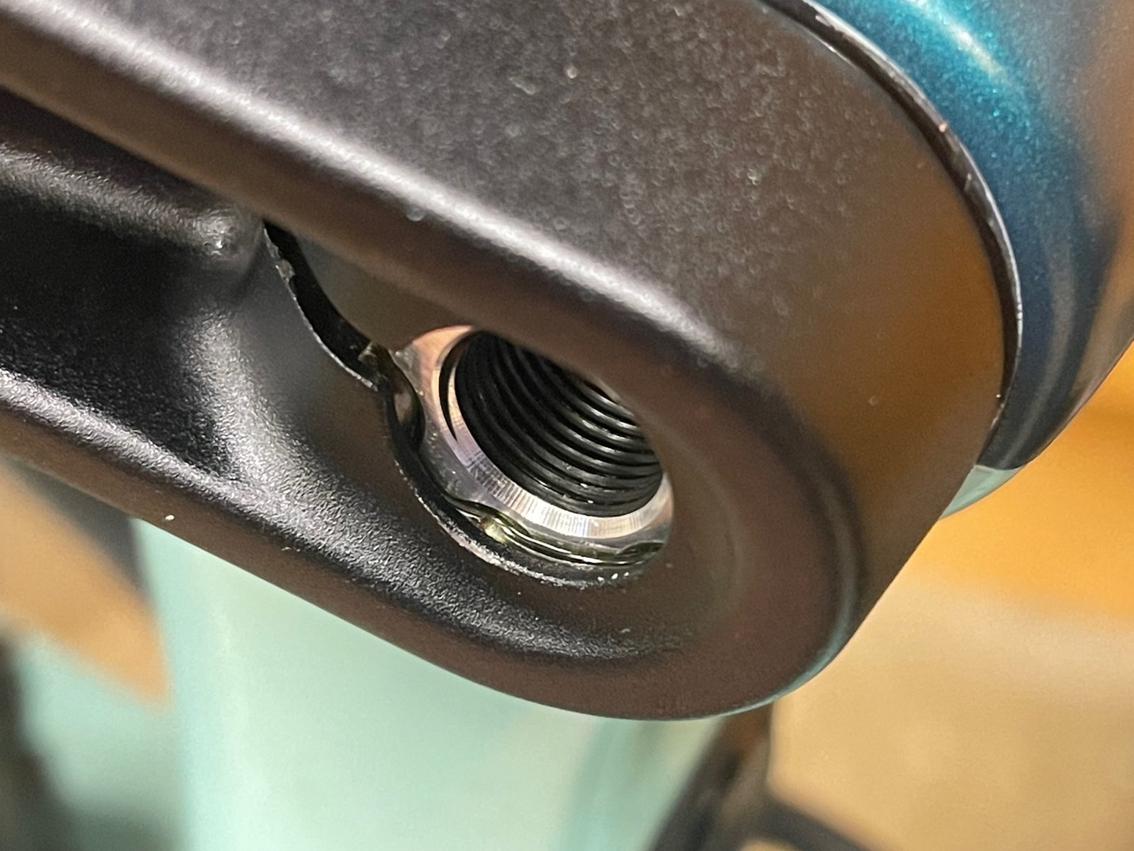

The comment - I ran into an interesting hiccup during reassembly. On one side, the large "shock extender bolt" did not sit flush with the arm after torquing it down to the specified 15nm. The threads did sit flush, but the head of the bolt was sticking out a bit. I pulled that arm off and discovered that the larger bearing appeared to not be seated all the way in the arm. There was about a 0.5mm to 1mm "gap" that had filled with the aforementioned greasy dirt. I cleaned out the gap, and did a few gentle taps while holding the arm using the bolt - that seemed to seat the bearing a bit better. After reassembling, the bolt head now sits flush again. I wish I took pictures or remembered if this was how it was before I took it apart. Maybe a bit of sloppy assembly from the factory?
Seems like my creak is gone though!

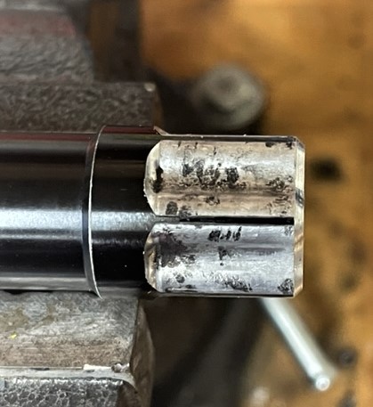

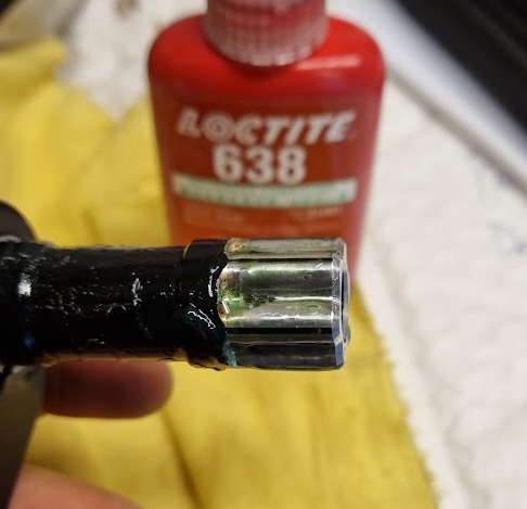

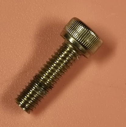

If your curious, here's how the pre-load tool works. When you thread the preload tool into the axle, the hard rubber spacer bottoms out on the axle. The alloy portion of the tool bottoms out on the linkage arm. The hard rubber spaces the axle and linkage arm out and prevents the axle from being completely pulled/seated into the linkage arm. If the axle were to fully seat in the linkage arm, both linkage arms would be pushed tight against the frame/bearings and the pivot linkage would bind. The gap which you are seeing, allows the correct amount of slack between the linkage arms and the frame.
Here's a picture of my axle with pre-load set. The shiny stuff you see is Loctite 638 cylindrical retaining compound.
Super helpful, thanks! This is exactly what mine looks like.

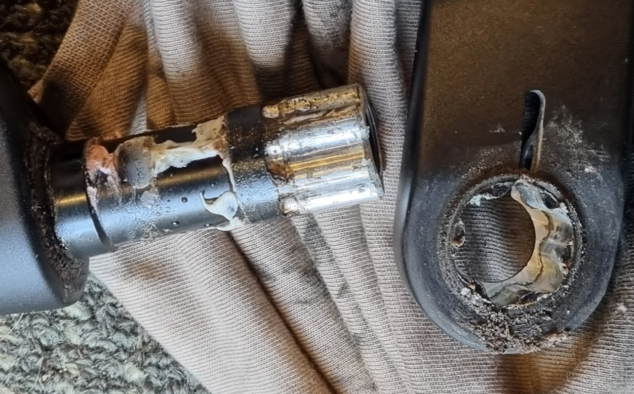

Please keep me posted on whether the retaining compound is successful at keeping the linkage arms from opening up.
Here's what my axle looked like when it finally began slipping a lot and I replaced it.

Thanks for all the advice Rod B and everyone. I did the full service on the upper axle a couple of days ago. Went mostly ok, only real issue was the drive side bearing was a little rough (surprisingly) so I repacked it with marine grease.
Picture of axle on removal
Spline all ready for assembly with loctite
I let it cure for 48hours and all solid after a brutal ride today. So hopefully this will be the last of it for a while!

I have only done about 40 miles on my Rise M-Ltd and already it's creaking like an old barn door!
I haven't stripped it down yet to check it all out but the threaded end of the upper suspension link is on the non-drive side which I think is incorrect, can someone please confirm?
Rod B.
Aug 18, 2021
538
940
Many of the bikes, including my Rise were assembled at the factory with the the threaded portion of the upper axle installed towards the non-drive side. I don't see how it really matters one way or the other, however the Rise Blue Paper is calling for the threaded portion to face the drive side.
When I first started the tech article, I thought the creaking was the result of a lack of axle lubrication. While this may contribute to the creaking, it's now my opinion the main culprit is the linkage arm shifting on the axle and the suspension opening up. Since I've used the Loctite 638 cylindrical retaining compound, I've had no more issues with creaking or play in the rear suspension. I would also suggest using a heavy duty waterproof grease.
Eventually you'll need to disassemble the linkage again for maintenance. The retaining compound provides a secure connection. I like to use a soft rubber mallet to drive the linkage arms off of the axle. This insures the linkage arms do not get scratched or damaged during disassembly.
I use something similar to this.
570K
