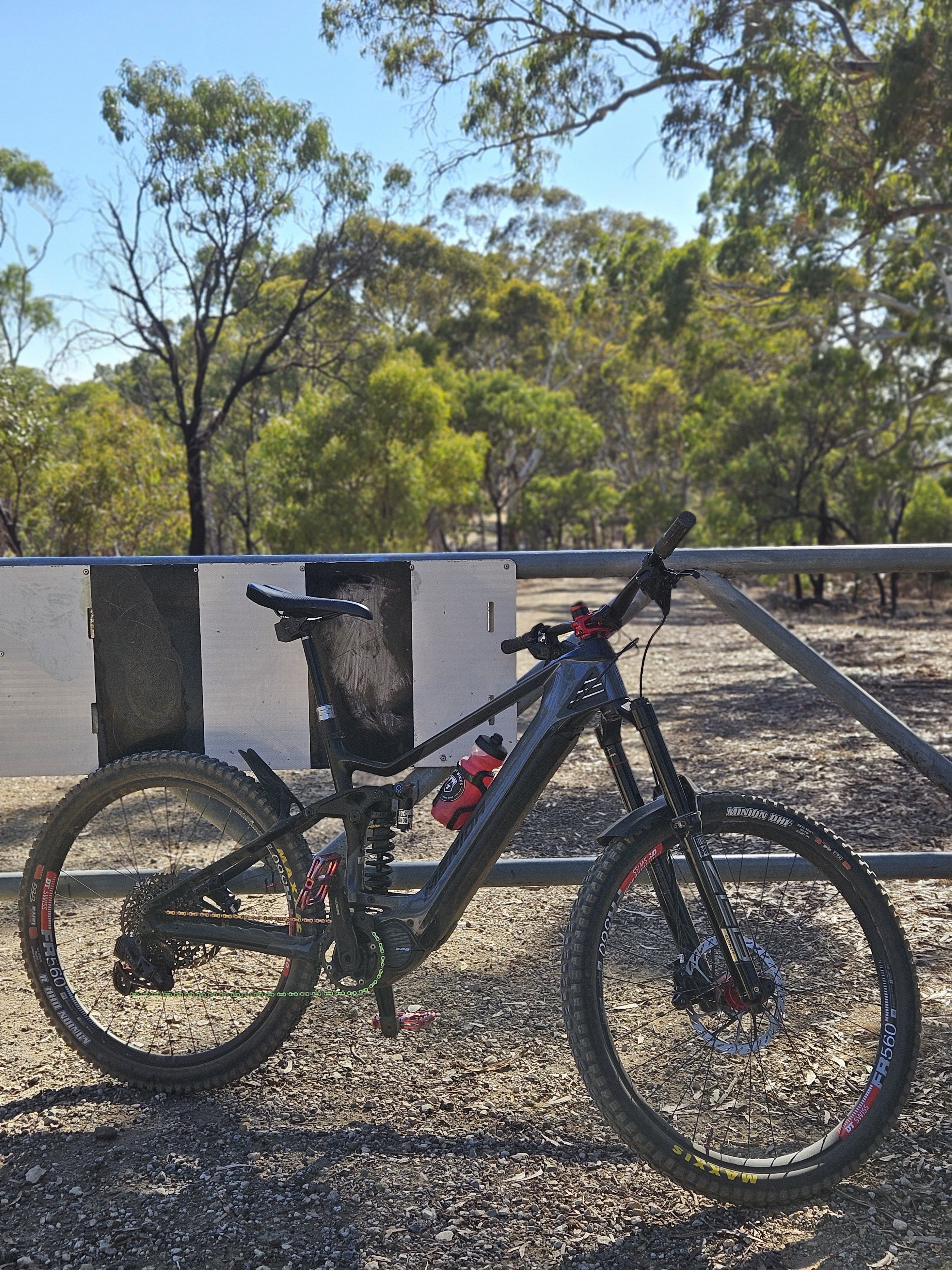

New battery cover! Tightened down the battery latch to stop the god awful battery noises, removed the fox x2 and switched it up with a 2023 Rockshox Super Deluxe Ultimate Coil and all brand new pivot/shock mount bearings.
This is the best and quietest the bike has ever run! The coil is miles better than the X2 even with a real basic carpark tune!

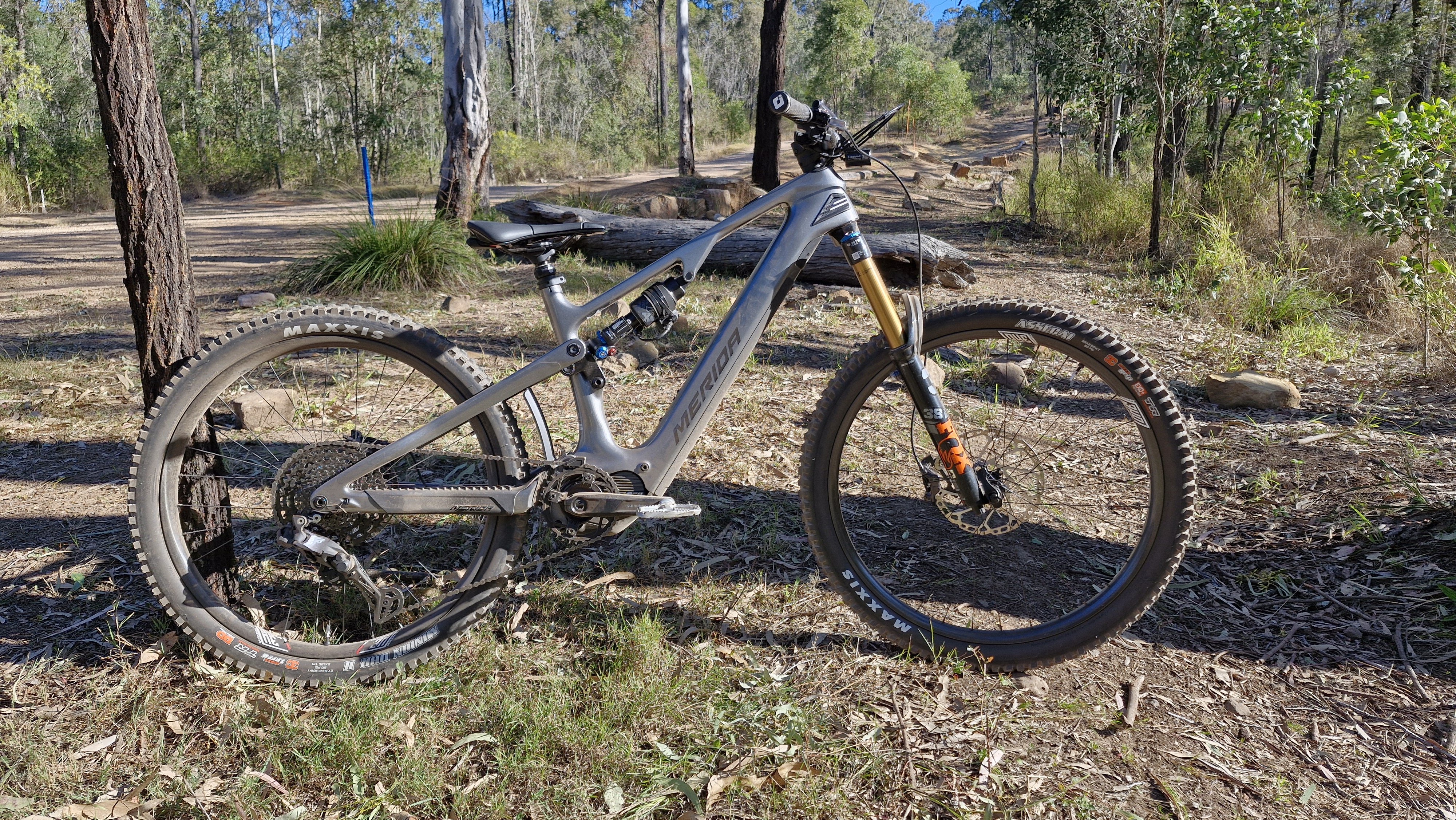

Anyone else on the new eOne Sixty?
This is the 875. 750wh battery.
Only done a few rides on it so far. Feels alot more capable than my 2021 e160 700.

Cheers!
The Zeb was a great addition. I am running a 170mm with 44mm offset. No clearance issues at all!
I love tech (I work in the industry) and absolutely love my axs shifting and dropper. I love being able to simply micro adjust the shifting while riding if a gear simply doesn't want to shift nicely without having to mess around with cable tension or barrel adjusters.
The coil was also one of the biggest game changers, so supple and soft! I put up with this X2 which has been been back to fix twice under warranty.

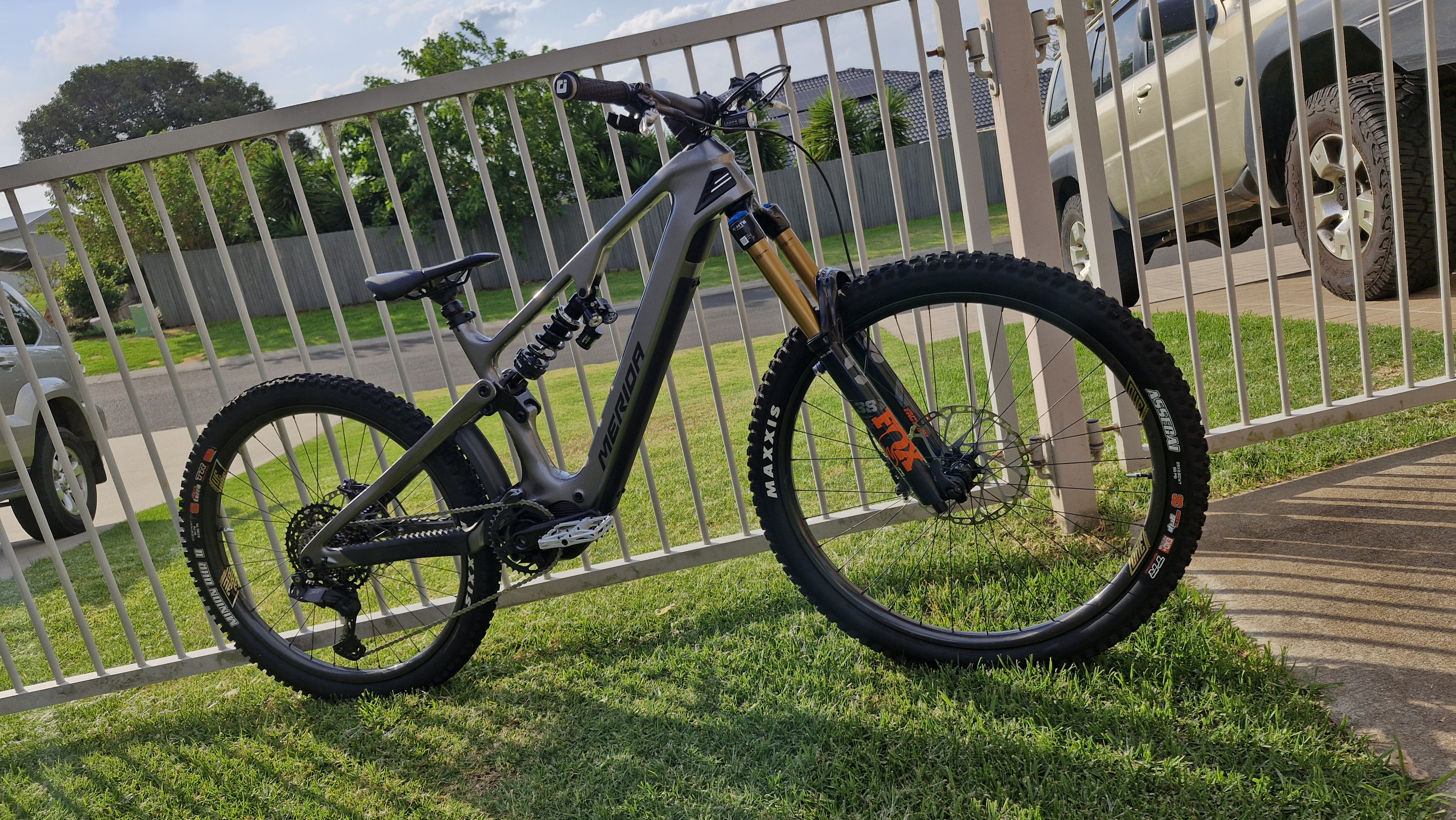

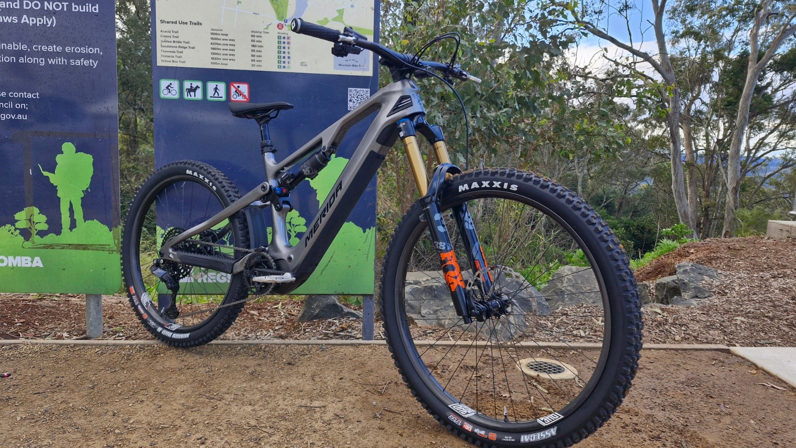

Yeh, I have an eOne Sixty CF 7000 on order fully paid for.
Current bike is the same as yours, 2021 eOne Sixty 700; but I had full fox factory 38s and X2 on it along with WeAreOne Union rims. Couldn't justify the 10k being that I will be moving my Fox Factory 38s to the new 7000 along with my WeAreOne wheels.
So the standard suspension will go back on my 700 along with the standard wheels and I already have it sold for when the new 7000 comes in. I'll get the Fox Factory 38s serviced then replace the standard Fox Performance 38s off the 7000 and put on the Factory 38s.
So hopefully August I get my 2024 7000 and I'll have Fox Factory 38s, WeAreOne Unions, ODI TLD grips, OneUp ALU pedals and 160mm cranks will go on. Plus I'll probably otherwise I can think of anything else the bike would need. First service on the 7000K I'll probly get the X2 on the 7000 chanced to Kashima coat just because it'll annoying me not matching the fork. Next set of brake rotors will be ICE rotors as they were genuinely good for cooling and a new seat depending on how bad the seat is.

Congratulations, beautiful bike!
How easy is it to remove the battery? WOuld you need to drop the motor? And how does it ride compared to the 2021?
Motor would likely need to be dropped.
Haven't had a trail ride yet because it immediately ra9ned after taking thst shot, but just a quick lap.of skills park; motor is a lot more punchy and the bike Def feels more agile, but until Sunday when I get a proper ride I'll have more to say

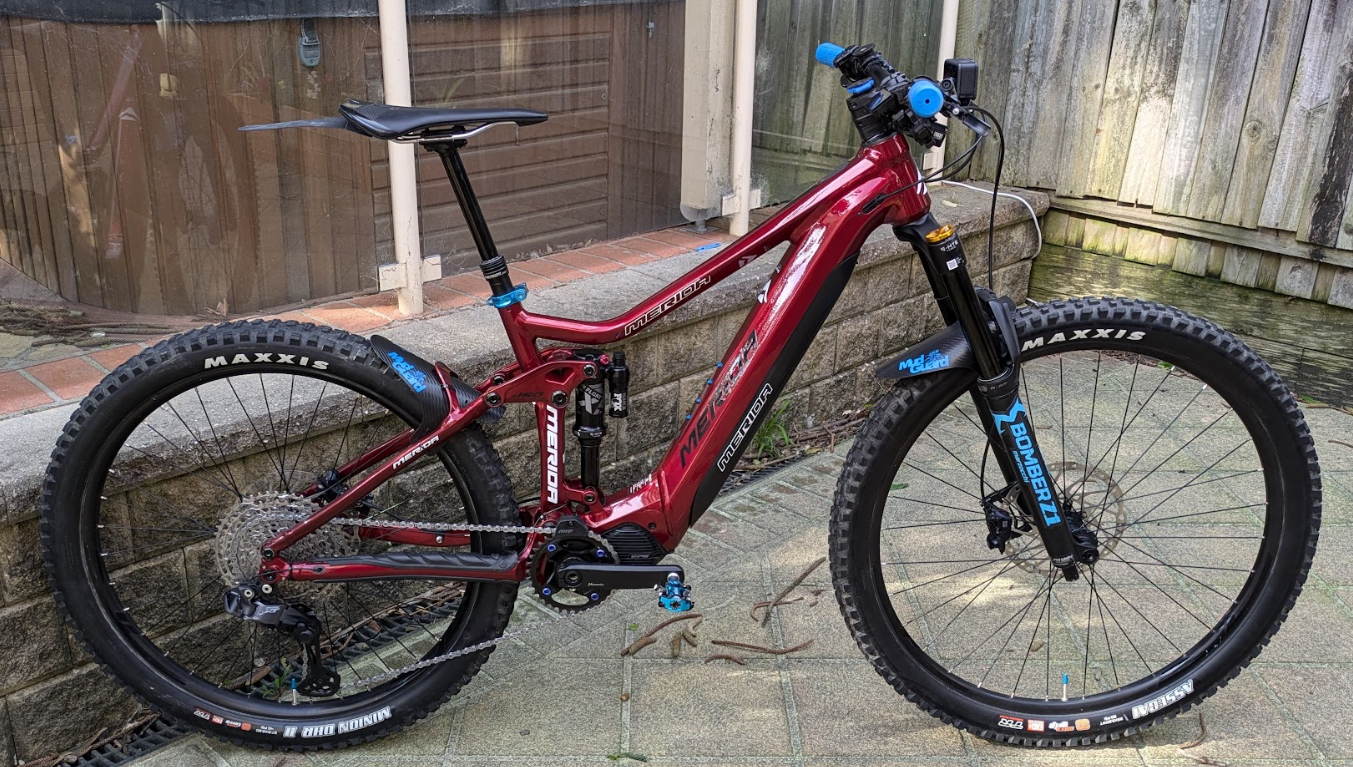

Yes, the EP801 is a lot punchier especially with the new 4.3.0 update. That bumps it up even more. I did a conversion on a 2021 E160 8000 from EP800 to EP801 and the difference is very noticeable. Once thing you should check is that the motor is set to the full 600W. 4.1.0 officially enabled that for the EP801 but some motors are still set to 500W. eMaxMobile is free and can display those settings.

Do you happen to have a list of what exactly needed replacing to do the EP801 conversion as I would love to do the same to my 2021 E160 8000.
If you start from scratch then it’s not cheap! I already had a spare EP8 (old one had issues) and battery which I sold to minimize cost! I also already had the SC-EM800 display.

Yeh, just incredible. Coming from the E160 700 2021 to this; the suspension feels incredible, so unbelievably supple but the bike is still so sharp and agile.
Definitely worth the update.
Will have a video of the first rides later

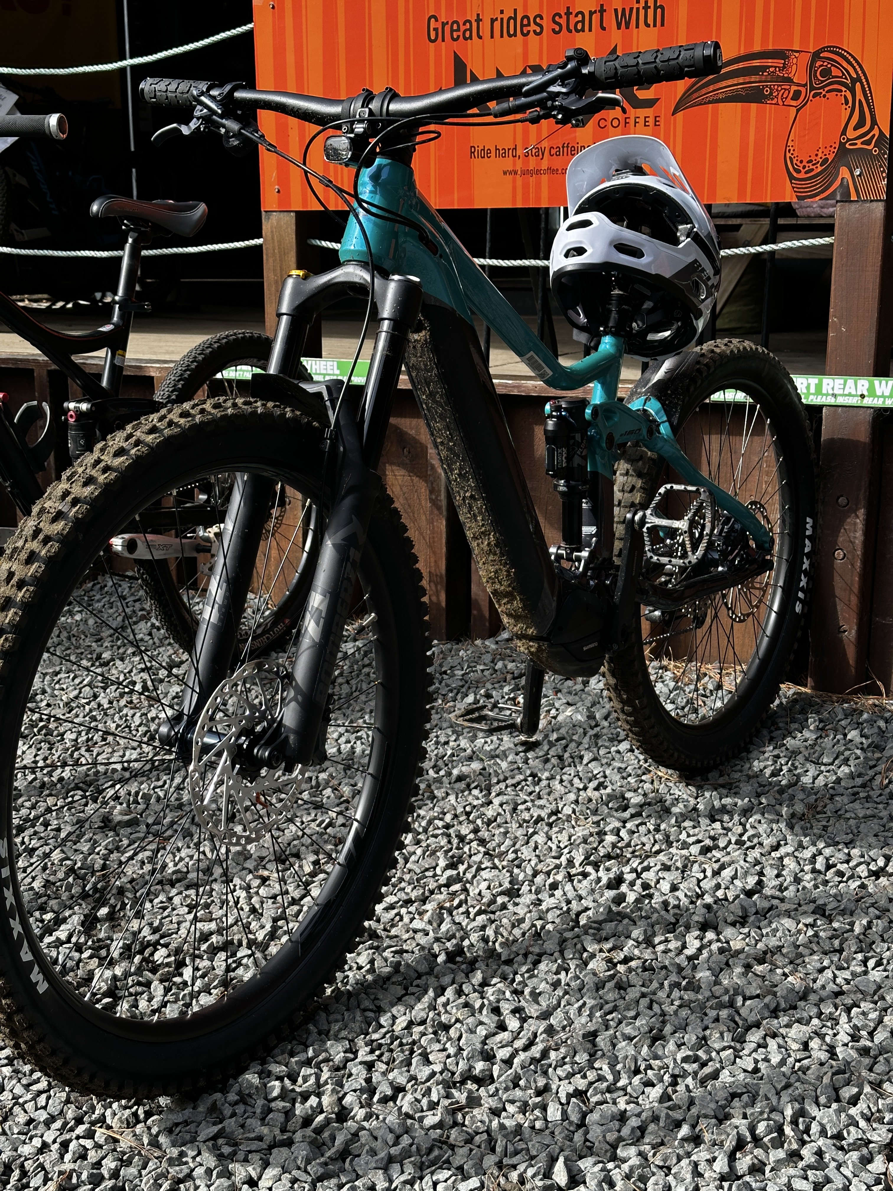

First minor problem discovered and remedied within the first week of ownership.
I noticed a plasticky clacking while negotiating rough terrain on my first trail ride, so after being warned about the battery covers falling off, I checked mine and it appears that the little tabs that hold it in place were not all in good condition. Two of the tabs on the right side of the cover were broken off and one on the left was wiggling about, ready to break.
I went to the shop and they were happy enough to swap it out there and then. 99Bikes to the rescue!
No more rattle, but am now keen to get a strap of some sort just in case.
I've read that the Polygon Siskiu T7e has the same issue with a virtually identical battery cover setup.
Can anyone reccomend a strap? Preferably one that's not going to be too obvious...

The tabs break off easily, and you definitely can't hang the bike over a Ute tailgate without breaking them all off. Speaking from personal experience!
I'd recommend getting an amygos bash guard. Great for protecting the motor, and also holds the battery cover on securely.

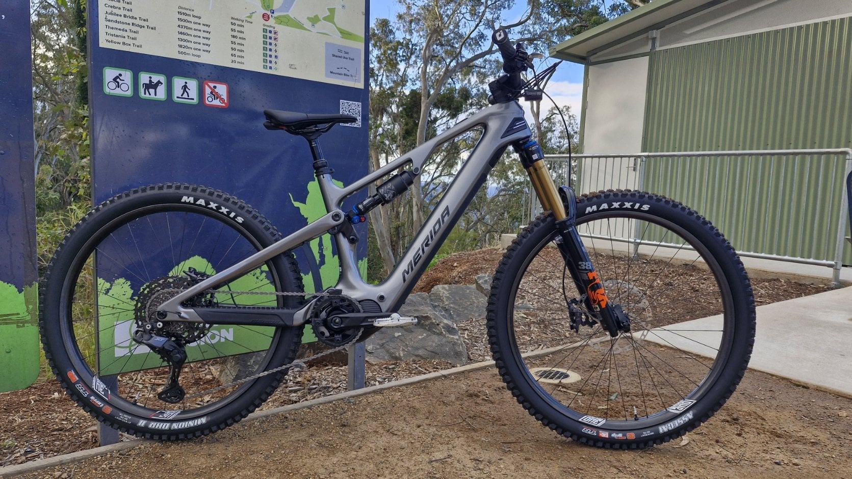

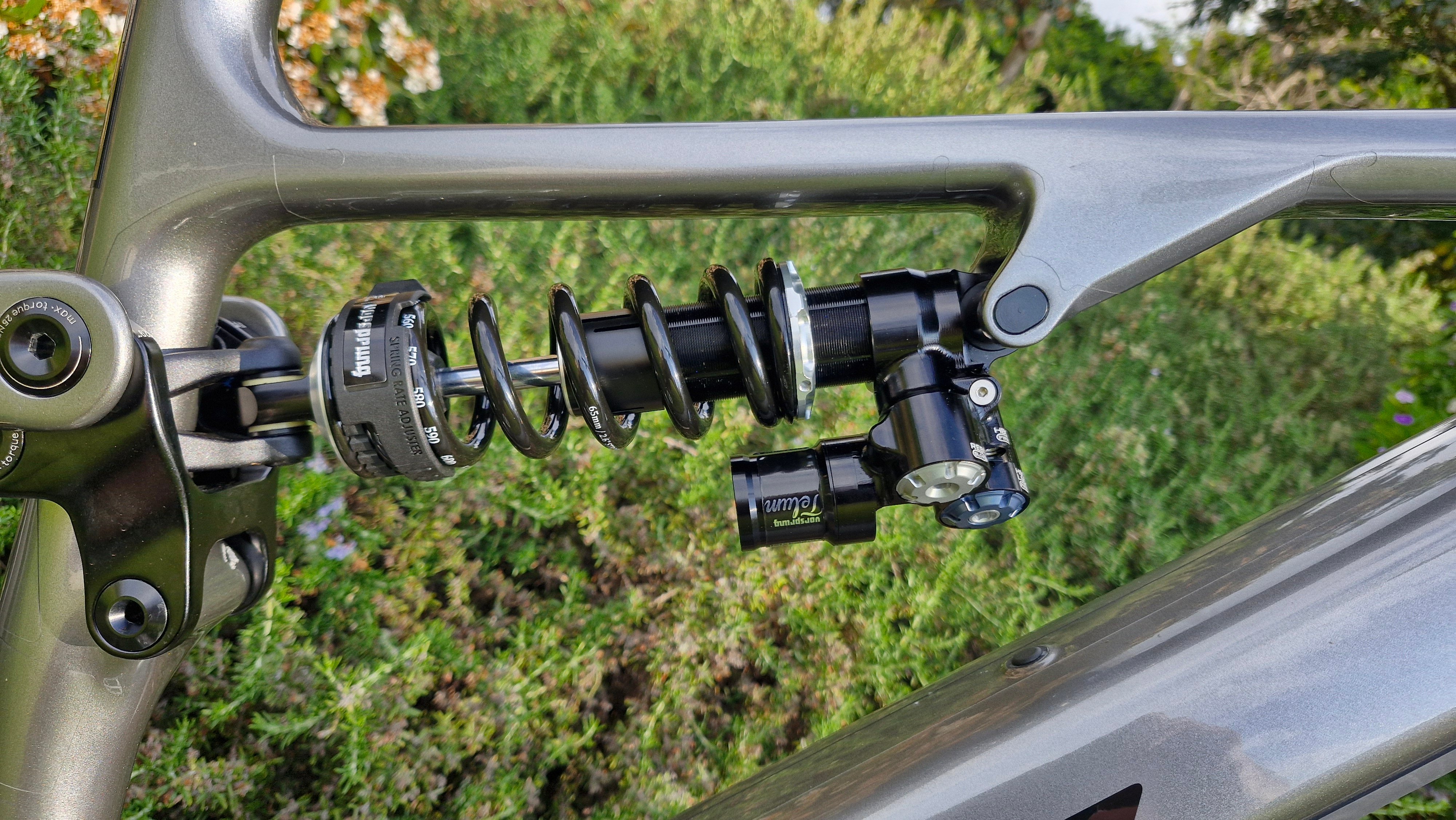

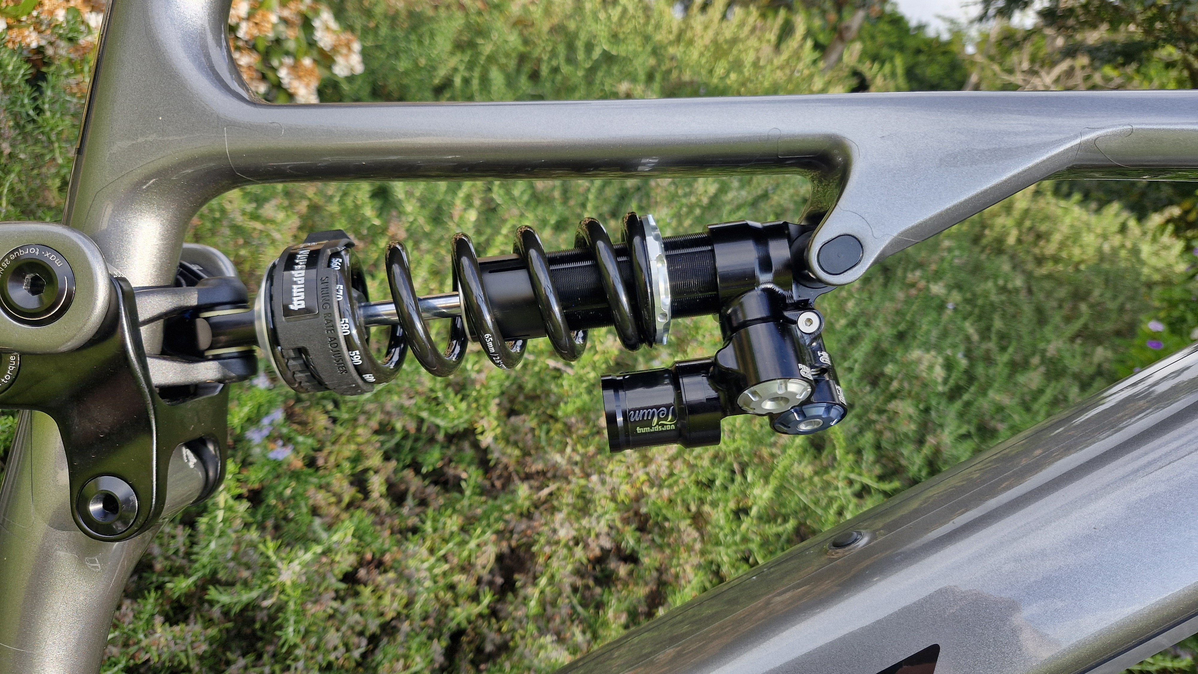

So another update; haven't had a chance to ride yet, but can confirm the bike design and yoke length can fit coils fine.
I've added a Vorsprung Telum today; no ride impressions (except a quick spin down the road) and yeh, alot more support mid stroke compared to air but not trail impressions yet.
