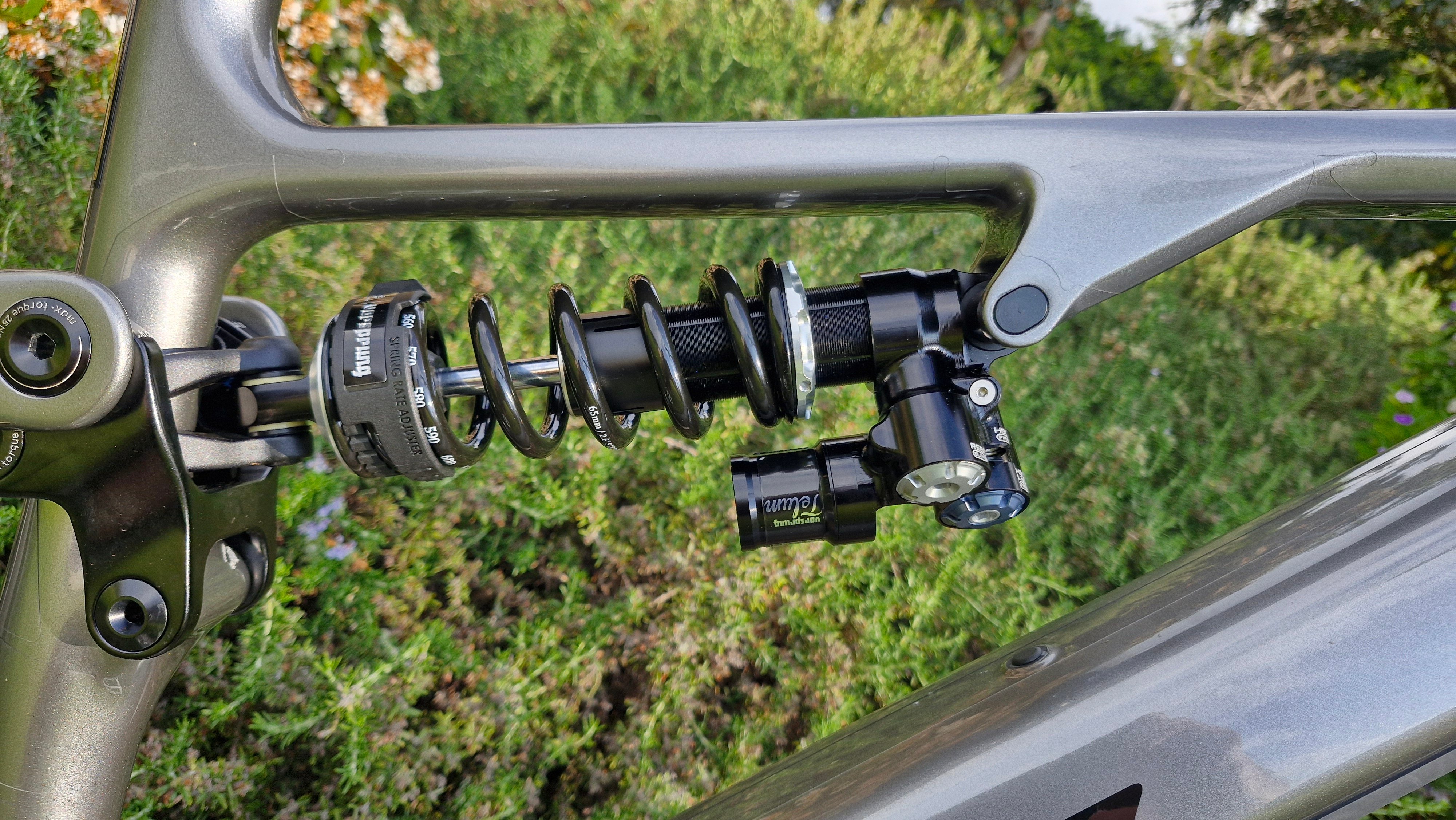

So another update; haven't had a chance to ride yet, but can confirm the bike design and yoke length can fit coils fine.
I've added a Vorsprung Telum today; no ride impressions (except a quick spin down the road) and yeh, alot more support mid stroke compared to air but not trail impressions yet.
View attachment 146553 View attachment 146554
Ive heard reports of next level amazing about the Telum. That bike will be a top weapon no doubt. Wish they sold them in NA

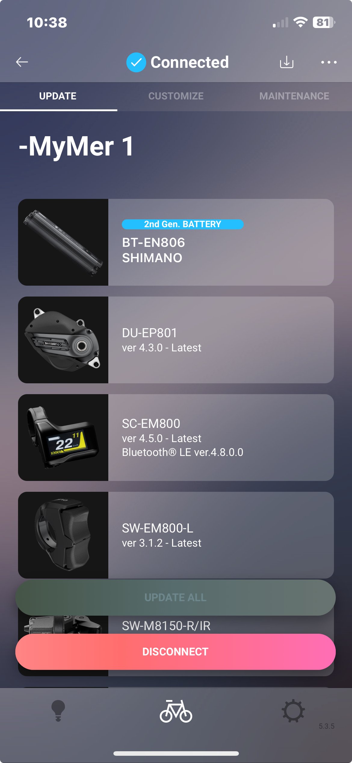

A question about firmware update.
E-tube Project shows my bike's EP801 firmware is 4.3.
According to Shimano, the latest firmware is 5.3.2
I tried to update but E-tube Project (connected) says 'no updates available' for my bike
Shimano are saying online: 'New firmware is free to all EP801 bike owners. Update the E-TUBE Project Cyclist with the newest firmware (Version 5.3.2), If you need help, visit your local Shimano Dealer'
Am I missing something?
It’s going to sound obvious, but are you sure it’s not telling you the version of the app?

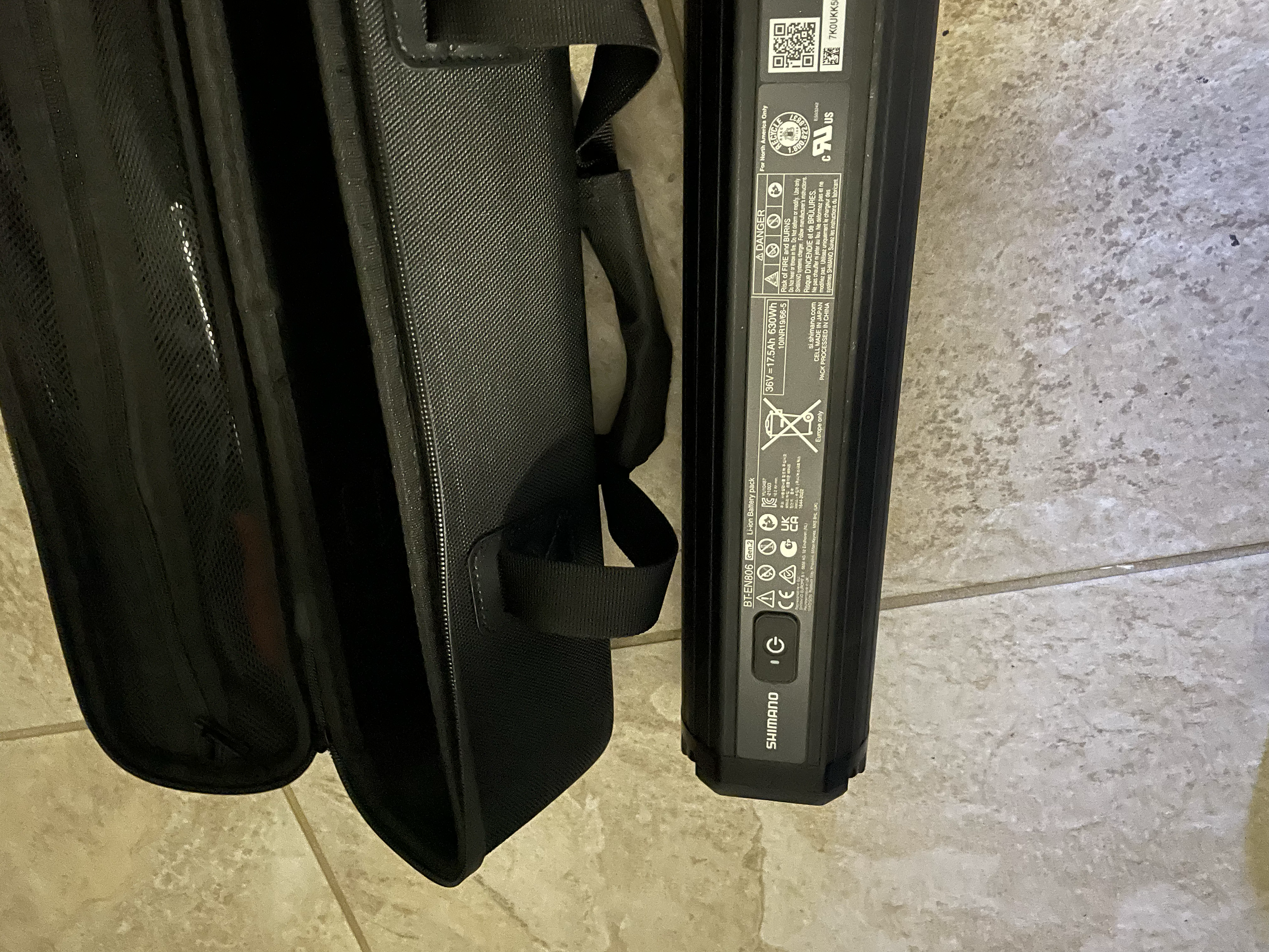

This is the 630Wh that comes with the 2023 e-160 and you can see a power on switch located near the bottom, on the side that faces into the frame. I've wondered about it - assumed the battery was designed for a different bike. I also have a 2021 e-160 with 504 Wh battery. Both are demountable, unlike the 2024 model. (I need demountable). Not sure if the power-on swith has its own battery - I assume yes. I recently replaced the battery in my Levo SL power-on switch. But, you should be able to answer your questions by checking your own bike?
On the pre-2023 (or 24?) Meridas there's a blanking plug on the downtube below the bottle cage fixings. You can stick something in there to power up the battery using the switch you've shown above.
BTW, can I recommend a battery bag from Amazon that perfectly fits the 630Wh battery? Had to return a couple before finding this one.
Not sure if it's been mentioned, but you can put a transparent plug in that hole. Then you can see the battery light flashing whilst it's charging. I use this to recharge the bike to 80% after ever ride. ( 4 flashes is about 80%) Rather than 100%. Then only charge to 100% when I'm going on a long ride. And only then, do it the night before.
Leaving the battery for long periods at 100% charge, is not the best way to treat a LiPo Battery.

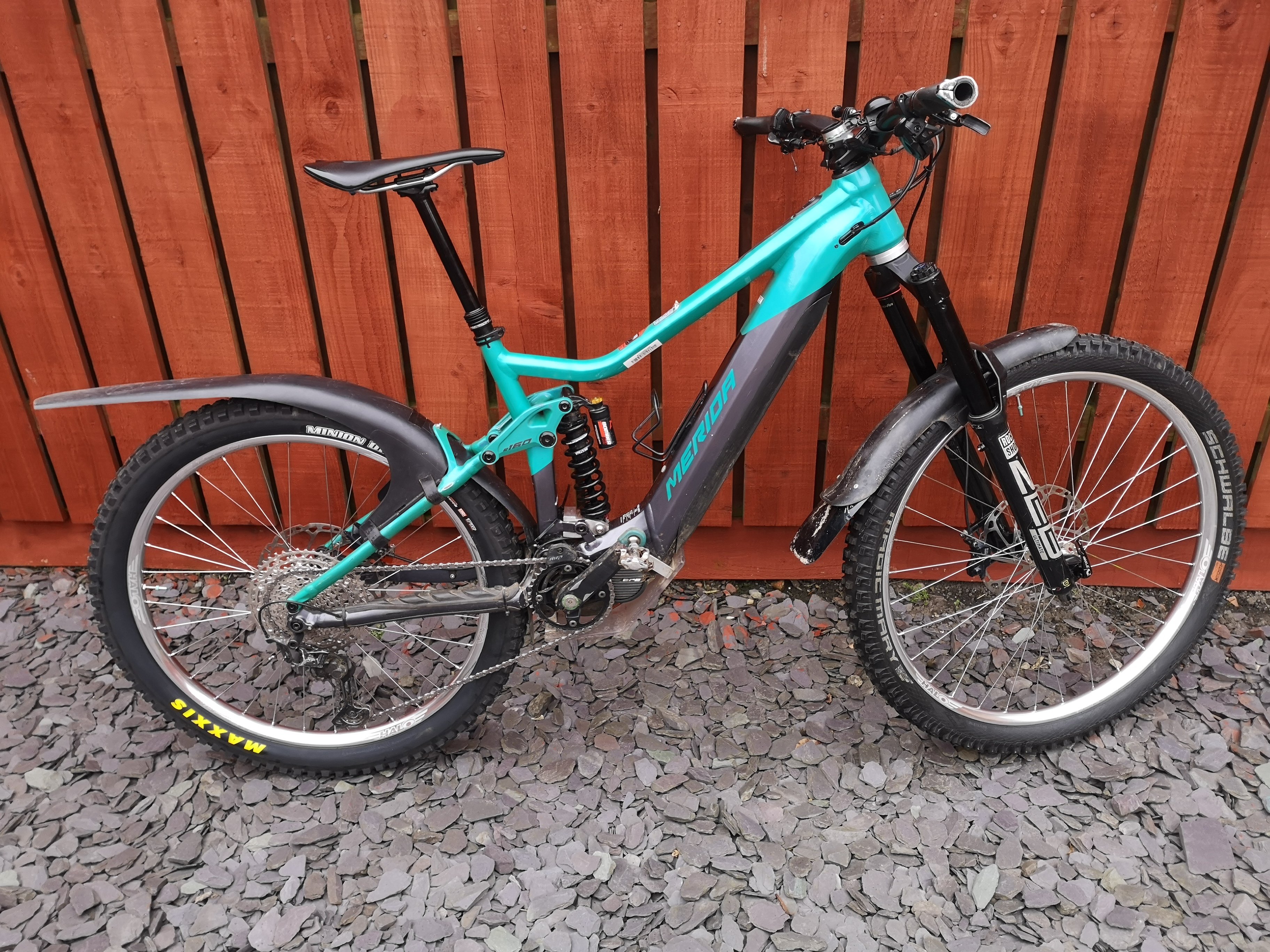

Yep, eOne Sixty 700, October 2021, 1800 miles, slightly modified. I love the thing but treat it like a baby after all the Shimano EP8 horror stories. She never gets wet washed, only dry cleaned next day. I do occasionally take the wheels off and squirt them though.
Hi mate. Did you installed the fork crownrace onto the 38 yourself? How did you managed to do it?

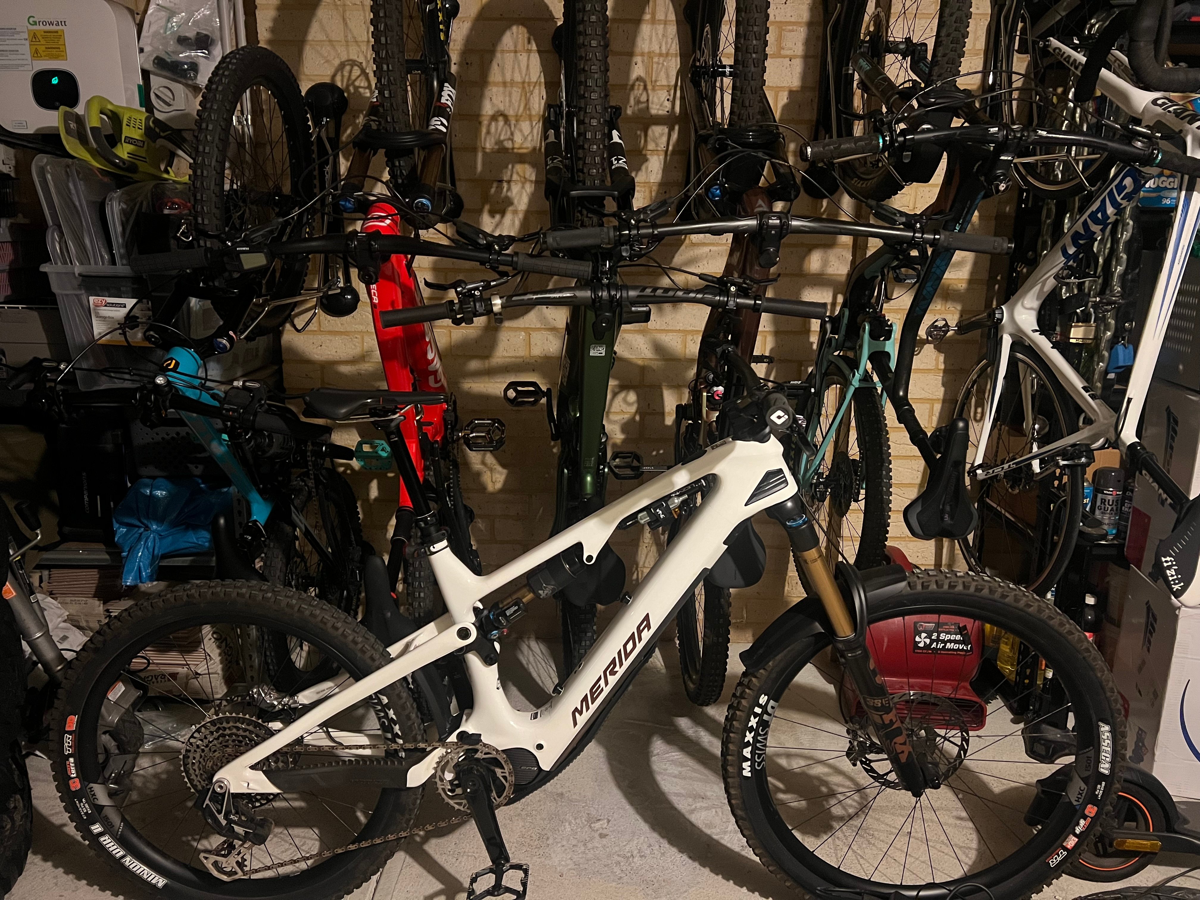

FINALLY my turn, after a 6 month odd wait for my order. Haven't modded too much yet, RaceFace Era carbon bar, changed the headlight out for the next tier up 1000 Lumen Lezyne (haven't compared it at night yet against the wifes 675 that still has the same model headlight this came with, so not sure yet if much improvement, have better stand alone lights for real night time jaunts), bought a Granite strap for the tool mounts under the top tube while I wait for a CrankBrothers SOS strap to arrive (Granite one will then move to the wife's 675), Rockstop frame guard, full frame/fork wrap, and Galfer pads. Still trying to decide whether to swap the saddle for my usual staple of a Selle SMP Well but finding this one pretty comfy albeit slightly short. Now I just need to make space to hang it!
If you don't have a split race or the crown race removal tool you can use the hammer plus razor blade method. It has worked for me several times, but of course be careful with yourself and don't blame me...

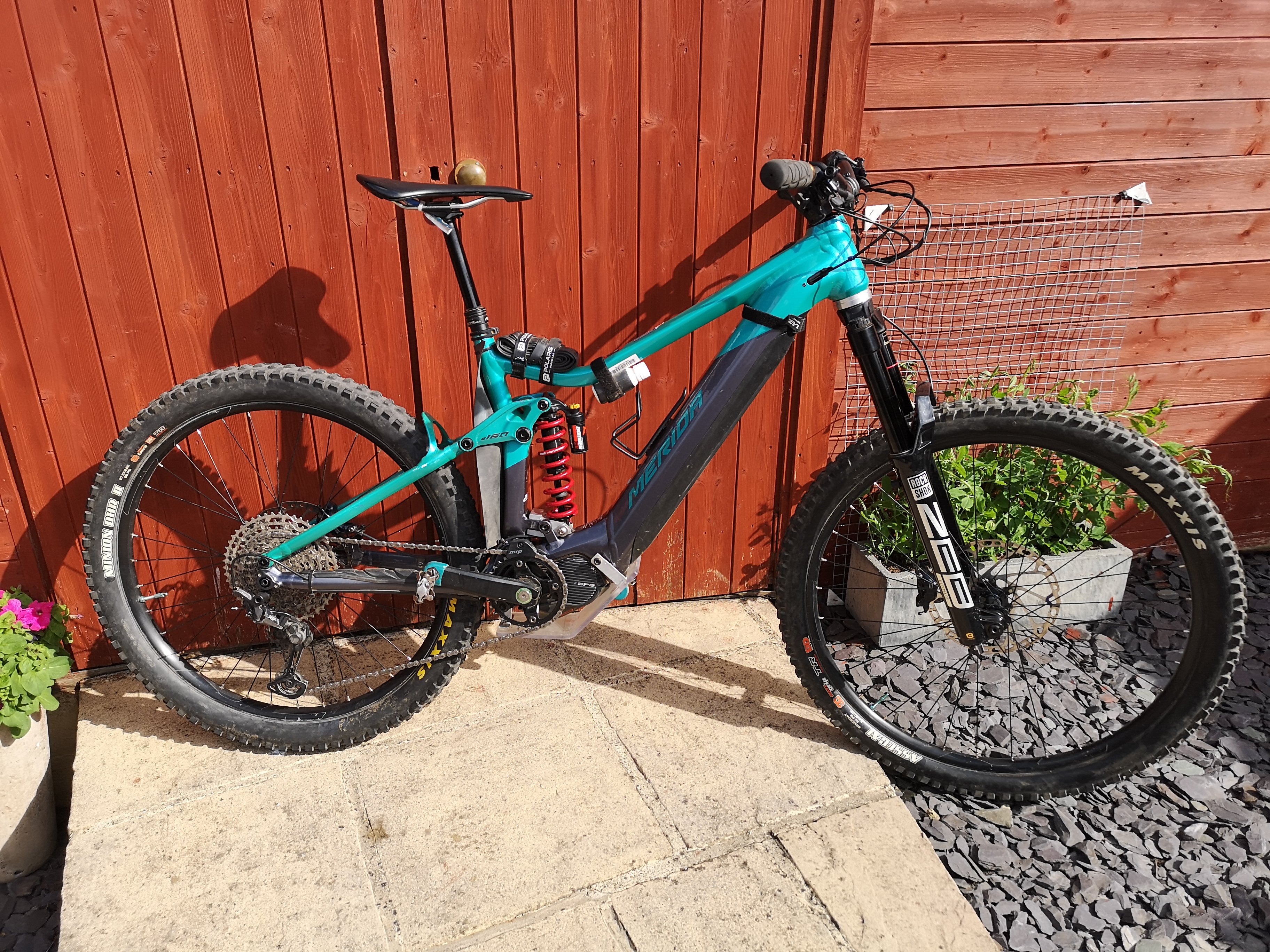

I finally ran out of trust with the Shimano SLX rear hub at 1800 miles, it loosened itself three times that I can remember, so when the cassette and chain needed renewing I treat the wee beastie to some Halo wheels. Never did like black anyway.
Really like the new wheels.
I'm also a fan of the look of the Bomber CR coil, too. How's it been, compared to the original air shock?
