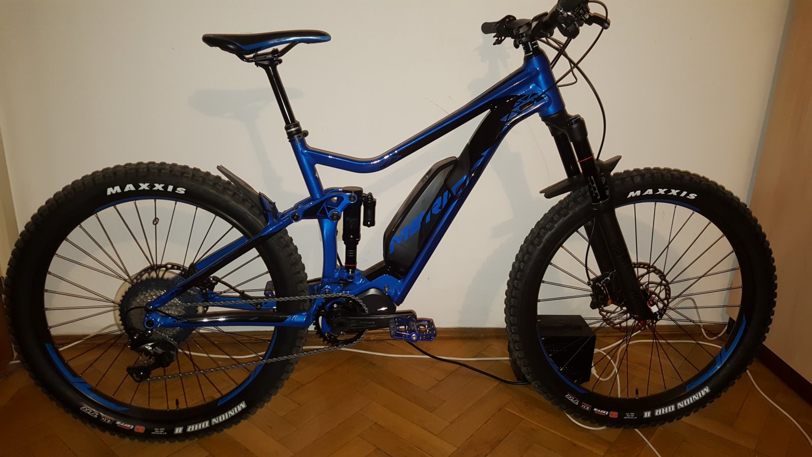

Here's mine.
A few things have been replaced which I'll list later.

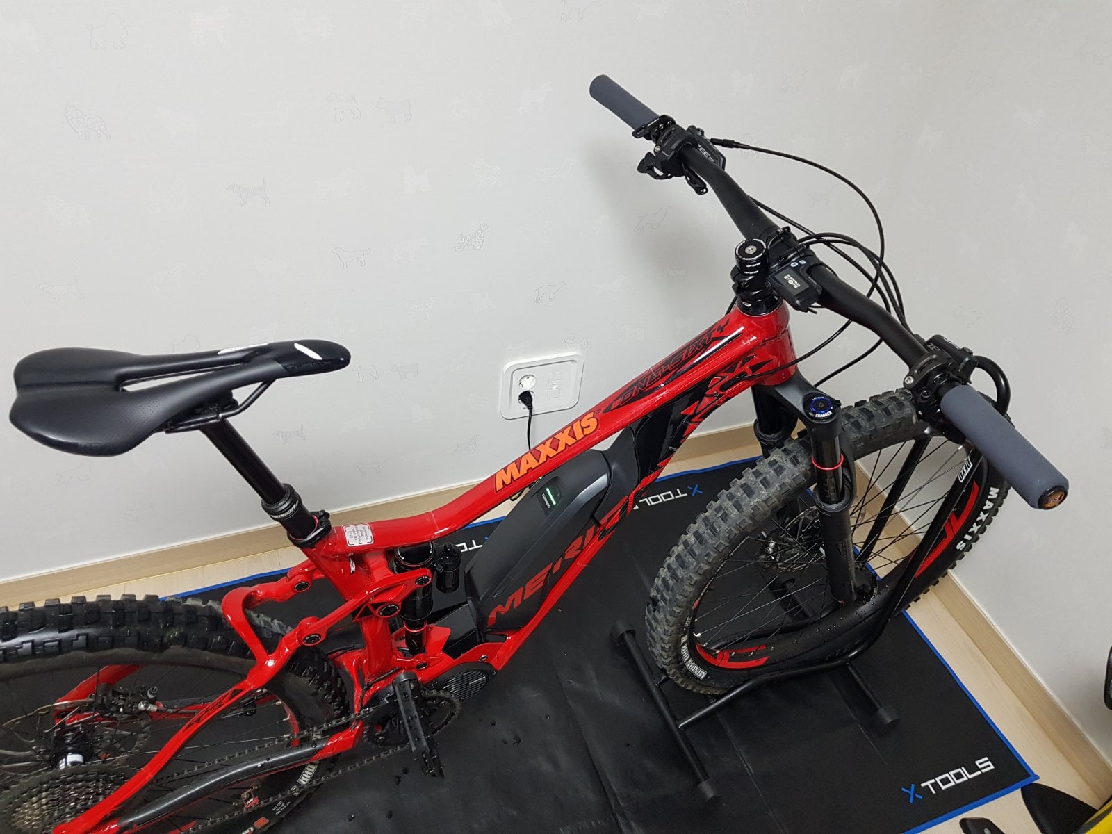

Hey, still don't have it :( ordered on 4 June and it's expected in the beginning of July. We'll post some pics when I get it. I will change the bike a bit, 29" wheel in the front (a la Canyon e-bikes), a canyon ebike specific saddle and a wider handlebar.

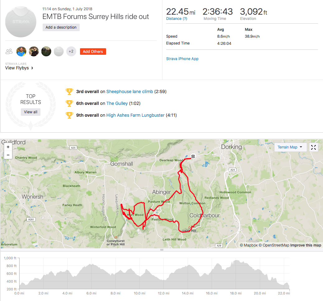

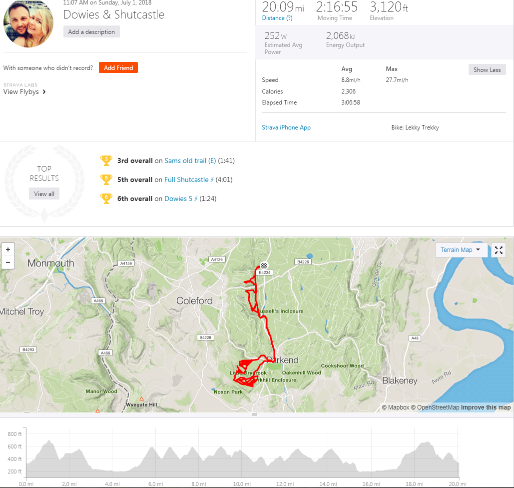

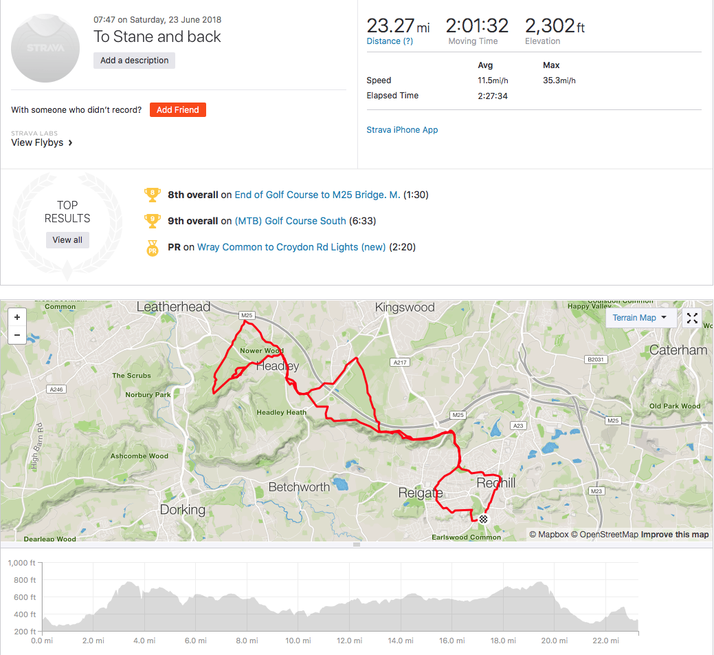

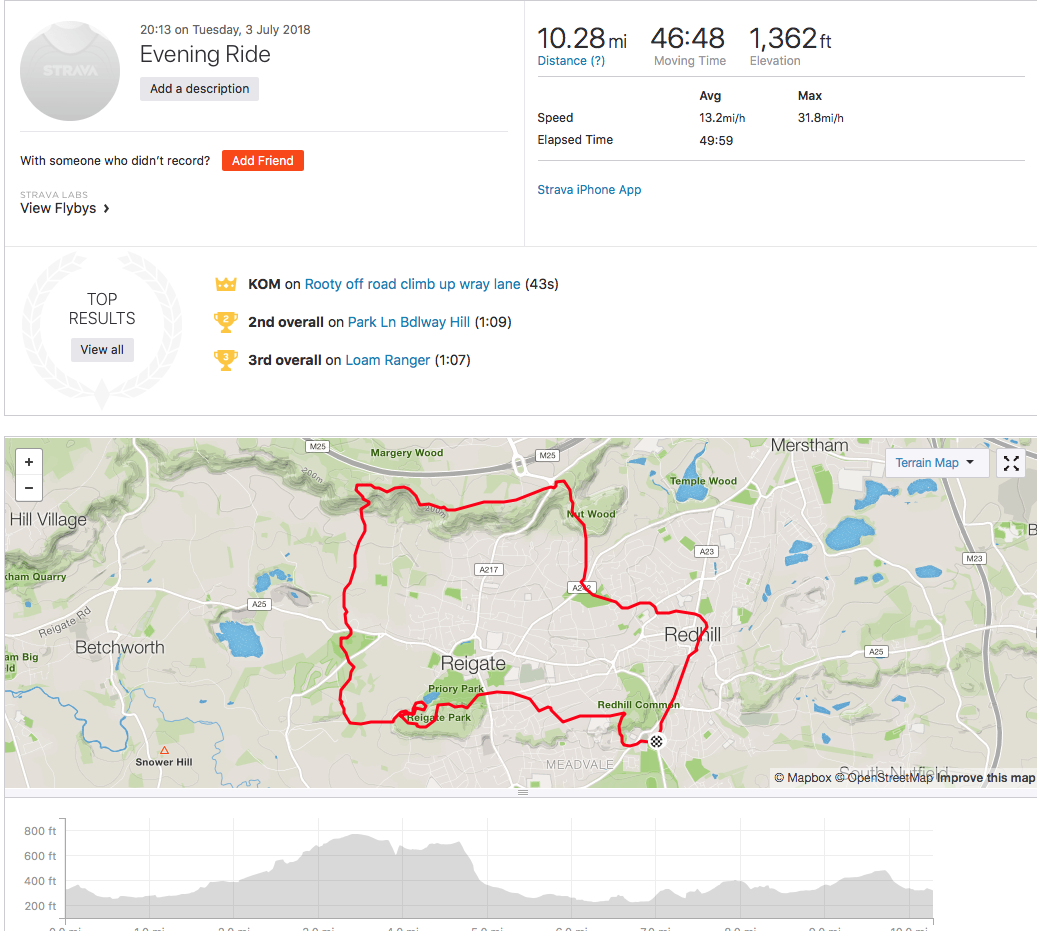

Thats surprises me, I weigh 13 stone, excluding kit, and would expect to get 20 miles out of the battery on my Vitus on that kind of ride, though i only put in trail when needed, and boost only if its something crazy. We did a forum ride the other day, first set of data below, and my battery hit 1 bar just as i got back to the car park, probably rode 40% eco, 50% trail (set in high mode) and 10% boost.
The second ride i did yesterday totally in boost, as a quick local blast, and it only went down to 4 bars just before the end, but not much elevation.
Third ride done fully in trail until computer said no, battery basically dead by the end, locked into eco for last mile.
Battery has probably had about 50 charges or so. Using Eco where possible does make quite a difference.
