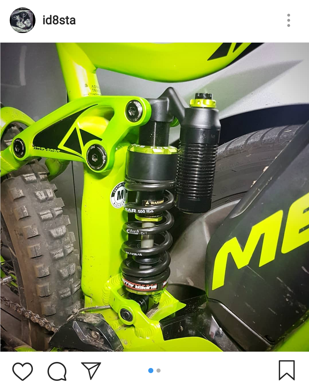

Everything but forks and drivetrain.
New bars, grips, stem, brakes (funny story), rotors, seat, dropper, cranks, wheels, shock, mode selector/shifter, fork guard, 1.5 angle headset and.... Pedals. But pedals don't count as they don't really come with proper pedals anyway.

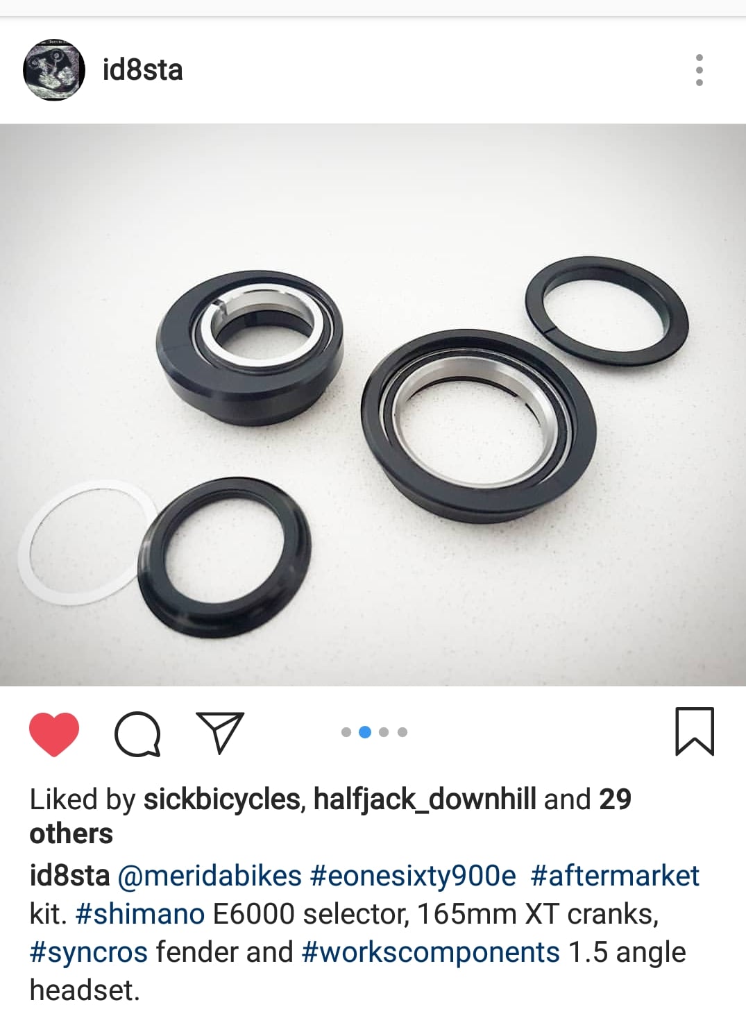

was thinking about an angle headset too, what make and size did you get?
drjarvis2003
Jul 4, 2018
320
141
glasgow
Cheers. Got the works headset and tried it out yesterday. Seems to help slightly but it's not a big difference. Running a 180mm lyrik on the front and measured head angle at 64 degrees now.

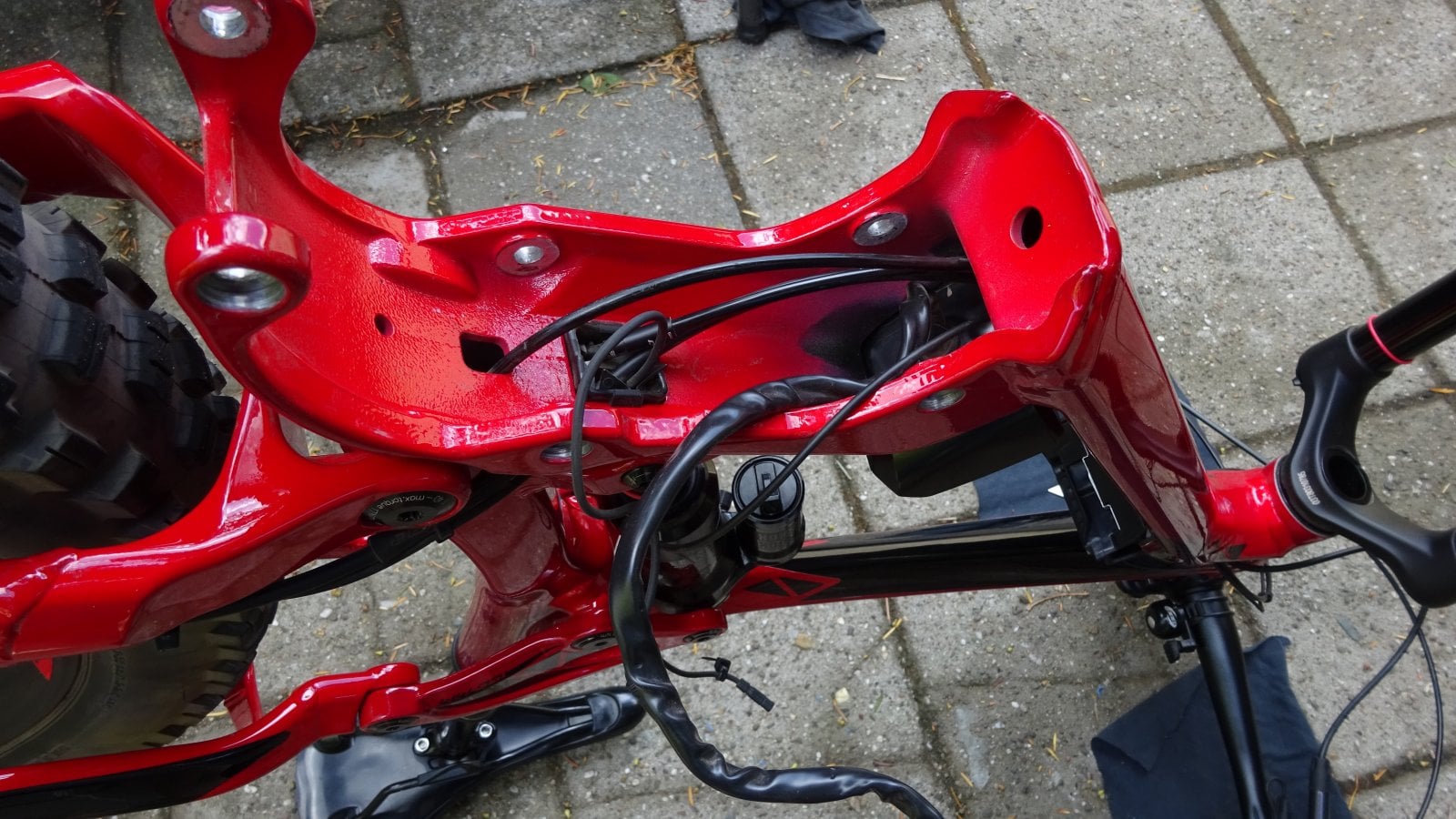

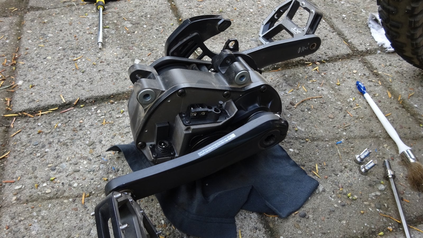

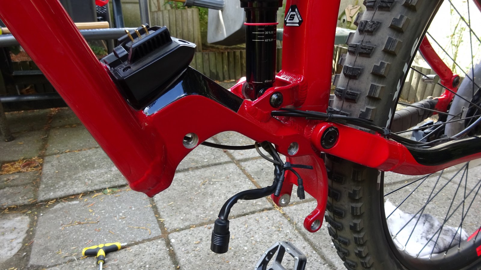

This weekend I took some time to work on the Merida.
Since I changed the XT to a gripshifter the cable was a little too short. But to get to the internal cables you have to take the motor off... :rolleyes: (I do like simple bikes, with simple solutions like external cables ;)).
And the motor removed...
I was surprised to see how little protection there is against dust or mud. The little plastic cover doesn't do very much, after only three rides (all in dry & dusty conditions) there already was a lot of dust on the electric connections.
After changing the cable (and putting the motor back on...) I also swapped the Minion on the rear for a Rekon and set up the tires tubeless. Oh, and in the proces ofcourse removed the ugly plastic disc :cool:

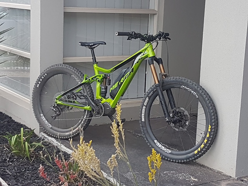

has anybody tried a 29 inch from wheel on a Merida yet?
Im thinking about a 30mm internal rim with Magic mary at 2.6.
Hey, I put a 29er up front on my Merida eOne-Sixty 900e. Love it. Only used the original wheel 20Kms from the store to my home.
It was immediately changed at home to a DT Swiss HX1501 Hybrid 29er with 30mm internal width with a Maxxis Minnion DHF 2.5 3C. Have been using it for almost a month now and I really feel that the behaviour of the bike is perfect like this. All my friends that tried it like this thought the same, 29er up front is perfect and makes the bike really agile and faster descending.
I also put the Canyon eBike seat post, very confortable and good for climbing and also put on softer green fabric grips. Other than that it's stock.
