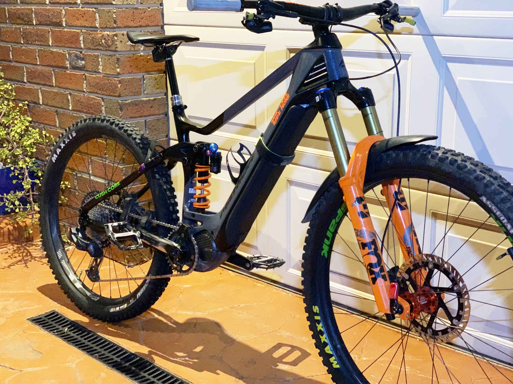

Hi All.
My Merida e160 900e has a Large size frame. I'm 6' 3" and 120kg.
When I first started this mtb journey, I don't think the "bike fit" was all that important. Nor body attitude on the bike. I was generally a passenger everywhere on the trails going downhill and just using the motor to tractor up hills.
But now my riding skills are progressing. And when I get in the "ready" position going downhill, pump over humps, get ready to lift the front wheel, or stand up to pedal etc my hand position seems too low. It's a real stretch to the bars and I can often feel too much of my body weight has transferred into the handlebar.
I think fitting a 29" wheel to the front would be helpful. Would this be the case? Are there any other considerations to convert the bike to a mullet?
Good advice appreciated.

Hi
Had the same bike and size l'm 6ft tried 29 inch perhaps better d/h, but steep inclines horrible couldn't keep front wheel on the ground , l fitted stem extender not convinced in that fit either, Have you ridden xlarge ? .
My bike was stolen recently purchased e160 9000xl which are mullet but the whole geometry is different, and i dont feel as crowded on it, but yet to ride the super steep stuff .
But IMHO not as nice a bike , mainly missing di2 and that stupid headset internal wiring , wish l could buy new 900e
Good luck

That's a good point about weight over the front wheel when climbing. There is one short sharp steep section where I have been riding and the front wheel already bobs to the point it must be very near lift-off.

How about a riser handlebar? 40-50mm would give you what you're after?
Yes - that is certainly an option. I'm studying bike fit and geometry now.
I came across the RAD and RAAD (Lee Likes Bikes) topic recently. Using AutoCAD I've drawn my frame and candidate SQLabs cockpit parts (stem, spacers and handlebar) to get to a supposedly near perfect RAD = 840mm and RAAD = 59 degrees. Then I came to realise that half the population seems to support the RAD & RAAD method; the other half doesn't!

If you feel like you have too much weight on the bars, both a high rise bar (or just moving spacers under the stem if you have any left) or a 29" front wheel will help raise the front and reduce the weight on there. The advantage of 29" is that you also get all the other benefits, slacker head angle and better roll over, so I would go with that option, particularly as it makes your bike more inkeeping with modern trends.

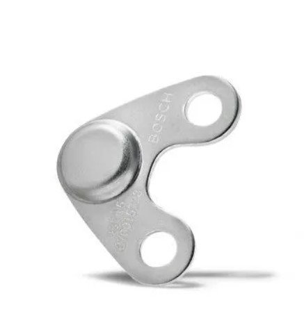

Has anyone upgraded the wheels on the 2021 e160? How did you fit the magnet to 6 bolt rotor hubs? My e160 has centre lock hubs with the magnet as part of the rotor (I think).
Is there a magnet that would fit onto the 6 bolt hubs (like hope fortus)? I've seem magnets for the levo, would they work? I'm not sure about the spacing.

Hey mate, i have the same issue. I had to get a new rear wheel and ended up with one that needed a 6 bolt rotor hub with a bosch magnet sensor but doesn't really reach the receiver attached to the frame. seems i need 40mm from centre of hub. Have moved over with only 1 bolt attached but it skims on the caliper ffs!. How did you go with the Magura set up?

I bought this, works perfectly:

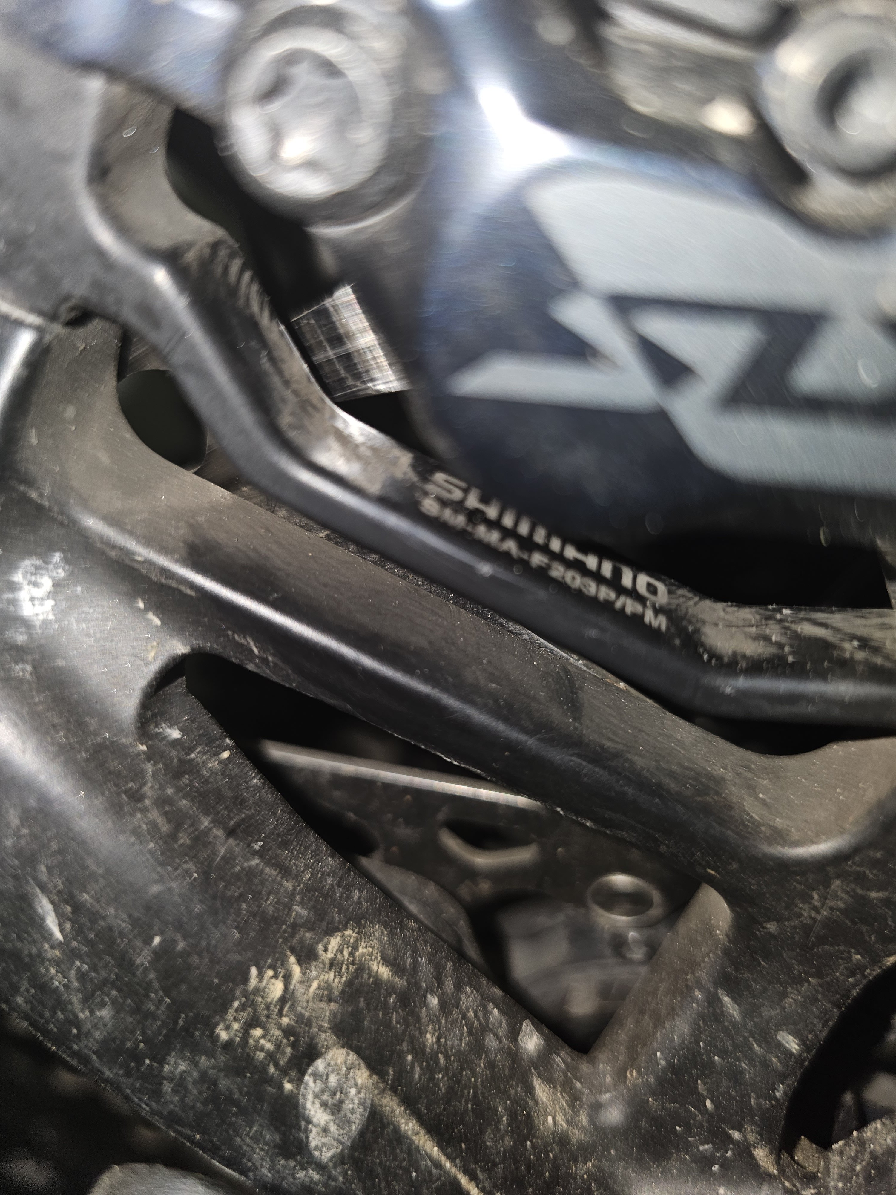

Does anyone know what rear brake rotor adapter they run on the e160? I am looking to upgrade from the stock rear size 200mm to a 220mm rotor (already have 6 bolt wheels, etc) just not near the bike for a while and wanted to get something ordered today. I am pretty sure it has a 180-203 adapter from stock and I need a 180-220 adapter just need to confirm.

203 on mine. 2021 model

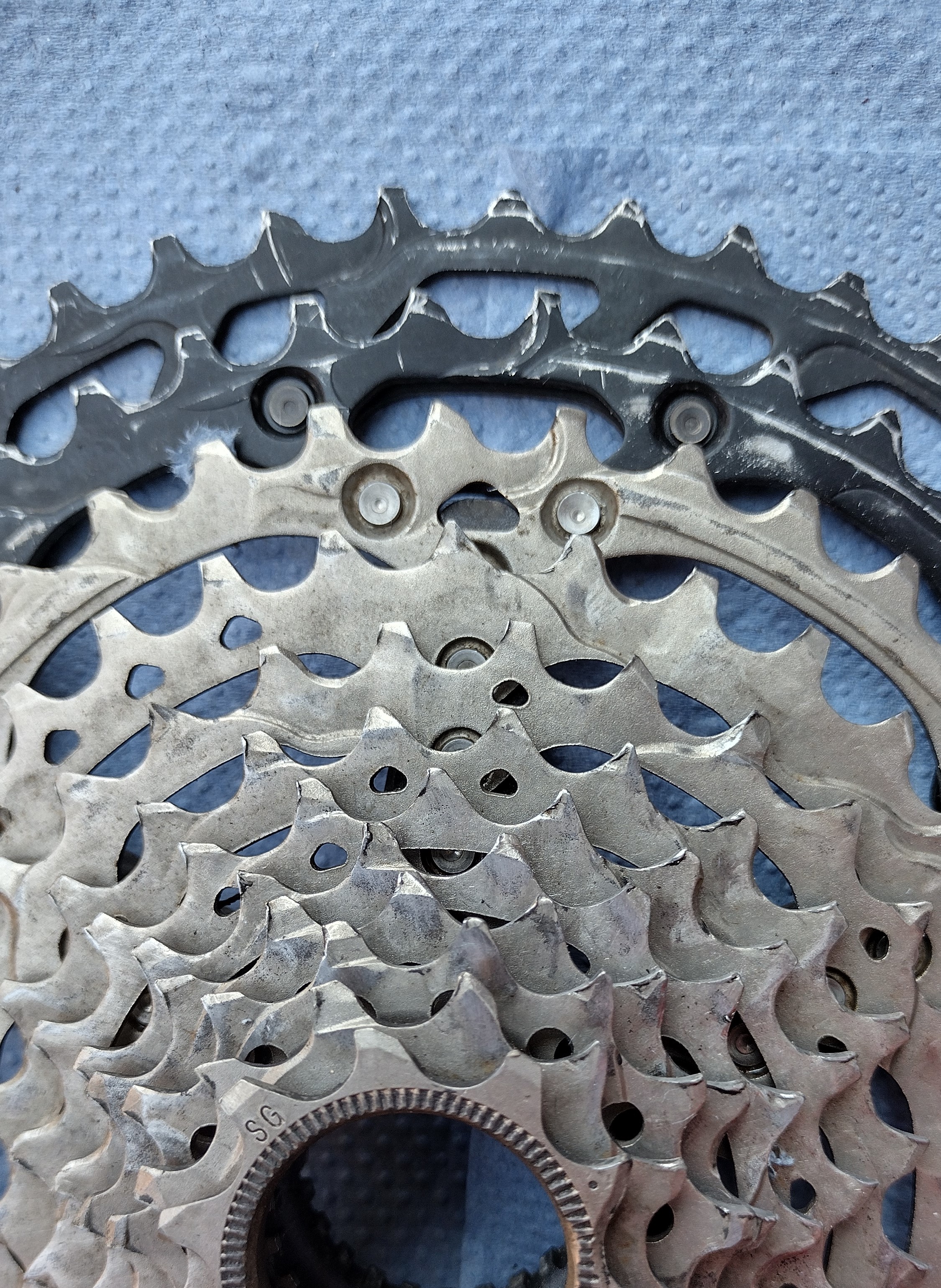

Yesterday my 12s chain snapped. One of the outer links peeled apart and off it went. I was lucky that there was no damage to the mech or any other part of the bike. Fixed trailside with a new power link. This has prompted me to get on with the transmission refurb.
The cassette had done 2273 miles, I had tried to put a new chain at 1789m, but it wouldn't run on the cassette without slipping. At that time, I had bits of two old chains that weren't too badly worn just damaged and too short to use, so I made up one whole one and used that! It ran perfectly well, no shifting problems and no skipping. I put the KMC-X12 chain back in its box where I could find it again (I still had to hunt for it!) While it was fresh in my mind, I bought a new cassette, same as the old one, Shimano XT. But I knew that one day I would have to replace the lot. I was expecting the chainring to need replacing too, hence the questions above earlier this week.
Today I changed the cassette and chain. No problems, easy job.
I removed the new power link I used yesterday and put that in the bag with three other new power links. I removed the two old power links also on the chain and put them in a bag for giving away to those stranded by the trailside, also a short length of old 12s chain, ditto.
The chainring is steel and is showing no signs of wear other than scuffing to the black finish. There are no signs of shark finning, extended wear to the root of the teeth, and no burring. Significantly, it ran perfectly well with the new chain, but that was out on the street. It will have a proper test next time I'm out on the trail. I am amazed at its condition and I hope it passes the trail test as that will save me £55. :)
While I'm on the topic of chain tooth wear, I thought you might like to see a comparison of the old and new cassettes. I have lined them up in the same orientation for ease of comparison. The old cassette had a tooth missing on the 45t ring (not shown), but it seemed to run ok, never noticed a dodgy shift. Maybe I was just lucky?
There is a lot of burring to the 9 smallest gears. Numbers 2-7 are worn so badly that they are pointed! It's only when you get up close that you can really see the wear and the burrs. I know that a worn chain damages everything it runs with and I remain astonished that the chainring has survived relatively intact.
