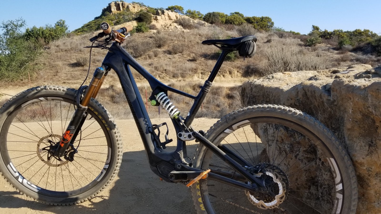

All you SL owners with the Jade X shock. Couple of questions:
(1) I am an (OLD) trail rider, technical stuff, not too fast anymore, I dont jump more than a foot. Do I need the cascade linkage?
(b) can someone post a pic of the shock on the bike, I thought I saw one, but cant find it now...
thanks alot.
Cascade link will help with progression. Ie you can set it up to avoid harsh bottom outs without having to run a stiffer spring rate , making it harsher on the chatter.
it’s worth it if you are going coil

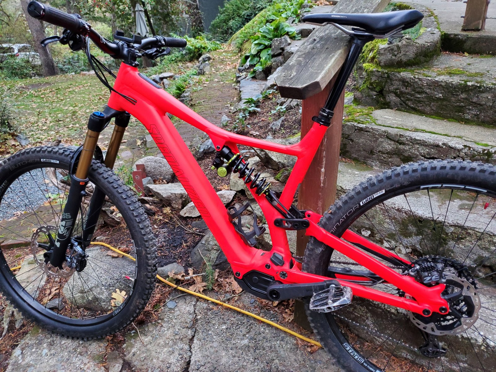

I just got an SL comp about a week ago, took to bike park yesterday, a buddy let me borrow his RS super deluxe most of the day (from FF Levo), whoa--transformed the rear suspension in a big way vs. little air shock that came on the bike.
My question to anyone who reads this and has upgraded their SL to coil, which ones can accommodate a water bottle without the piggy back getting in the way? RS super deluxe and normal size waterbottle don't play well.
Seems like DVO Jade X might give good clearance (no pics here with waterbottle!)
Anyone tried a Fox coil? DHX2 or other?

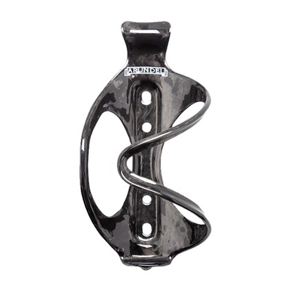

I've mounted and ridden fox x2, dhx2, bomber, dvo air. pretty much all needed a different cage that sits lower on bike. the Arundel carbon cage is what I use.
p3eps
Dec 14, 2019
1,987
2,410
This one?
I don’t own a Range Extender, but may get one in the future. Wondering if this would work with the strap?

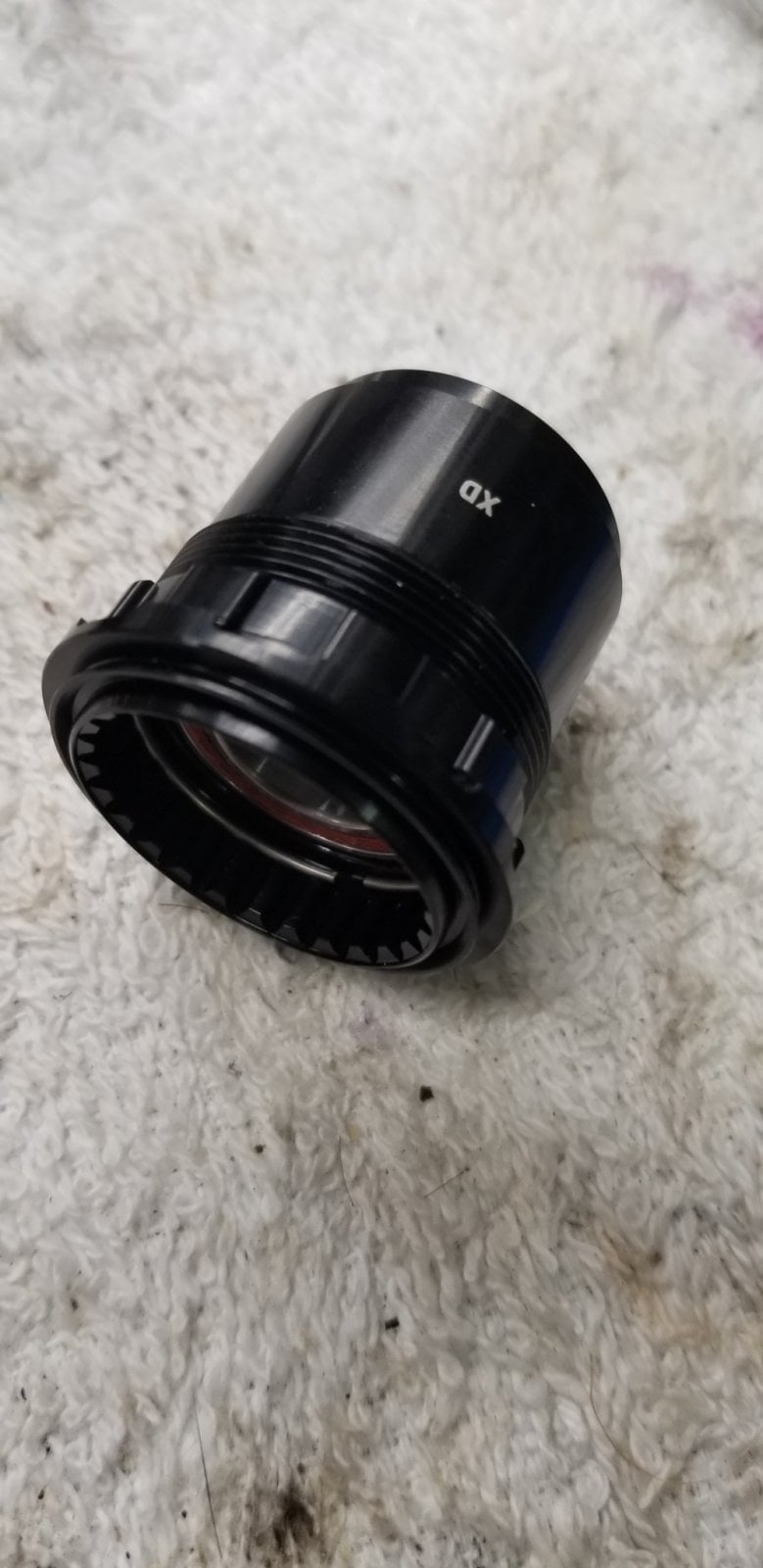

Seperate question, size large SL comp, maximum seatpost insertion length? I've tried to call Specialized Rider support 3 times in last week, sent 3 emails, crickets on their end, Covid message says everyone isolating...limited full specs on their site, best I can figure is stock post overall length 438mm but no breakdown on insertable length, want a post I can slam to post clamp.
Also no information on "specialized" rear hub specs, comes HG driver with boat anchor NX 12 speed cassette, want to change to XD driver, tried to disassemble rear hub but need 12mm hex and maybe 14mm hex to get HG freehub body off best I can figure, have DT swiss XD freehub body in-hand

This one?
yes, that's the one. it works with the range extender. only issue being cord is closer to plug in so it doesn't sit in the cable groove on the battery. not a big deal considering how much better the shocks are. I ended up keeping the bomber cr coil on my sl comp. 170 fox 36 fork, and running it mullet style. I like to go downhill ?
I am running a Storia and there is a bit of interference with a water bottle, but the bottle just kinda sits to the side. I cant imagine its doing any damage. I run it like this all the time and have not had any issues.

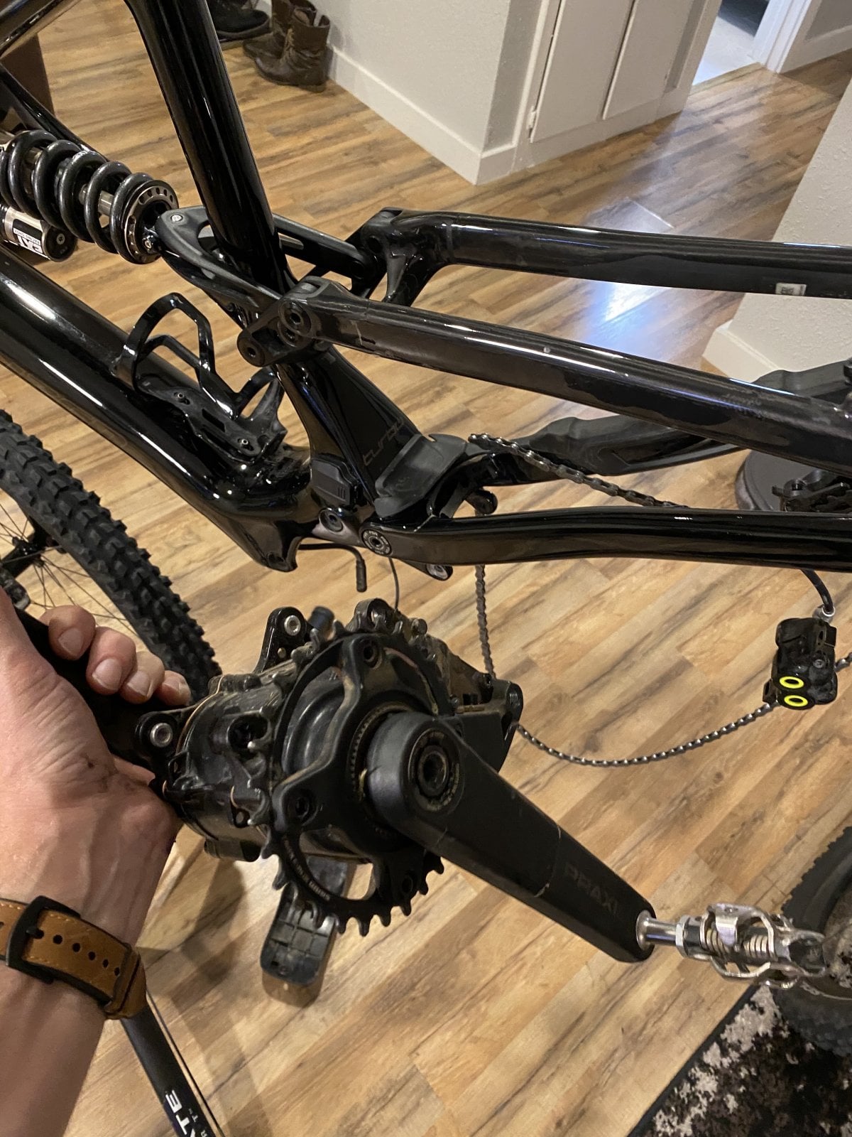

I've been chasing a squeak on my sl comp for awhile now. Greased all my pivots etc. Turns out it was my offset bushing causing my frame to contact my bomber cr coil shock. Noticed rubbing on shock. Bummed I can't use the bushing but glad that noise is gone!
So I figured out what was making my "creaky door hinge opened slowly" sound.
I pulled the motor and unbolted the main pivots. When I was cleaning the inside of the pivots, I noticed the sound again. I thought to myself, "well thats strange since the pivots making the noise are not pivoting". Started to look at the other pivots, but quickly realized its actually the internal cable guides rubbing together. I guess they are made out of a somewhat sticky plastic, and in my bike they were crossed over each other and making the sound I was hearing. I wrapped the guides in the area going through the back of the frame into the chain stays, and voila, no noise. Put the pivots back together and was hearing noise higher up in the travel, turns out the cable guides crossed back across each other as they went up the seat tube. Wrapped those up too and now there is no noise!
Unfortunately I have been hearing a faint clicking while pedaling hard. I am regreasing everything now and hoping it is not an issue developing in the motor. I have been riding it for several intense rides with the sound and it happens whether the motor is on or not, so I am hoping its just from all the dry dust from around here working its way in.
I have also had a lot of noise coming from the rear axle area, that is always cured by a simple removing of the rear wheel and a light greasing of the dropouts/axle threads. Just another thing to look for for noise.

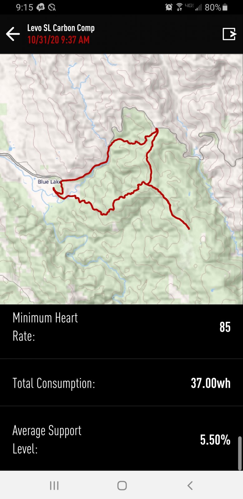

So I rode 33 miles, 4:42 hours, climbed 4,040 ft., consumed 37 watt hours, and my average support level was 5.5 %. Battery went from 80% down to 74%. I road mostly unassisted and when assisted (steep climbs) in Eco mode set at 25-35%. Is there a math wiz here to tell me how far I can go and how much climbing I can do at this rate?
Was it difficult to drop the motor?
