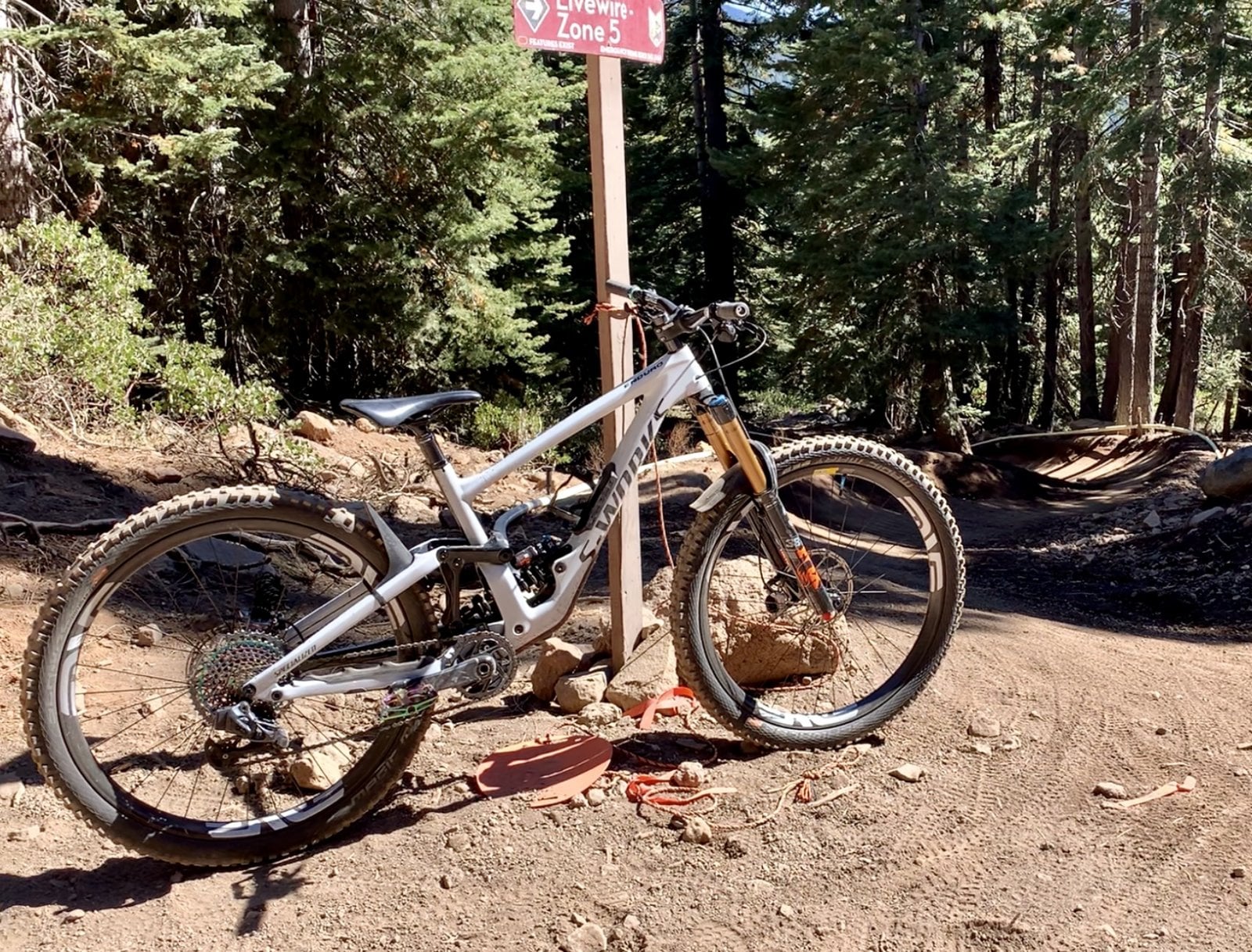

Going to try out my 170mm fox 38 and see how it goes. Normally i run a 160mm fox 38. Rear has a 210x55 X2
I hope you'll report back how it rides with the Fox 38 vs your normal 36. I'm trying to decide between the 160mm Fox 36 and the 160mm Zeb ... but perhaps I should consider the Fox 38. And if anyone else has any thoughts on the matter, please let me know. For reference, I like to ride to ride the steep/rooty trails here in the PNW, so definitely want to upgrade from the Fox 34 I currently have. Thx!

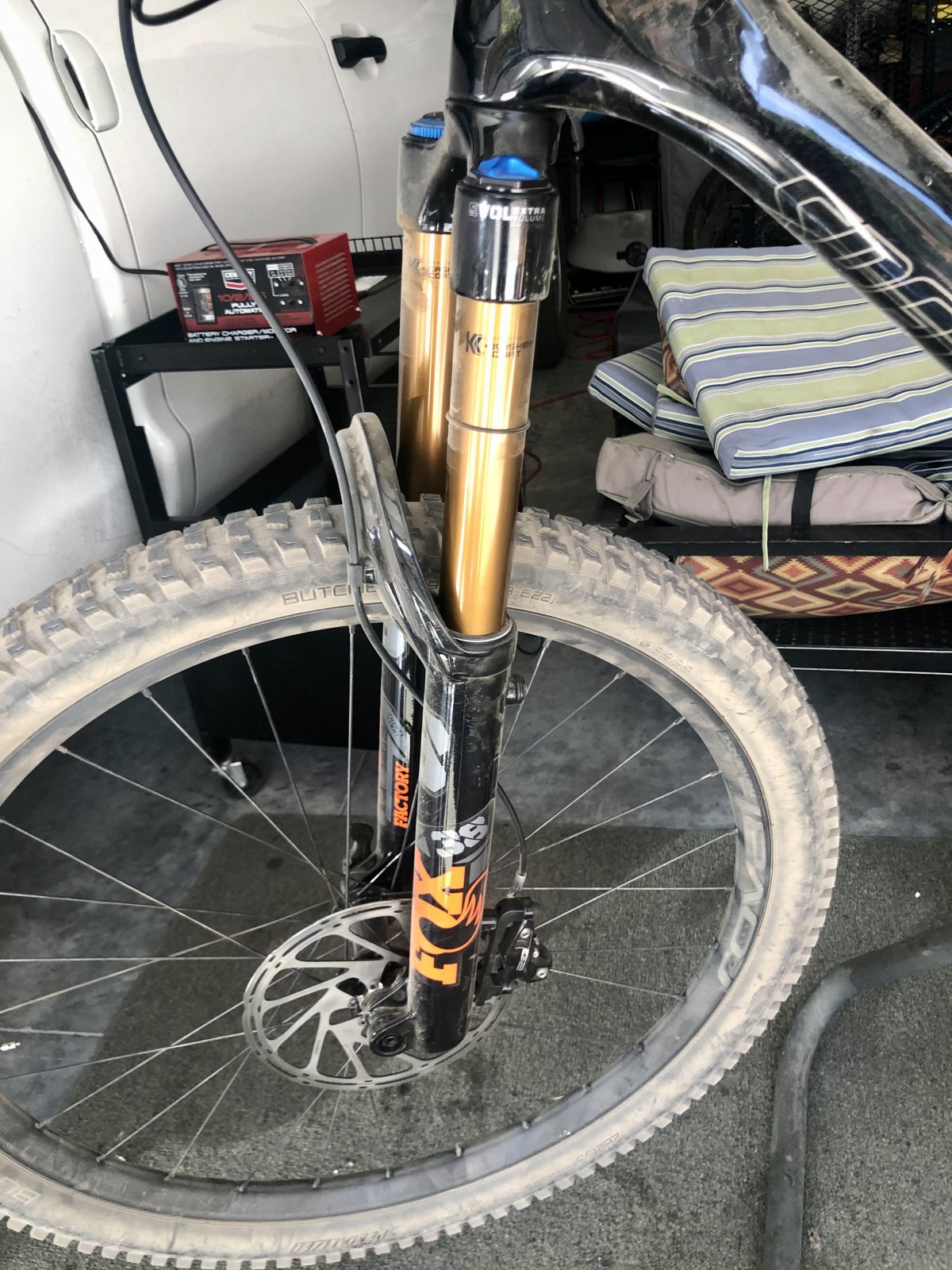

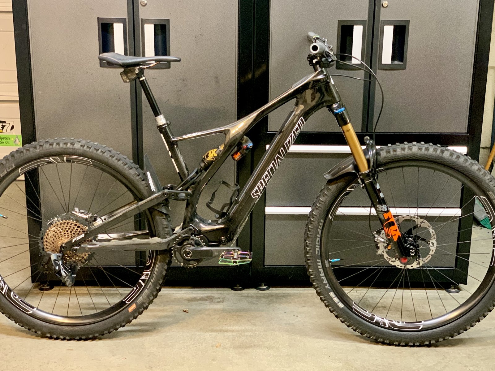

First ride on the new Fox 38, 160mm / 51mm offset. I ride in AZ, CO and UT. Kitted up I weigh 205 pounds and ride an XL Levo sl.
The 34 for me wasn’t even in the picture as I had ridden a demo with the 34 and I actually thought that it was scary having such a flimsy fork on a bike that weighs as much as this. I put on my old Rockshox Yari(burlier fork) the minute I got the new sl and it handled much better but it still didn’t inspire confidence going down mtns or on technical rocky terrain.
Fast forward a couple of months. The new 38 came in a couple of days ago. After the first ride all i can say is.... OMG !!! ?
For me the 38 literally transformed the ride and handling of the bike and I don’t even have the fork dialed in yet. The cornering, braking and handling are all better and I haven’t even mentioned how well the fork just soaks up big rock hits. If there is anything I worry about down the road is if the stock rear shock can keep up with this new 38. I guess only time will tell.
For bigger guys on the fence about purchasing a 38 don’t wait. It wasn’t easy finding a 160mm 51mm 38 in stock. I wanted the 51mm offset to keep the handling like stock and I wanted good handling in slow technical situations.
I apologize if I sound like a shill for Fox but this fork is that good...

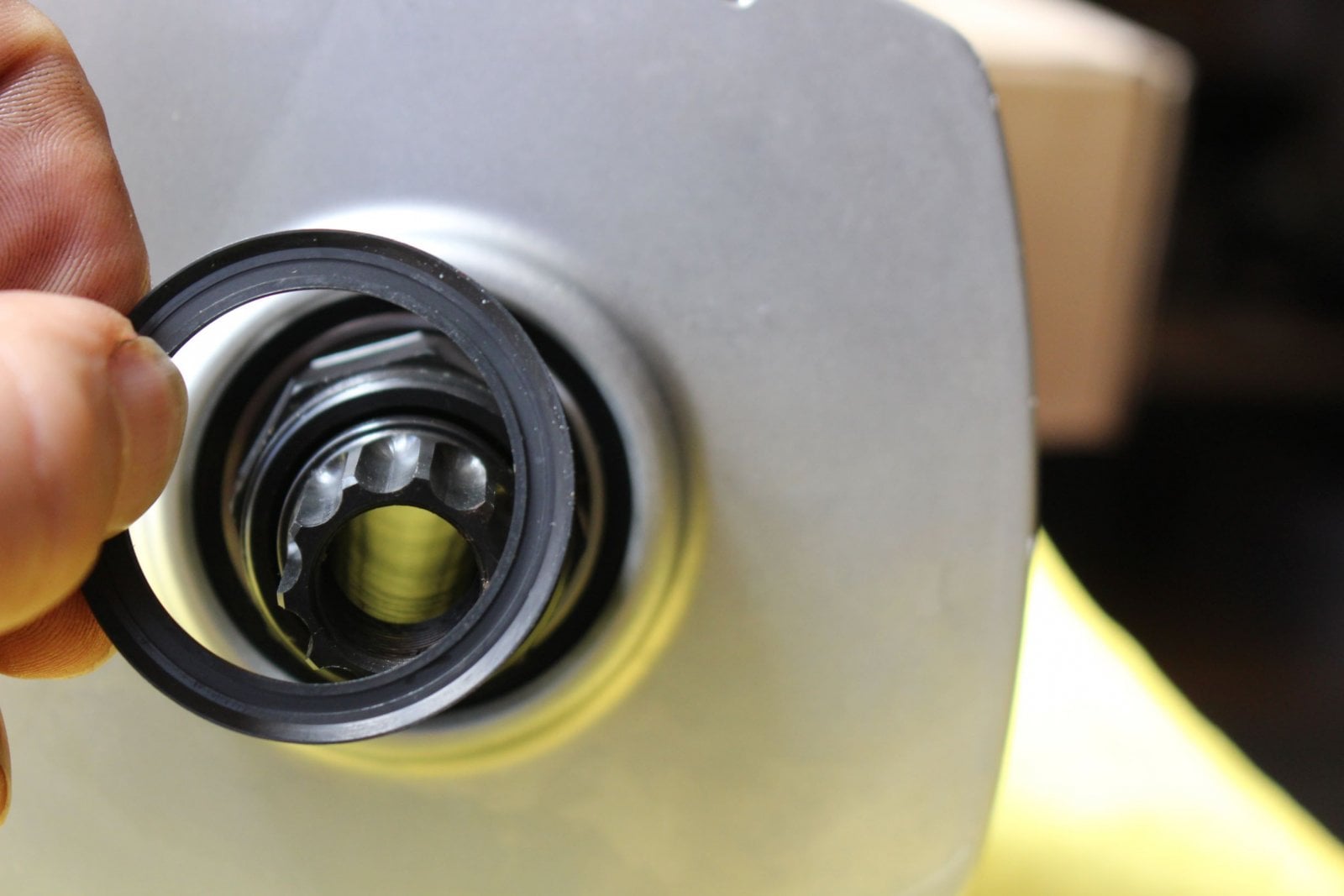

I have this squeak. I removed the cranks / spider and spun the motor by hand, in the stand. Definitely a squeaky seal or something in the motor itself. Is there anyway to lube or fix this issue myself? It only does it pedaling with the motor off, but I like to turn the motor off when overtaking bikers and hikers and now its squeak, squeak, like I have a bad bottom bracket. The bike is not even a month old.
Sorry I'm a bit late answering this one. The squeak is usually caused by the right hand crank bearing seal as in the pictures. If anyone has had the belt cover off, you will normally find this seal trapped underneath, but if this is not the case, get a little pick or the like, gently lift the seal and add a little waterproof grease if you have some. Then re-fit and enjoy the quiet.
“Belt cover”? On a SL? I have no problem gently working off the seal on the drive side and lubing it as long as I can get it off without doing damage. I’d like to see an exploded view of the motor first or other’s first hand experience, on the SL motor, before I begin.
SL! Doh!! ?‍♂️ Yeah, forget everything I just said. I should learn to read better :rolleyes:

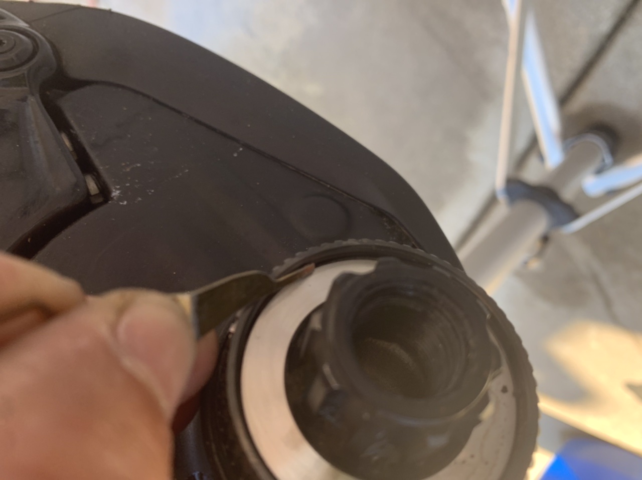

I got the squeak to stop by spraying silicon spray in at the point of the seal shown in the pic. This is drive side with the spider removed. I had to put the frame on it’s side and squirt a lot in there to clean out some dust and get the lube to wick under the seal a bit.
