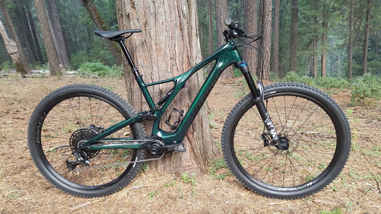

Yeah I was surprised the 2021 Comp Carbons have been out for a while. I was ready to buy a 2020 in Cast Berry when I saw a 2021 in dark green. I've had it for a couple of weeks. 20200917_074839.jpg
As far as I know the 2020 and 2021 are the same. Only colors and price tag are different, I paid $25US more.

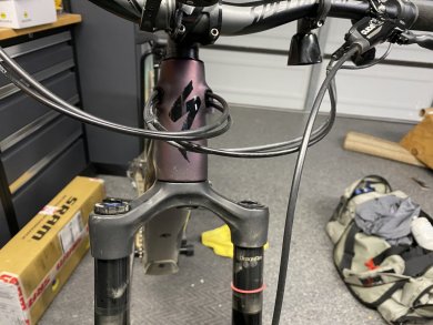

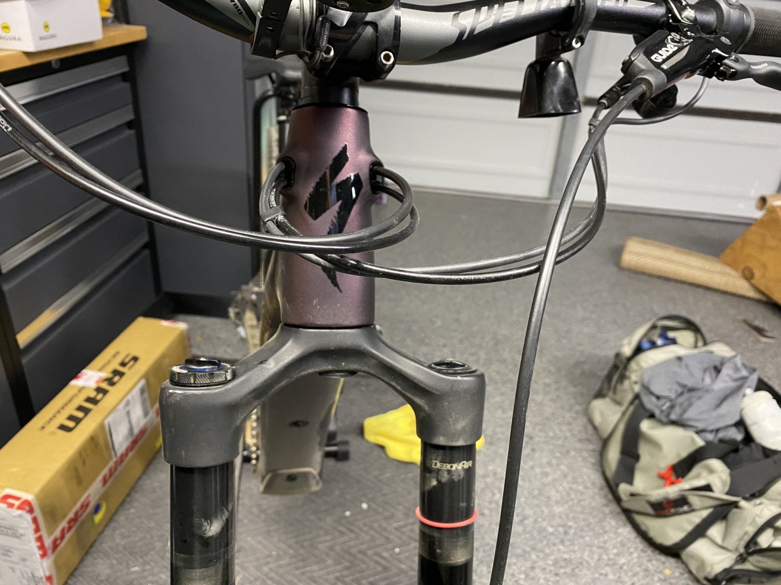

Question for the folks with the front brake on the left hand, how are your front cables routed? Mine are from top to bottom (facing bike): dropper, rear brake + shifter, speed remote thing, front brake. With this way, I can't tape the dropper and speed remote cable together because they straddle the middle 2 cables.
