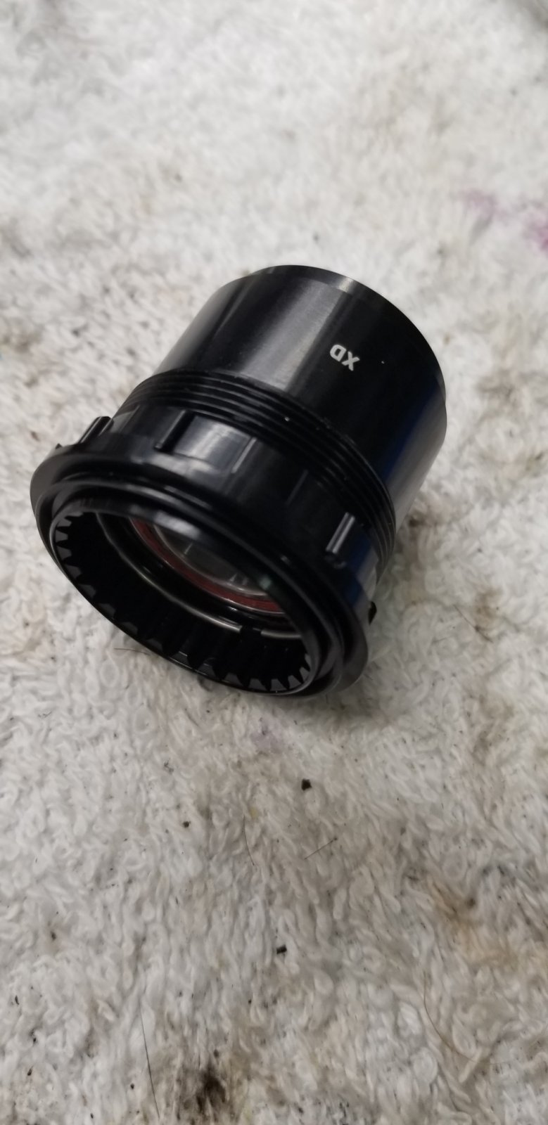

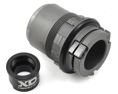

Seperate question, size large SL comp, maximum seatpost insertion length? I've tried to call Specialized Rider support 3 times in last week, sent 3 emails, crickets on their end, Covid message says everyone isolating...limited full specs on their site, best I can figure is stock post overall length 438mm but no breakdown on insertable length, want a post I can slam to post clamp.
Also no information on "specialized" rear hub specs, comes HG driver with boat anchor NX 12 speed cassette, want to change to XD driver, tried to disassemble rear hub but need 12mm hex and maybe 14mm hex to get HG freehub body off best I can figure, have DT swiss XD freehub body in-hand
Hi Squeegee,
You get 2 different Roval wheel sets;
Comp comes with Formula hubs (Transverse SL)
Expert get the DTswiss internals Hub. (Transverse SL)
You will require this part number to move to XDDriver on Formula Hubs, I actually got it from my Specialized dealer locally (in South Africa) I'm sure your store will keep them..
Specialized Formula XD Driver Freehub (11 Speed) (FH-535HA)
Part number : S162100006
LosiSA
Nov 17, 2020
20
13
South Africa
Hi Squeegee,
O and you will need a 15mm hex and 17mm cone wrench, easy enough to do.
LosiSA
Nov 17, 2020
20
13
South Africa
I tried this, too. But there is no compatible XD driver available. Speciialized rear hub is called DT 360, as they only label it with ROVAL. I bought DT360 PAWL driver, but this is too small, so that there is no interlock as the inner pawl are to small in diameter and the body does not fit the spacer of the HG body, too. Reply from LBS is no driver available to their knwoledge. I tried 3 different shops.. If you find something please let me know.

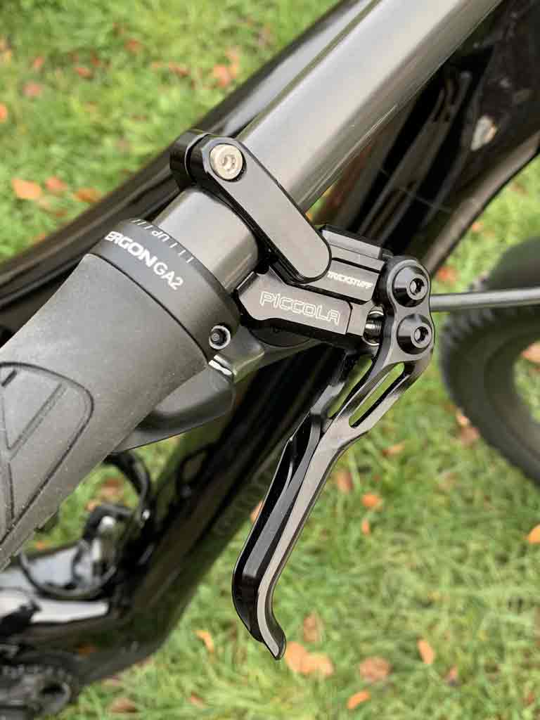

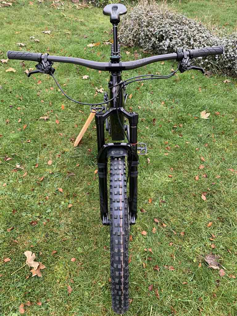

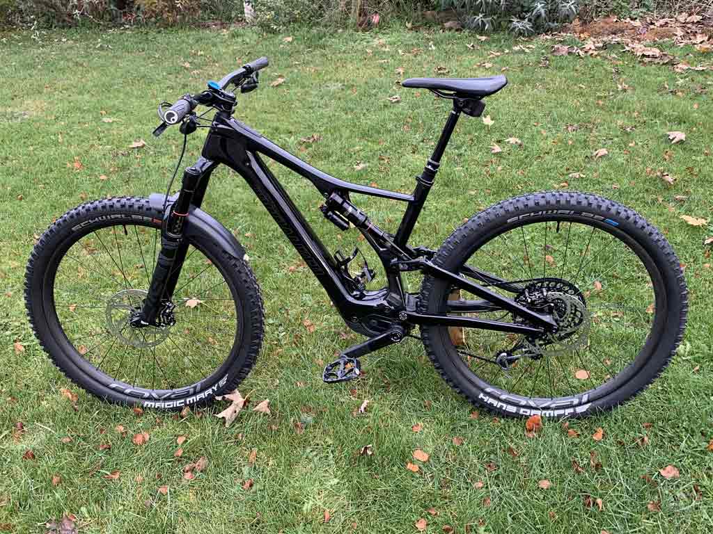

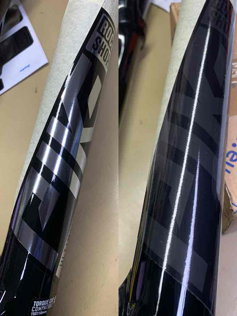

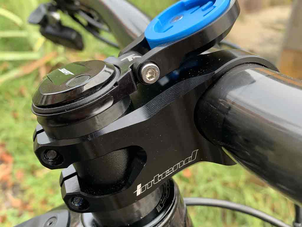

sonix
Oct 18, 2020
7

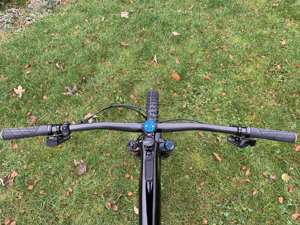

Hi,

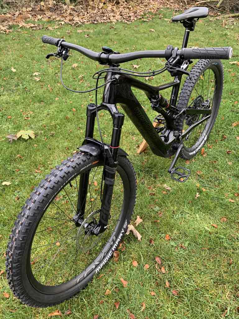

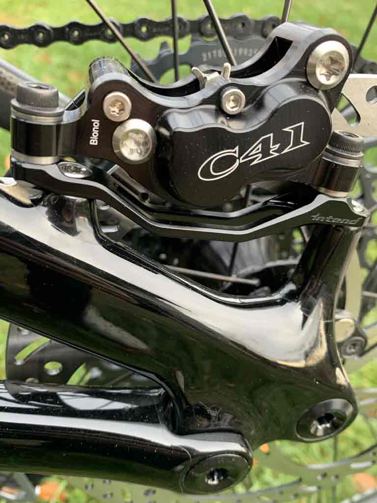

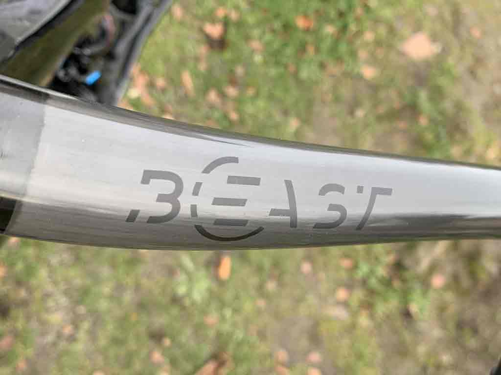

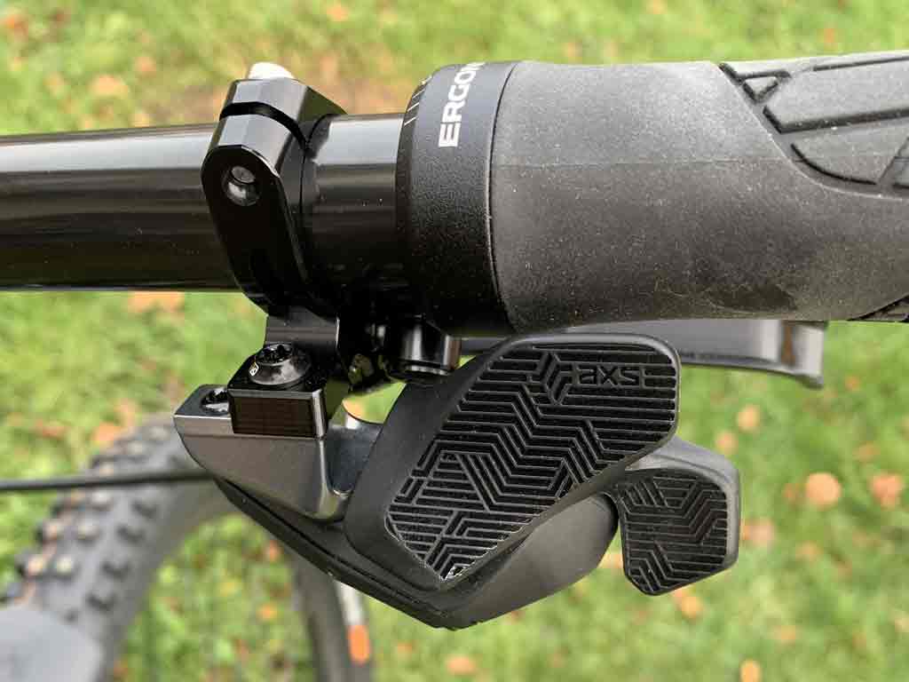

I had two days and my SL was rebuilt.
According to the motto, "Black is colorful enough" ...
the black beast :D
It was not that easy to get everything black, the silver decals of the Pike had to be removed and exchanged for stealth ...
and then that ugly silver scraper the reverb ...
the result...
and a few more details ...
The weight is now almost exactly 18 kg.
Now drive, adjust and test first.
cheers (y)
