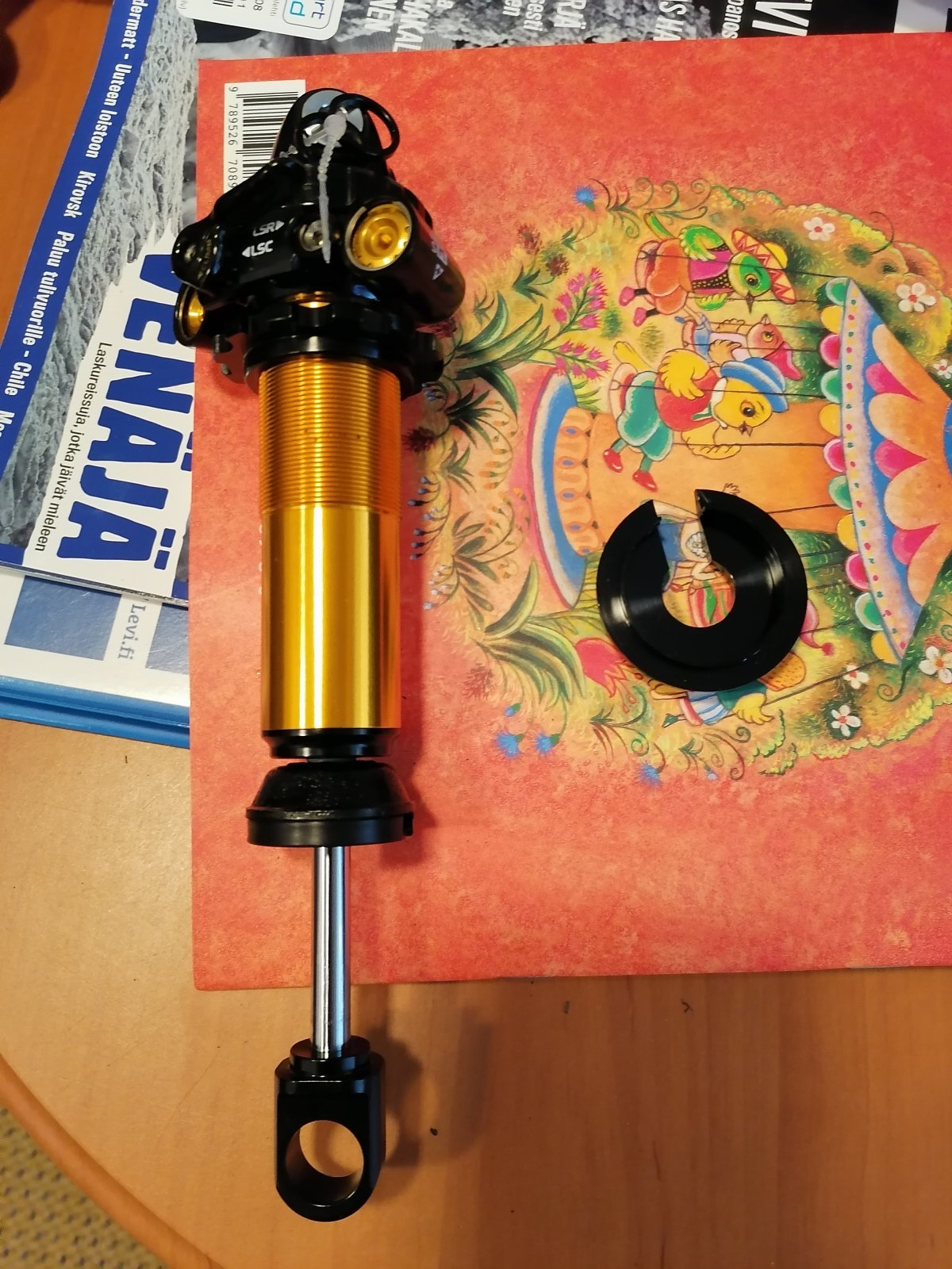

I am so glad the shock failure is being recognised. Cane creek really need to know this is happening. I am sure that Tftuned Will be Passing on their concerns.

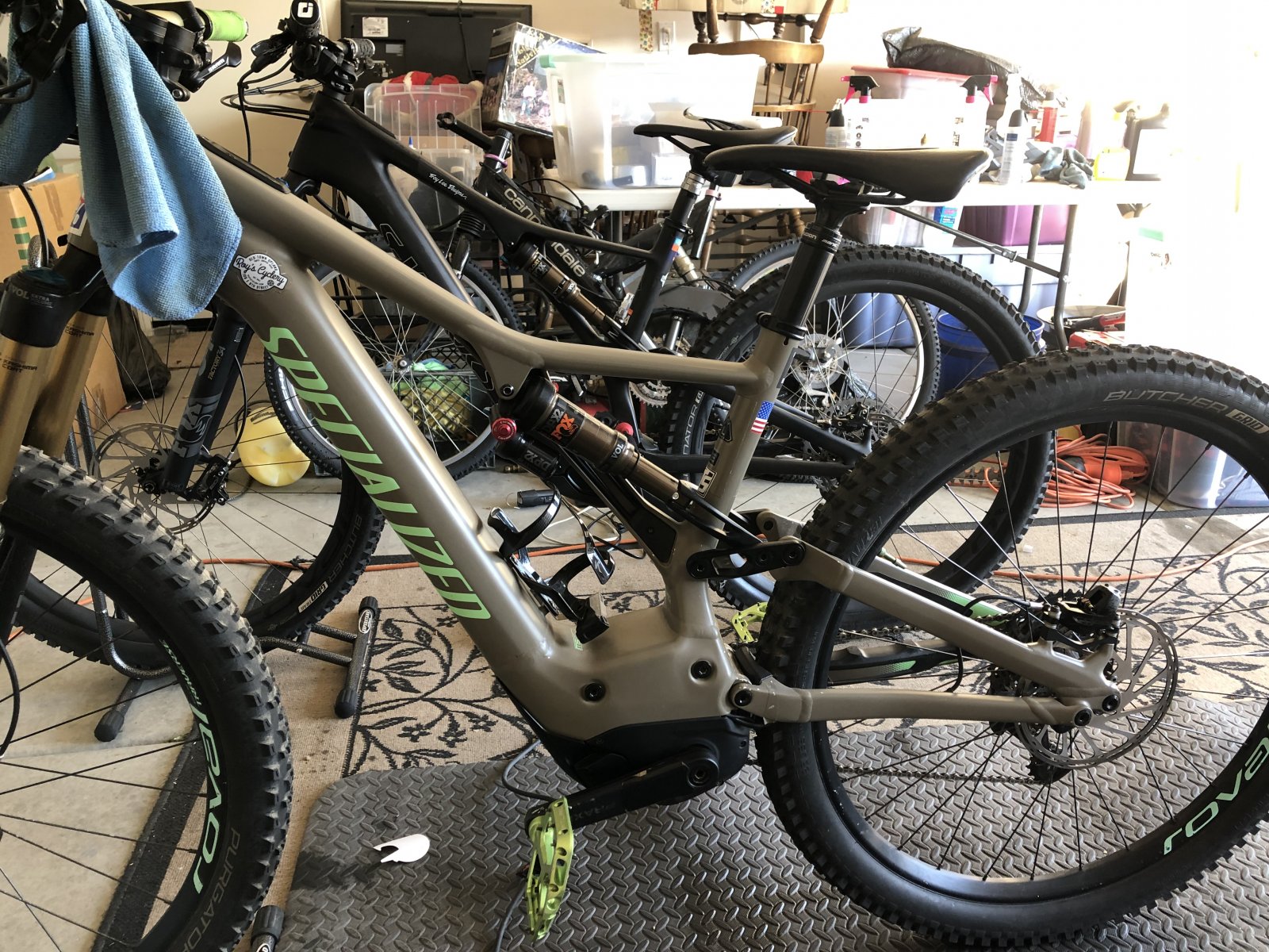

I think that I am "done" with my build:
In stock guise, the SL is a killer bike, as we are all aware. My goal was something that was a bit more aggressive due to my trails and riding style. For reference, I am riding everything I had been on my 2019 Kenevo (which was also modded to be a bit more aggressive) and previous Evil Insurgent. Modifications in no particular order:
Fork - Manitou Mezzer at 170mm
Wheels - Mercury Enduro X1 (~1725grams, 30mm internal) carbon
Shock - EXT Storia V3 with Cascade Component progressive link
Tires - Vittoria Mezzer 2.4 (Front), and Agarro 2.35 (rear) w/Cushcore XC
Brakes - Magura MT7 with 203/180mm rotors
Bars - Nukeproof Carbon V2 - 800mm
Cassette - e13 TRS 11-46 (340grams)
Grips - Rev grips for now
Saddle - Ergon Enduro (let's me slide the saddle fairly far fwd for a better pedaling position).
Misc - Offset bushing to slack the bike out (currently not on ,but will be putting it back)
All said - I think that i am close to 40lbs with pedals on the XL. Weight wasn't a priority overall, but I did feel a big improvement when I swapped wheels and cassette. Huge drop in rotating/unsprung mass there!
On the rear shock - just got that on this week and still dialing, but it's very apparent that it can take a beating. It's not "magic carpet" plush (i.e. what my Ohlins 180mm kenevo felt) as of yet, but I have a stiff spring on there right now, and a tight eyelet bushing fit that i am going to fix. That being said, it can take any hits and not feel hung up or jarring. Really well balance with the fork which was a big improvement as well.
I have trip to some bigger mountains in about a week which will be fun to push this bike to the limits. I already feel much faster than I did on any of my previous bikes.

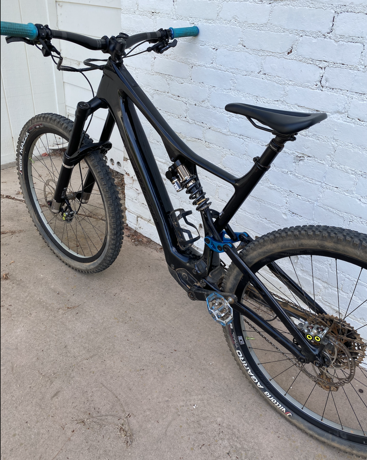

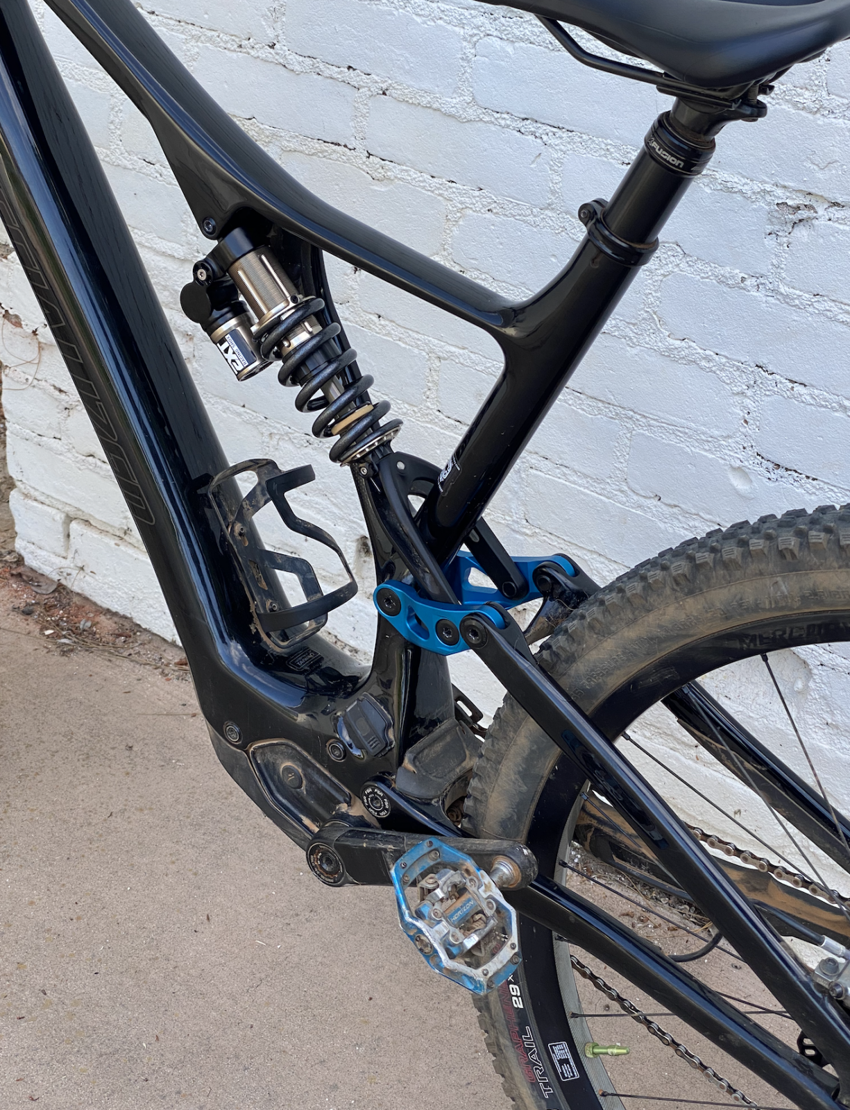

sweet build! I'm building my comp alum to handle more aggressive dh terrain too. 170 lyrik, cascade link, x2 210x 55 shock.
I have a topaz air shock now while I wait for the x2 and recieved my cascade components link a few days ago. bike feels plusher with link but not really noticing any improved progression. bike still seems to blow thru travel even with shock packed out with air volume spacers. got it set for 15mm sag. hoping x2 with compression adjustments will fix it.
u noticing improved shock progression with your link?

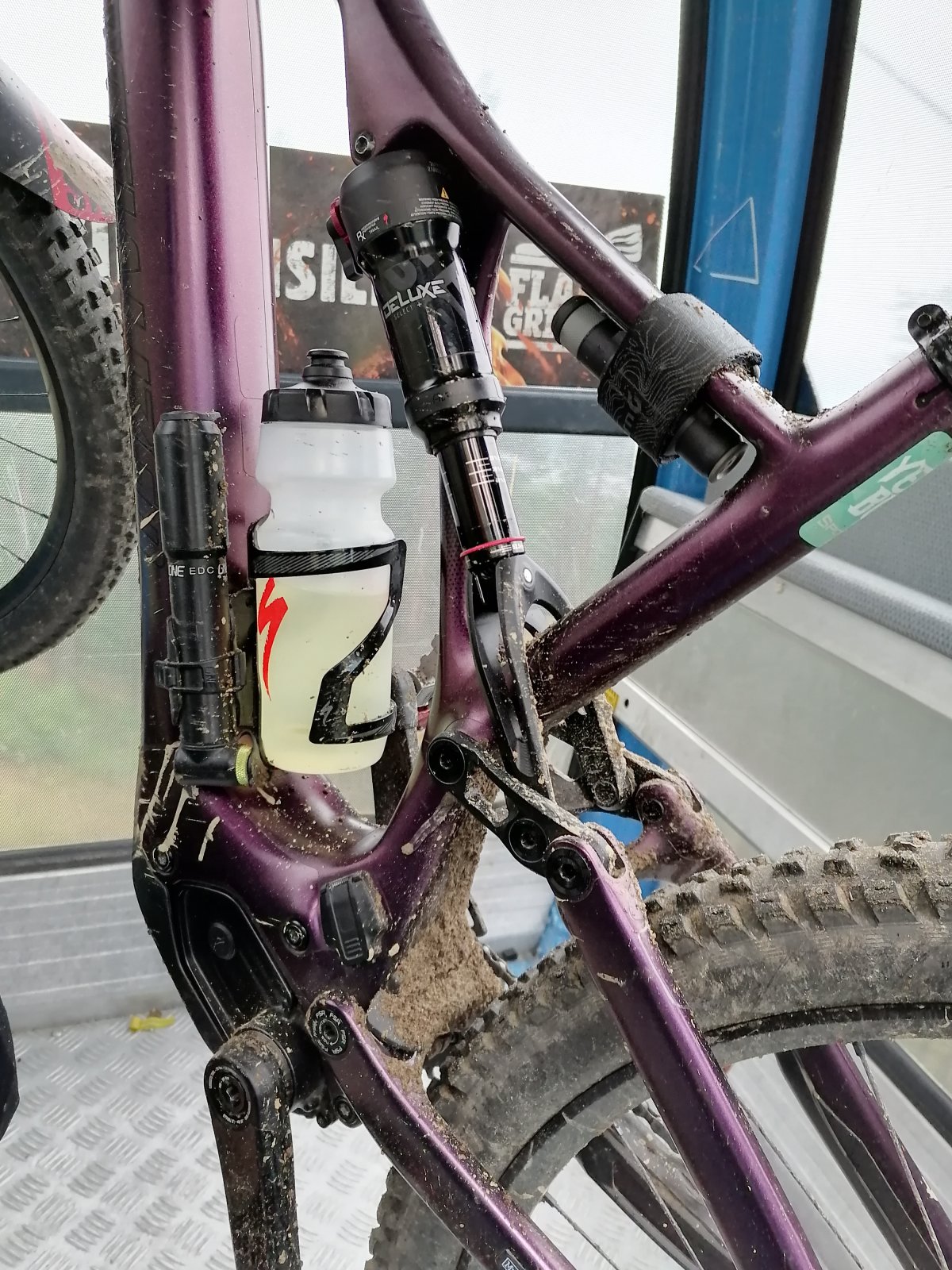

Can you fit a water bottle with that shock?
Did you run higher pressure than you did with the stock link? This link has a higher leverage rate overall with needs a greater spring rate (PSI for air shocks). I have only a quick ride on mine with the coil, but it definitely is not blowing through travel. Tough to judge though with this shock having an HBO.
When I ran the CC link with the stock air shock., I added about 10% PSI for roughly the same sag as the stock link. I found better small bump compliance and less harsh bottom outs
I'll give more psi a try. thank you!

What spring rate are you using and what do you weigh?
I am ~180lb -ish with gear. I am starting with the 600 lb/in coil, which feels a bit firm. Sag seems to be around 27% or so. On the one trail I have ridden it so far, it used maybe 2/3 travel, but I really only had one drop. I am riding a bike park tomorrow which should show me a bit more.
I have the 575lb to try as well.
