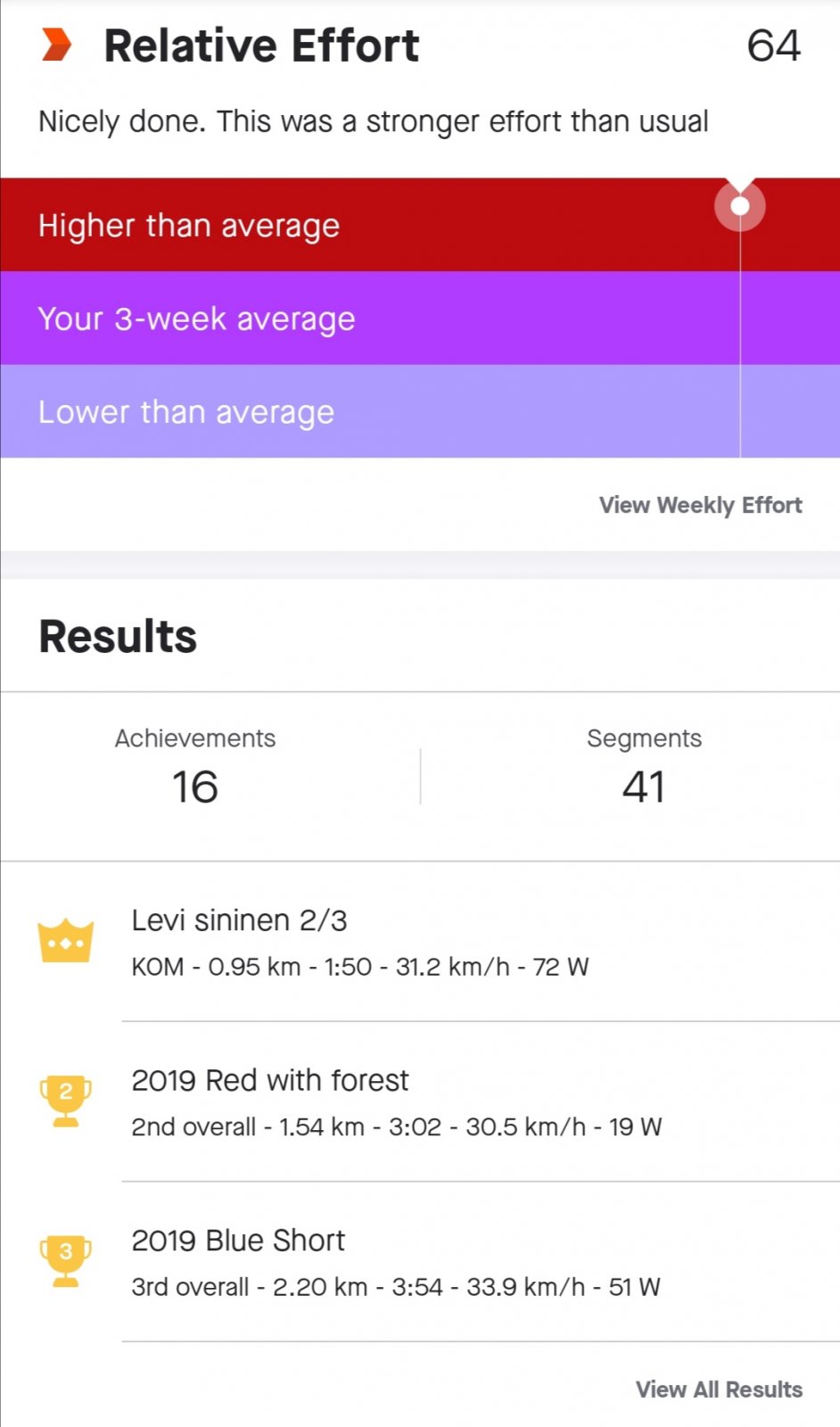

Tested today deluxe air shock. Total bullshit vs coil.

Air shock works ok.
