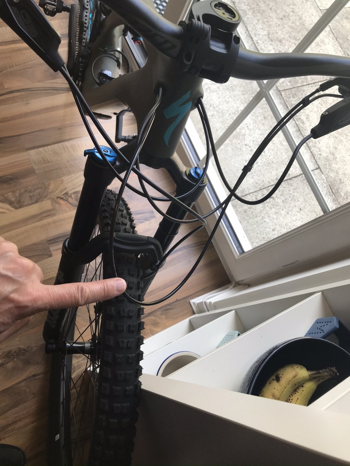

Cables and hoses .... I got my UK spec SL a few weeks ago and loving it. I am a wee bit disappointed at the nose and cable lengths as supplied and it’s going back to the lbs for some tweaks in a couple of weeks. I have the 150mm dropper pretty much as far into the seat tube as it will go, being a short arse 5ft 9.5 with a 30 inch inside leg. The dropper cable is a good 5-6 inches too long, with a huge loop out front. Similarly the rear brake hose is a few inches too long, while the front hose is definitely a bit short. Spinning the bars in the stand the front hose stops rotation way before anything else and would be a likely casualty in an off. Anyone else found this ? View attachment 33935
My cables are all over the place, too long, too short, weird routing...

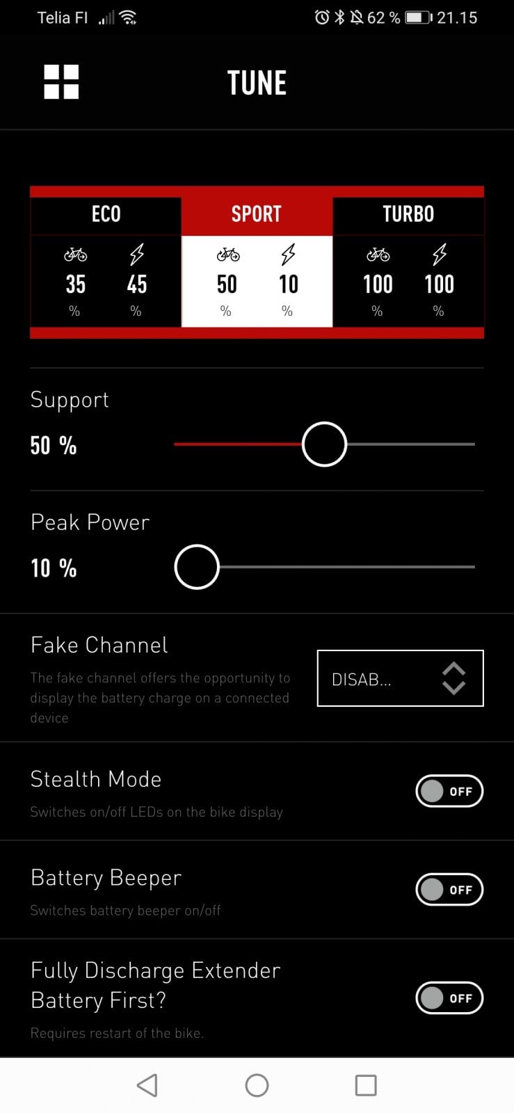

When we got the presentation from Specialized in South Africa they said that draining the RE first was not the optimal way of using the battery and there would be a significant drop off in power nearing the end of the RE's battery. Hence, don't do it.
Even on a standard Levo at 3-4 bars the power output is less as the Voltage drops from the battery.
The idea of using RE first is that if you have more than one, to use RE first and loop back and swap out for another. It's not recommended if your going to ride a normal loop with a RE to use that first, then switch to Main Battery. Go for dual discharge. You do need the Y lead to charge both.
Always go for dual discharge in MC if you have a single Range Extender plugged in.
Unless you're a machine I can't see a need to use 2 Range Extender's and the Main Battery, your're talking about a 50-60 mile loop and just swap the RE out when it drops if that's your bag. Rob and I rode and his discharge rate was almost identical to mine on the FF Levo.
@TomH Were both batteries fully charged? The software is smart and from what they said at the presentation it will balance them, but I would assume it needs them to be somewhere near equal to their full capacity or it might not handle the discharge of each efficiently. From what I remember of the talk they said with more than one Range Extender the logic should be in MC to use RE, RE, Main battery. Otherwise, with a RE and Battery, it was discharge both at the same time. That would imply, and I'm speculating, they all need to be at full capacity.
I hadn't thought about the physics, so good point.
My reason for using the drain-RE-first options are:
- For day-long rides it's easier to find somewhere to plug the RE to charge, so I favor draining the RE and saving the main battery
- To reduce overall charge cycles on the main battery
Even considering physics, the battery management could be better with the option to swap from RE to main battery at the point it would otherwise significantly restrict power. If that was 10-15% I'd be fine with that.
Until then, it sounds like draining both at once is the way to go, because my reasons for draining the RE first are not deal breakers.

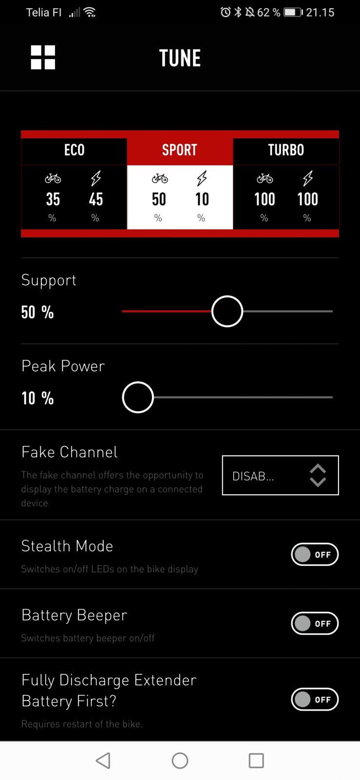

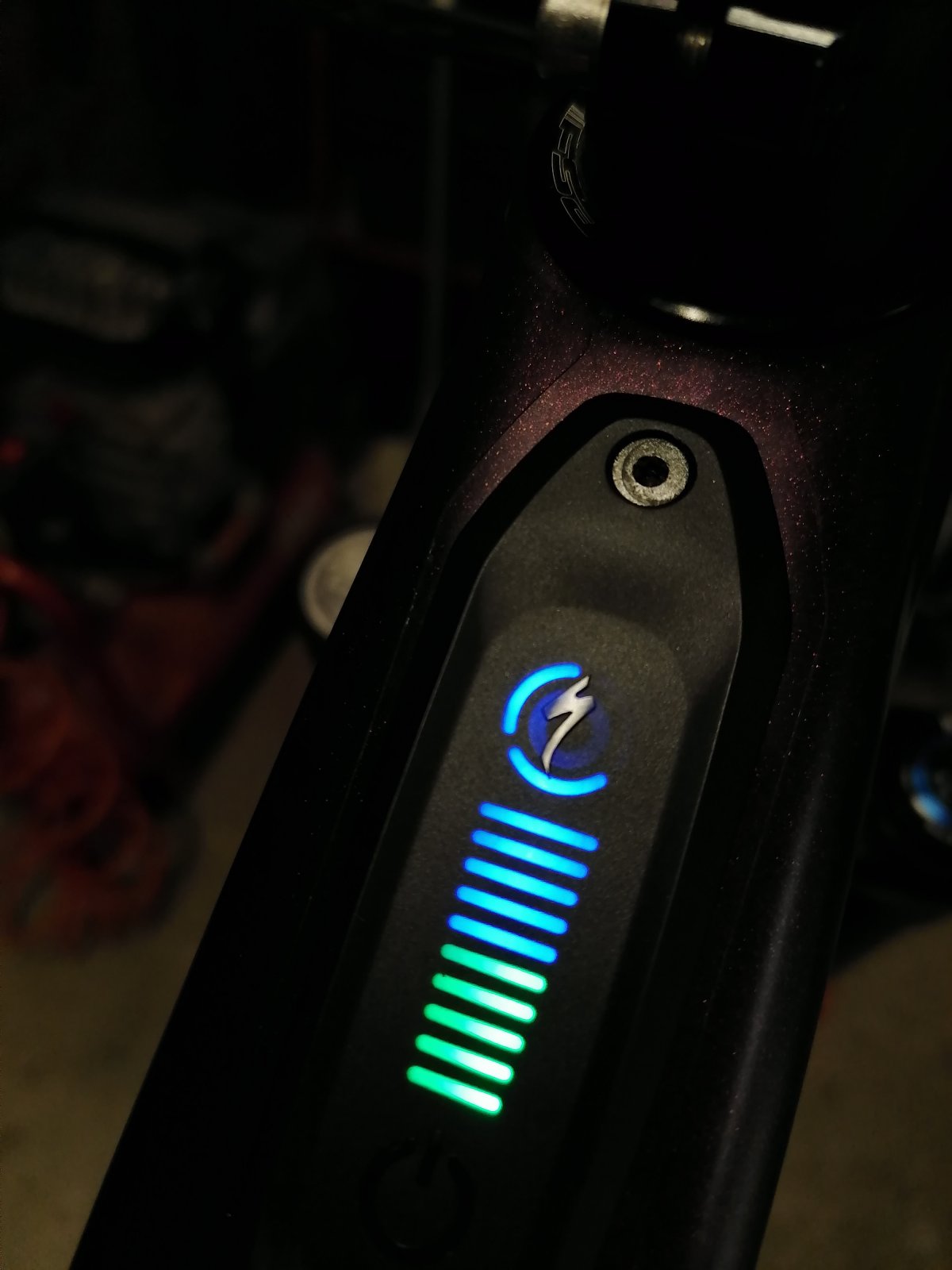

Fitted today the extender. Last time i used it was about 2 weeks ago.
Mc setting is like i use both main and entender at the same time.
Still when connecting it and power on, there 5 blue and 5 green bars in tcu. Tried to change it from mc but no change.
So went for a ride, and like assumed, bike died after extender was used. Needed to take the cable off from the bike to be able to ride again.
Anyone had this? I still wanna use both batteries at the same time.
Am i only to have this? It worked normally 2 weeks ago showing only blue lights when re was connected.
What has changed?

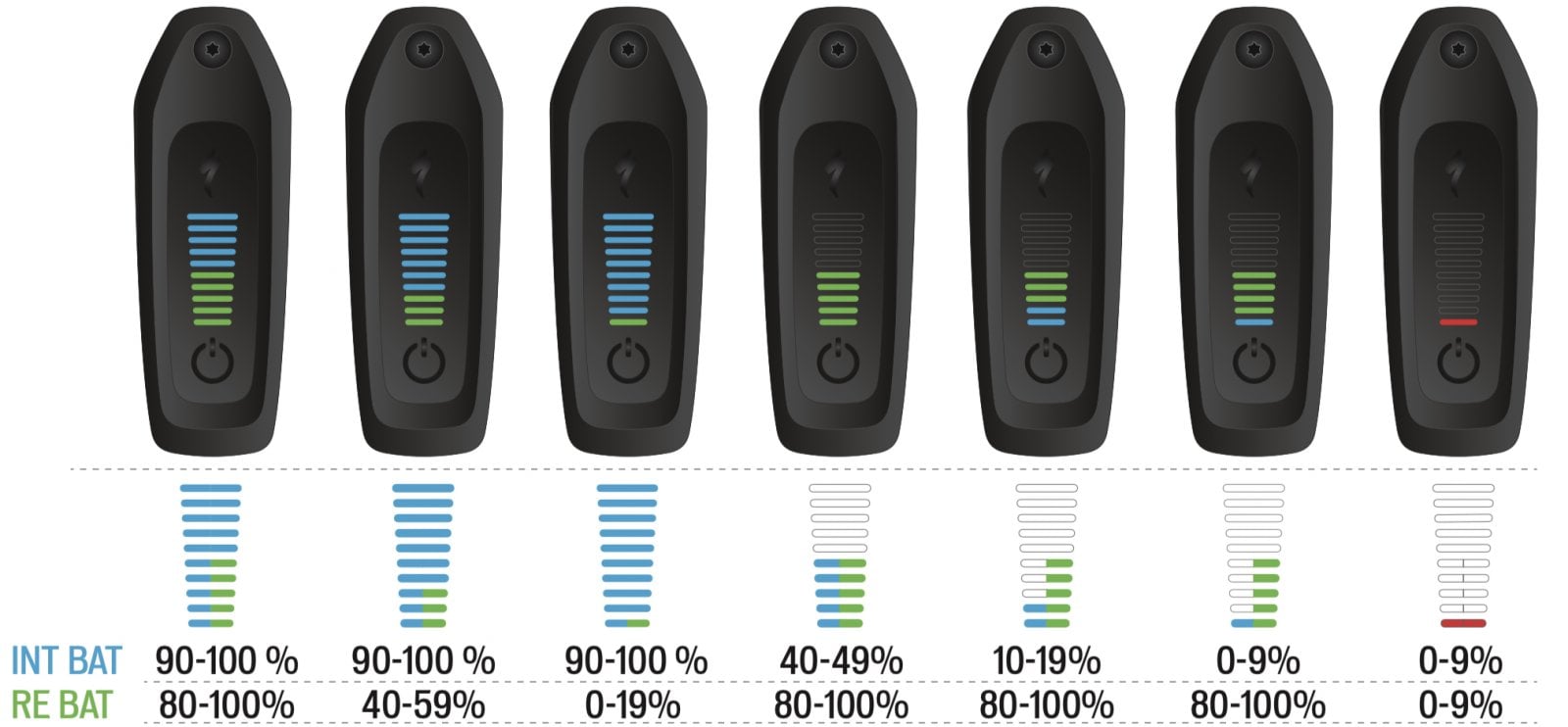

What has changed?
When both batteries are full, it should have 5 blue and 5 green lights. Only when the RE is empty, every light should be blue.
Yes when you use it like you wanna drain the re first. But when using both at the same time there use to be only blue leds.
Now it only works like draining re first=bike dies after it is empty and cord needs to be took away.
Pretty sure on mine the bars look the same however you are drawing down the power.
