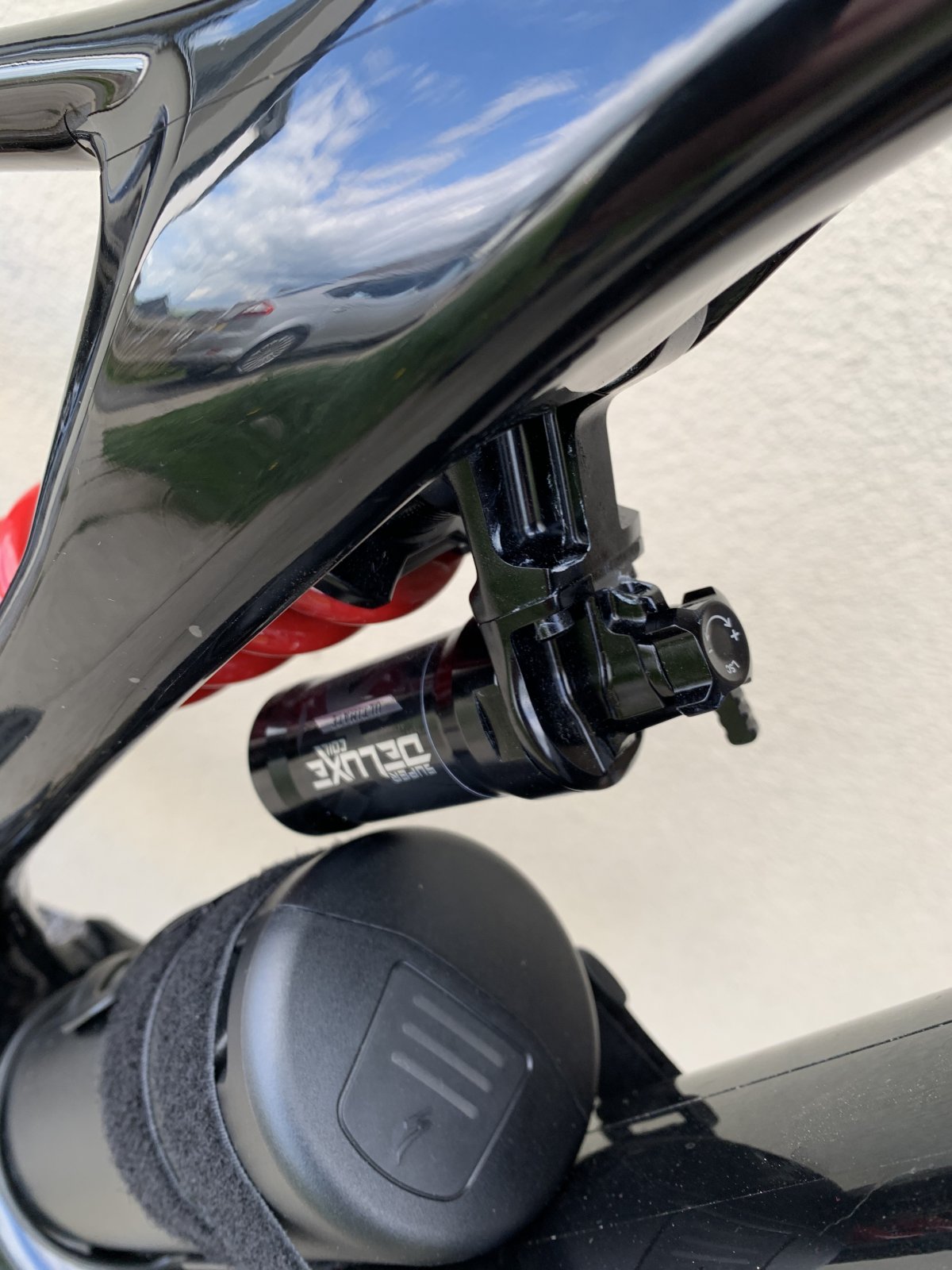

Has anyone tried fitting a Rockshox Super Deluxe Ultimate on the rear?
I’ve always preferred Rockshox over Fox, and feel like I’d like something slightly more adjustable than stock.
Just wondering if it’d fit... and should I be getting 210 x 52.5 like the stock Fox?
The only one I can find says it’s for a Stumpjumper - but 27.5.
Would that be right?

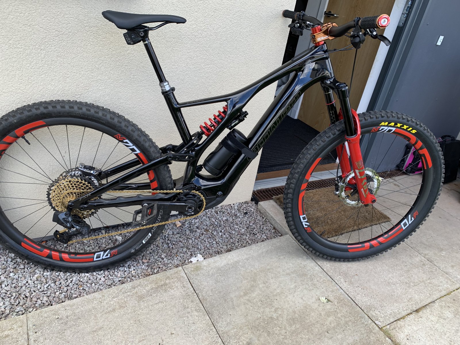

Dann that a lot of money for a none coil shock .
not sure if you seen my bike and update but my rock shox super deluxe ultimate coil fits my frame with range extender with a few mm spare . This is only for large or extra large frames only as this wouldn’t fit a medium or lower with extender fitted .I also had to take the 2 black plastic washers off the inside of the cage and put them both together and put them on the outside of the cage on bottom to bring the slant of the cage up at the the bottom and Down at the top so the piggy back don’t hit the battery . Also my shock is 210x55 and 160mm lyriks .
I can get it cheaper than that. That was just a site that listed all the specs.
I’ve never used a coil, so not sure what benefit it would have for me over air?
Might be worth me looking into that, as the coil version of the Super Deluxe isn’t really any more expensive than the air.
I just feel that the stock Fox fork doesn’t offer enough low speed adjustment, and no matter how I set it, it’s not comfortable for trail riding.
Seems good for fast single track and downhill, but it’s very ‘bouncy’ on bumpy slower trails.
Good to see that the piggyback fits ok. My frame is XL, so it should be ok too.
Does fitting a 55 instead of a 52.5 not increase your travel?

A coil will give you improved small bump sensitivity, the closest air shock I've ridden to that feeling is a Float X2, but will be heavier and has a linear feeling (unless you get one of those adjustable rate springs). Fitting a 55mm stroke will increase the travel, though I don't know specifically by how much for a Levo SL.
So a coil will save my back end bouncing so much when I’m riding on trails with small bumps?
The DPS performance doesn’t have much in the way of adjustability for this. I thought a shock like the Super Deluxe Ultimate RCT would give me the ability to tune it to my liking as it has LSC and LSR settings.
I was always under the impression a coil added extra weight, and needed to be set up by a specialist? Probably because I know nothing about them!

Yes, a coil will give you a much more 'glued down' feeling to the back end, when set up correctly. The trick with any coil shock is to get the correct spring rate, from there you tune it the same as any other shock. This is where air shocks have an advantage, as they give you the ability to tune the spring rate to very precise figures, whereas with a coil you are using the closest spring rate you can fit. The payoff here is that a coil has less interfaces to cause friction, therefore you get the increased small bump sensitivity and that 'glued down' feel. In short, once you have the correct spring rate and tune, a coil shock will give you much better compliance on rough trails, but it will be heavier than an air shock. If you buy from somewhere like TF Tuned, they will tune the shock for you and your bike, before posting it out.
yes it increases the travel . Not by much .
And I agree with the stock shock being to plush on slow stuff . You should have no problems with XL frame .
