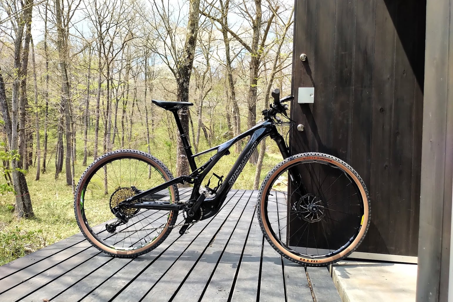

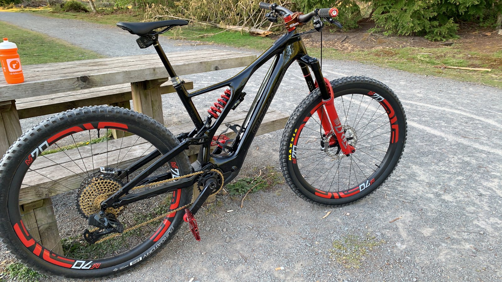

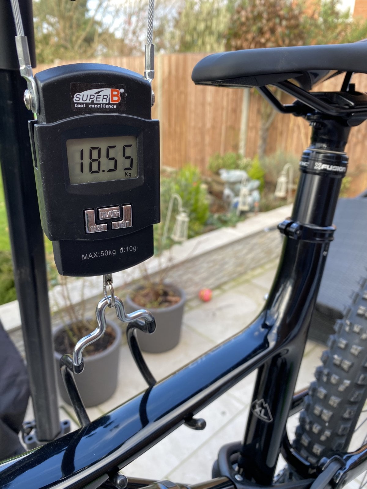

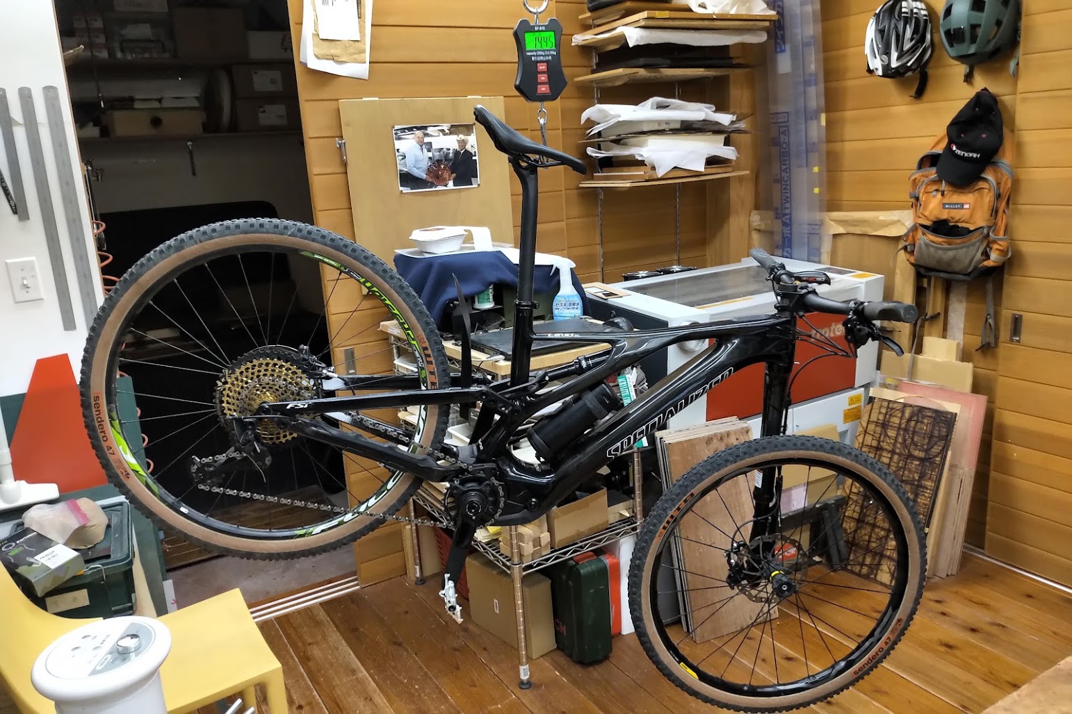

Picked up mine (long term loaner) today in Comp Carbon spec.
Out of the crate weight, tubed, no pedals in size XL:
Thanks, always enjoy your Youtube program, I swapped in the Lefty Ocho and 27.5" wheels, removed the main battery and made it a range extender only and got 14.45kg! XC built is another way to enjoy E-MTB, I believe!
9,190
Really like that build, because I can see why you have gone for the parts you have, rather than just try and make the build as light as possible at the expense of ride ability. Top work
Thank you for your comment. Do you live in Surrey? I also lived in Farnham around 2002, Small world!

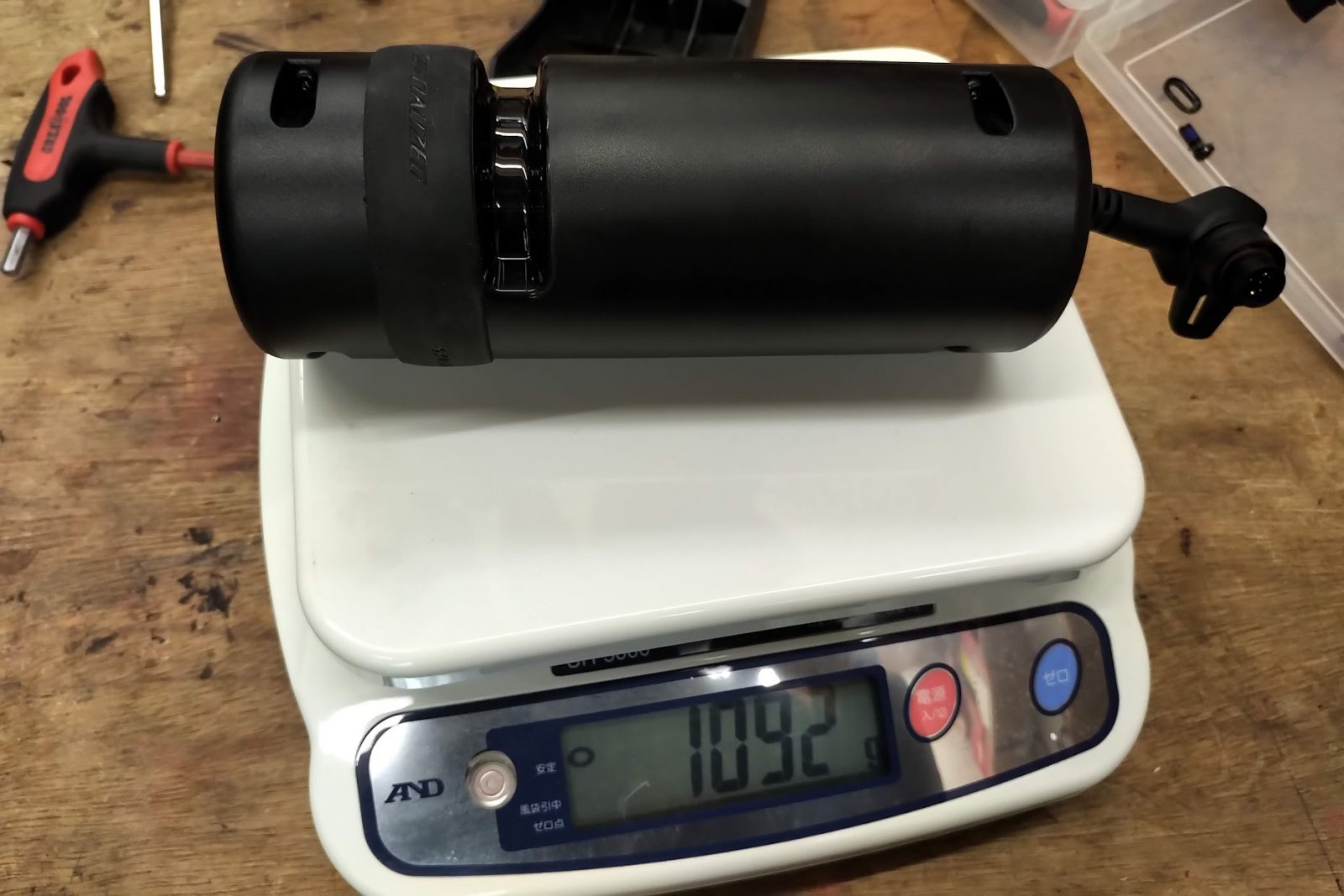

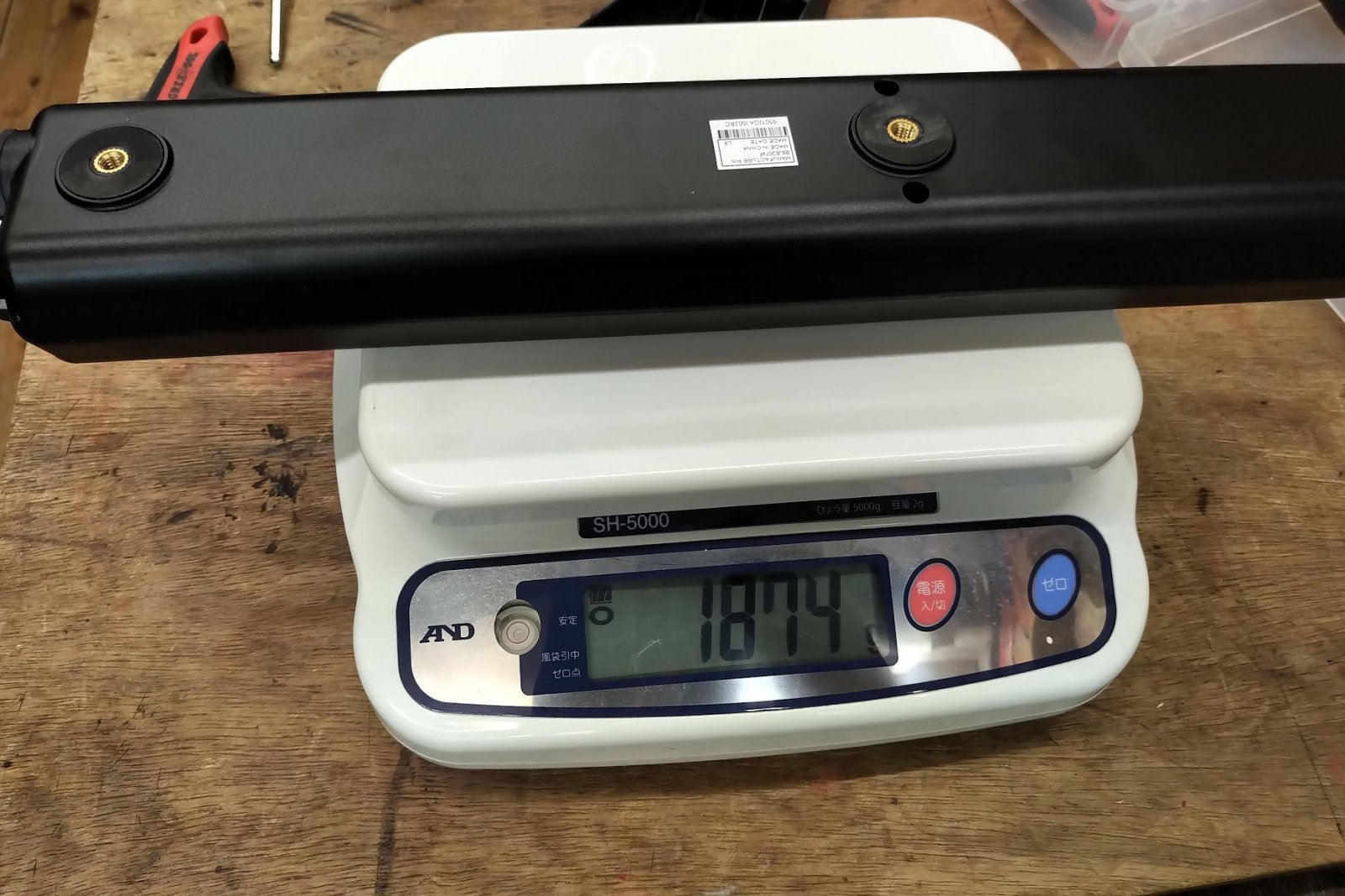

Wow! Do you happen to have the weight of the main battery pack after you removed it?
I have thought of doing similar for trips (if we ever get back to normal) that require air travel

Great rig. What are these these exactly?
The spec. of my bike;
Fork: Cannondale Lefty Ocho (1,376g)
Handle bar: PRO THARSIS Trail RISER BAR Di2 (194g)
Seat post: No brand (Chinese) Carbon
F.Wheel: Mavic XA Elite lefty 27.5 (780g)
R.Wheel: Fulcrum Red passion 27.5 (759g)
Tyres: WTB Sendero 650B x 47c (530g)
Cassette: SRAM XG-1299 (355g)
Bar-end(settled in the middle though!): EASTON ec90
etc.

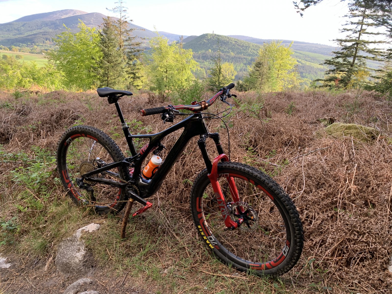

Hi all, my Levo SL should have been with me last week, except that when it got to my LBS nobody logged it in! So, hoping to pick it up early next week and wanted to check a few things (having trawled this thread).
1) Check and remedy the cable rub issue on the motor housing port, any thing I specifically need to do/look for?
2) SicoMTB rear guards; is anyone using/used them and recommends?
3) I tend to like a more progressive/bottomless feeling in my sus setup, as it's way easier on my fairly destroyed legs. Other riders who like the same, what setups have you gone for? Linkage change, shock change, shock tune?
4) Any other mobility-challenged riders using them and having issues with power/support (I didn't on my test rides, but didn't get to do many longer rides)?
5) Anything else you think I need to know?!?
I won't be going all weight weenie on my bike, build as follows:
150mm Pike Charger 2 RCT3 with 2021 Debonair spring.
Octane One Chemical Pro 40mm stem, rainbow.
Brand X carbon bar, 25mm rise, cut to 760mm.
Ergon Factory grips, rainbow collars.
Code R front and rear.
GX single click shifter.
155mm FSA cranks.
Sam Hill Enduro flats.
SDG Bel Air 2.0 saddle.
NS Enigma Rock/Roll 29" wheelset, rainbow hubs and spokes.
Minion DHF Exo+ 2.6, with Nukeproof ARD insert on the front, Double Down Aggressor 2.5" rear.
I think that covers it, aside from a possible shock upgrade later. All mounted up on a medium Cast/Berry frame.
Can't wait..!

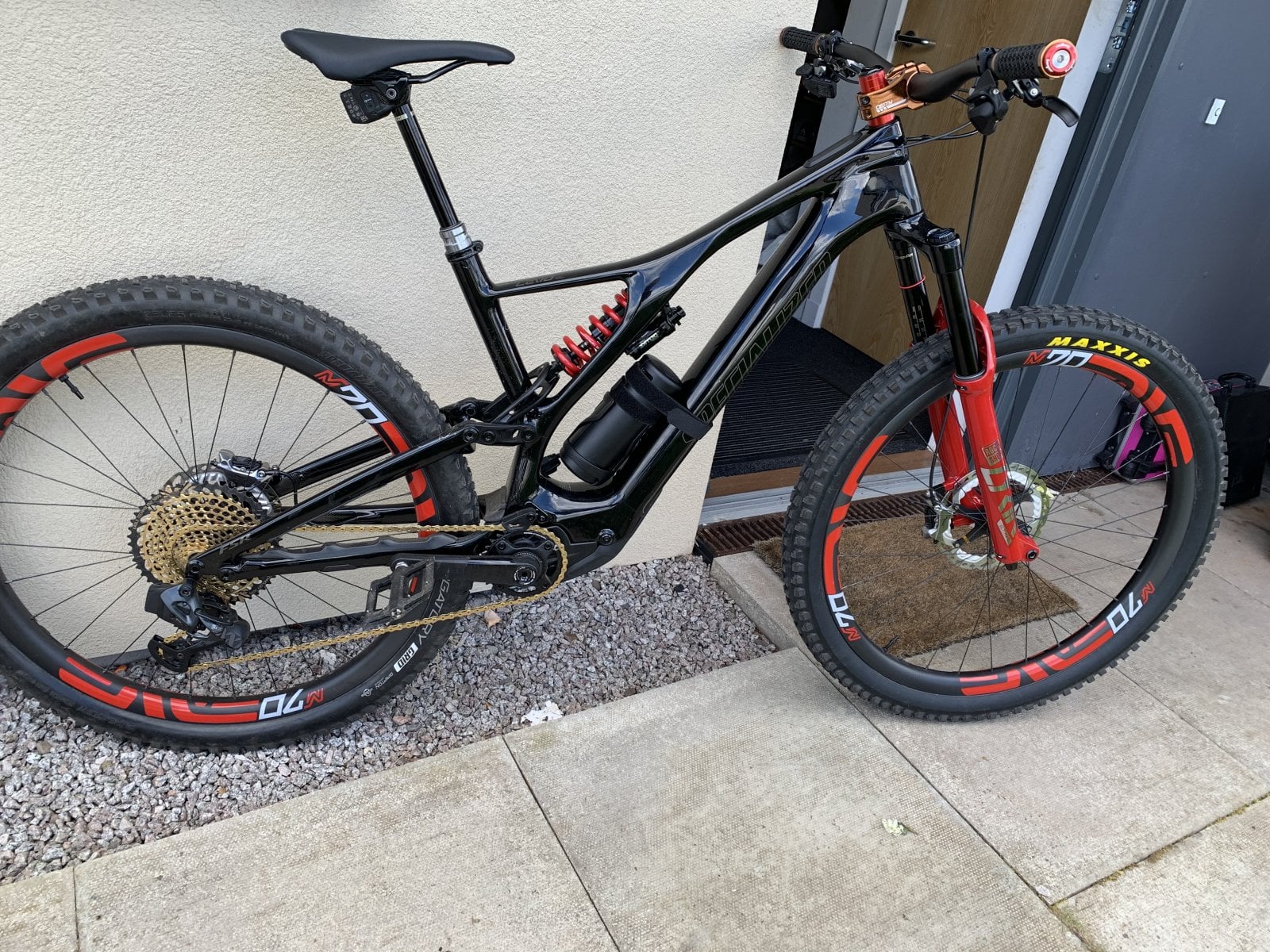

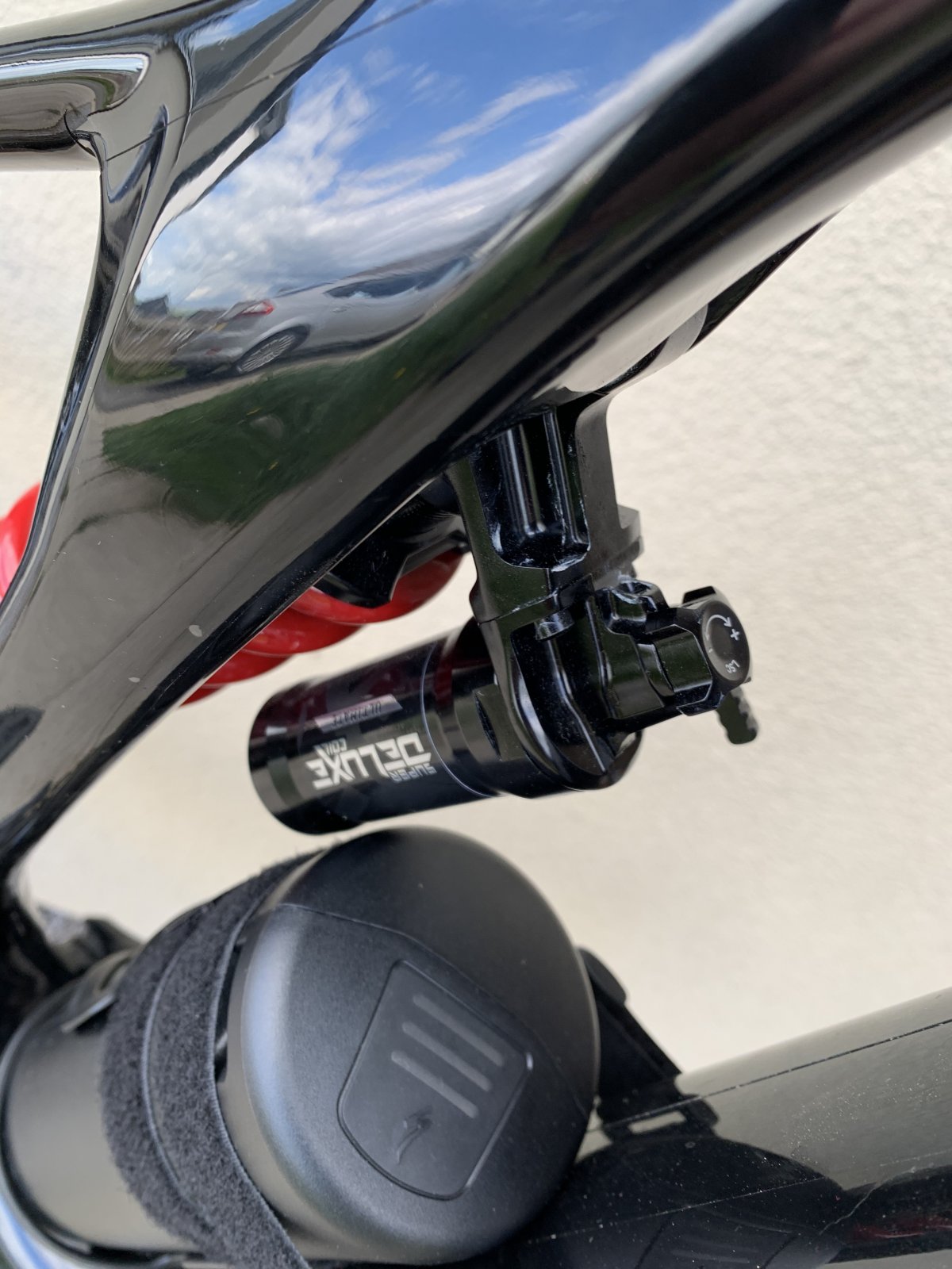

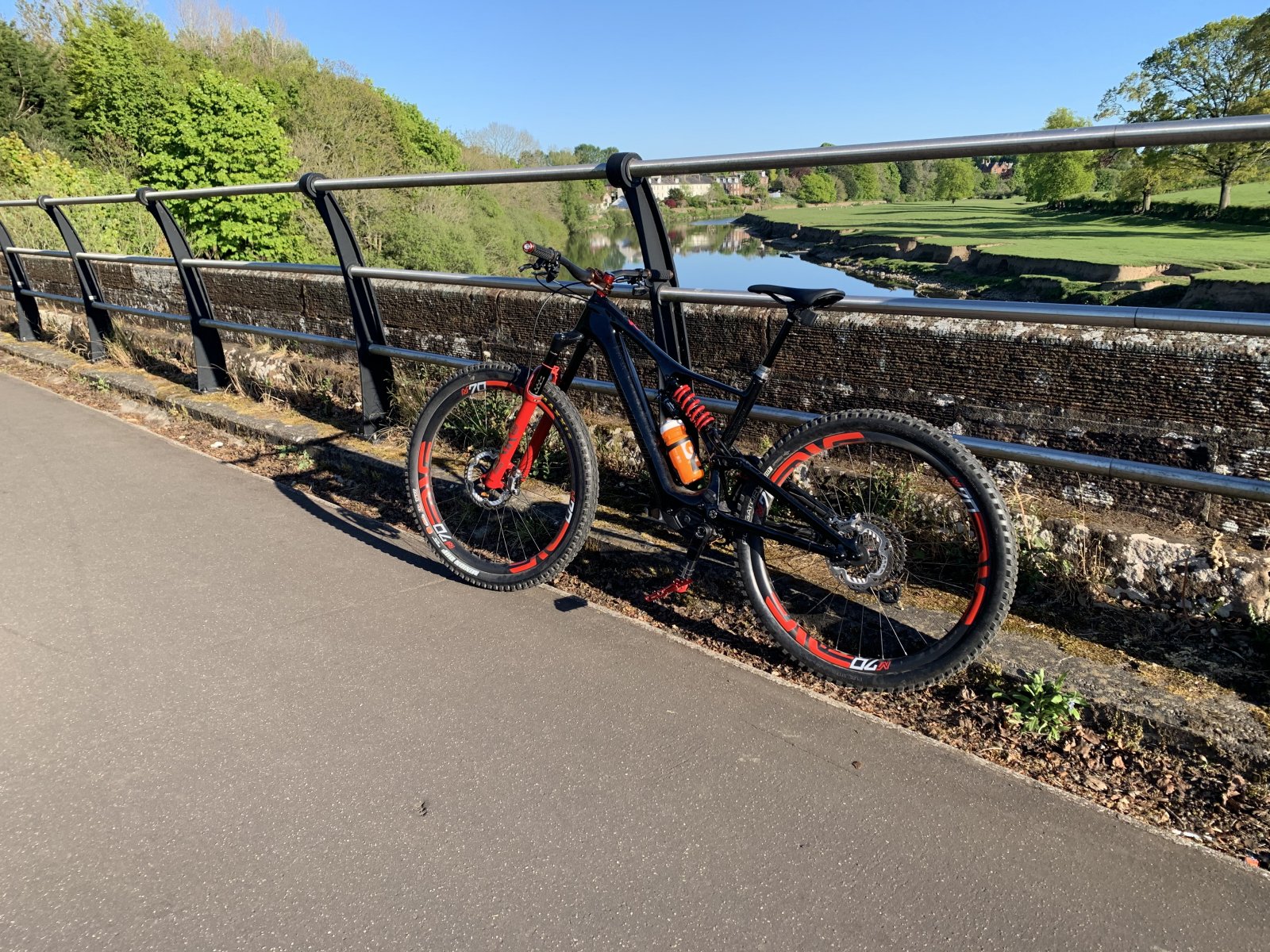

Really do love this bike . Only doing cycle from my front door and can’t wait until trails near me open back up .. also not sure if I’ve already mentioned that my coil shock actually fits the large frame with extender . I had to take the 2 black plastic washers from the cage and stick them both on the bottom hole on the outside to bring the cage up front the bottom giving it the angle I needed for it to fit and not hit the shock . It works flawlessly ! This will only work on the large or extea
Large frame it will not fit on a medium .
