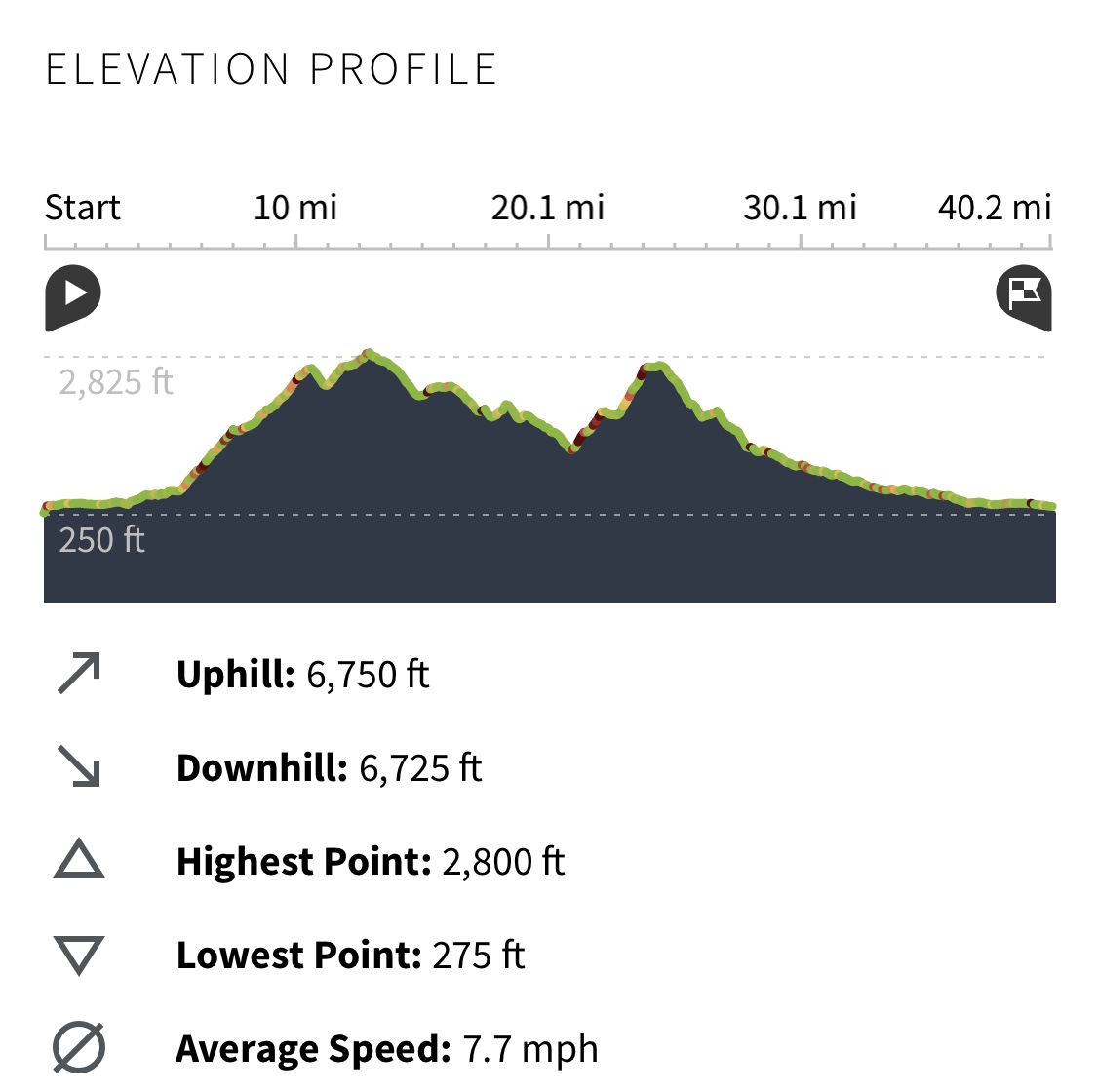

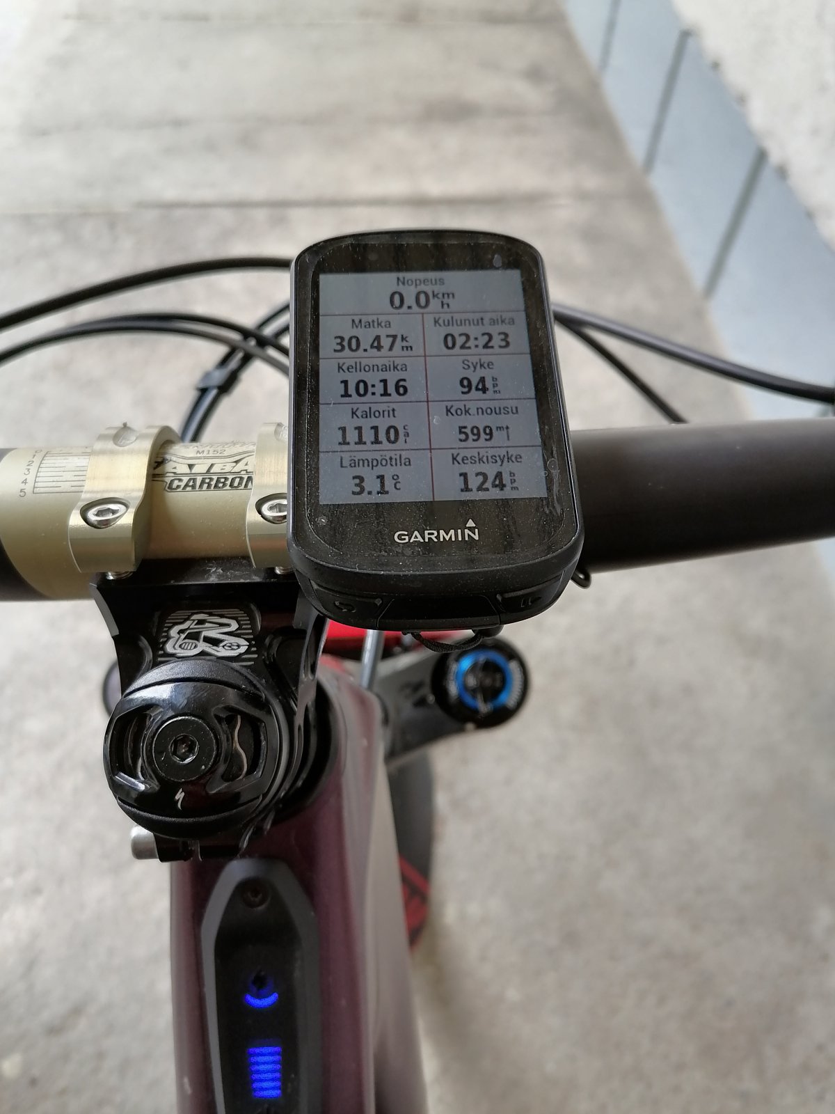

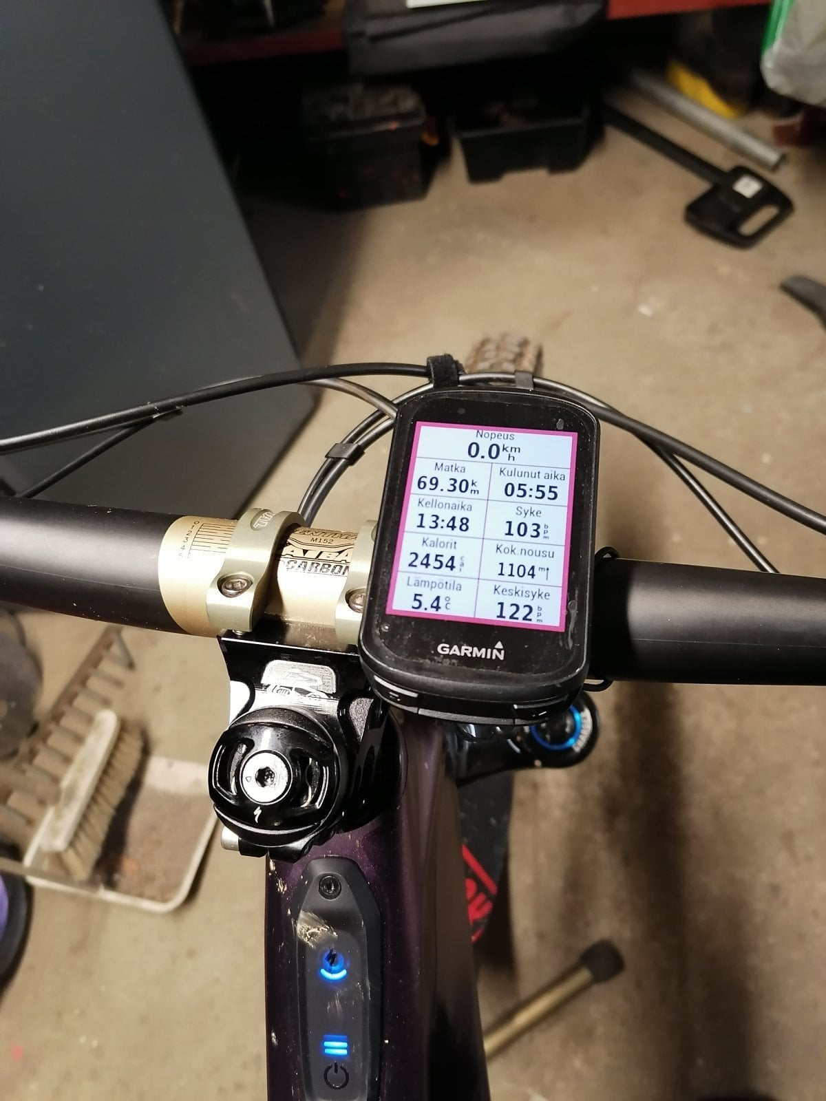

I thought the Garmin would measure distance and elevation based on GPS / GLONAAS data, not the Levo TCU?
my garmin head unit always used to detect the kenevo power meter and the cadence/speed sensor in the bike .. if hes using the planet3 the power, cadence and speed sensor will be the 3rd of what hes done .. he might have another device like a watch , phone to detect the real distance and speed , even better if hes using his own cadence/speed sensor ant+ or bluettooth.
My 820 definitely uses GPS for speed and distance - but then I've only set it up to see the Levo SL battery and nothing else.
I have an 830 due to arrive today, so I'll try it with cadence etc.

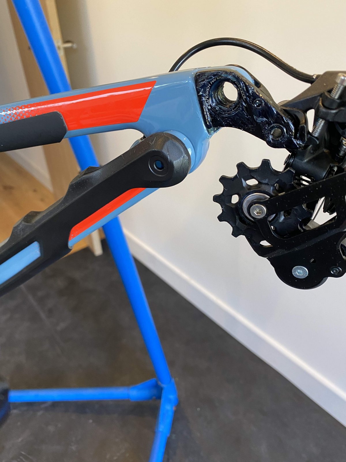

I recently got my carbon comp SL and I am pleased with it. One thing I noticed is that it came without the retaining screw, for the right chain stay protector.
The store I purchased it from have spoken to Specialized, who are going to send one out. According to the invisiframe instructions, it should be a T125.
Hopefully it was just my build, but I thought it was worth sharing.

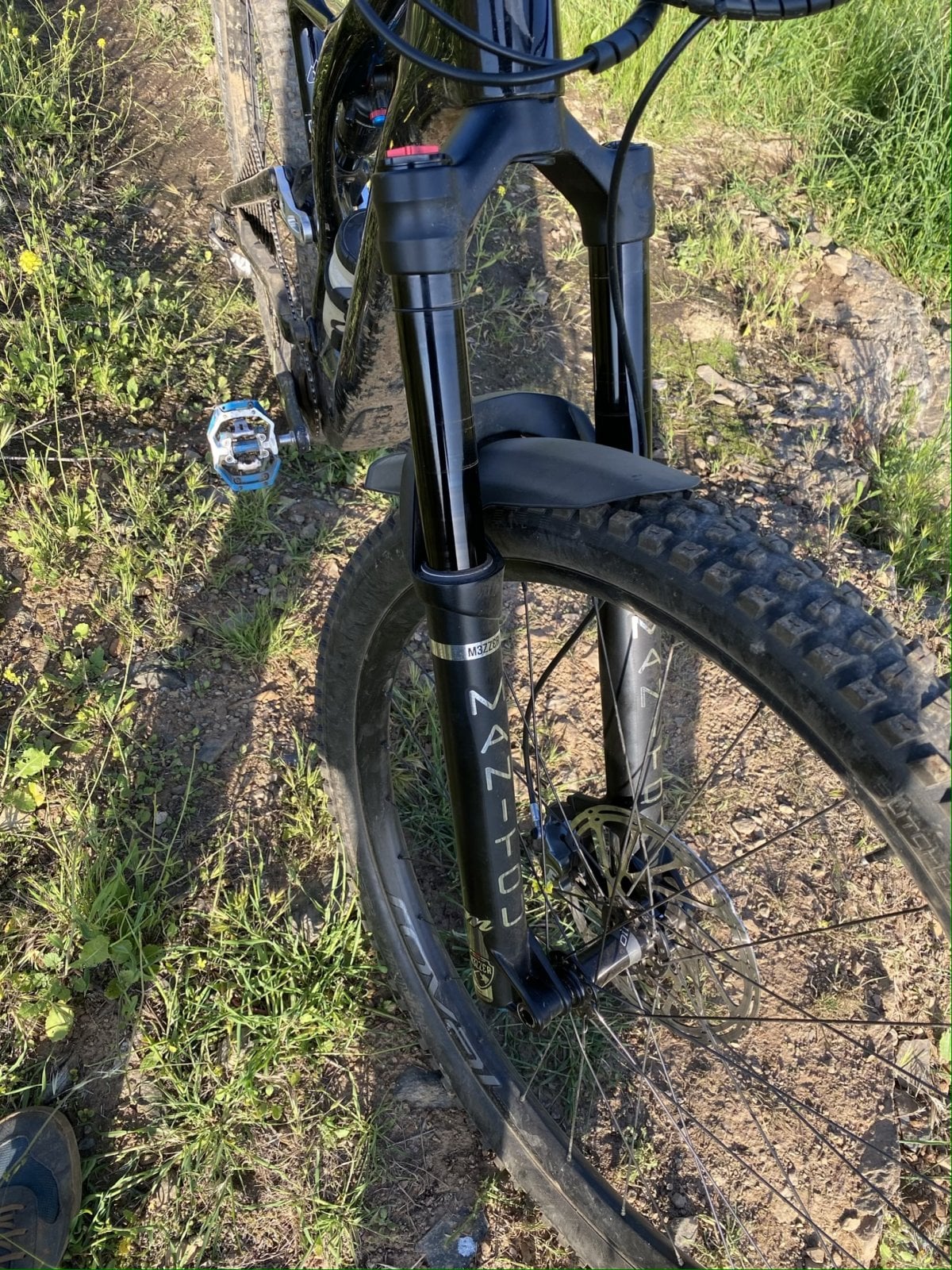

A bit of an update - got a Manitou Mezzer to replace the stock Rhythm 34. The 34 wasn't bad, but I was hankering for bit more travel and big hit capability. Plus, I am a fan of the dual positive airchamber setup after running it on my Kenevo's Lyrik for a year or so.
First run was yesterday. Damper is a bit firm, but the fork is STIFF, composed, and plush when it gets rough. Going to tweak the settings a bit for small bump, but I like it so far. Oh and it's only 80 grams heavier than the stock fork after steer was cut. I can also adjust the ride height internally from 180mm to 140mm, and I may play with that as well. Got the fork for $800 which was the kicker given it's capability

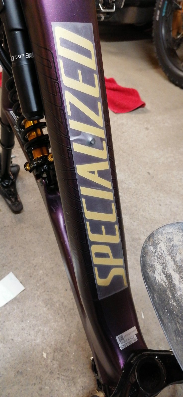

Ordered some parts ?
-xo1 eagle rainbow casette
-x01 eagle rainbow chain
-x01 r/d
-invisiframe kit
Get some tar remover for the bike as this gets rid of the contamination of stuff on the bike . Put it on leave it on for a couple of mins then wipe . I do this on a brand new bike so you will notice a lot of dirt when cleaned .this also helps in the adhesive of the invisiframe glide and stick better .

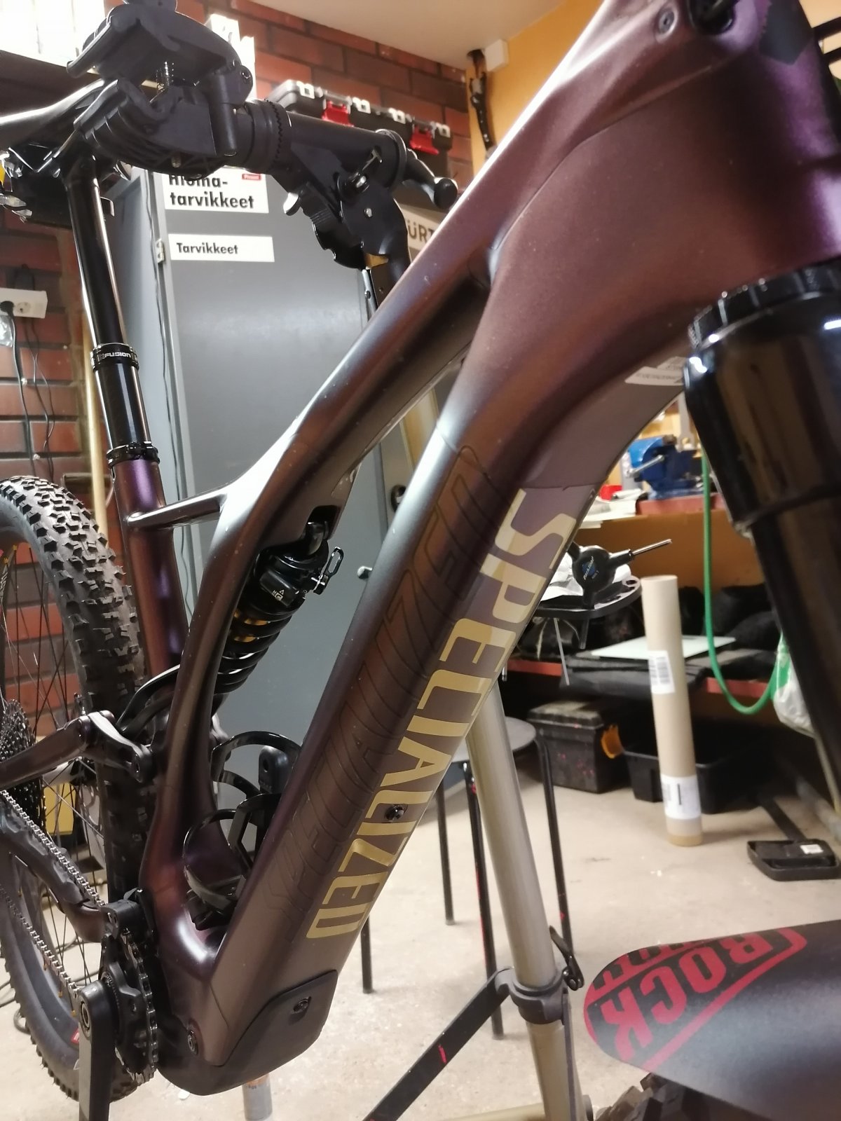

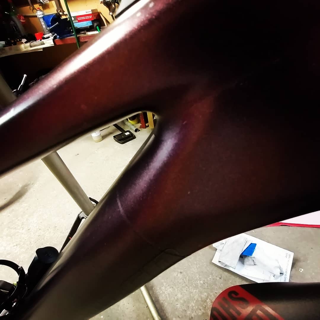

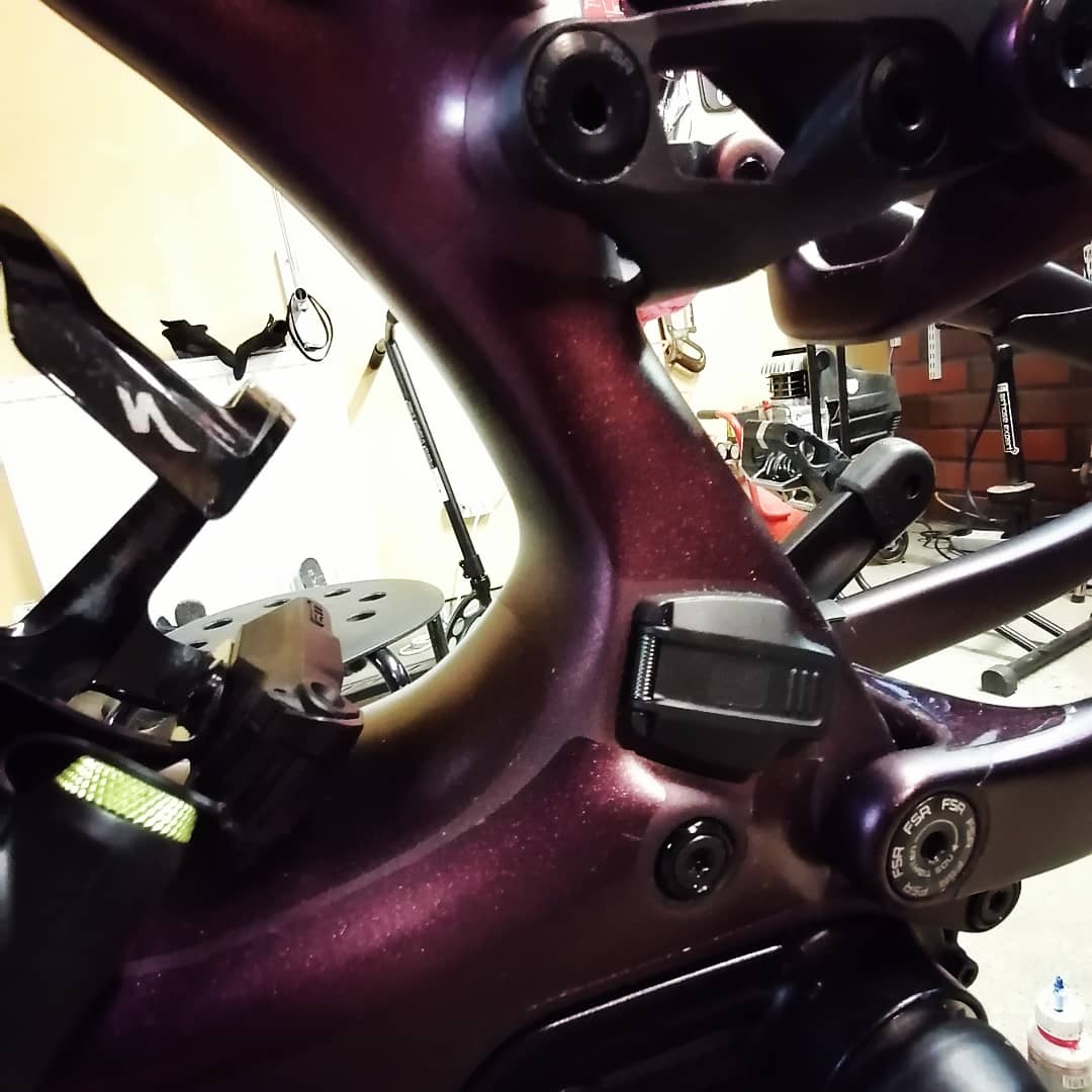

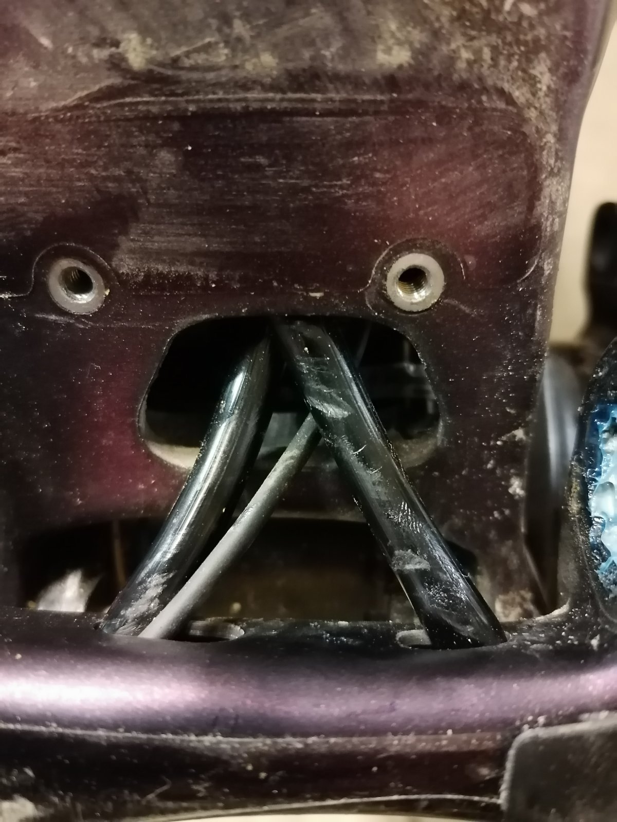

Still making a skeeq sound. Linkages have been greased and checked,same for shock pushings. Comes somewhere in rear. Ni saddle cause when pushing from frame, sound is still there.
Gotta keep on moving ?
TomH79
Jan 5, 2020
322
304
Finland
Heres the sgeek.
Fitted some slapper tape on top of that hole to prevent rubbing. Let see how it goes.
If it helps, gonna drop motor and fix that thing for good.

Heres the sgeek.
Thanks from posting, I have just checked mine and I am now 99% sure it is from those three cables. Mine show no signs of chaffing but I have only ridden it a handful of times.
Like you, I was thinking about dropping the motor out and then run some fabric tape around them.
