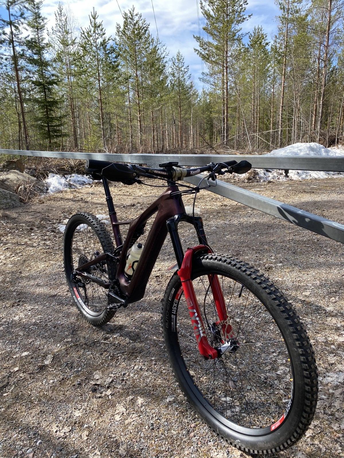

Lbs owner sold his cc to me today.

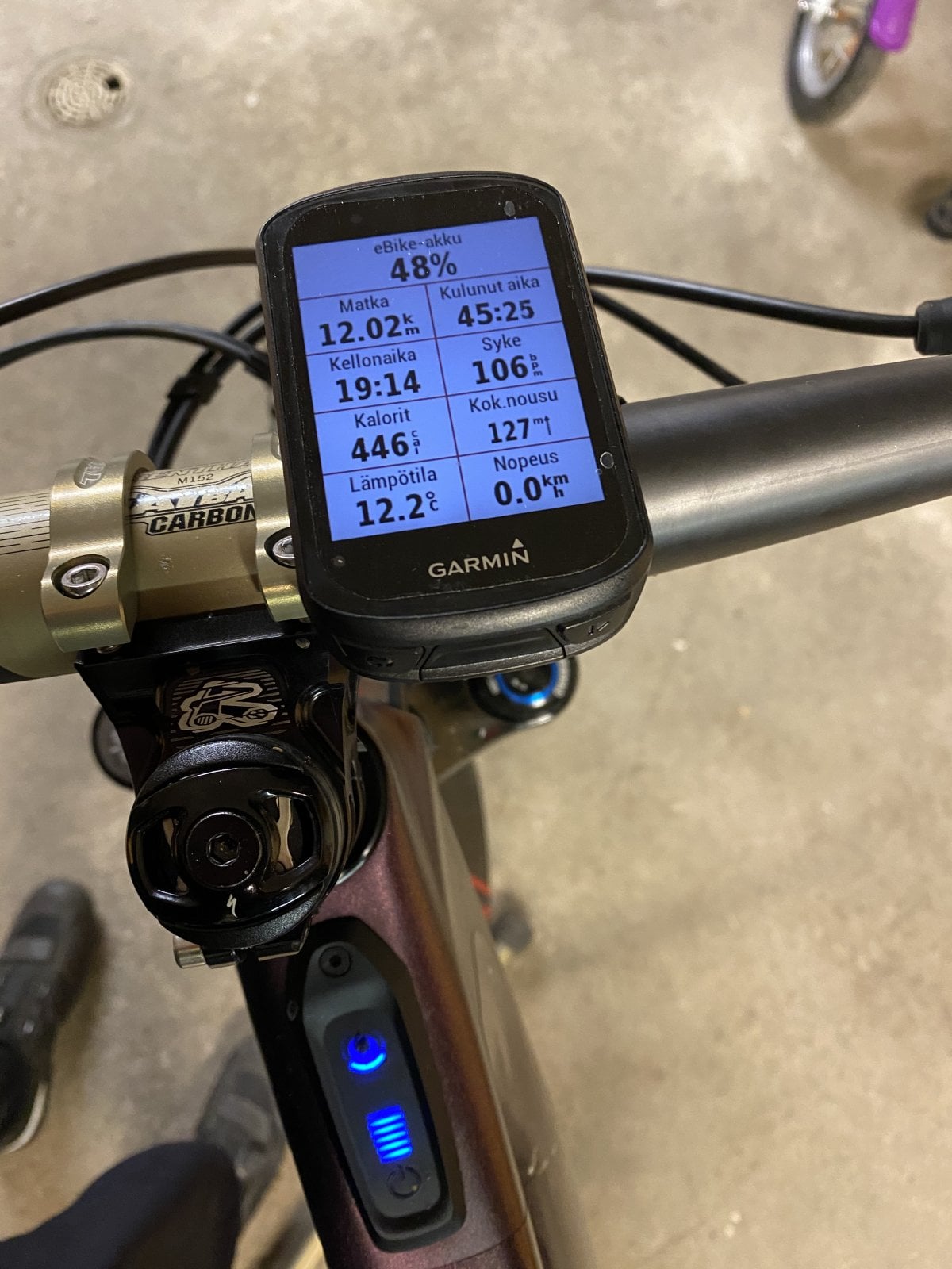

Your Edge shows:
48% battery, 12 km, 416 ft ????
I thought the same...
I did 24 miles on Sunday (about 38.5km) with 710m (2330ft) elevation all in Eco (40/50) and returned with 39% (main battery only). Not bad. I might dial my Eco down to 35/45 and try that for a few rides.
Try 30/45, works very well.

Today 40km with +1800ft ascent. 70%on eco 35/40 and rest on turbo 100/100. At the end there was 48% remaining ?. Used turbo on strava segments.
With extender this goes to the moon and back.
Weighs 19.0kg with stock drivetrain and heavy enduro setup.
Looks like someone using the planet3 device . Could be Wrong .. as that’s the only way the Levo detects 3/4 times less than what you have actually ridden .
I thought the Garmin would measure distance and elevation based on GPS / GLONAAS data, not the Levo TCU?
