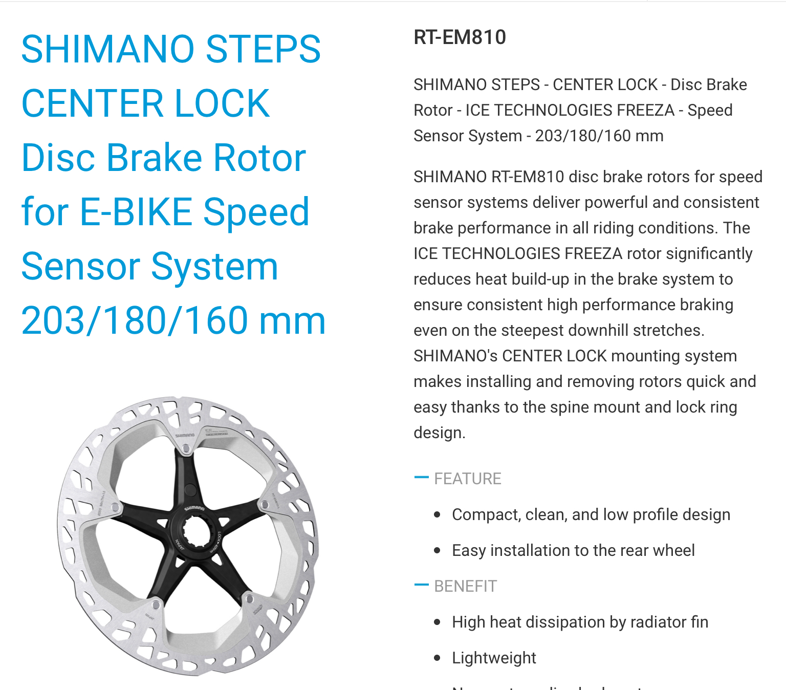

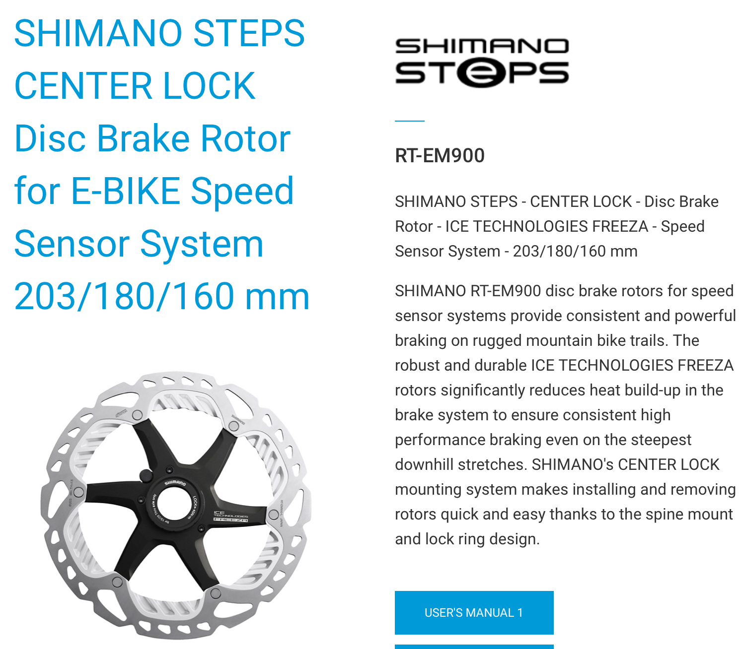

Hey Santa Cruz just bought some center lock wheels for levo myself. How long have you been riding with this magnet set up? Do you think it is durable enough to last for years? I only ask because of the plastic threads on the spoke ...
Shimano makes disc rotors with built in magnets for ebikes.
