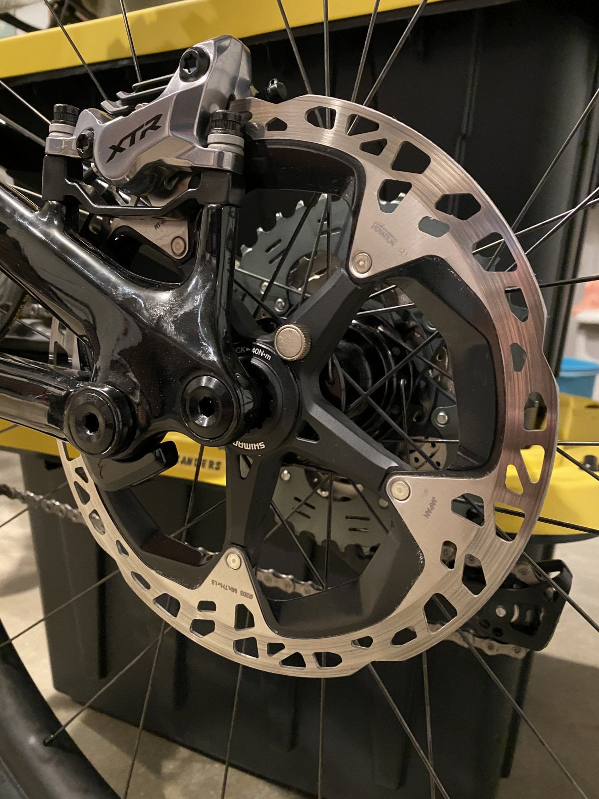

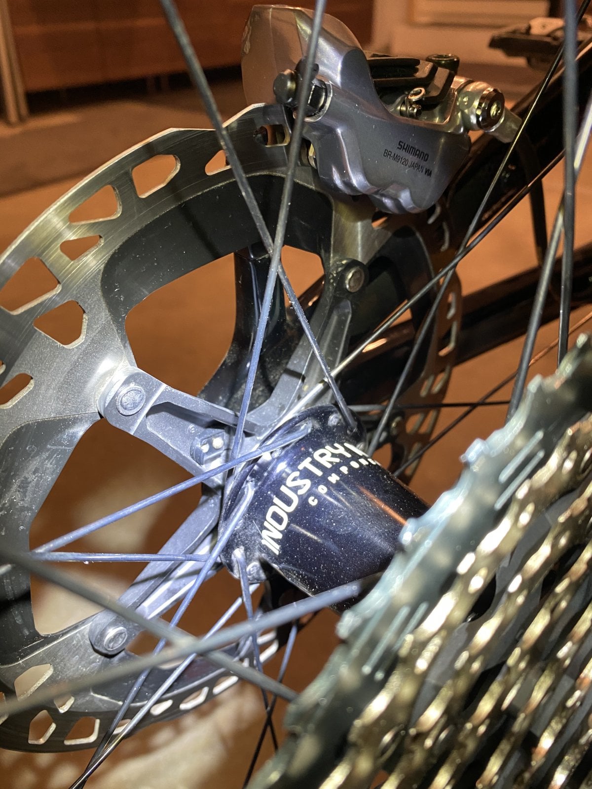

Upgraded the brakes to XTR M9120 with XTR 200mm centerlock rotors front and rear. When going from 6 bolt hubs to centerlock hubs, I lost the ability to mount the magnet and needed to come up with a solution. Thought I would share this hack with the group on how to attach the magnet for centerlock hubs. I used a cat eye magnet speed sensor, stuck the threaded barb through a hole on the rotor and then held it in place with the spoke nut flipped over backwards. Took less then 5 minutes to install and works great. Ordered an extra speed sensor to put in my pack, just in case. This hack would work on the Levo or Levo SL.
View attachment 26960 View attachment 26961
miss shimano brakes.....

How do you like the 9120s? I’ve been thinking of putting them on mine

The new shimano XT8120 and XTR9120 are both killer. I recommend semi-metallic pads especially for ebikes. I hate Sram stuff except the AXS seat post. Switched the bike to all shimano brakes and drivetrain.

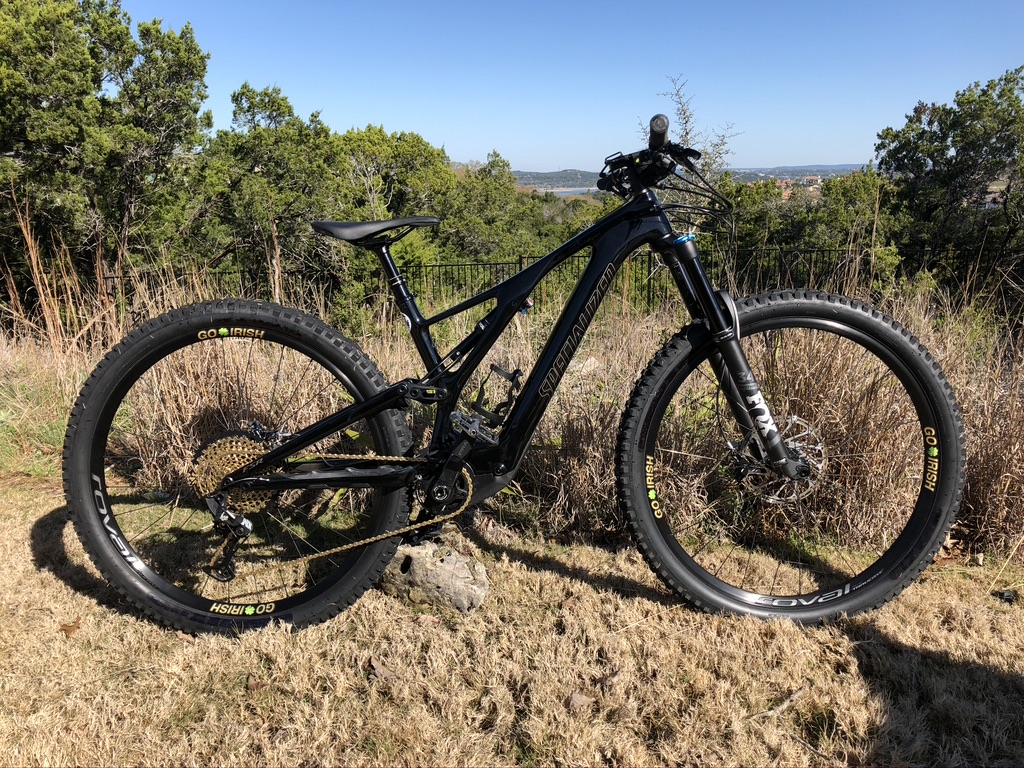

Installed the freehub. At first I was a bit concerned with the dimensions / stack up but once assembled everything lined up. I them put XX1 cassette and chain on the bike. Net weight savings was 280 grams. Went for a 10 mile ride. All works as expected.

Hey Santa Cruz just bought some center lock wheels for levo myself. How long have you been riding with this magnet set up? Do you think it is durable enough to last for years? I only ask because of the plastic threads on the spoke nut. Ordered the XTR rotors as you did. Was it a perfect fit? Did the magnet threads line up perfectly with a nut threads? I see you had to reverse the position of the spoke nut when threading it on. Any problems with lining them up? Did you use any kind of sealant on the threads to make sure it doesn't come loose? Almost looks like you used white caulk. Thanks for your help.

Hi Jeff,
100 miles on the bike and not an issue so far. I have checked it a few times to see if the magnet had come loose and it has not. I used a pair of pliers and went a 1/4 turn past hand tight on the initial install. I have ordered a spare cat eye speed sensor and I will carry in my pack just in case. No issues lining things up, literal dropped the speed sensor in the hole and put on the nut backwards. Did a slow spin on the initial install to see if there were any clearance issues, which there were not. So far, its works well! And the Shimano brakes are awesome!
