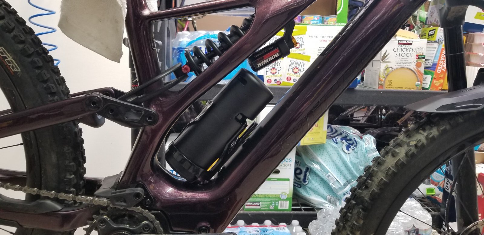

Just sharing a tidbit of info for those looking at Range extenders. SL Comp carbon size Medium, stock bottle cage, Wolftooth b-rad bracket, Bomber coil over, tight fit but it works!

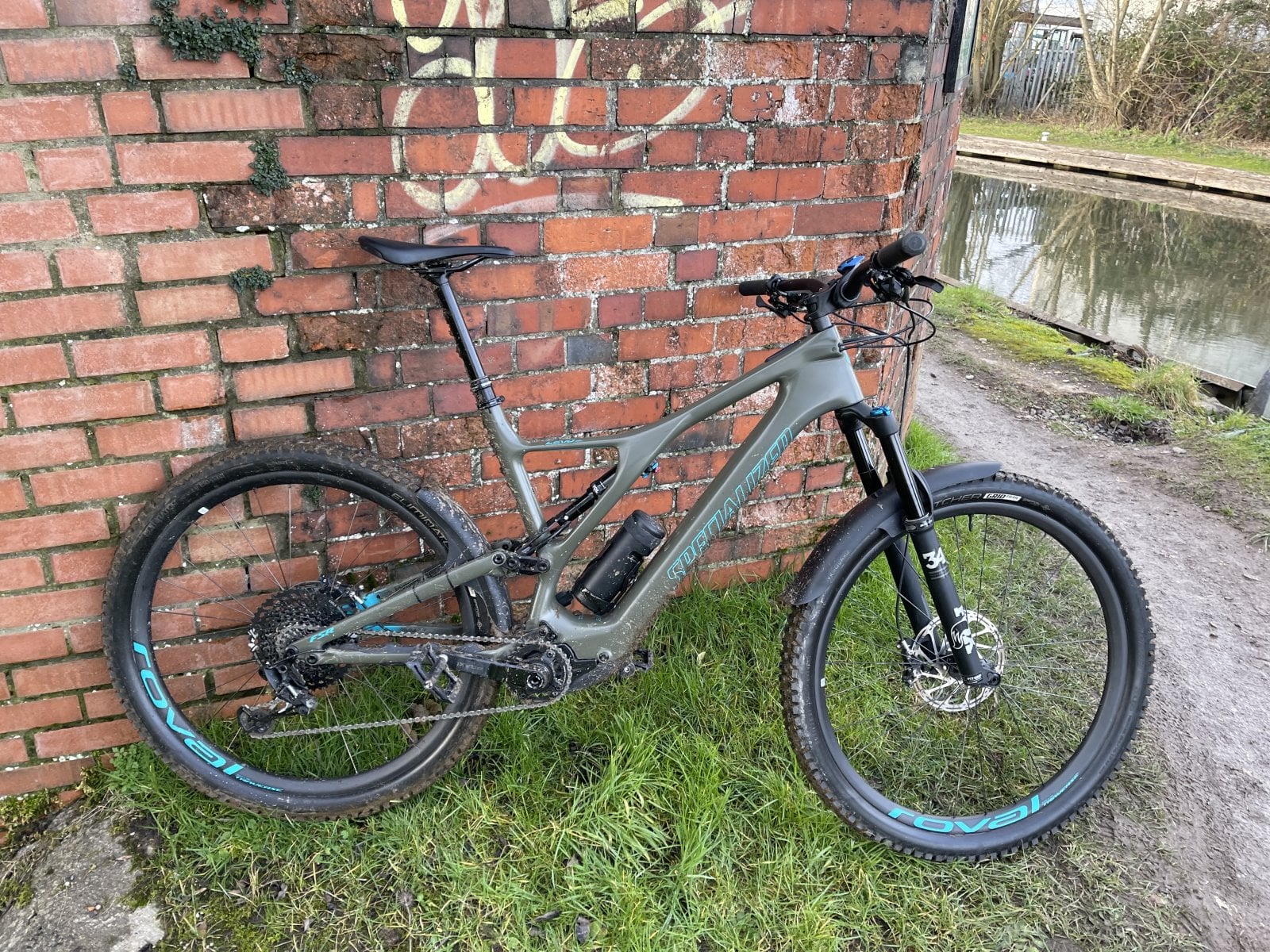

First proper ride on the sl expert carbon
Absolutely love it !!!
I am fairly fit and still looking for a bit of a work out did 30 miles on a mix eco and off no trail or turbo
Only used 29 % battery with the extender amazing
to be honest pedalling this bike off didn’t feel much different to my old 13.5 kg Santa Cruz Tallboy
as much as I love my ff Levo
This is the bike for me , it works well if your fairly fit and still looking for a work out , nice mix of ride in eco and off mode didn’t feel the need for the other modes
can’t wait for the next ride
