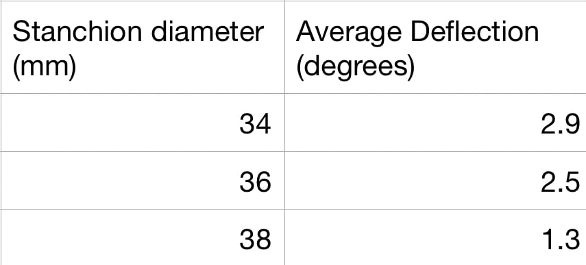

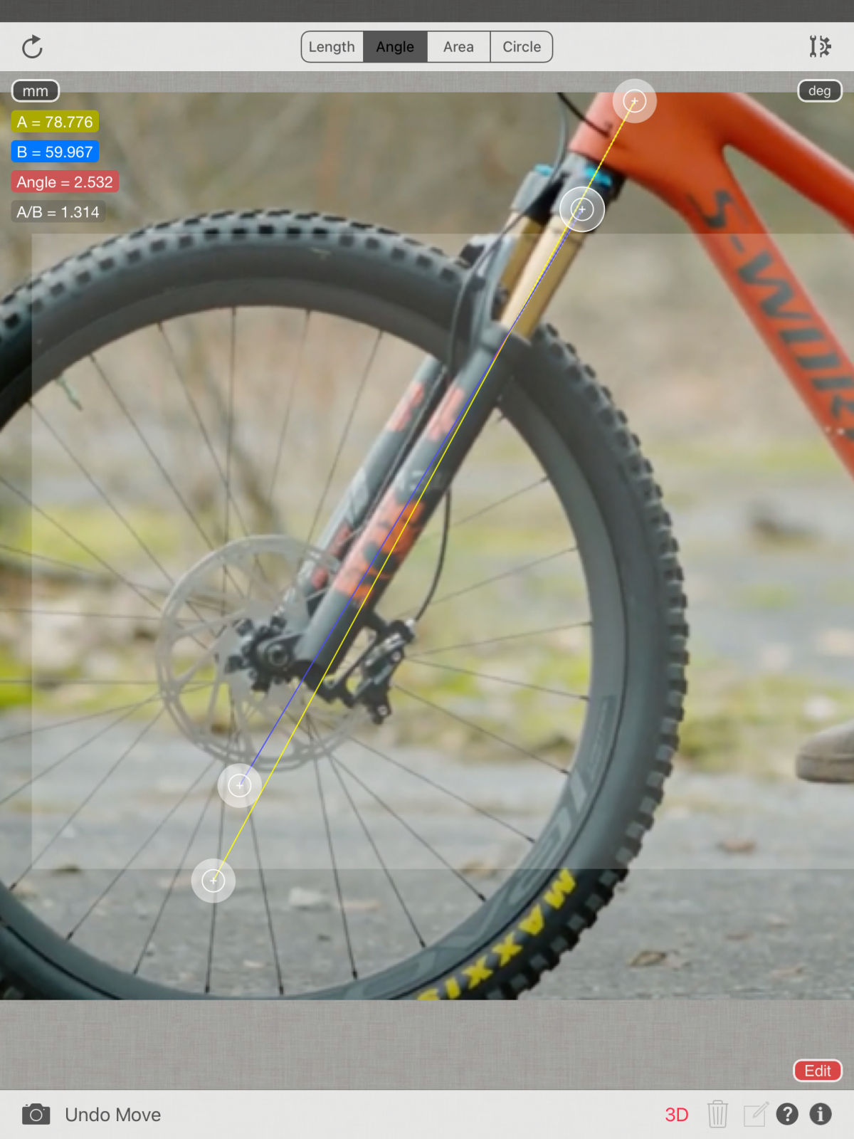

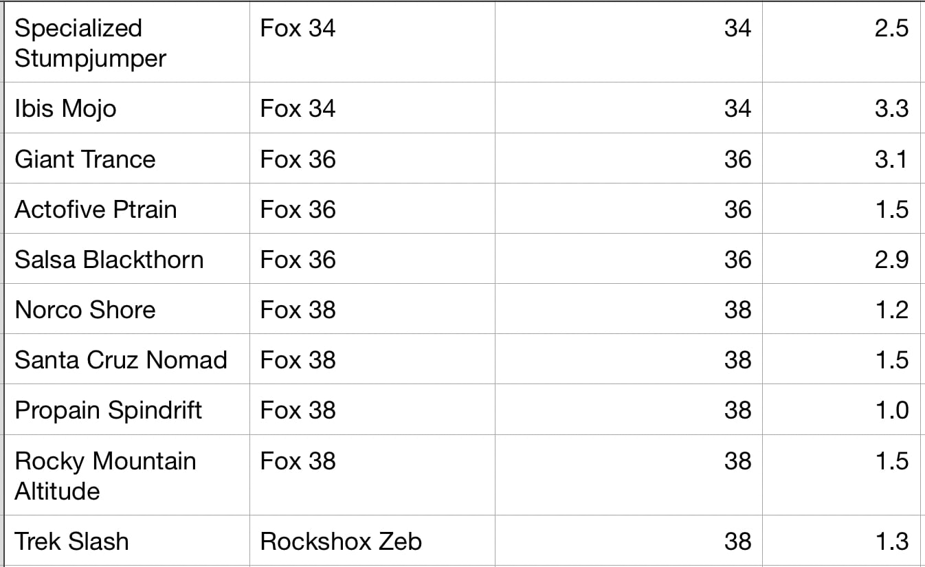

Interesting discussions on fork stanchion sizes. Pinkbike posted their latest huck to flat video of 5 trail bikes and 5 enduro bikes, and the forks have stanchions from 34 mm to 38 mm diameters. The same rider rode all the bikes off the same jump and the slow motion camera had the same view every time, so this was a somewhat controlled test.
You can really see the forks flex. I felt like nerding out a bit so I measured the maximum deflection of the stanchions with respect to the fork lowers for 9 bikes. Results below. The 38 mm stanchions are definitely stiffer, but the 34 and 36 are closer than I would have thought. I would guess my measurement technique is only good to +/- 0.3 degrees, but it is still kind of interesting.

I bet most of that flex is not primarily caused by the stanchion size, but the steerertube diameter/materials/crown race bearing setup/etc.
I wonder what the comparable size stanchions but with a proper triple tree setup would look like in that that test above.
I am sure there is flex in the other parts of the fork. By measuring the amount of deflection at the axle relative to the head tube centerline the flex of the whole fork could be measured, while taking account of the fork offset. The measurement (really an estimate) that I did just accounts for the stanchion, since it was just the angle between the stanchion and the fork lowers.
It would be interesting to see results for a Pike and a Lyrik. I am running a Pike on my SL and it seems just as stiff as the Yari (with internals upgraded to Lyrik Ultimate) that I had on my FF Levo.
One comment about the Pike - it is a leftover 2020 that I “upgraded” with the 2021 air spring. That was not a good move and I later “downgraded” back to the 2020 spring, which is more supple. Not sure what Rockshox was thinking there.

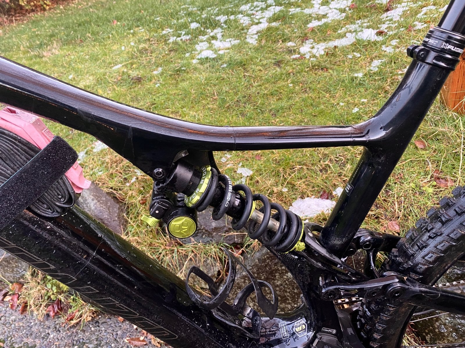

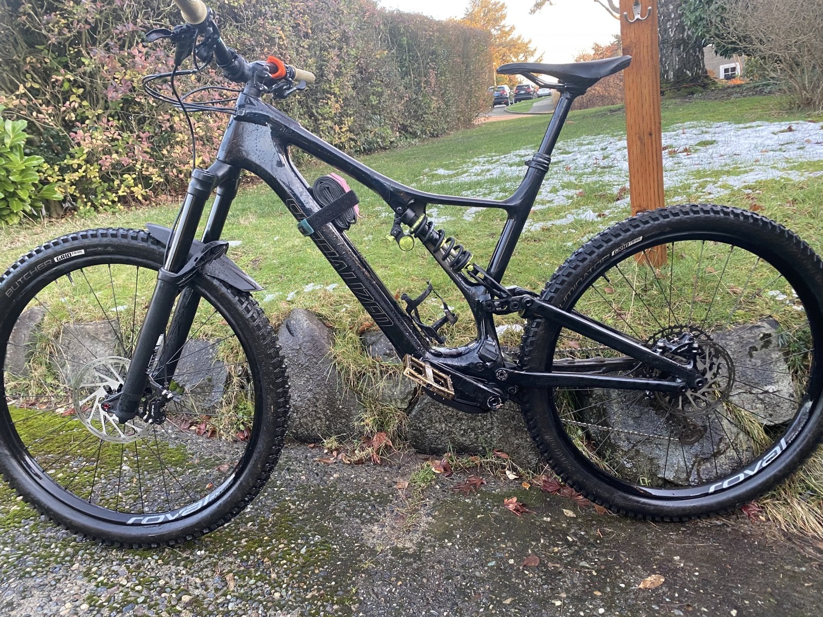

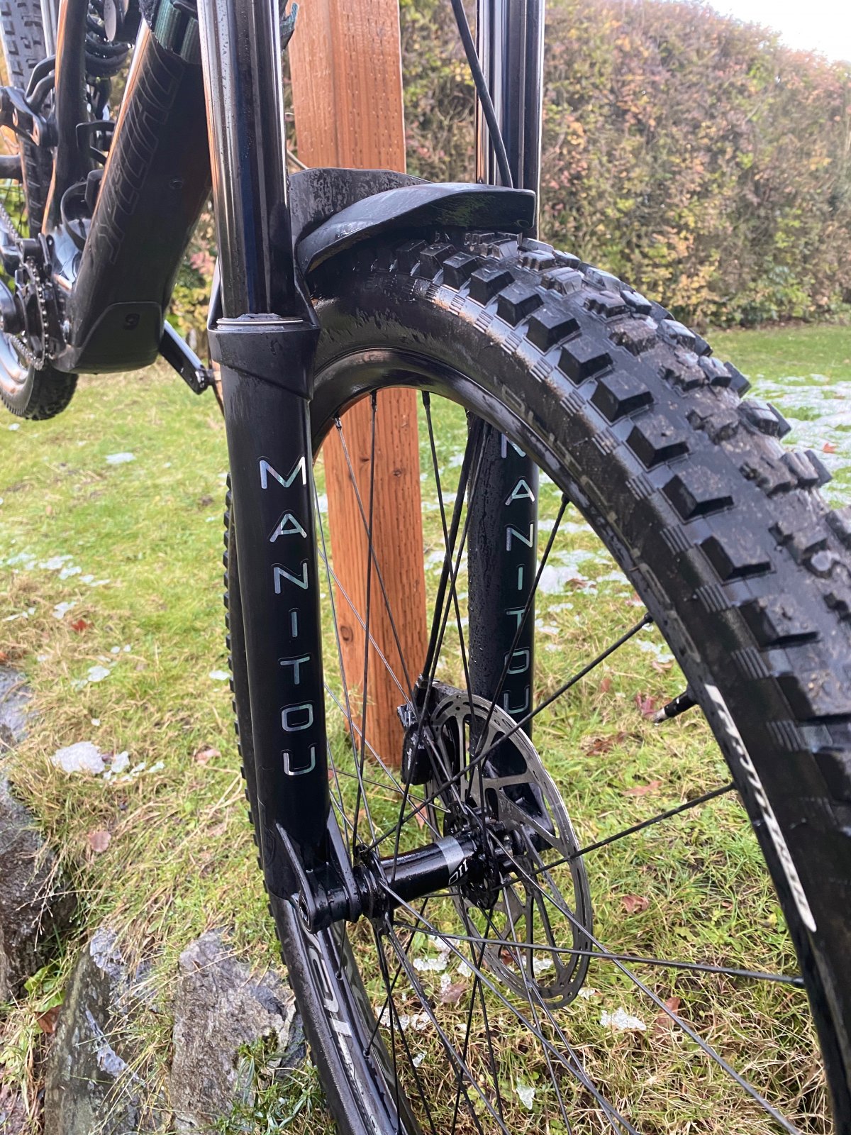

Thanks to some suggestions in this forum, I finally have (some) of my upgrades completed. I swapped out the stock Spesh bars for some PNW. Got rid of the Fox 34 and replaced it with a Manitou Mezzer Pro 160mm and miraculously found a brand new DVO Jade X coil with spring for $300 (!) which replaced the rather lightweight Fox that the bike was spec'd with. I ride an XL and weigh about 200lbs and even though I'm not super sensitive to my suspension, I can say that this new setup is SO much better than the stock, at least for my riding here in the PNW. I took the bike out today and rode the roughest and steepest trails I could find and the bike was amazing! So much more control and traction at higher speeds, both through the rocky/rooty stuff and smooth berms. The next upgrade I'd consider making would be the brakes. The RE's are generally ok, but they start howling on the longer/steeper descents. But otherwise, I think I have the perfect bike!
View attachment 48574 View attachment 48575
Nice setup! I was looking for a JadeX but they are sold out. Do you run it Open on the steeps? How do you like those stock tires? I found them no where near as grippy in the damp/wet as Maxxis DHF 3C or Assegai which are the norm here in Vancouver/Squamish. I am sure the bike (frame) is much more capable than the stock parts suggest.
Yesterday I rode the rougher trails with the shock in the Mid position. I think the spring is actually a bit too light for my weight, so keeping it in the Mid setting firmed it up nicely for me. I'll experiment some more but will likely go to a stiffer spring soon. I'm interested in trying the Sprindex as my riding ranges from steep/rough terrain to jump lines and even some XC-ish stuff, so dialing in the coil depending on terrain would be useful. My goal (after this next bout of rain passes) is to spend a day just sessioning certain trails and really try to LEARN how each setting on my fork affects the ride. I'm still kinda fuzzy on the real-world application of LSC/HSC/Rebound/Etc. Understanding the concepts and feeling the changes on-trail as still somewhat disconnected for me.
As for the tires, I've been pretty happy with them! My other bike is a Hightower LT and has a Magic Mary on the front and some Bontrager tire on the back. And my previous bike had DHR/DHR combo ... and to be honest, I can't tell a huge difference between them all. So many good tire options these days. For me the biggest variable is if I have the correct pressure dialed in or not.
How do you like the mezzer? It’s been brilliant for me. Try 170mm at some point. I don’t think it adversely affected the handling at all , especially for the riding you experience in the pnw.
I don’t ride wet pretty much ever, but for the dry, dusty trails I did find that the stock tires held there own until the side knobs started to tear on the butcher. Also - stans sealant always leaked sidewall.
What spring were you using with the Jade X (given you said you weigh 200 lbs and are riding some pretty aggressive and steep trails)? I looked into the Sprindex but doesn't that setup reduce the stroke of the shock? Have you considered a Cascade link? From what I can see from the DVO website, they seem to be pushing their Custom tunes (shim stacks for LSC/HSC) to setup your bike for your specific riding conditions. I am using a Vorsprung custom tune on my Kenevo's stock RockShox Super Deluxe coil but I have not compared it to anything else. My wife has an Ohlins TTX22M for her SL but I would need bigger spring for me to ride it with that shock on it.
I agree with your point about tire pressure being important but I was still slipping far too much on wet roots with the stock tires!

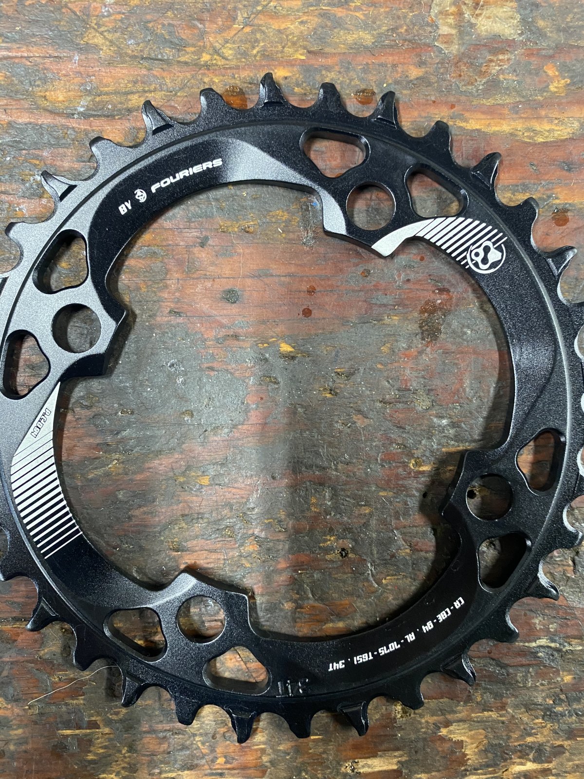

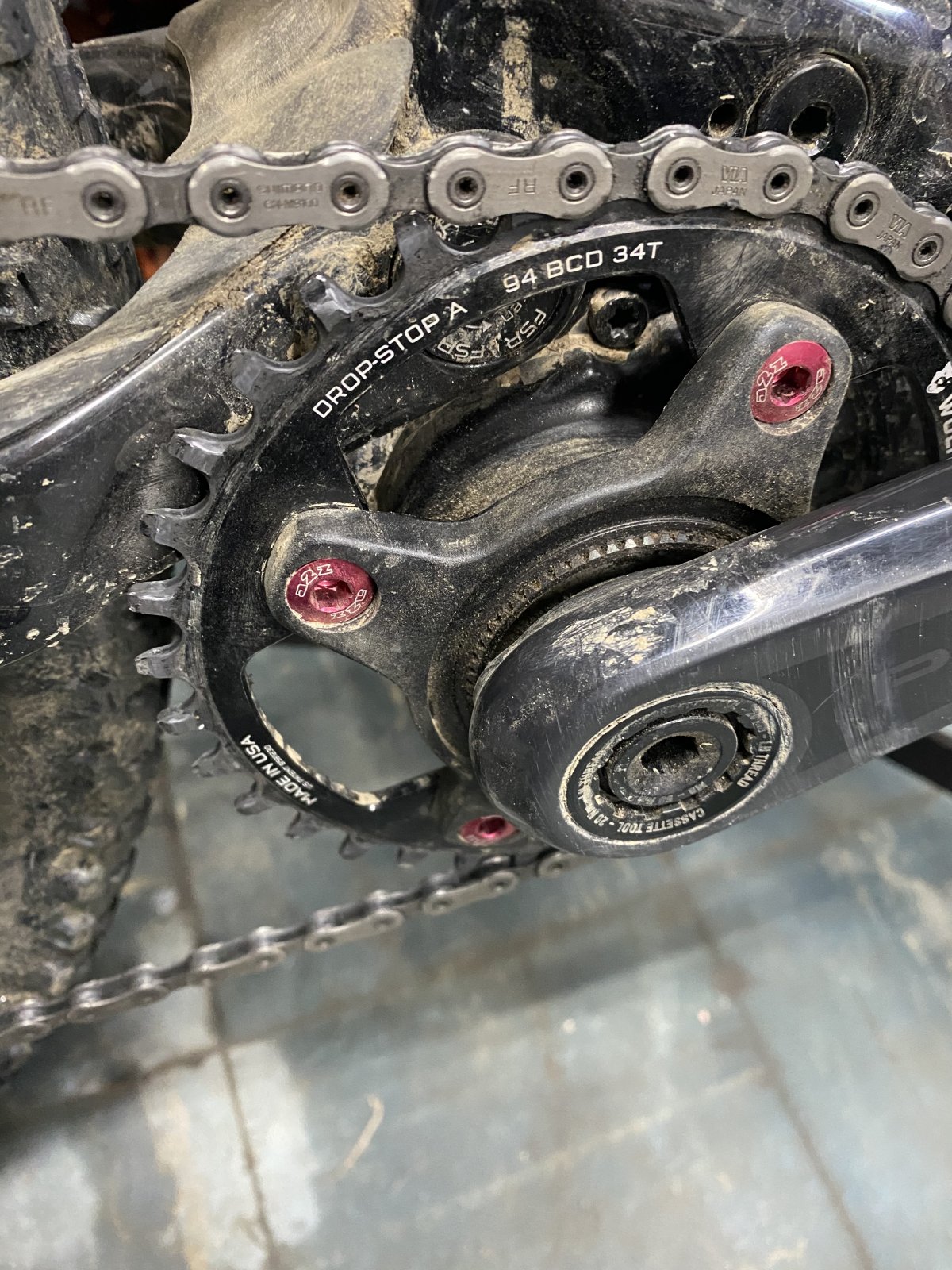

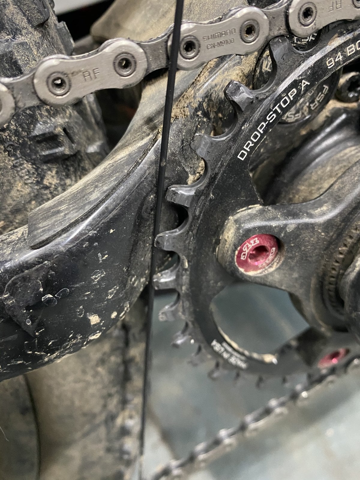

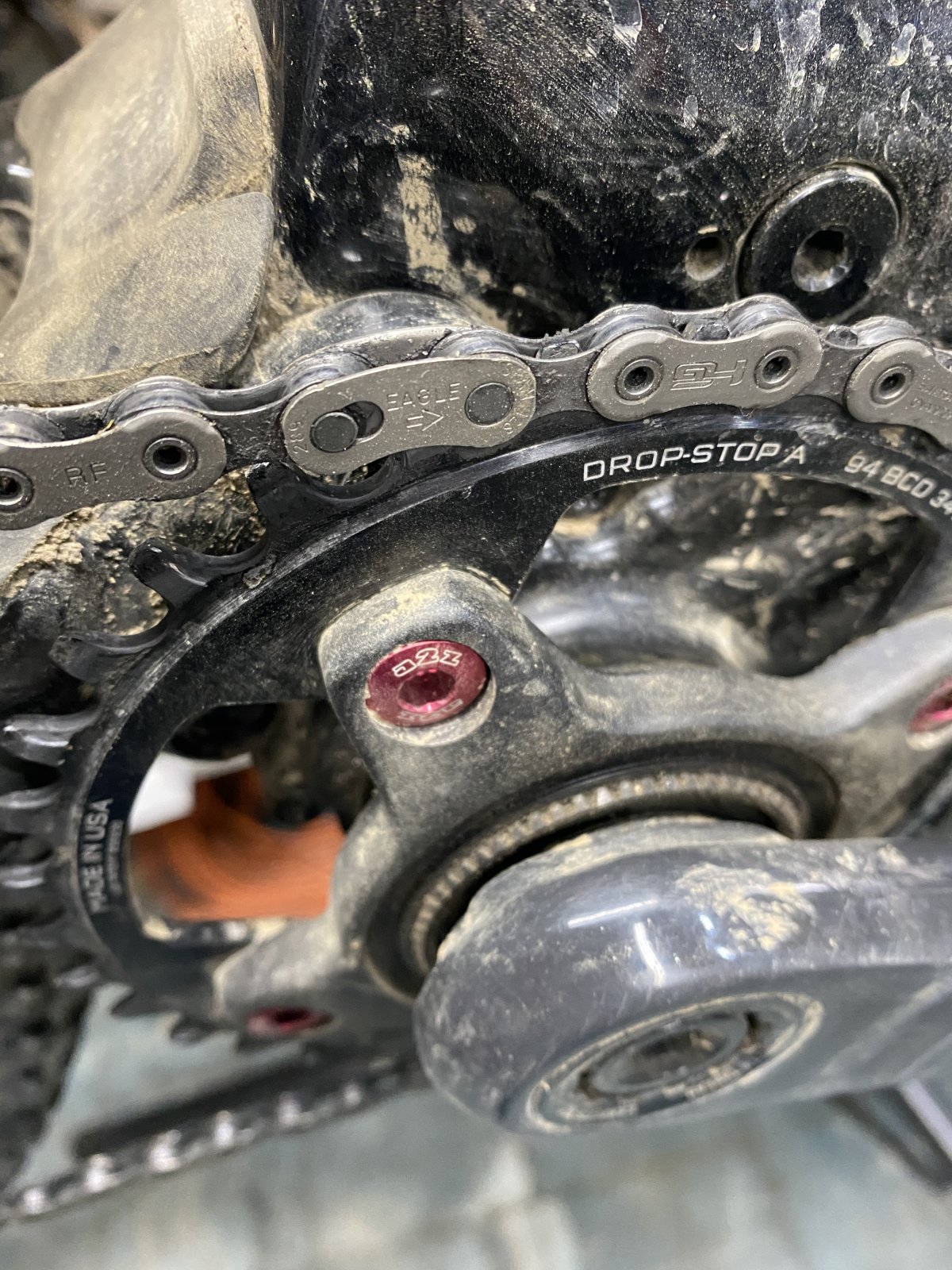

Anyone swap out to a 32 or 34T chainring? I find myself constantly on the smallest gear riding my levo sl and think that would help give me a bit more top speed.
I’m running on SL Carbon Expert a wolf tooth 34T , Shimano 12 speed chain and a Sram link, Shimano link jumps on drop stop A.
I also found a Chinese Sram X Sync 2 copy,
Haven’t haven’t tried it yet.
There’s only 1.5mm of clearance ,see the Picture of 1.5mm spoke between frame and 34 chain ring.
I have demoed the alloy SL and it appeared to have more frame clearance, maybe a 36T would fit?
Thats a pretty tight fit. Thanks for sharing!! I'll probably stick with a 32t..
Indeed thanks and I also will most likely stick to a 32T for clearance.

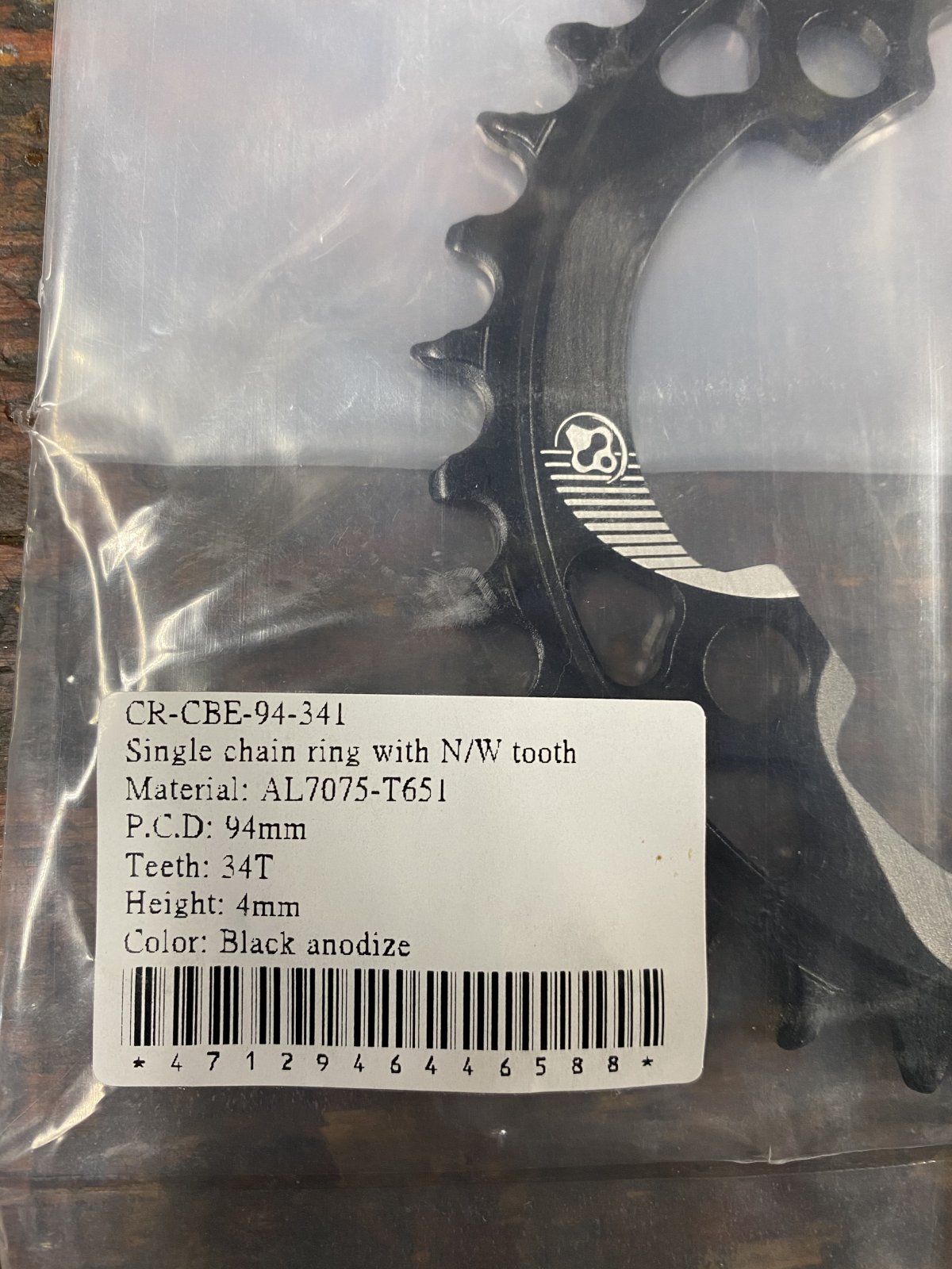

This is the correct part right? Wolf Tooth Components Drop-Stop Chainring: 32T x 94 4-Bolt Would I need to get the bolts as well?
I have a sprindex on my EXT. It does not reduce the stroke of the shock - purely changes the spring rate. Works great. I have found that I prefer a 585 lb rate for most scenarios, which would have me between sizes with most standard springs. And it is nice to be able to firm up or soften even quicker than adjusting compression. Pretty neat product
I think you can reuse the steel chain ring bolts they came with the bike I changed mine out to alloy because I’m a weight weenie.
Here’s the link to Wolf tooth
I think that’s the same ring as worldwide cyclist
The 34T has plenty of clearance I run my turbo levo 38 ring much closer without a problem
