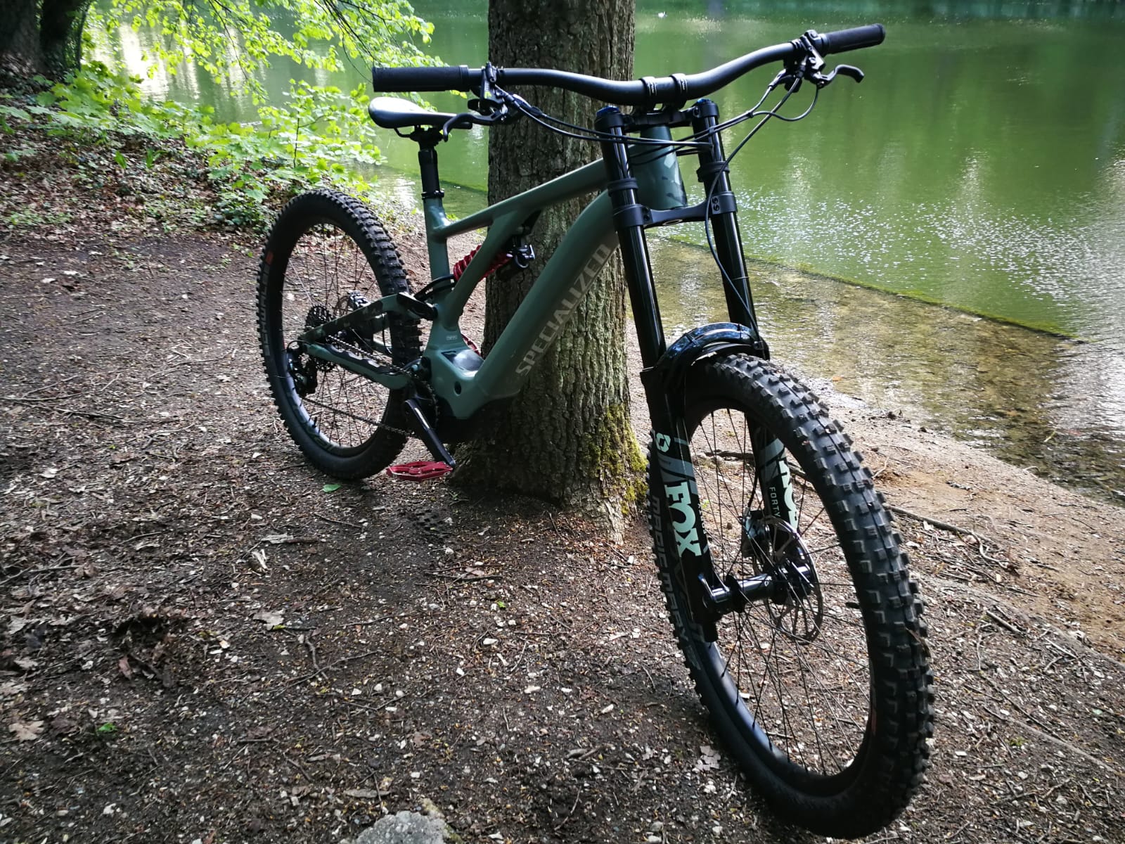

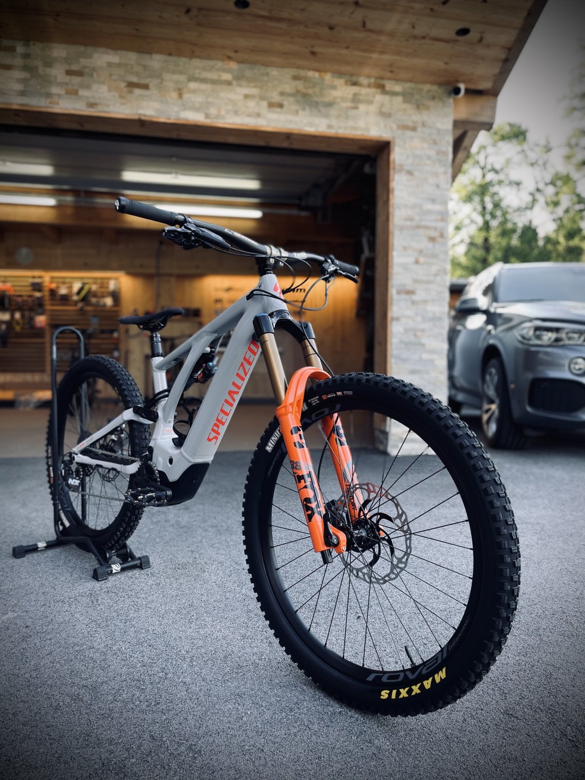

Mullet every time, love mine, Wouldn't got back to a small front wheel or buy any bike that wasnt a mullet these days. Dropped to 180mm so the axle to crown is about 580mm, only 10mm higher than the stock setup.
EDIT although I am talking about the boxxer with 29 lowers & an rc2.1 damper upgrade rather than fox stuff. Offset I think is 56mm.
Did not go for the mullet, but new Fox 40 Performance Elite :)
