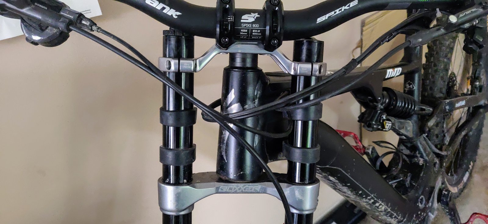

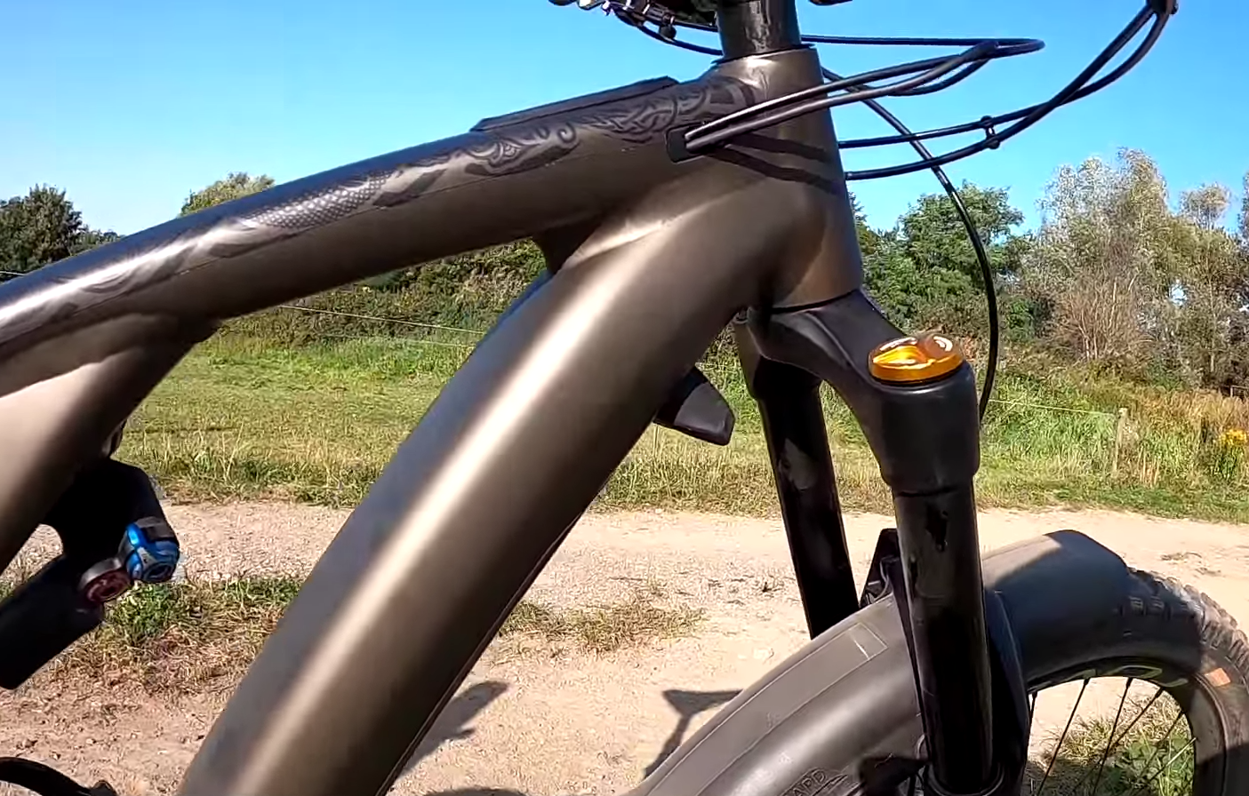

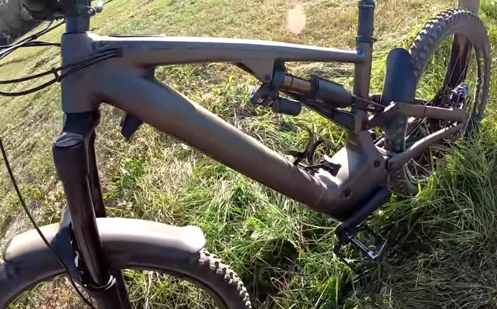

sp00n
Jul 11, 2021
62
31

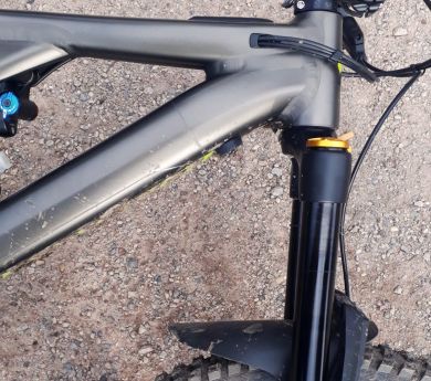

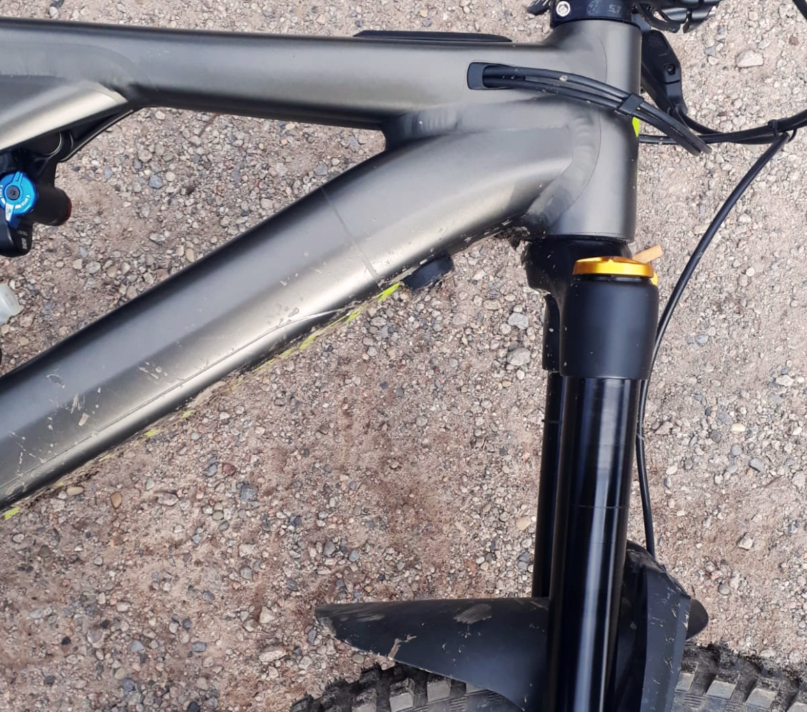

While we are already at the topic of rubber bumpers, I don't like the fork rubber bumpers on the down tube of my Kenevo Comp 2021 with a single crown fork, or more precisely I don't like how early they stop the fork. Also they look a bit unsightly in my opinion.
I've checked the movement without them, and there seems to be only a couple of milimeters that the fork is too high to pass below the down tube.
So I'm looking for alternatives that will allow more side to side movement of the fork, does anyone have an idea or already replaced them?
There seems to be a version for the Levo SL 2020 which appears to be smaller, but I have no idea if the bore diameter is the same or if they actually allow for more movement.
The back up solution would be to get out my Dremel and try some DIY modifying. With uncertain outcome. ?
Apparently they're only required for the smaller sizes (or S2 only?), and they're normally not shown on presentation pictures either. So if you don't know what I'm talking about, here are two screenshots from a Youtube video (not mine):
View attachment 66311 View attachment 66313
Yeah, so I decided to dremel that thing now. Taking off the "horns" was enough to gain back enough steering movement, the down tube seems to be still protected well enough and it's not as ugly anymore.

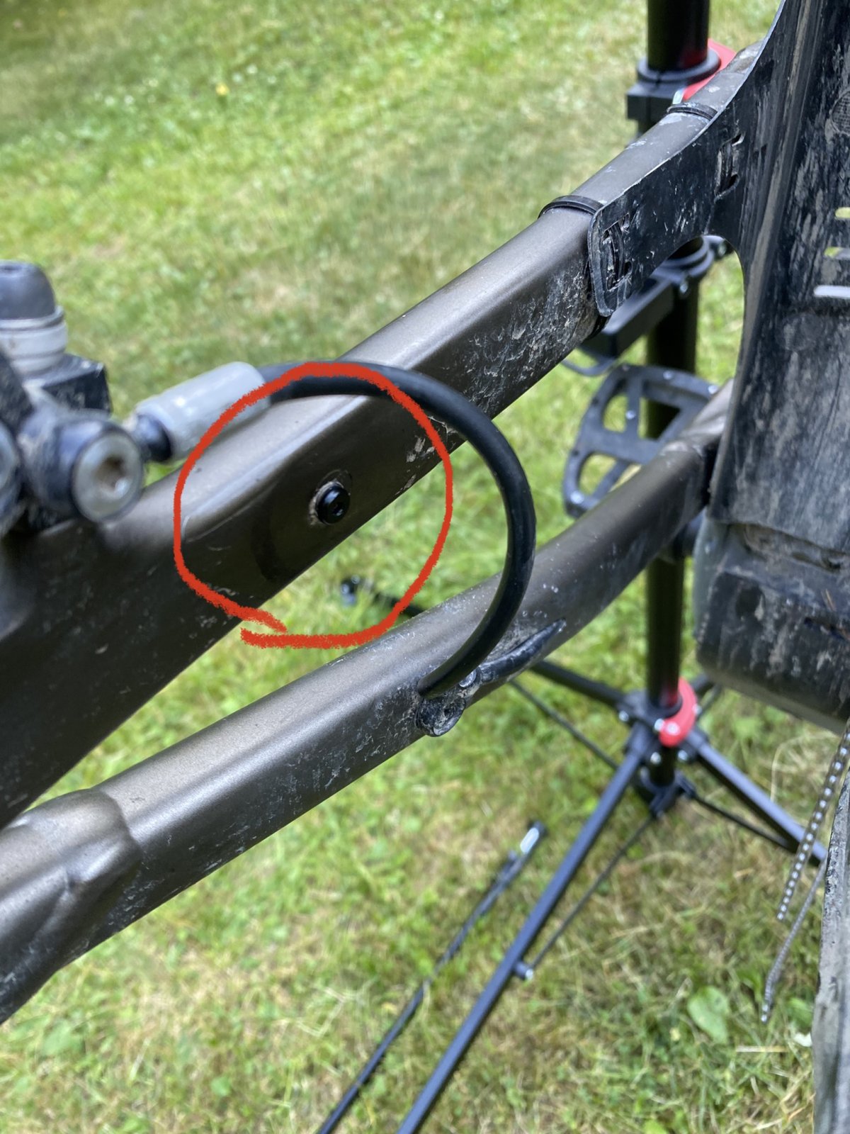

What's the function of this screw in the left chainstay?
Also, my Kenevo has developed an annoying creak when pedaling. Do the plastic covers creak like on the old Levos?

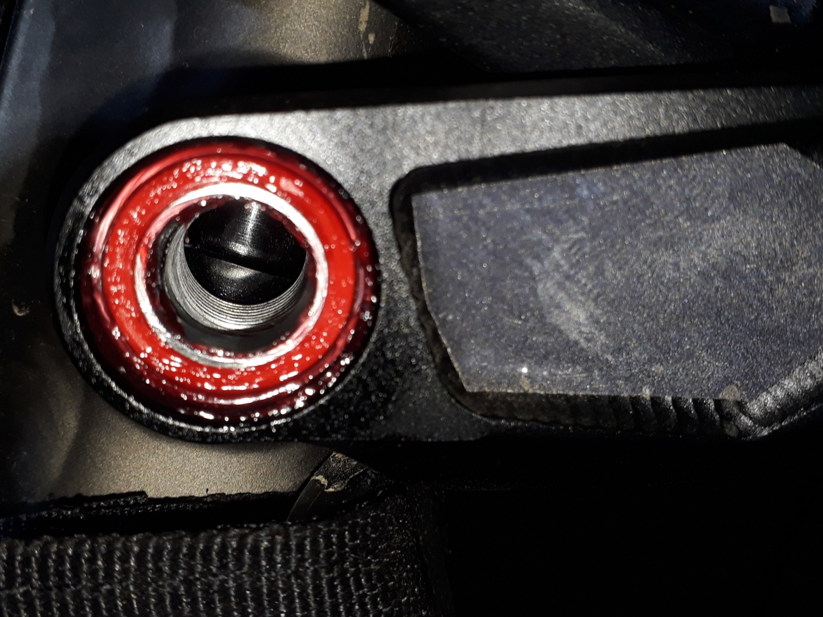

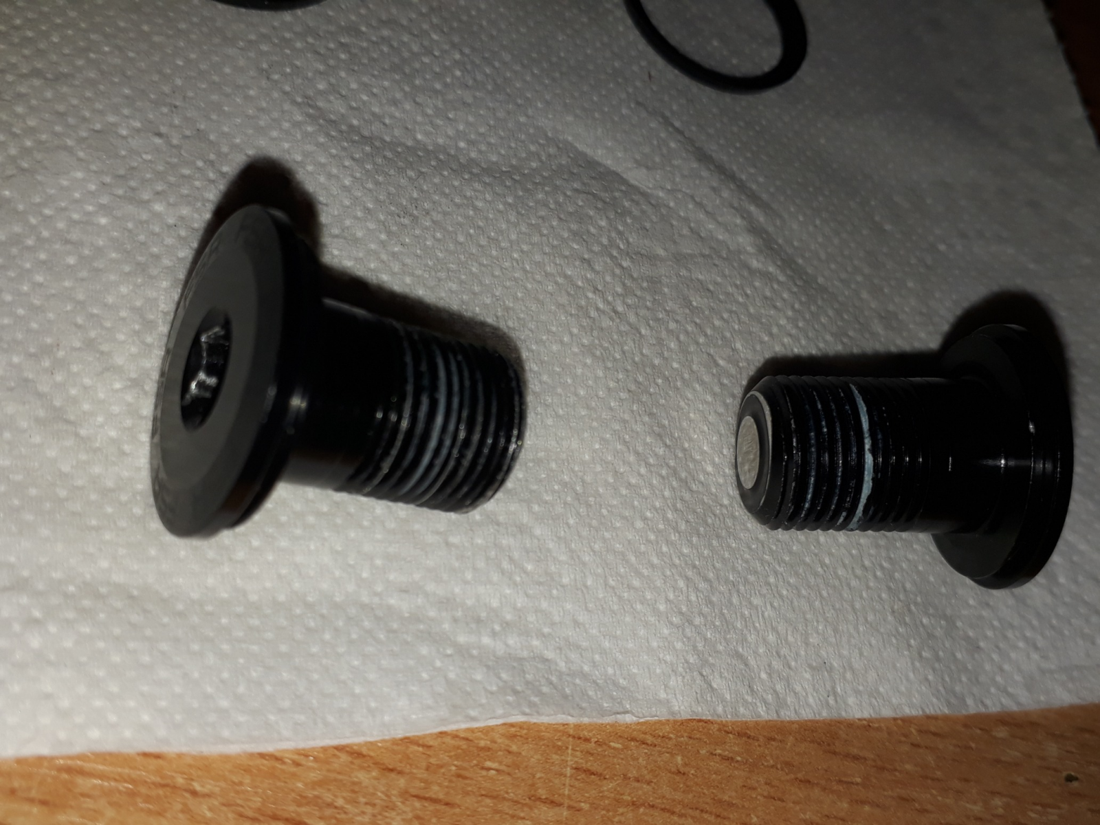

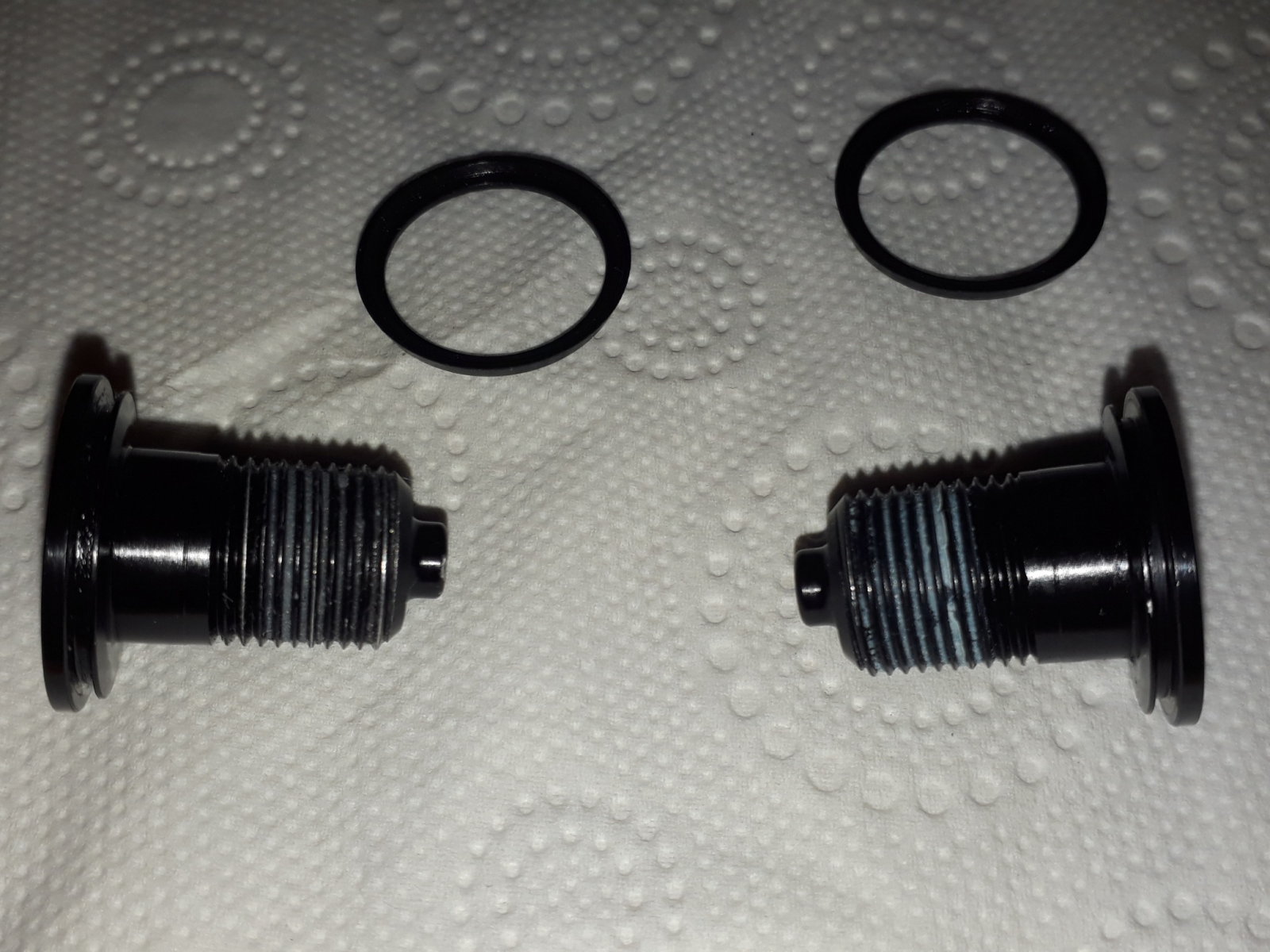

For anyone struggling with the seat post length on the S2 size frames and its limited possible insertion depth in the seat tube, you can gain around 20mm insertion depth by removing the "nubs" on the bolts that connect the link to the seat tube. Which in turn allows you to install a longer dropper post with more travel. And we all know that more is always better! :D
For whatever reason these bolts have these nubs on their end, which to me seem to serve no other purpose than to artificially limit the amount you can insert the seatpost into the seat tube. Maybe it's some sort of well-meant but poorly executed frame protection, to prevent the seatpost from scratching the seatube from the inside.
With these nubs in place, the available space in the seat tube for an S2 size frame is around 195mm. Without them, it's around 215mm. Which allowed me to replace the 125mm X-Fusion Manic with my existing 170mm OneUp Dropper v1 post. Before modifying the bolts, I needed to limit the travel of the dropper post to 140/150mm - which is still better than the 125mm that comes with the bike, but rather annoying if you switch from a bike where you were able to use the full 170mm.
Also a shameless plug to my overview page of dropper posts and their dimensions, which can help you get the most possible travel (without any claim of completeness):
http://sp00n.net/bike/seatposts/
Anyway, pictures:
1) The bore in the seat tube. No visible reason for these nubs whatsoever, the thread goes in all the way and the bore diameter stays the same as well. The black thing after the thread is already my inserted dropper post.
2) The bolts before modification. On the left bolt you can already see some marks where the dopper post touched the nub.
3) The bolts after modification. Dremel away!
(I would've made a picture with the nubs extending into the seat tube as well, but I really really didn't want to risk having to rewire the dropper post cable, which is huge PITA!)

I also ran into this when trying to fit a 170mm AXS Reverb as deep as possible in my S3 Kenevo, hacked the bolts ends off to sink it in where I needed it to be. Anyone looking to do this, just be aware that the cables that run in the top tube, through the sidearm, and into the lower seat tube will be damaged if you insert the post too far or if the post slips down.
Update: My LBS removed the motor, cleaned everything and replaced dropper post housing. Creak gone :) (y)
As for the mystery screw, like sp00n mentioned, it's probably a placeholder for alternative brake hose routing.
