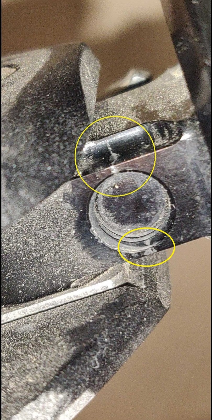

I haven't followed this thread for a while, so maybe this has already been reported.
Whilst searching facebook for a superdelux coil shock to buy (for another bike) I came across a post showing the superdelux cracking on the rebound thread.
I checked mine & have the exact same crack.
Im aware of the leaky bomber cr and the potential snapping of coil shocks exacerbated by the wrong spring, or too much preload, but ive never heard of this issue before. Cracked right through on both sides upto the chamfer, so about 5mm.
So check your shock.

Bike is going to berkshire bikes on monday to hopefully get the shock warrantied. I expect I will get a superdelux air back.

@cozzy Mine cracked in the same place. RaceCo changed it for a Fox DPX2. RockShox haven’t got any Super Delux airs and there’s no due date for them either. Rather than having no shock at all I took the DPX2. Not tested it yet but bought an Öhlins TTX as well. That’ll take a few weeks to arrive so I’ll run the DPX2 in the meantime.
I've ordered a cane creek kitsuma coil which should be here today. I've decided not to warranty the rs coil but am getting a price to have it repaired as the shock will fit another bike I own.
If it's too expensive or cannot be repaired I will warranty it and wait for stock of rs airshocks then maybe sell it.
Seeing as I've just had to service a 5 month old dpx2 that had cavitated, I'm don't really want another as I dislike air shocks in general. Never had one last more than 10 months or so. There again the last 2 coils ive owned have failed. :ROFLMAO:

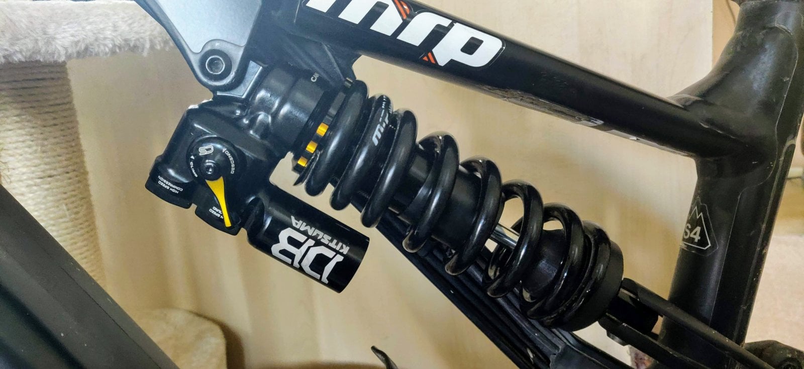

Shock arrived & fitted. The spring adaptors supplied are too tall for my mrp progressive coil so have had to only fit 1 for now & ordered some hopefully shorter 38/36 adaptors for each end. The space available to fit a spring is much smaller than the standard superdeluxe. Certainly the stock RS spring is far too long.
May end up getting a cc progressive coil but I don't like the white colour it comes in.
Price to fix the cracked superdelux is £120 for the part, eyelet & shaft assembly, but obviously no stock. No rush though. I have nearly another year to decide if I want to warranty it or get it repaired.

Very cool CC Kitsuma, it looks great!!!! Aren't you afraid that it will break the same as the RS or Marzocchi coil shocks??
I believed that the problem of broken shocks of the Kenevos was due to the suspension system, the link, etc ... that is to say that it is not a problem of the shocks, but of the design of the bike.
So if you put another coil shock on it ... it could easily break anyway.
Am I wrong??
This was recommended as it has a solid steel shaft compared to hollow shafts to accommodate the rebound gubbins when it's at that end of the shock. Plus I have a correctly sized spring with minimal preload applied.
I gather other coil shocks are also suitable, the ohlins and the ext, maybe others due to larger and/or solid shafts.
The marz was always cheap garbage and the superdelux not that much better.
The only shock I've ever owned that hadn't failed was a cc db coil, so I have high hopes for this.

@cozzy the new shock looks pretty sweet. Annoying about the spring adapters not fitting but it shouldn’t take long to get the correct ones. £120 for the parts plus whatever it costs to rebuild it is still cheaper than a new shock. I’ve heard that the Super Deluxe coils are cracking around the rebound adjuster on all bikes not just Specializeds although the added stress on the shock due to the design of the linkage on the Kenevo obviously isn’t helping. Something to bear in mind should you decide to pay to have it rebuilt.
@MEDUIX there have been a lot of issues with the shocks on the Kenevo. Some of it due to the linkage design, some due to the shocks not being robust enough and some down to poor setup. With the correct shock and spring then hopefully there should be no more problems. I went for the Ohlins for the reasons listed by @cozzy.

@Stompweaver I couldnt find anything about cracking superdeluxes online apart from the facebook post I added a few posts back, this info should be out there really as I guess the eventual outcome is it cracks all the way across & the eyelet falls off :eek: I would never have discovered this crack without seeing the post about it.
I got my mate to check his & no signs of cracking although he will be keeping an eye on it now :)
Its quite the weak spot when you look at it, they shouldn't have machined it down so much.

@cozzy it was a reputable source that deals with a lot of suspension/bikes so it's likely that there are other failures of the Super Deluxe given how little material there is in this area. As you said it's heavily machined down. Our bikes put a lot of stress through that point so it's no surprise that we are experiencing the first, and most, failures.

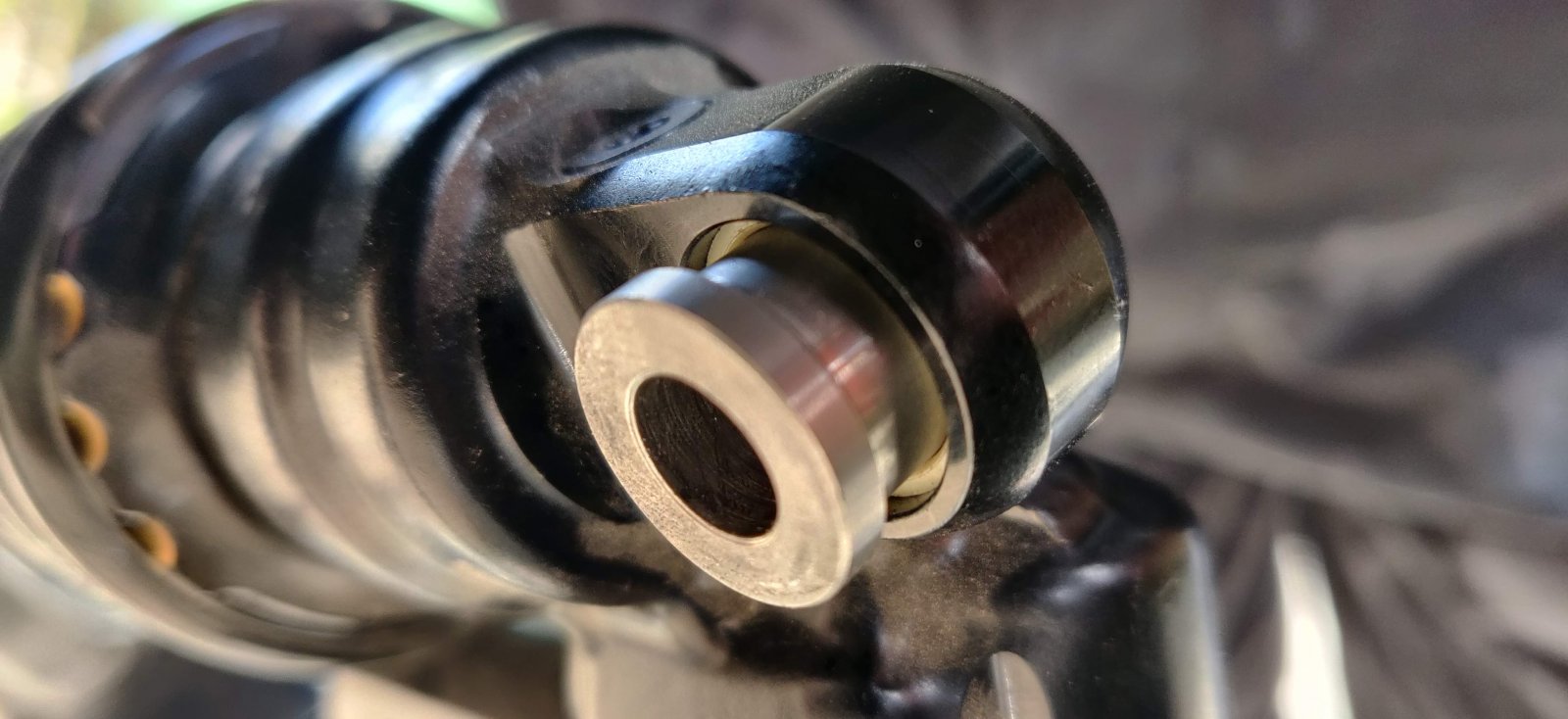

Im not particularly sensitive & have been guilty of leaving the lockout on & not noticing until ive been thrown into the scenery multiple times in the past (not this bike!) but my god the kitsuma feels bloody brilliant. A significant upgrade on the RS coil. I felt absolutely no need to touch any of the dials after initial setup with lsc/lsr in the middle, hsr to suit & minimal hsc & I think any tweaking could have messed it up.
Really really pleased with the shock.
A slight issue was with the mounting hardware. Its chamfered which the supplier claims to allow some float, fair enough, but due to the chamfer allows the hardware to intrude into the eyelet, which in this case has pushed the bush out by a small amount leaving the shock misaligned.
As we know the specialized yoke design is a bit harsh on rear shocks, so i've refitted the original mounting hardware which will not allow this to happen.
