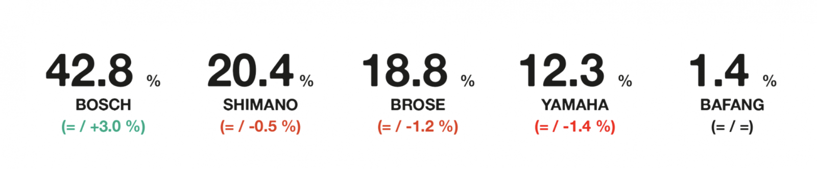

I dont think the Levo and Kenevo have sold anything like as much as the other brands combined - they are a popular choice, but expensive bikes with a limited market, the majority of EMTB's sold are at lower price points, with the number of Bosch and Shimano motored bikes out there far outstripping Brose - I would be surprised if they even accounted for 10% of EMTB sales.
If you look at the results of Ebike-Mtb's reader poll from 2020 (13,500 responses) you can see that Specilized accounted for 16% of ownership. The most in use motor by far was the Bosch with 42%.

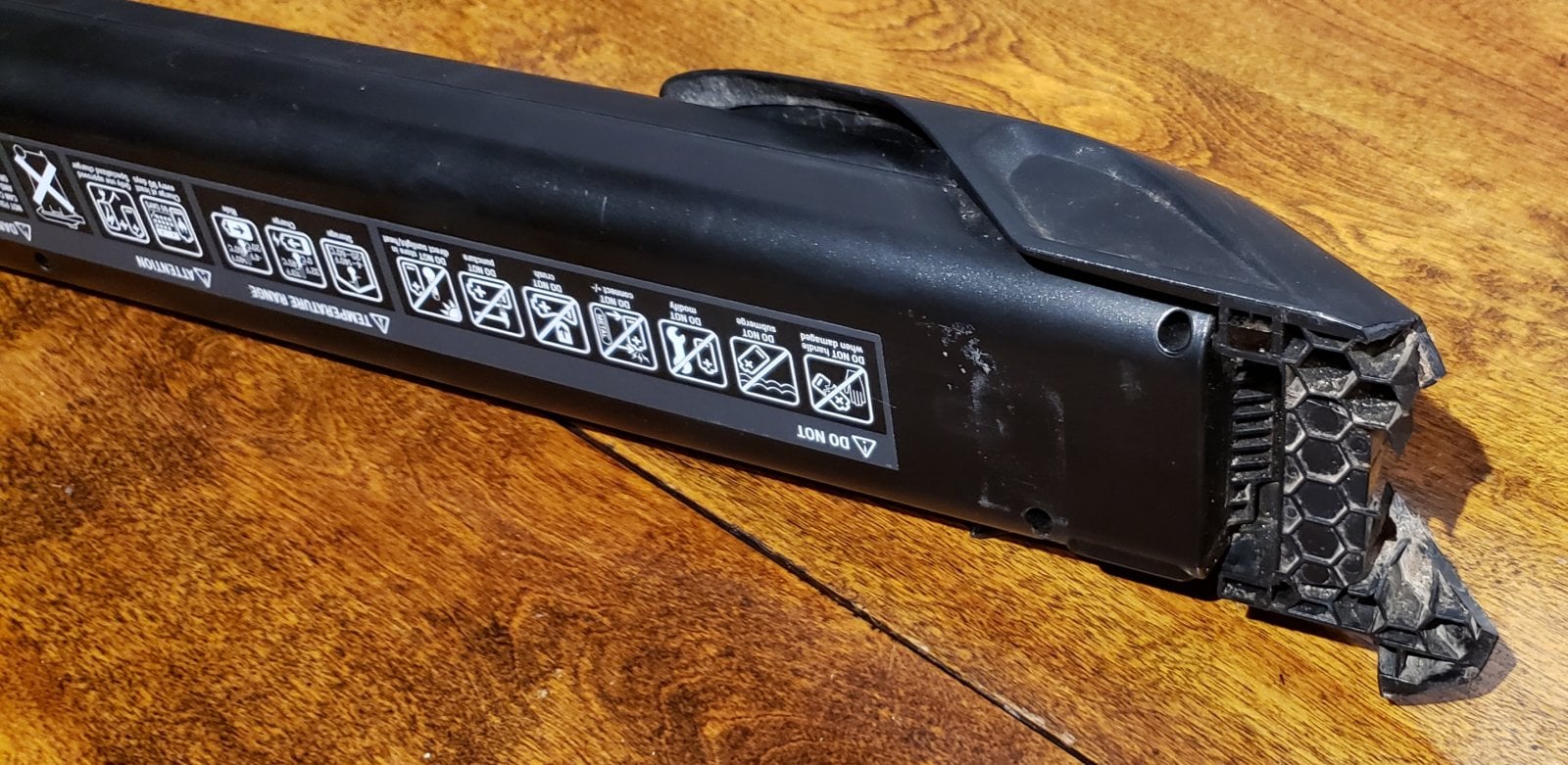

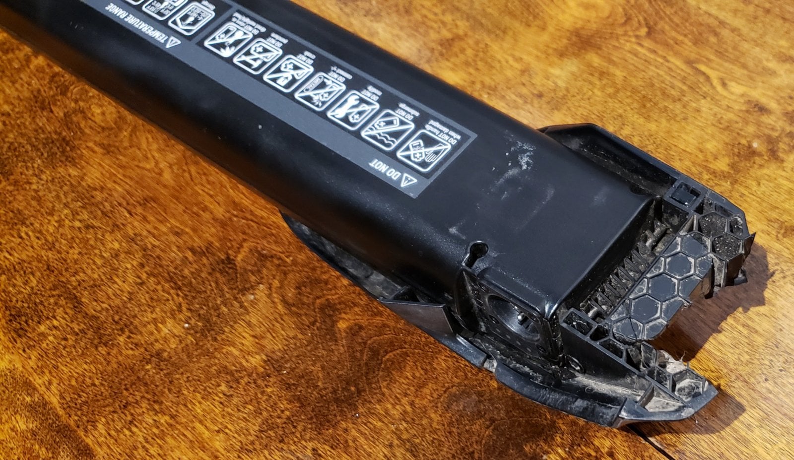

Just wondering if anyone else has smashed the bottom bracket hard enough or often enough to break the lowest edge of the battery case? My Kenevo is now missing a big chunk out of it battery case. Its not from hucking to flat on anything huge or anything else a bike should not be able to absorb (suspension wise) but from the bike's inherent low BB design. I guess I will have to learn how to be lighter on my wheels.
Since there is a big chunk missing, I would like to replace that part of the battery case. Has anyone done that? Cost? part number? I hope you don't have to buy and entire battery!
Since there is a big chunk missing, I would like to replace that part of the battery case. Has anyone done that? Cost? part number? I hope you don't have to buy and entire battery! View attachment 54289
View attachment 54290 View attachment 54291
Cracked my old Kenevo battery protector trying to be a hero attempting some trials work coming out of a trail. Lesson learnt!
You can buy the protector on it’s own for about $100 Aussie. Easy to replace

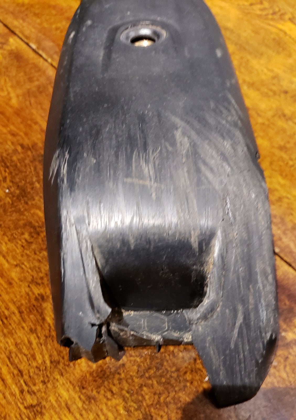

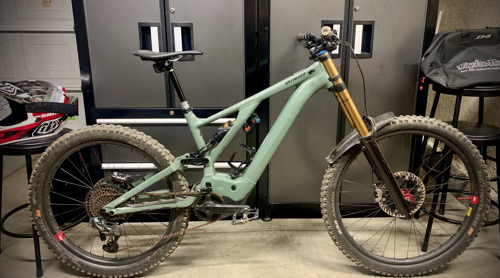

Yep done that! Solution to the problem: SPECIALIZED - ROCKGUARDZ
This piece has paid for itself 20 times with all the damage it has taken. Still going strong 10 months in.

@bushkila Thanks for help in finding the battery cover case. I find it to be a tad ironic that someone at Specialized called a piece of thin, honeycomb plastic, a ROCKGUARD kit. Then again, we all ride in different places around the world and I guess its not a high impact spot for many. After finding out what the part was called, the LBS 2 hours away, has 13 in stock. They must know something...
#lazy

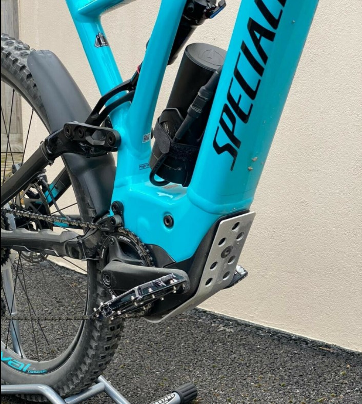

I put on this protection , does a good job and looks ok !

How is that battery protector attached?

It doesn't look like its attached to the motor bolts, only to the battery mount bolt. I would have some concerns about an impact transferring the energy into the the battery mount bolt though or still impacting the rounded end of the battery cover in only one place (the bracket looks flat and not shaped to the actual shape of the curved shape of the battery cover) . On the next Kenevo model, I would like to see a proper aluminum skid plate, with multiple attachment points or maybe a higher bottom bracket.

If you hit it with a rock hard enough to break a 8/10mm bolt then without the guard you would’ve destroyed your motor/battery covers ! It’s not bombproof ☺
They give you foam for a snug fit .
