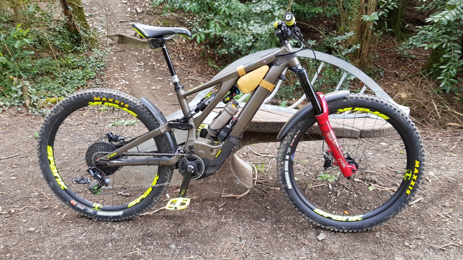

Just thought I'd chuck this up here and say hello :)
2020 Kenevo Comp with a radically altered spec. Went with the comp as I already had a 700wh battery and a Lyric that I absolutely love. Other upgrades include the Spank Oozy rims on Hope Pro 4 hubs, AXS Reverb 150mm, Fox Float X2 shock, Renthal bar and stem, and 155mm cranks (to reduce my knee bend, as both are shot to bits). She gets ragged regularly, but takes all the abuse I've thrown at her. My only issue has been the battery wiring harness, which was replaced under warranty and was apparently a known issue. If and when I ever get it, she'll be complemented by a Levo SL. If I get the range from it that I hope I will, I'll be selling the 700wh battery (one careful owner) and sticking with the 500wh one on the Kenevo.
Nice rebuild!
How do you like the air spring in the back? as compared to the stock coil?
Thanks!

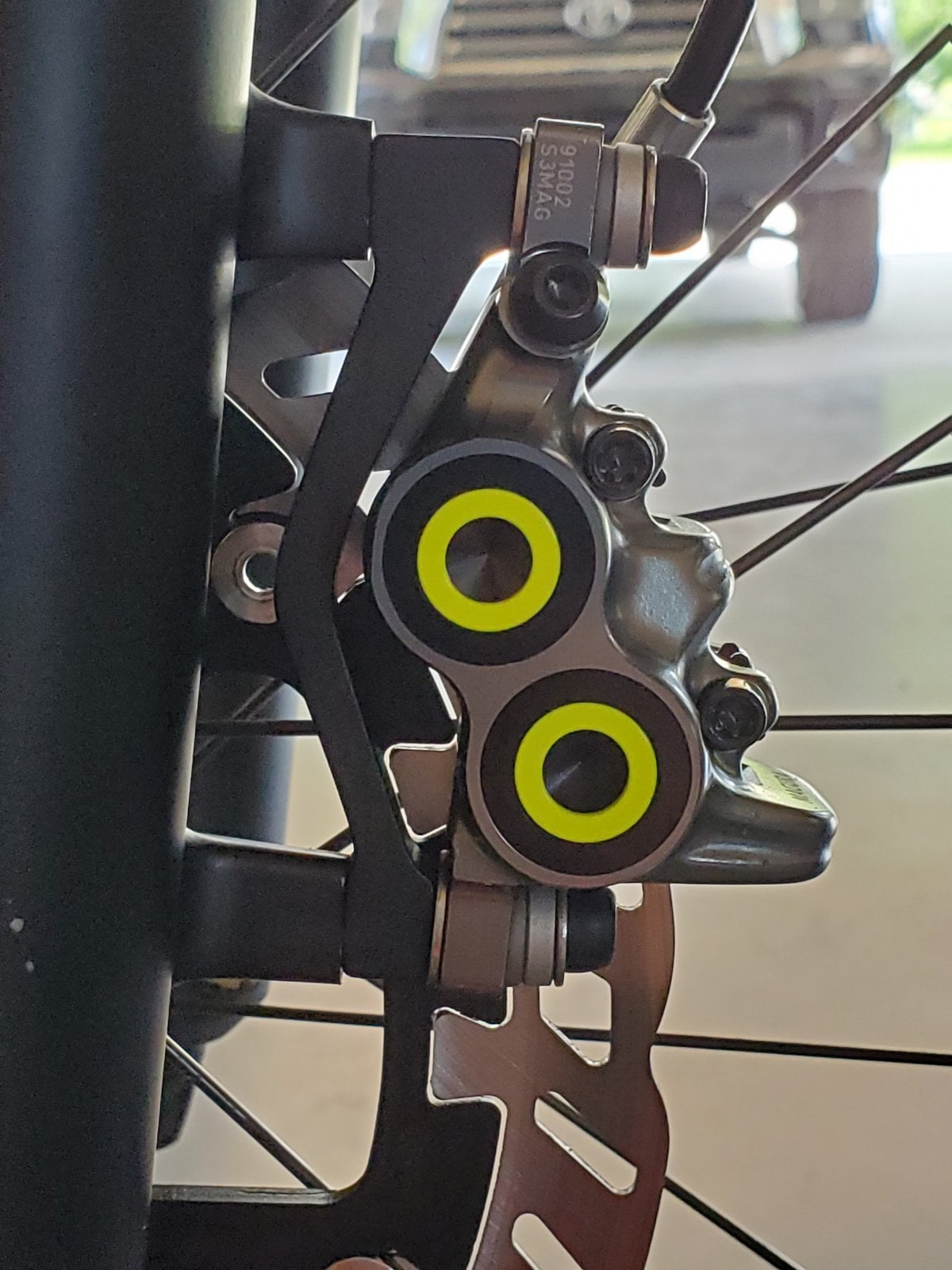

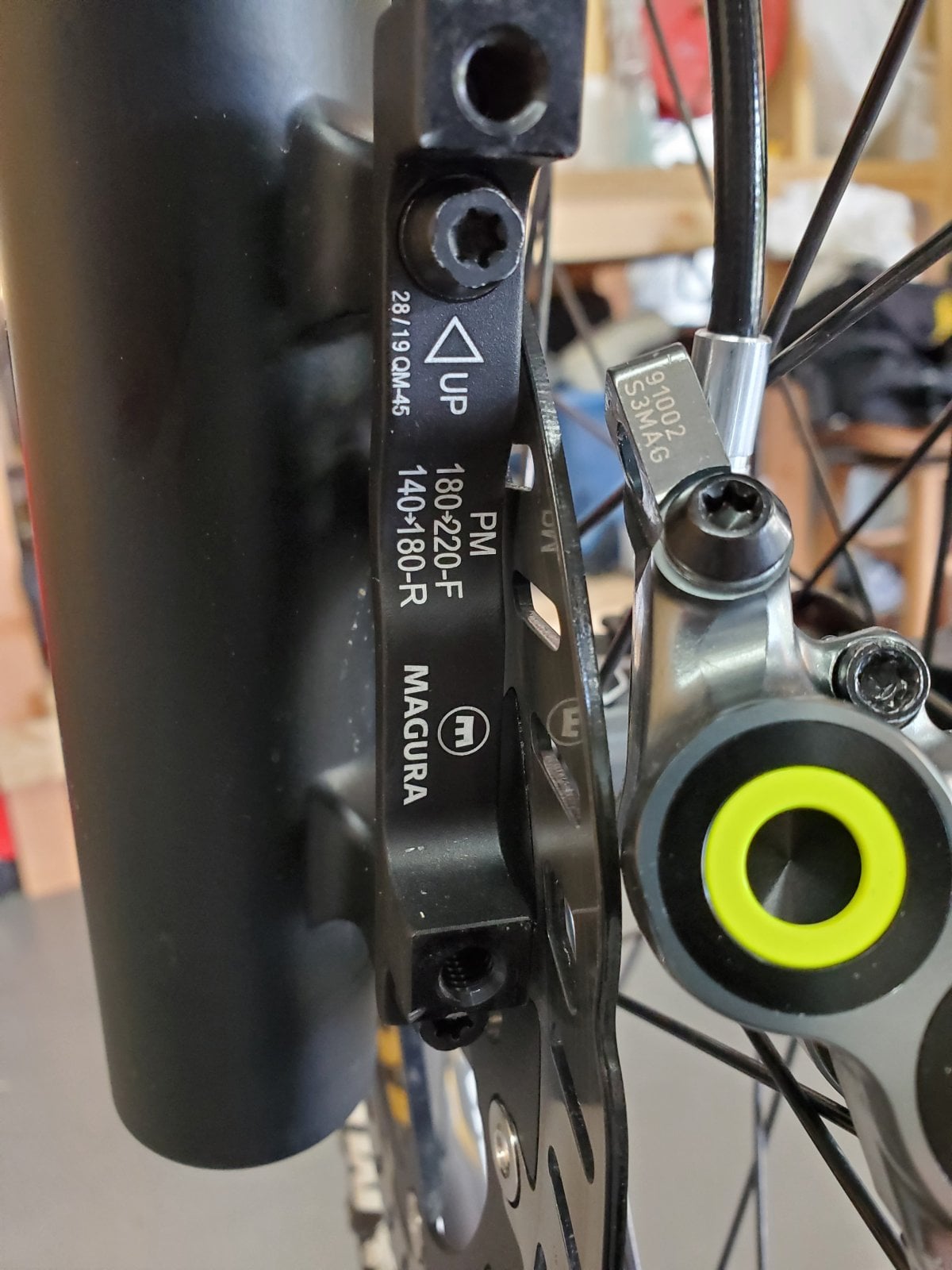

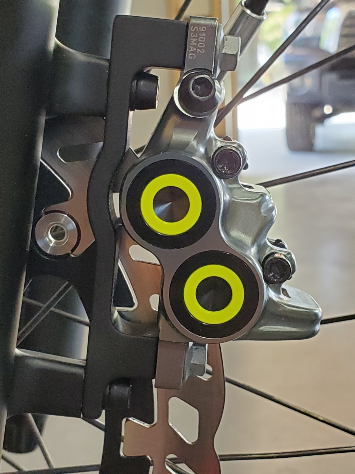

Ok so what am I missing here? I'm mounting the Magura MT7 on the Magura 220mm rotor on my Kenevo with the Boxxer fork. I was told to get the Magura QM-45 adapter to mount it. As you can see it is not even close. Pay no attention to the mounting bolts on the caliper. The third picture is where I took the stock adapter off the rear, added a washer between the caliper and the adapter and it is much closer. Not perfect I don't think because I get a pretty good screech sound which I think is a misalignment sound. Any thoughts?

The Boxxer has PM8. This is the direct mount for 200mm rotors. So you need the QM40 adapter for 220mm rotors.
The QM45 fits on the rear with the 220mm rotors, because there's a PM7.
