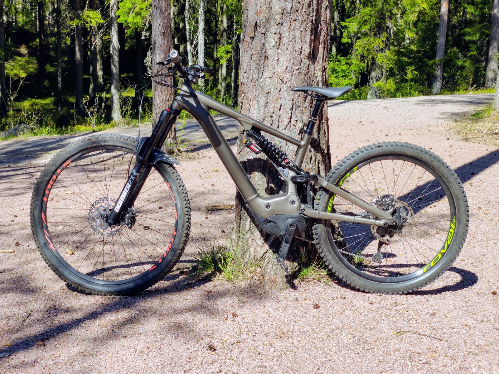

Here's another test drive with a mullet. Front tire is Maxxis DHR II 2.3. Pressure 1.5 bar
Have to take one spacer away under the stem.
Tire size can also be 2.4 WT I think.
More precise steering, easier and faster on the root/rocky sections. I'll keep it, until the muddy season starts
More precise steering, easier and faster on the root/rocky sections. I'll keep it, until...
Have you played with the flip-chip? The HA is pretty slack mulleted, right?
One of the drawbacks with the stock bike is the BB height, I think. I have so many pedal strikes and numerous hits of the battery cover on my local trails. Rocky/rooty terrain...
So it is tempting to mullet, flip or both.
Didn't touch the flip-chip. I like slack HA and bike feels so good after reducing stack high of the bar

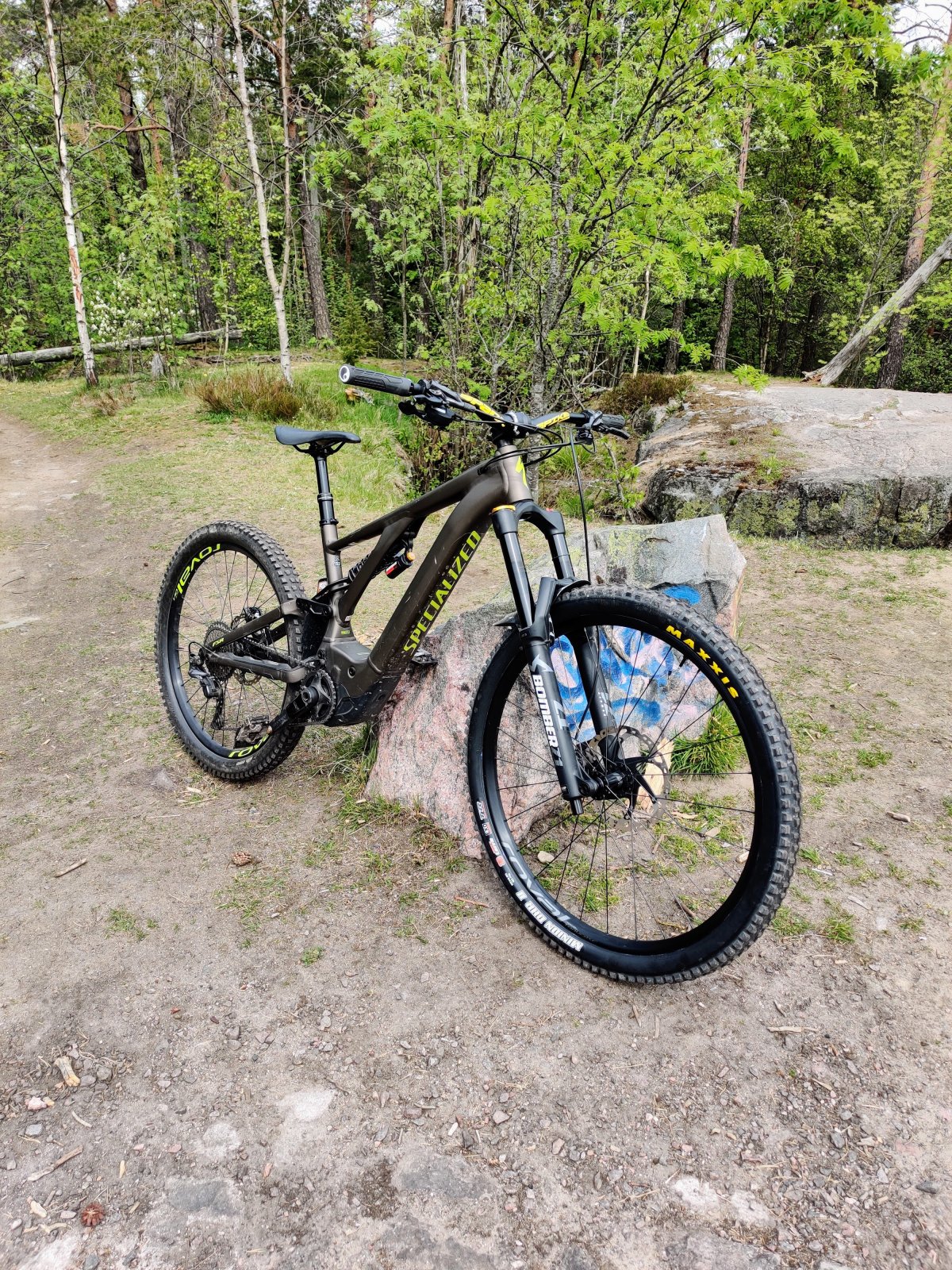

Now after I have ridden Mullet Kenovo couple of weeks, I can say it's the best combination for a smaller guy.
My Kenovo size is S3
Bike parks, rocky and rooty trails it's much better combination.
Thanks for your thoughts.
How tall are you? It is very tempting to test the mullet set-up. The 27.5" lack roll-over ability over the 29".

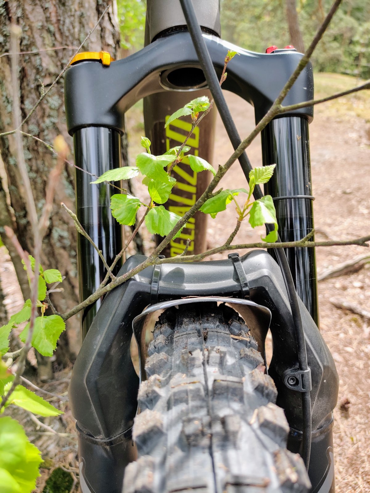

Update to my Mullet project.
Just installed Michelin Wild Enduro 2.4. Clearance is ....hmmm. enough. Not for a mud ride, but good for other rides.
Hope the steering stays as precise as with 2.3 size tyre...tire...what ever.
