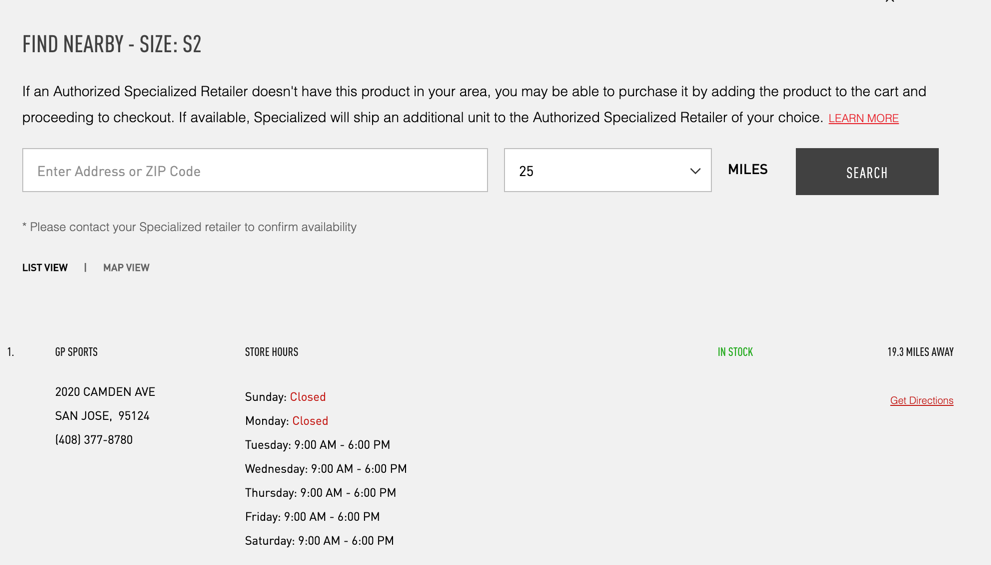

So does anybody outside the US want to sell me a 2020 Kenevo expert S2 and ship it to the US? Was supposed to get mine at the end of February but just found out it wont be until August. I picked a bad time to sell my 2019 Levo. The only one I could find in the US is an S3. I'm 5'6" and just assumed an S2 would fit better. Any thoughts?
Rittiman
Mar 17, 2020
El Dorado Hills
Don't know where you are located there is a S2 in the Bay Area.
https://gpsportsonline.com/Specialt...-Jose-CA-3d422e69-1082-4dee-9e46-ab57007f576b
Shimanomike
Jan 6, 2019
24
27
Paris, Tn
Thats crazy. If you talk to a local dealer, nobody has one in stock. Sounds like they dont want to share sales. Anyways, I called them and they do have one but won't ship it. They do have a person that delivers their atv's they sale to within 5 hours of me in April so I'm guessing I will go that route. Scares me a little to pay for something like that only trusting to receive it but what do you do.
Shimanomike
Jan 6, 2019
24
27
Paris, Tn
I can ask my local guy if they’d send you one from Aus if your that desperate?
I think I have located one. Yes I was panicking because I'm not used to being without a bike. I put my 19 Levo up for sale and 2 days later it was gone. I never thought it would go that quick. Anyways, I think I can wait until mod April for one. Thanks for the thought though.
