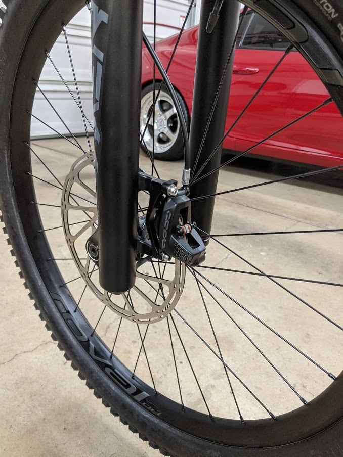

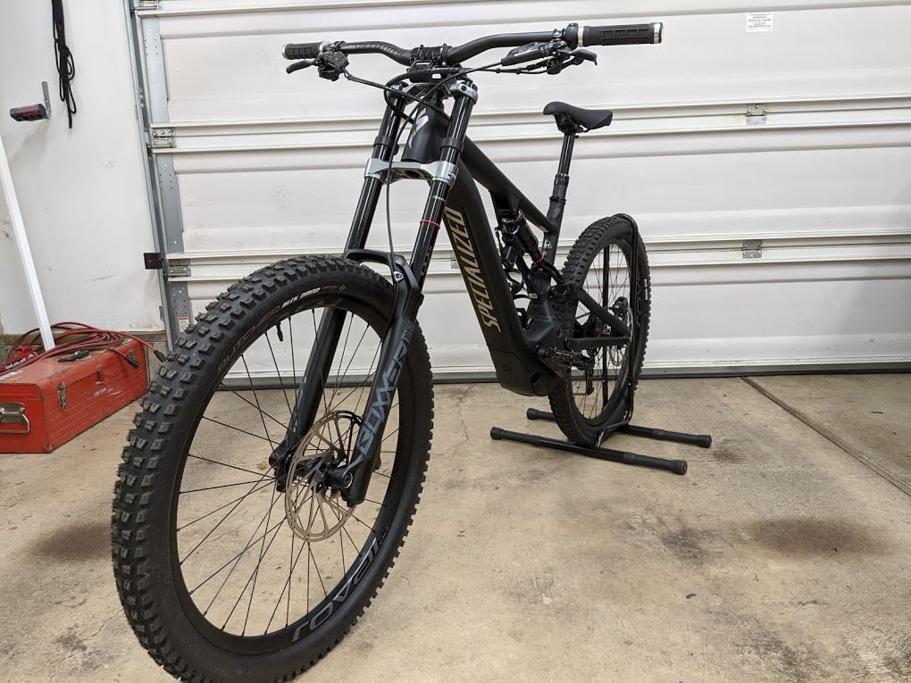

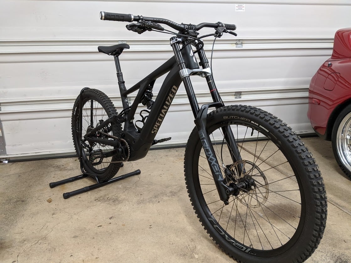

Here is mine...... 37 miles on the ODO.
I used a 20mm Avid caliper adapter to fit a 220 mm Rotor

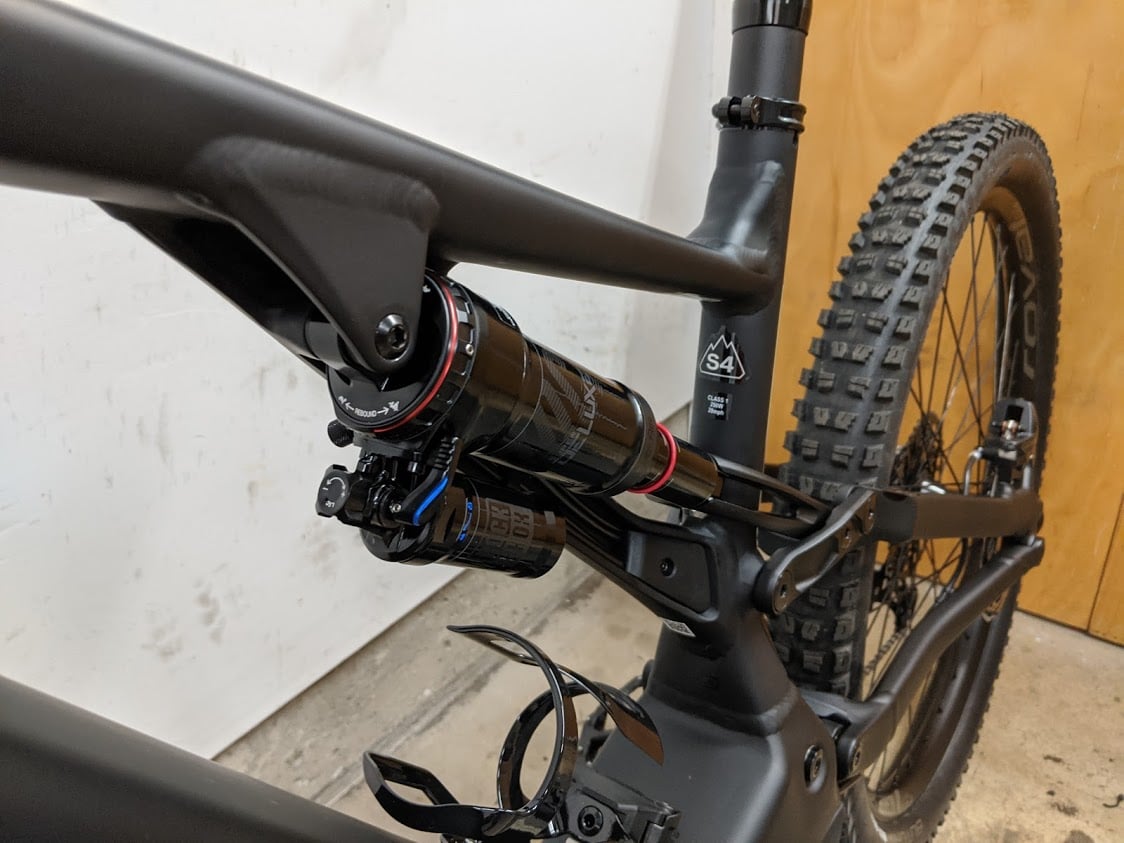

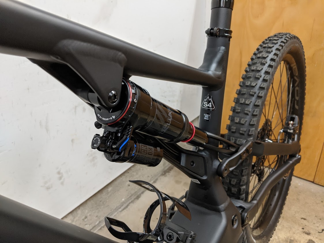

Interesting - brakes are opposite and two shockwiz thingies going on there.
Interested to hear how the rear shock goes - which model is it?
Yes, in the U.S. we run mostly Right hand rear/ Left hand front. A few people do run what we call "moto style" like you guys. Yes, Shockwiz front and rear for tuning.
For shock info see below. I only have one proper ride on the air shock, and it was pretty good but lacking in mid-stroke support. I have jammed it full of air tokens and adjusted the sag, so we will see how that goes.
Could you please post a close up pic of the front brake setup?
This work? Its a 20mm adapter. I had to source proper bolts for it.

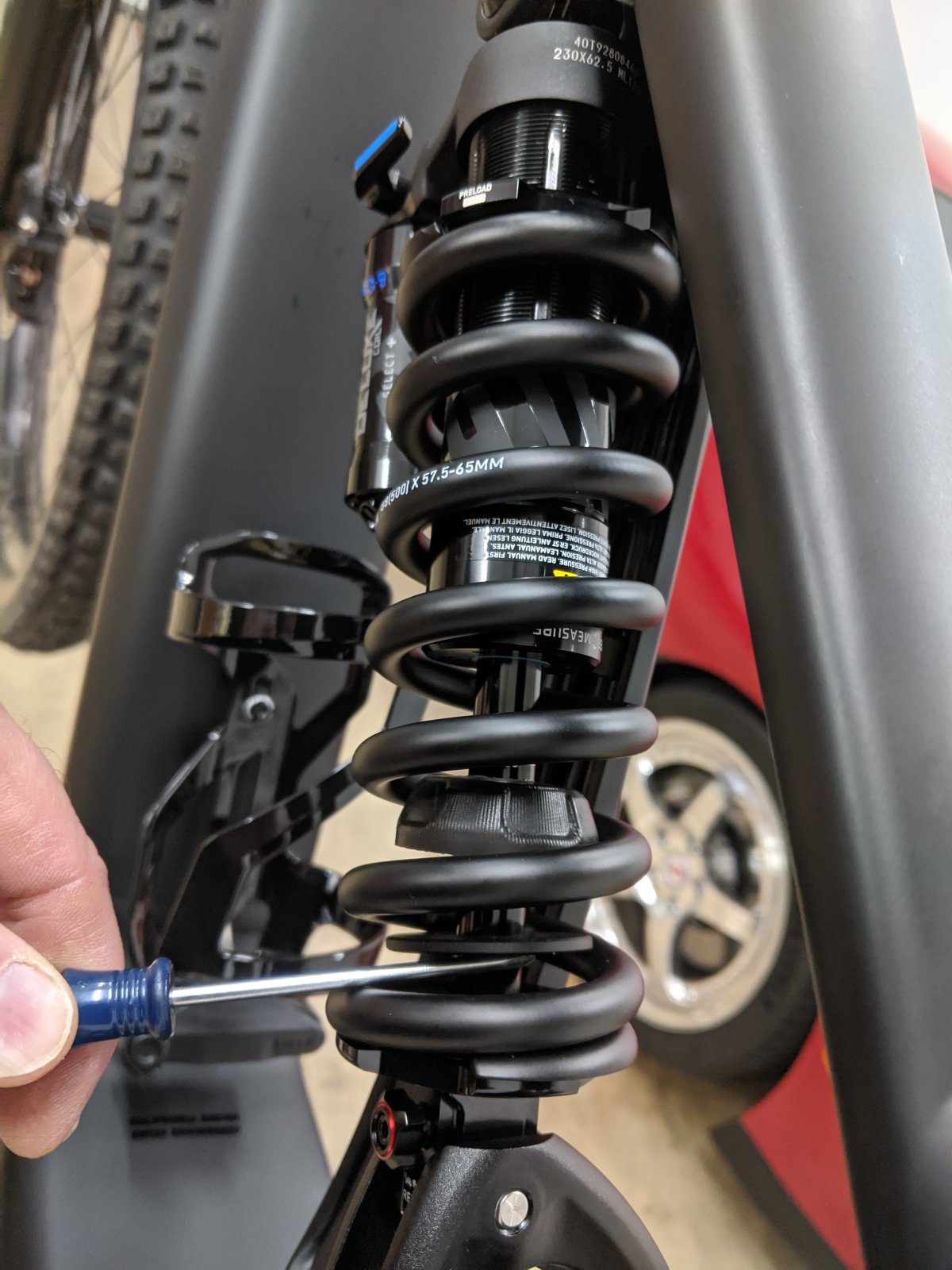

"Rockshox Super Deluxe Coil Modified to 230x65mm" How it is done?
There is a spacer under the bottom out bumper that I removed. This worked for me, but your experience could differ.

No problems at all in full compression ? Had you just cut out the spacer or take everything a part to take it out ?
Thinking about go 190 - 188 already :)
