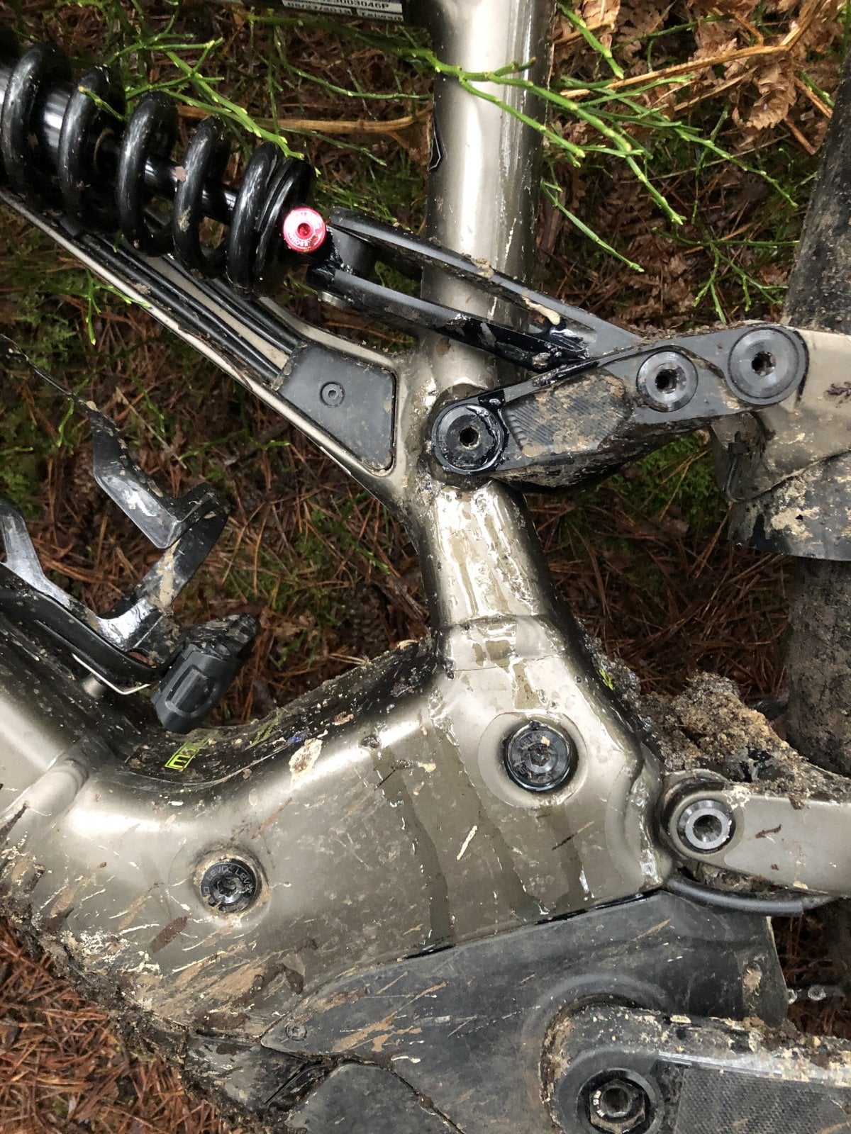

My Bomber CR just exploded.... on a 4 day old bike ?

Marzocchi shocks blown AGAIN ☹️
After riding no more than 150 km, mine exploded too. LBS said me: this problem happened already several time to others riders, due to original Marzocchi‘s torque assembly is not right for Kenevo application.
They made full maintenance to my shock and put higher torque. No problem after 150 km more.
You can add me into this club too.
My Marzocchi Bomber CR shit itself at the weekend while trail riding in the Surrey alps.
Bike looks like its crying and I feel it's pain as this is the 3rd component failure and I am yet to cover 100 miles! No motor troubles though (touch wood).
