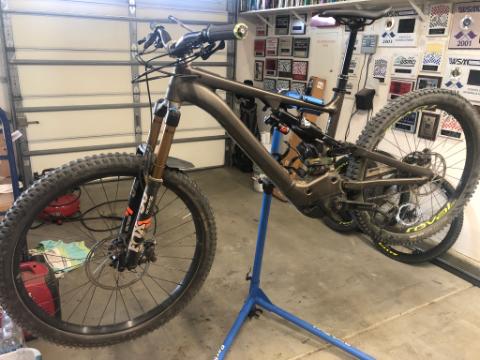

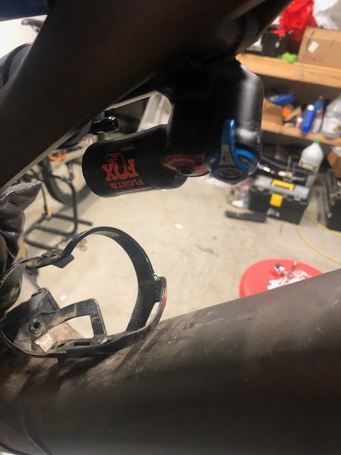

I've now cannibalized both ends of my FIrebird 29 to put on my Kenevo.
I really like the 29" front now, so I'll get 29" forks for the Kenevo, and just switch between a 29x2.6, and 27.5x2.8( I built a pair of 35mm i.d. wheels).
Blew the living hell outta the POS Marz shock today(ejected the shaft, and I think its bent), and since I couldn't find a DHX2 anywhere that could get it to me by tomorrow, I stole the X2 off my Pivot as well(low and behold it's 230x65mm) I ordered a DHX2, and if I like the X2 on the Kenevo(hoping it creates more pop), I'll put the coil on the Pivot. I've wanted a coil on that thing anyway as it doesn't have problems popping off anything, thus I'd prefer to take advantage of a coil to keep the rear end glued. Plus, it's only about 30lbs. It can take another couple hundred G's no problem

Good day.
You must be the first one I know of to install a Float X2 on the 2020 Kenevo. I was waiting for someone to try this, I was not sure there was enough room for this shock due to the side arm.
A few questions if you don’t mind:
1. Have you checked clearances? Is it really close?
2. Did you ride the bike? Have you seen any rubbing anywhere due to the tight fit and flex during riding?
3. Do you plan to keep it at 65mm stroke or shim it down to 62.5mm?
Thank you in advance for the help.

Good day.
Brgds/Nikolaos Tsivis

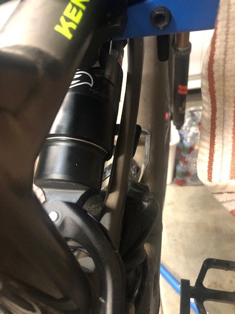

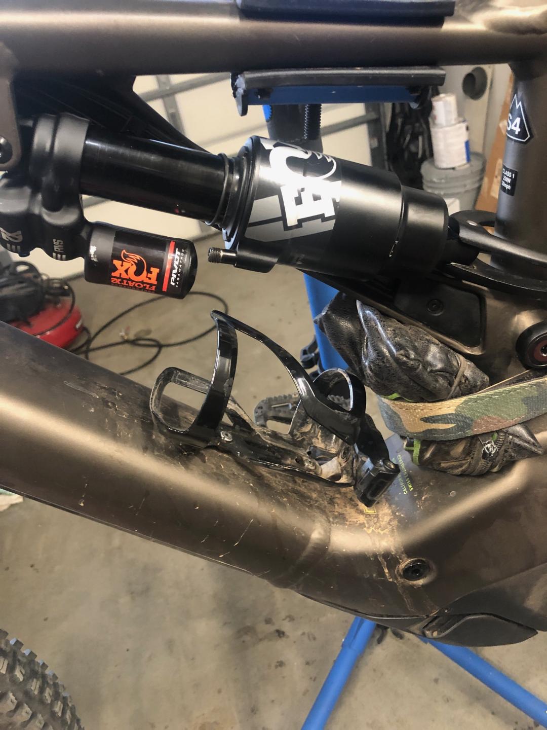

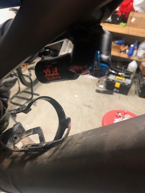

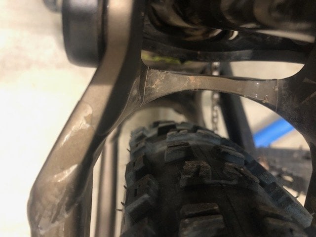

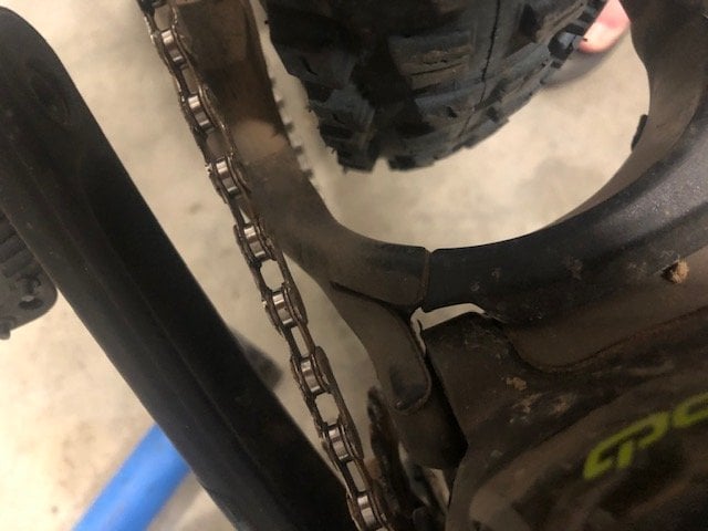

I'm not sure what you're talking about as far as clearance is concerned.
Are you referring to the extra 3mm of stroke? If so, I've got plenty of rear tire clearance with the OE 2.6 tire. Looks like even a 2.8 would fit, but I personally have no plans to swap out to a bigger rear. I like as much front traction as I can get, but like the back end to slide around when I want,
If you were referring to clearance around the shock itself, there's no problem there. It fits without touching that brace.
I just installed it yesterday and today it was a rainy day here, so I'll be riding on it for the first time tomorrow. Ill cut it a little slack because it's an air shock, but I like the shock to break into its travel sooner rather than later, and I like the tire to follow the terrain instead of bouncing all over hell's half acre. Where I'm riding tomorrow has some areas where you need to bounce from rock to rock, so I'm hoping the X2 gives it more pop. If it does that, I'll be willing to be more forgiving on the other stuff:giggle: Keep in mind however, that the X2 I'm using came off my Firebird 29, ie it's been valved for a bike with different wheel size, leverage curve, and of course, one that weighs over 20lbs LESS. I'm anticipating the valving being a little weak. If it works as-is good enough to keep, I'll just send it off to have it re-valved, and put the incoming DHX2 on the Pivot.
Either way, I'll report back here how it works
Edit: I just went out in the garage and let the air out so I could take pics showing the clearance at the tire, and around the shock. Hope this helps you.
Just to be clear, these photos are with the rear suspension totally bottomed out(y)
View attachment 26437 View attachment 26438 View attachment 26439 View attachment 26440
Good day!
Excellent info! Thank you so much for taking the time to advise in such detail!
Please report after testing the bike!
The poppy feeling is also something I am missing from the coil shock. The bike is just very heavy, although it tracks the ground perfectly and keeps the line like no other, the air shock will make it livelier.

So it was kinda how I expected. Valving was too light.
When I ordered the Pivot, the dealer asked me if I wanted the 'factory' or 'performance' X2. He mistakenly told me the only difference was the coating on the shaft. I'm a big believer in a separate high-speed compression circuit, as our local bike parks(summit, Mammoth) have a LOT of chatter, and other square edged hits If you don't have your HS compression dialed in correctly, by the time you get to the bottom of the hill your arms will look like Popeye's, and you'll have no control over your hands.
Anyway, I ended up with the 'performance' X2, and it didn't come with high speed adjust-ability. Long story short, the Pivot works well without it, so I left it alone.
Not so much on the runs today on the Kenevo. LOTSA rocks, holes, chatter, and other square-edged shit, and it desperately needed HS compression. I kept adding compression 4 clicks at a time, but by the time it actually started soaking in the chunder, the side-effect of losing rear traction had kicked in, and my tail end was trying to pass the front on a couple occasions.
I came away with this opinion: IF you were to go to Fox and order a FACTORY X2 specifically valved for a HEAVY e-bike(which they do all the time), you probably can get an X2 to work for you. ESPECIALLY if you're the type that prefers air over coil, i.e. you choose pop over smoothness.
My situation of trying the X2 'Performance' I had on another bike didn't produce results that would have me change my DHX2(coil) order over to an X2 however. It's ride-able, sure. It just didn't give enough control over the back end
I'll tell you something else I've learned with the '20-and this may cause some controversy here- In my experience with an '18 Kenevo and the '20, the '18's chassis IMO is MUCH more stable, and WAY less sensitive to setup. My '18 plowed down anything like a locomotive, turned just like a well made enduro bike, and jumped neutral. After one run down jumpline, I couldn't even feel its weight. In fairness, I pitched the OE Lyric(I hate SRAM suspension), and put on a G2 36. Kept the OE Ohins shock though.
The '20 OTOH, jumps like your riding a fricken semi, and has a terrible habit of dropping its nose. IMO Specialized took a BIG step backward with the '20 chassis. Even though it has MUCH more power, and with the addition of the 700wh batt(I bought it separately), I seriously regret selling my '18 for the '20.
