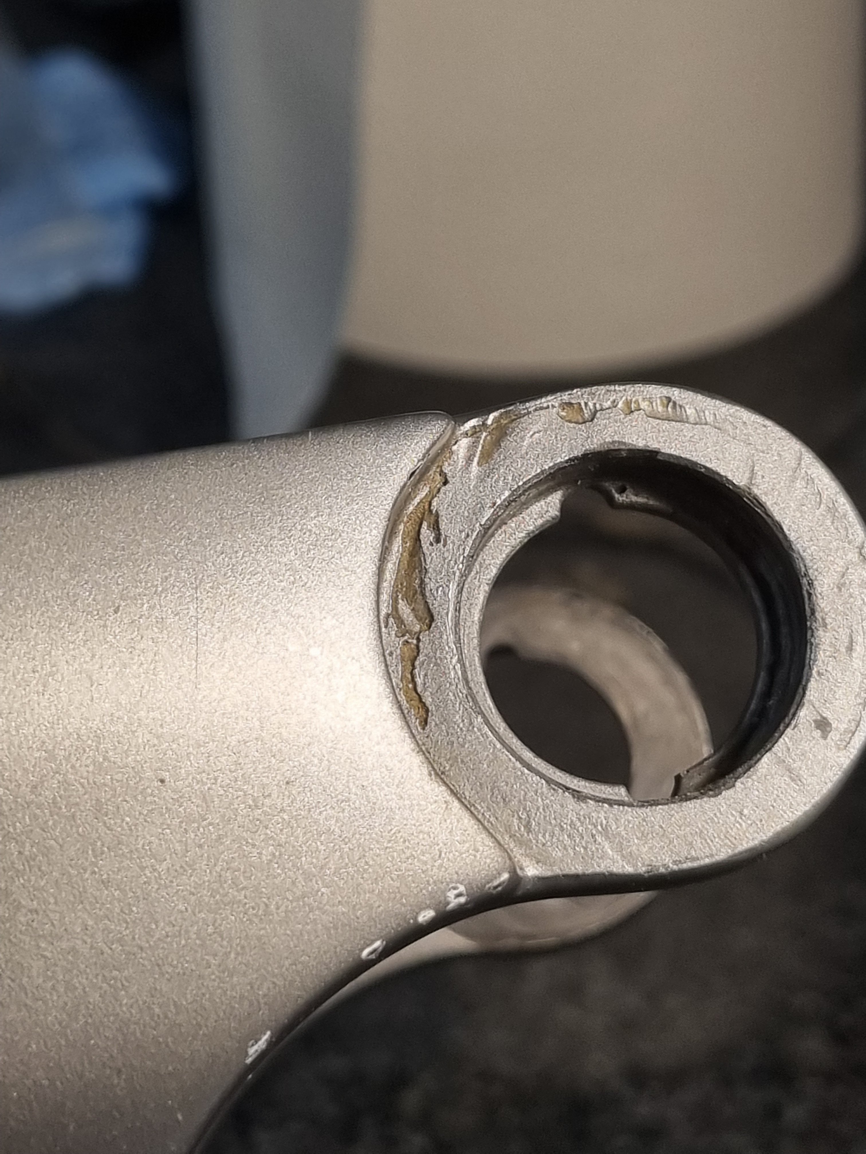

I'm not the only person with a dogshit quality E82 with incorrectly labeled parts no. Essentially every E82 sold up till October has this issue with torque tolerances. You'll find people have abandoned their Dengfu builds on their FB page due to safety concerns and poor tolerances.
Later frames have the correct spec etched on them. I wish I'd of kept the bearings so you could see just how thin and flimsy they are and how poorly they turned, it's like they where forced Into the frame rather then correctly pressed. The E82 is ment to be an enduro frame yet the bearings and axel didn't survive one tiny half a meter drop not even 150km into the bikes life... As for weather, well meh. My Nukeproof frames still on original factory bearings after 36000km over two years of constant use. It's not weather that kills them, it's poor quality and lack of service. Something I shouldn't of had to worry about after only 100-150km of use right?
I'm also guessing you have never had the pleasure of trying to deal with them for issues? Let's start with the ordering process. Order one thing receive another. During ordering I explicitly stated the size of the shock I planned on using (230x65) I was assured that the frame would fit the shock (it's even promoted as working with the frame in their promotional videos) Nearly 6 weeks after ordering the frame it was finally sent out, and guess what? The shock didn't fit the frame....... I'd then to wait nearly a month for them to send the correct size yolk out. I was also sent a charger that was completely useless for the bike I ordered. Again another 4 week wait for the correct one to be sent out. Again this seams to be dengfus way, as many people have issues where they Re sent parts that don't fit

And do you know how they made this 230x65mm shock fit? By grinding off some of the metal on a stock yolk and spraying it in black undercoat that does not match the finish of the rest of the suspension mounts. Something I could of done at home. Screams quality and great design don't it.

Photos are from the day I inspected the frame before painting after full disassembly

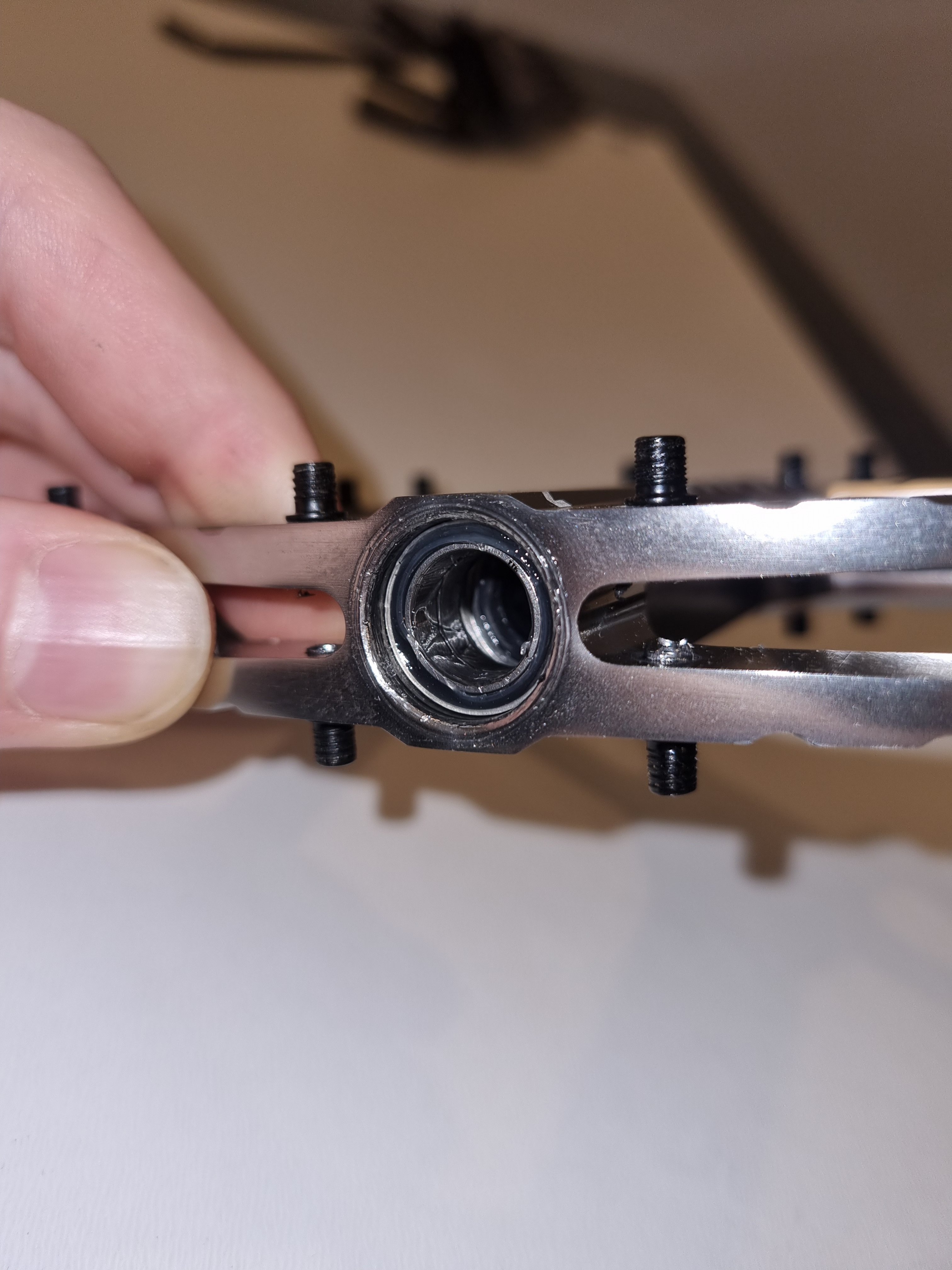

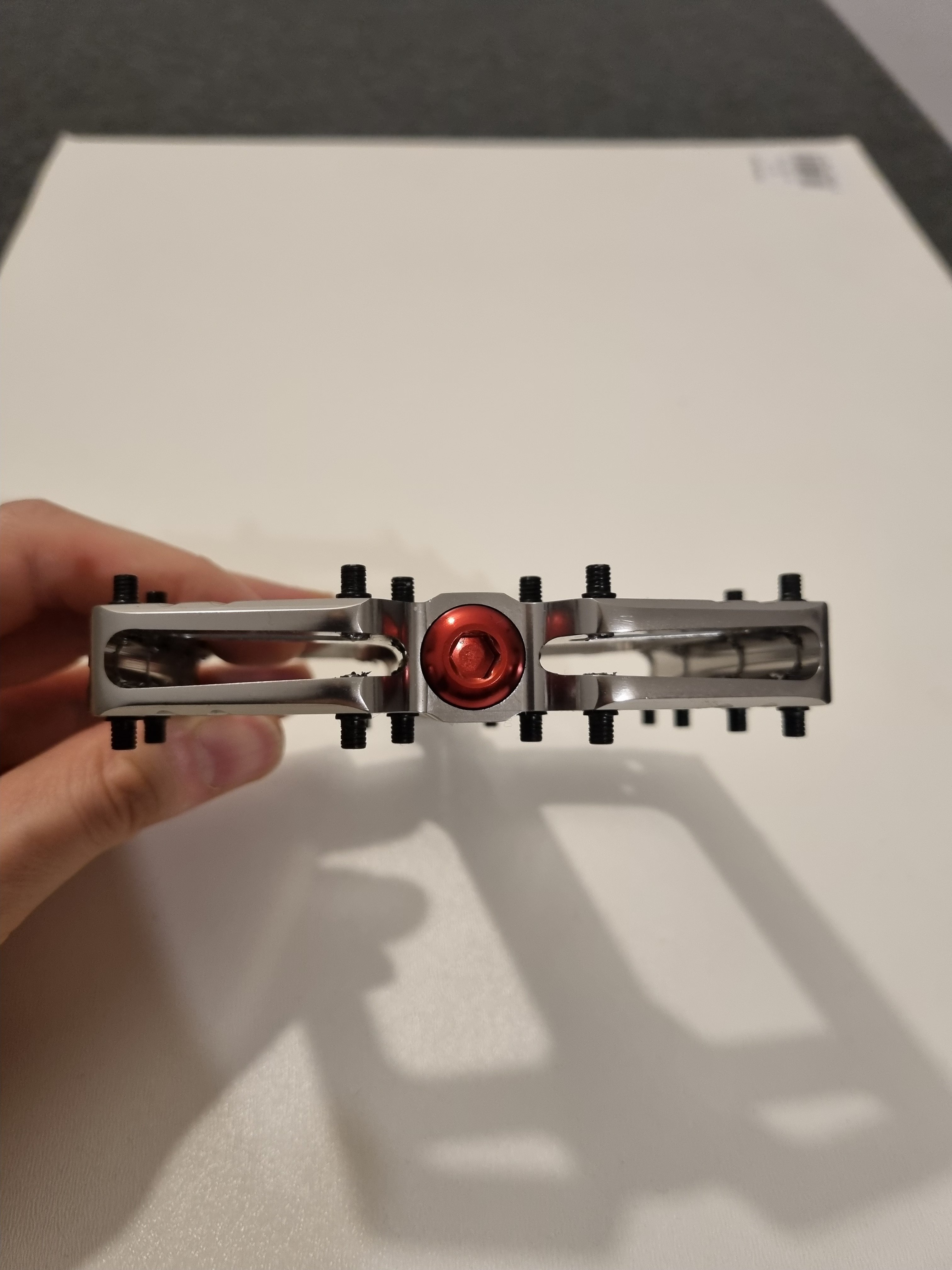

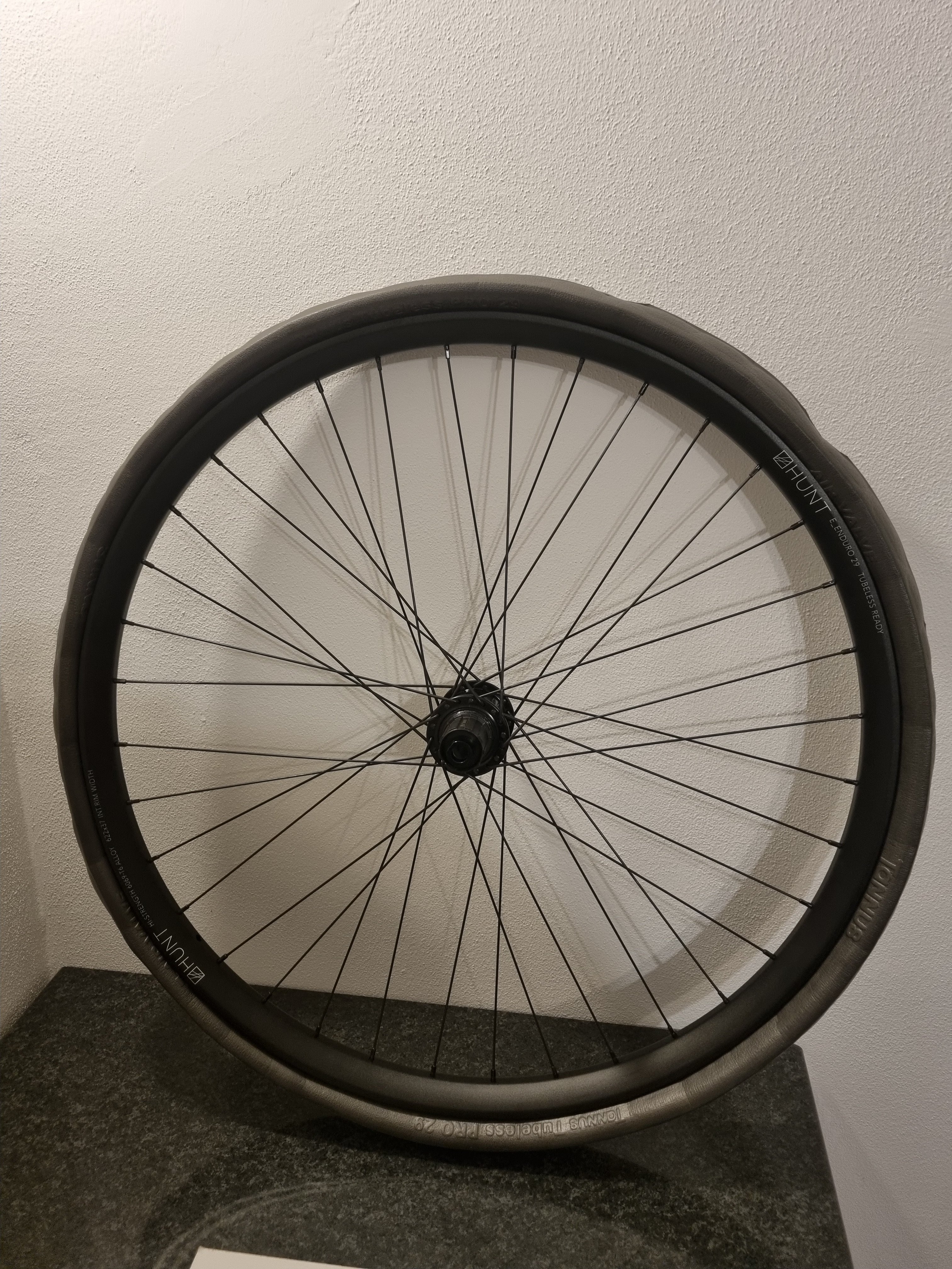

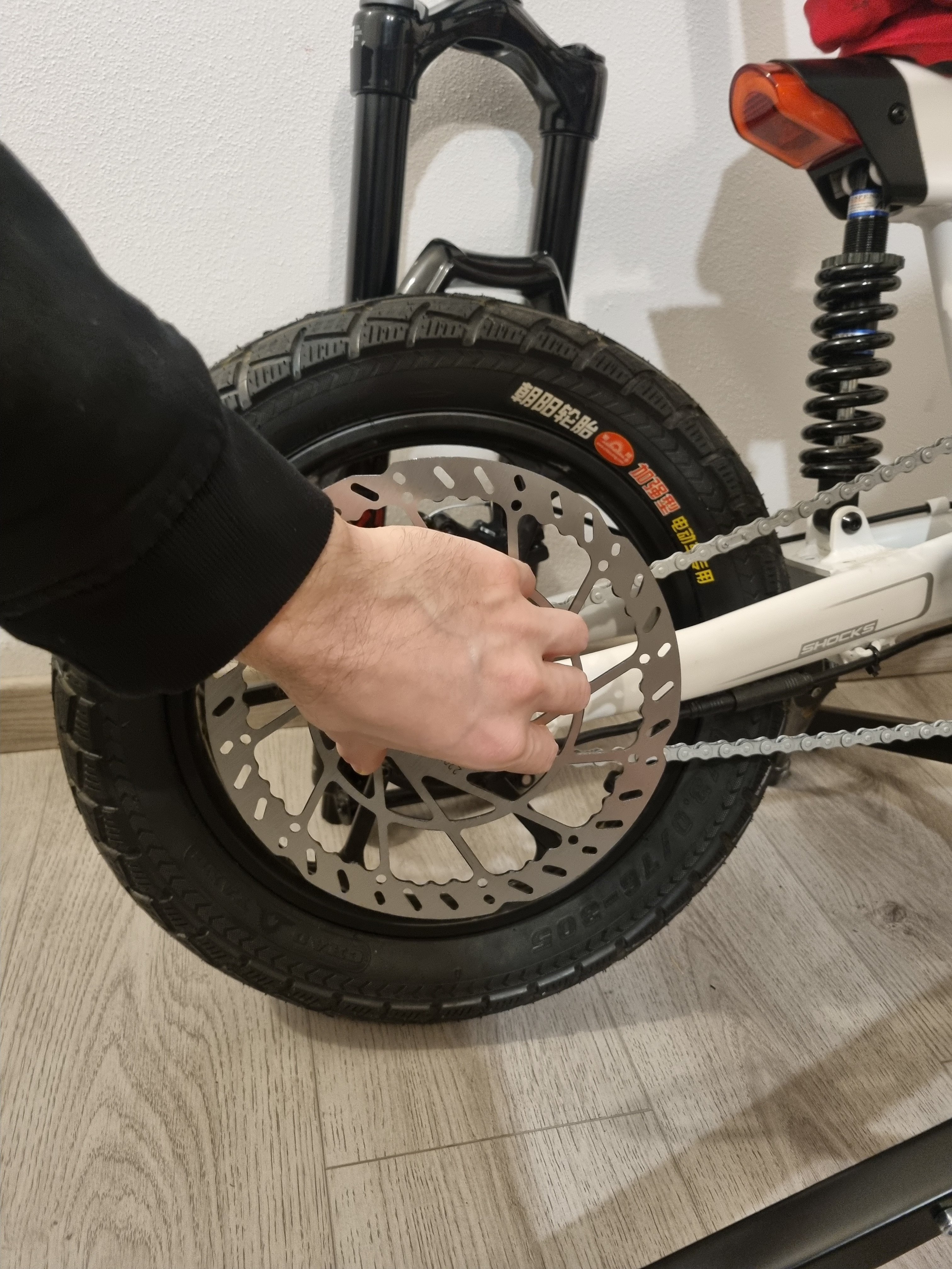

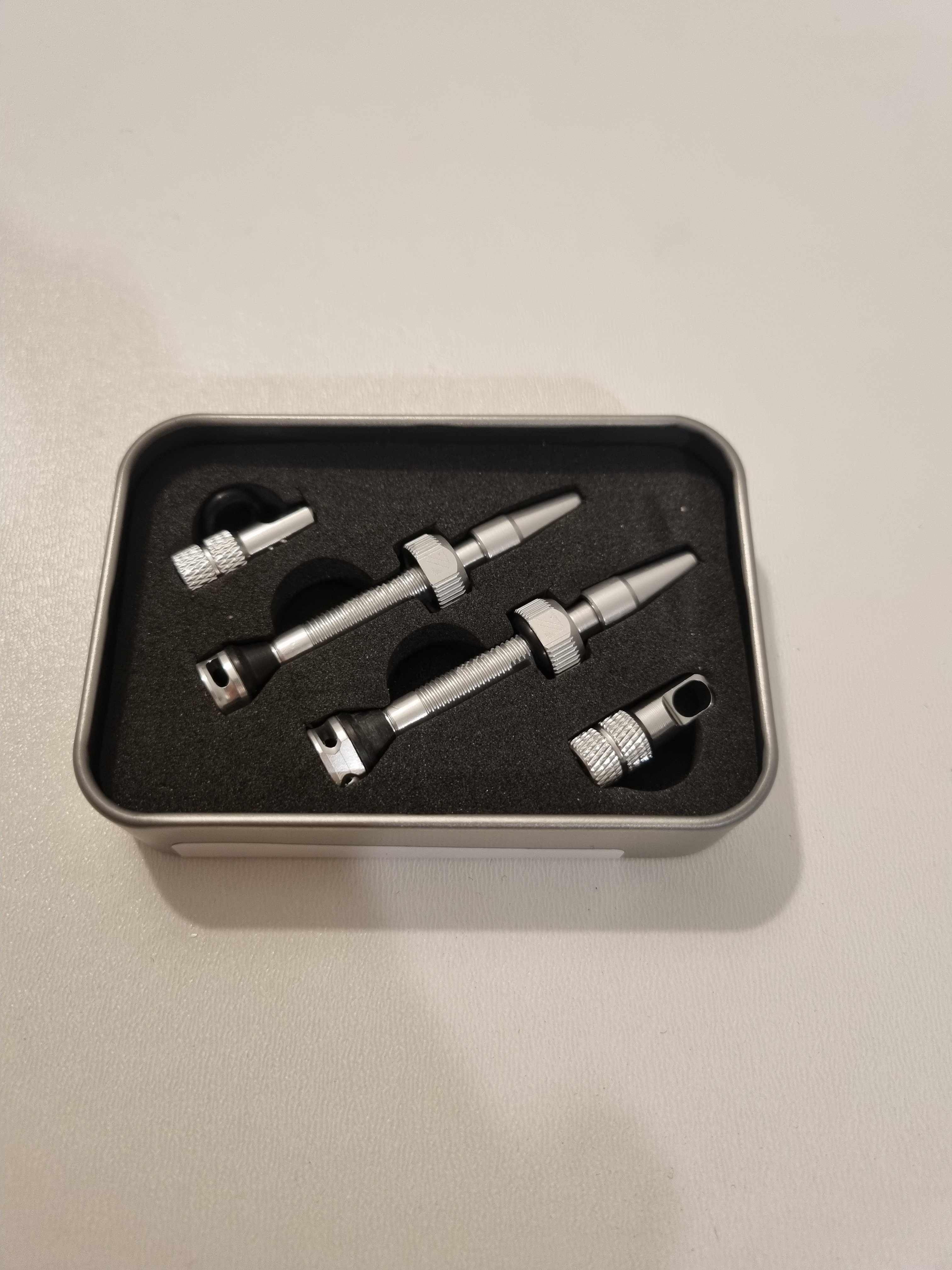

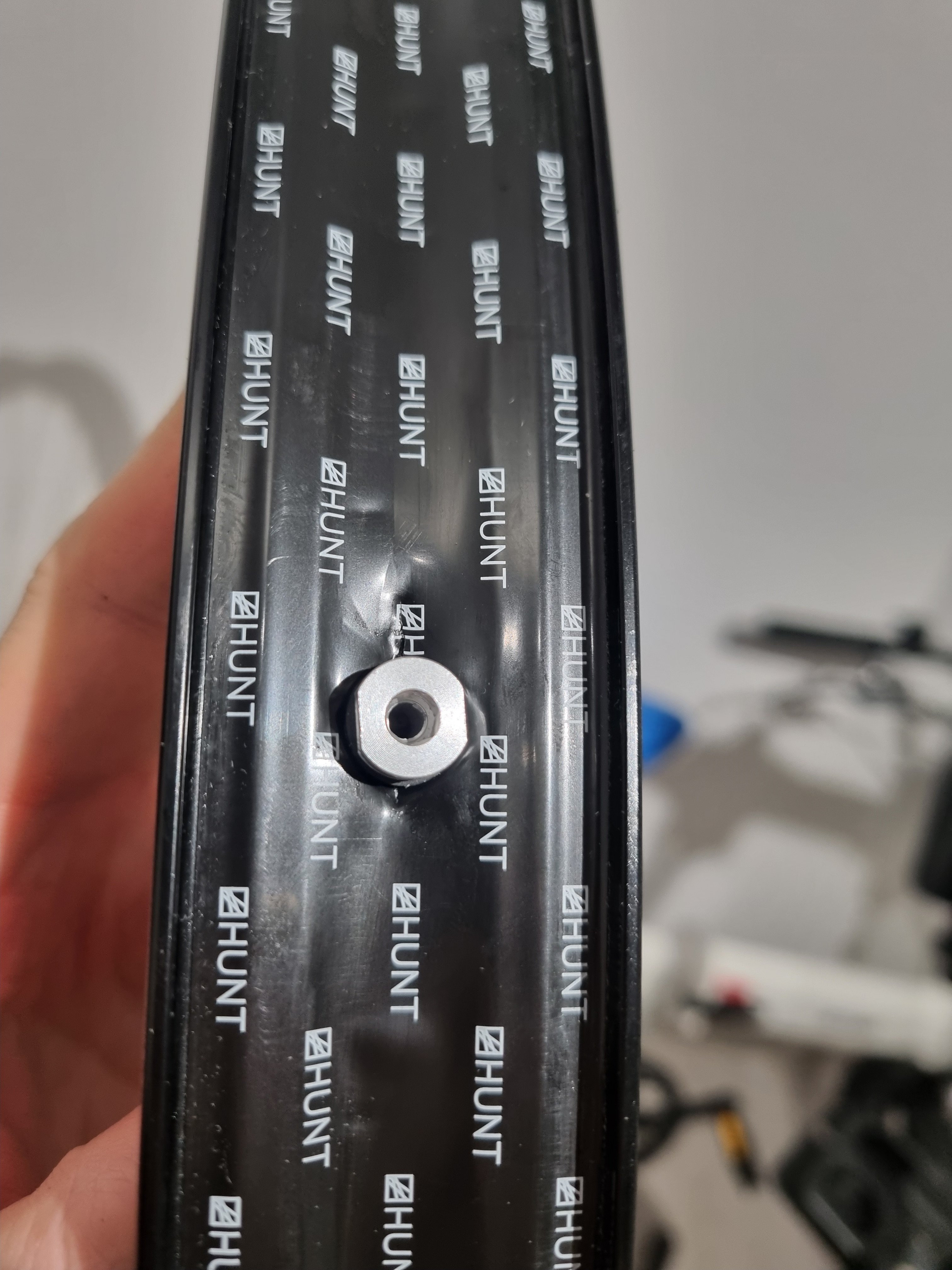

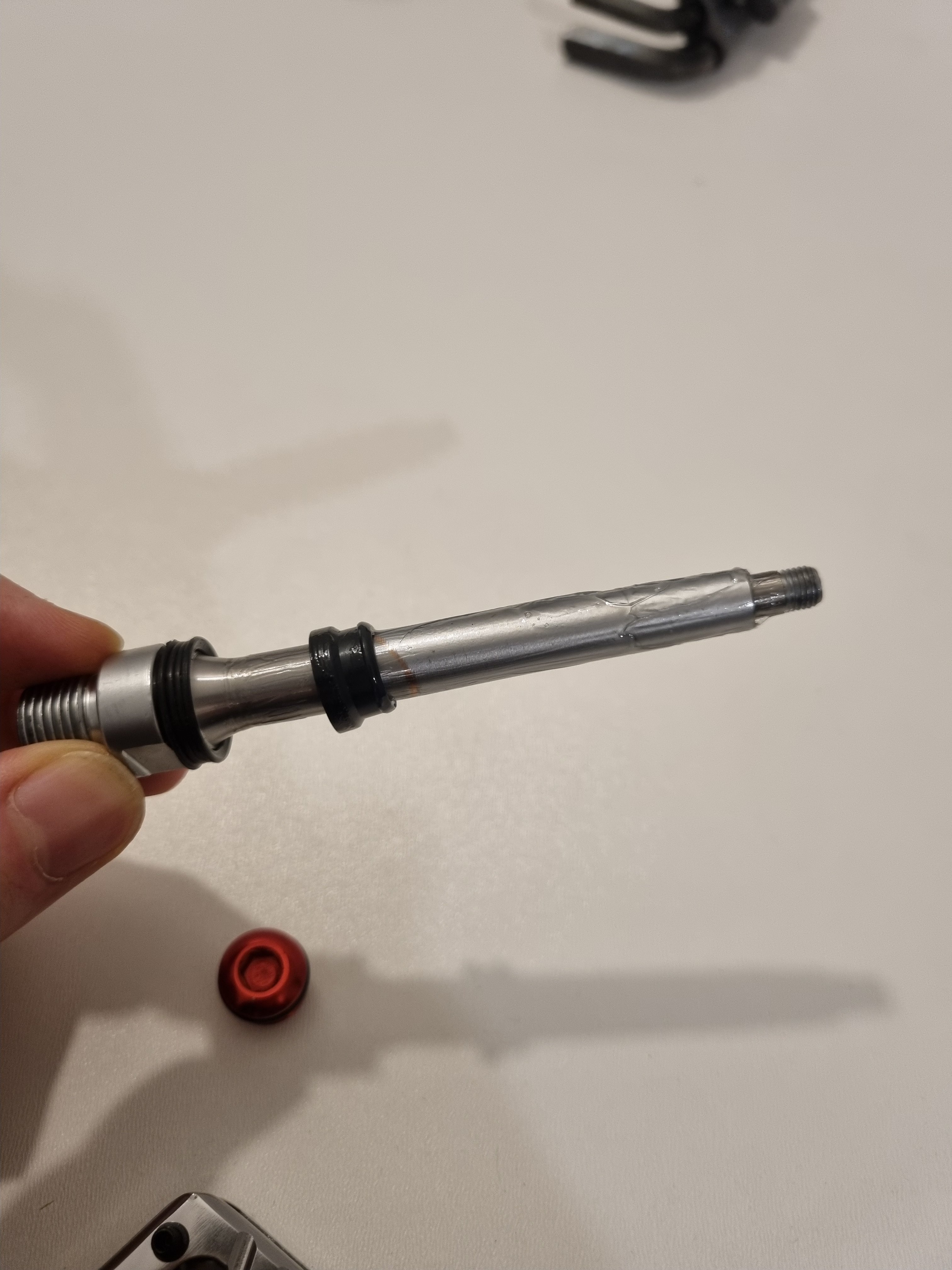

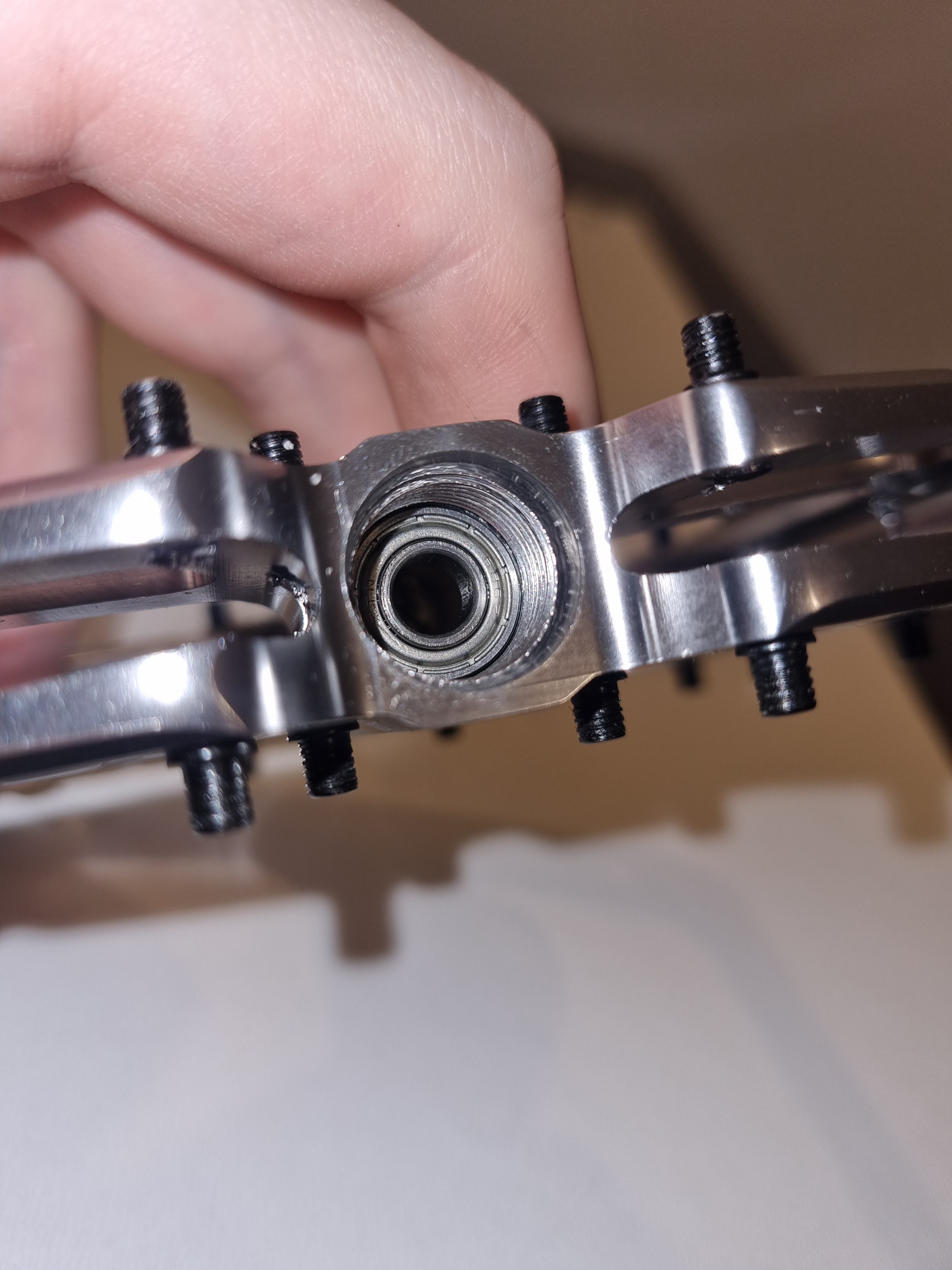

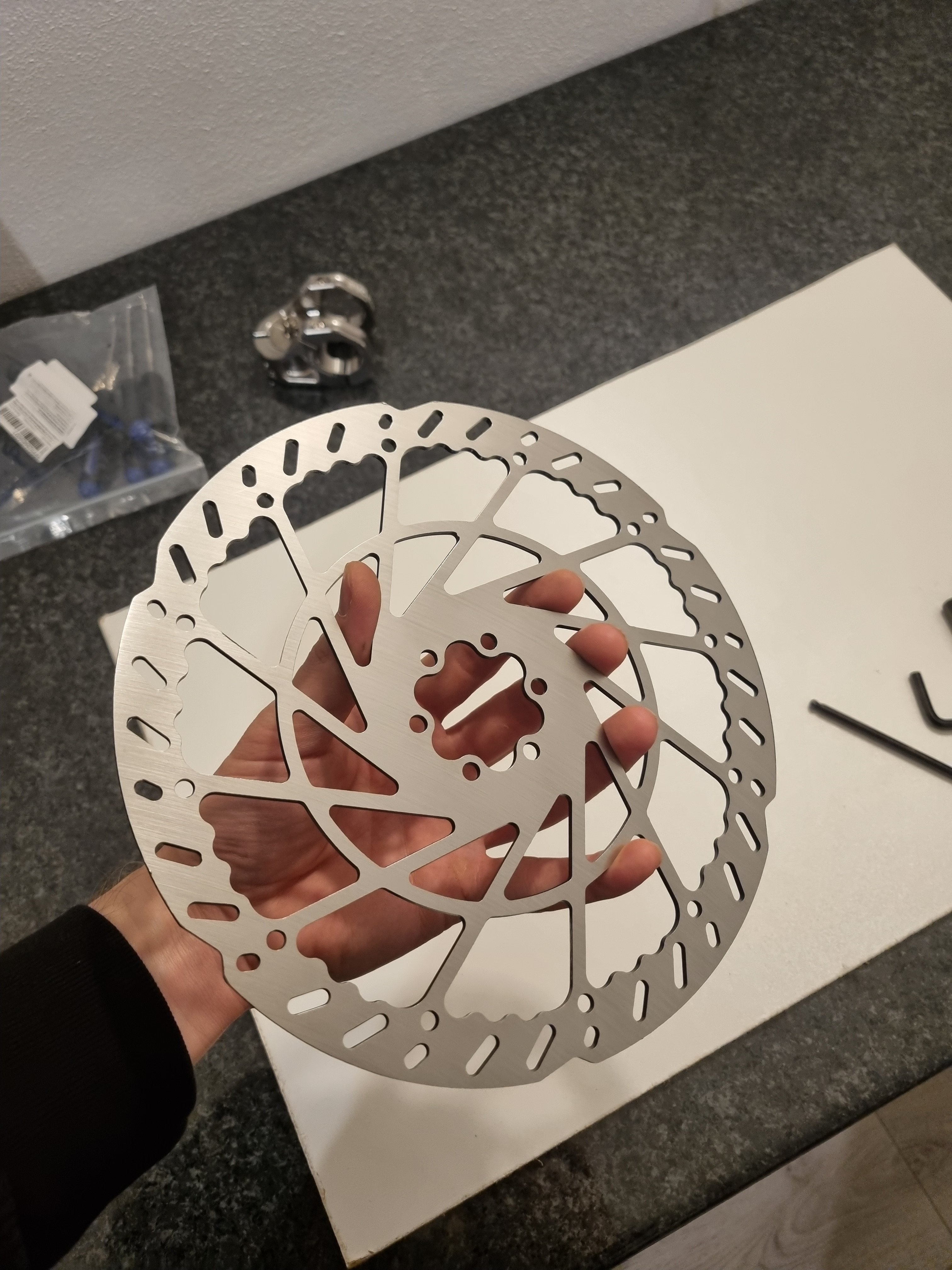

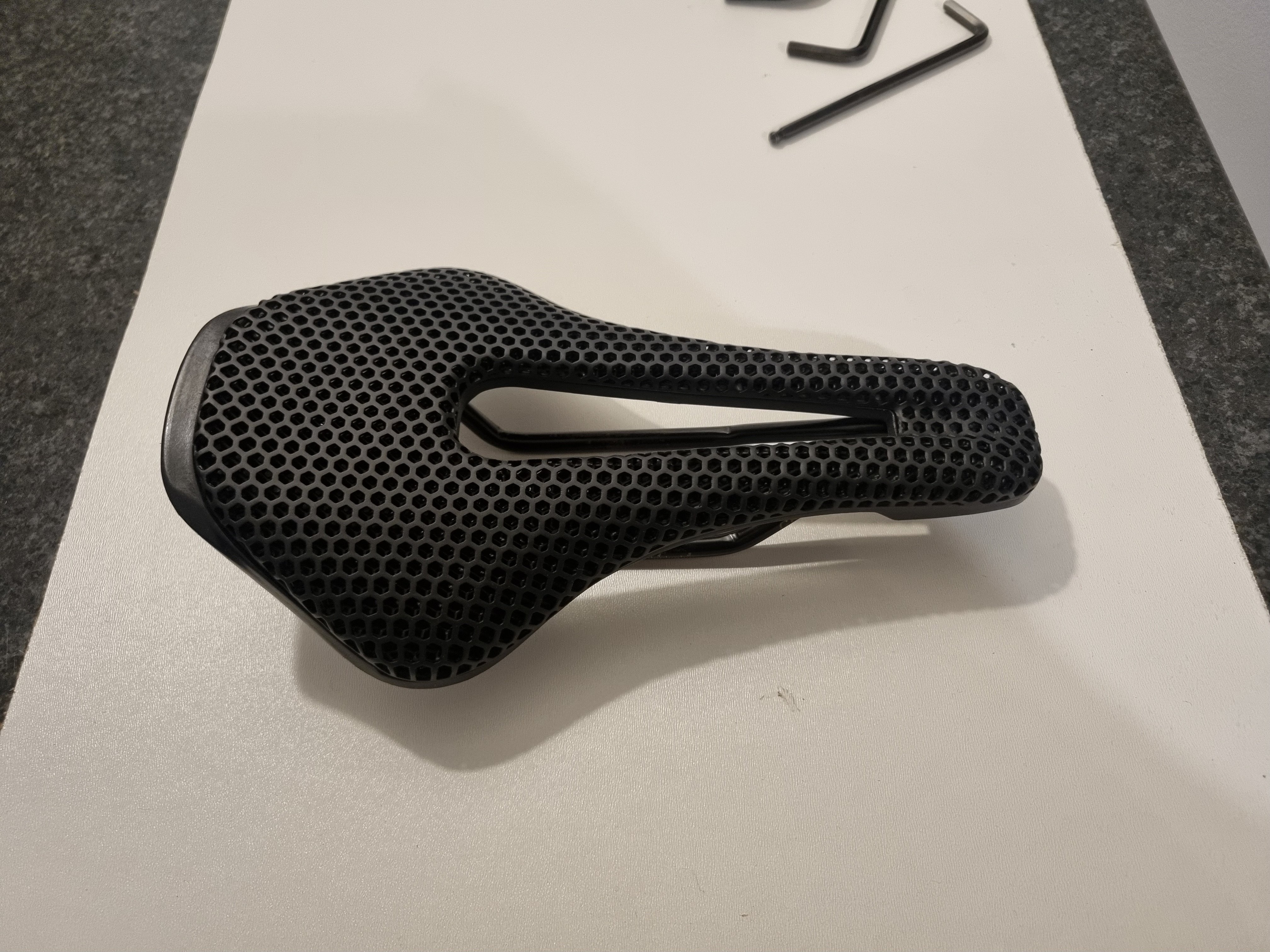

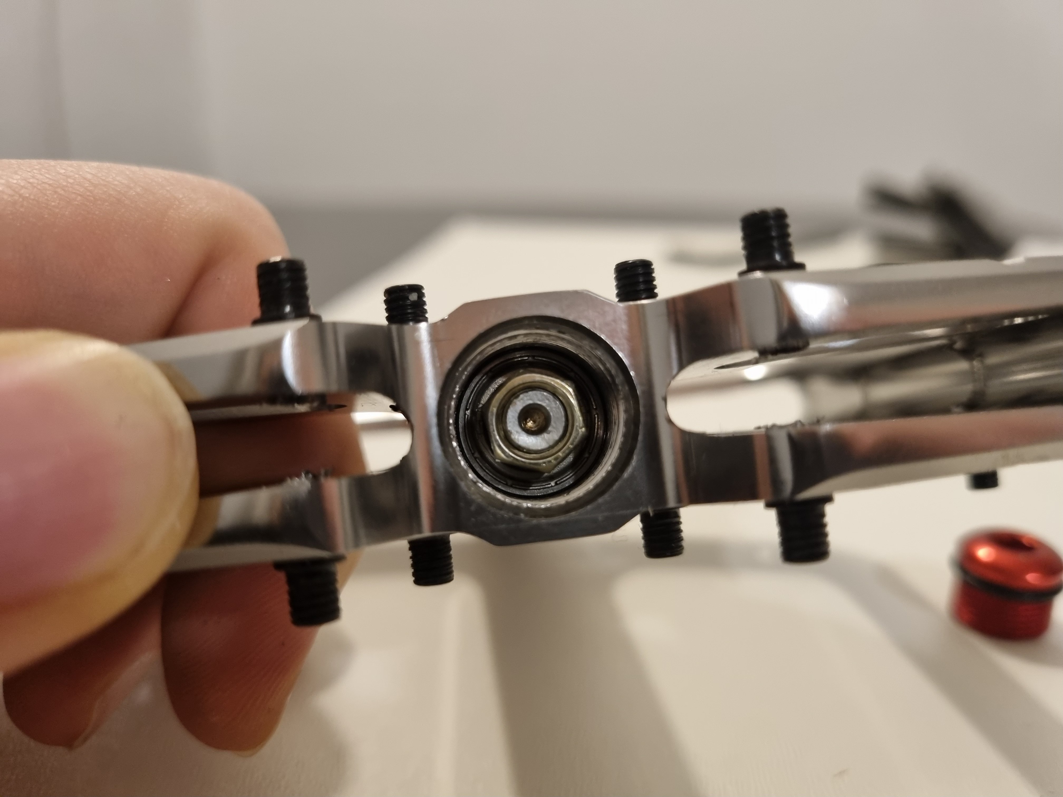

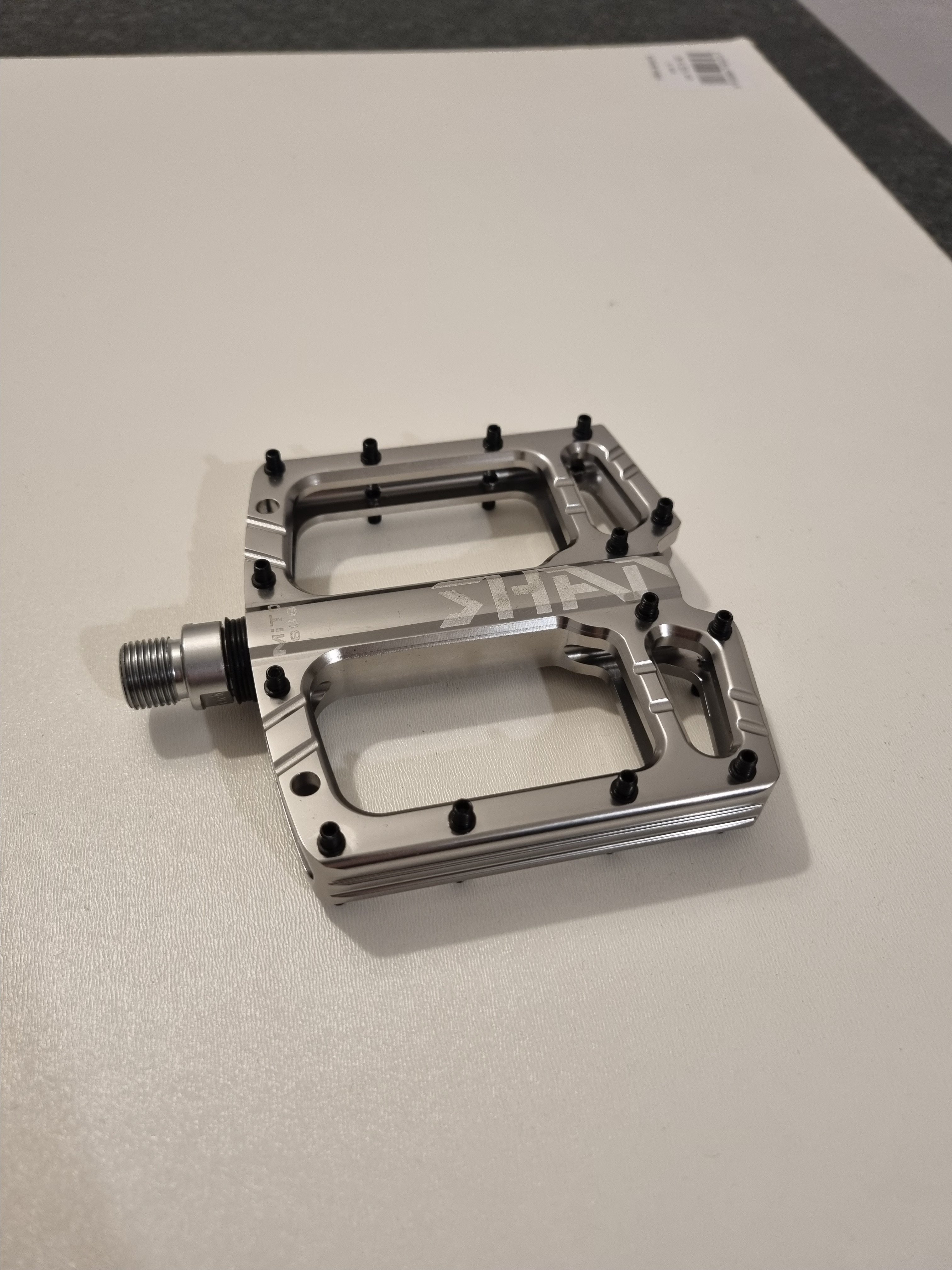

Ok bois, back on track. I will start building soon, in the meantime, here are some photos.
This thing looks sick.
Pedals look good as well. Very smooth, no play.
No fancy concave design.

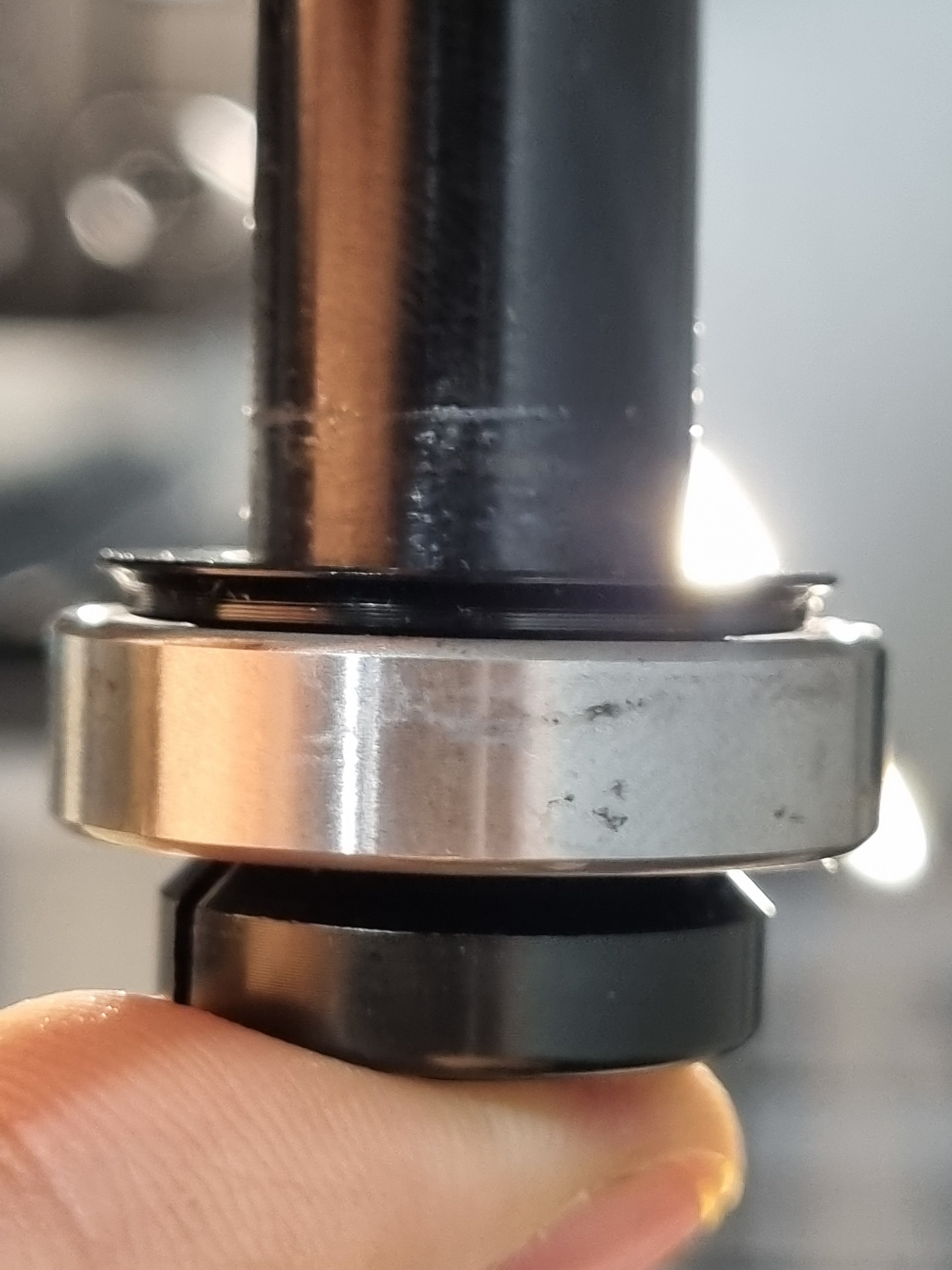

Three bearings.

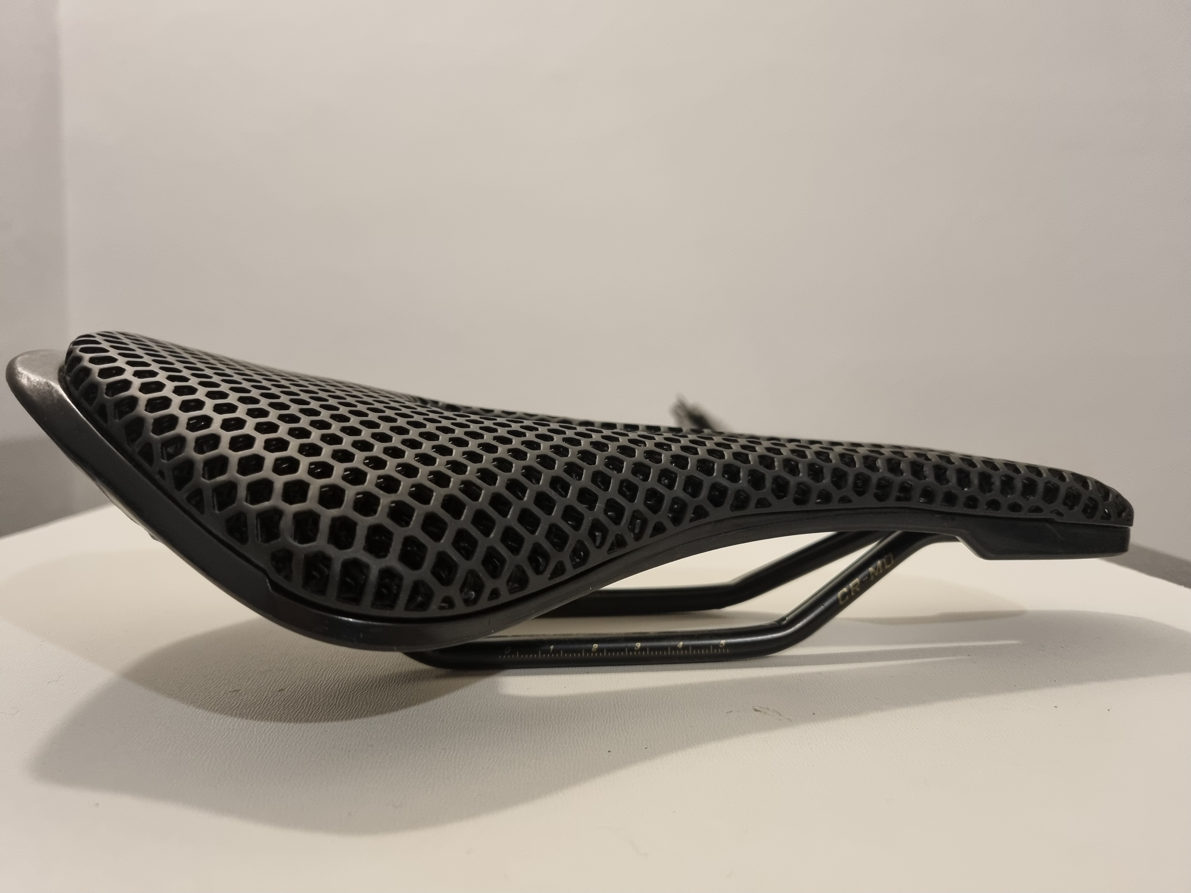

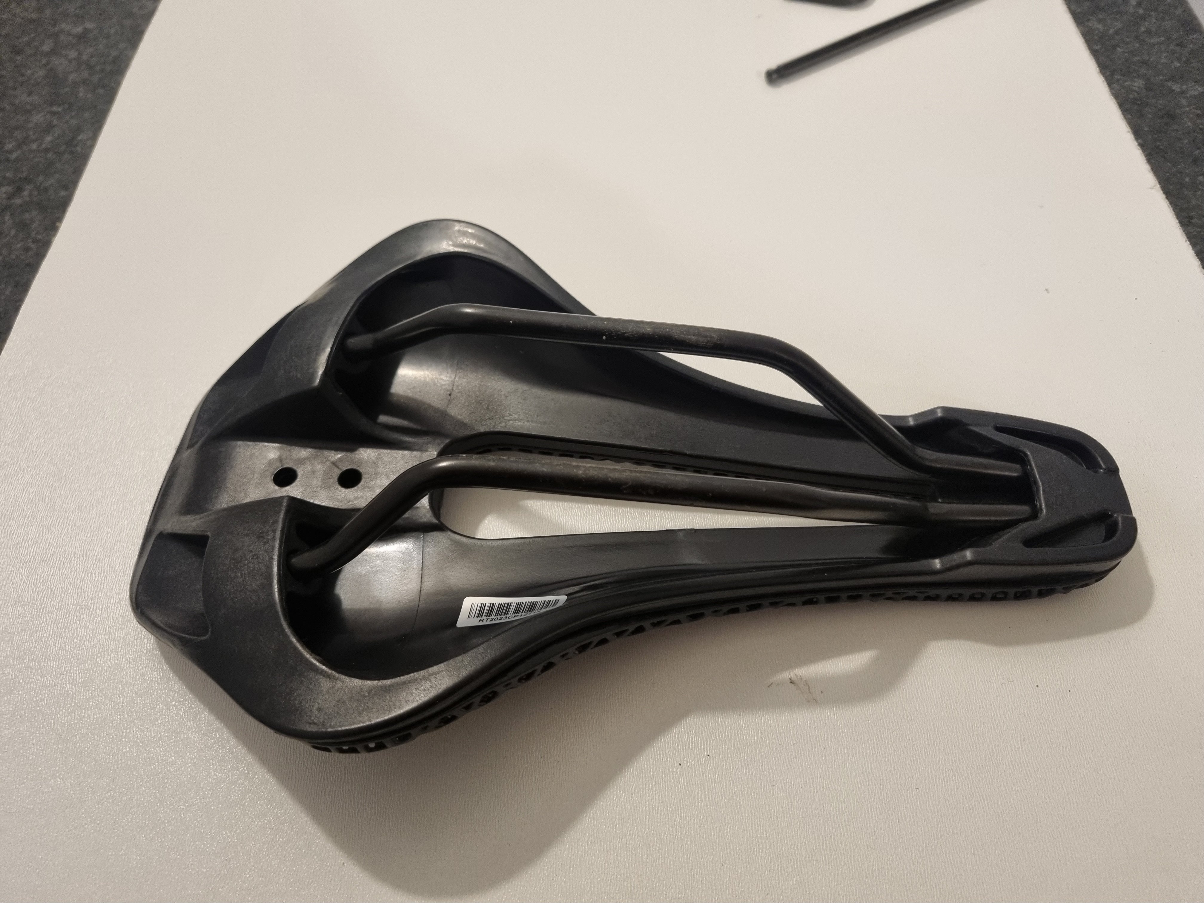

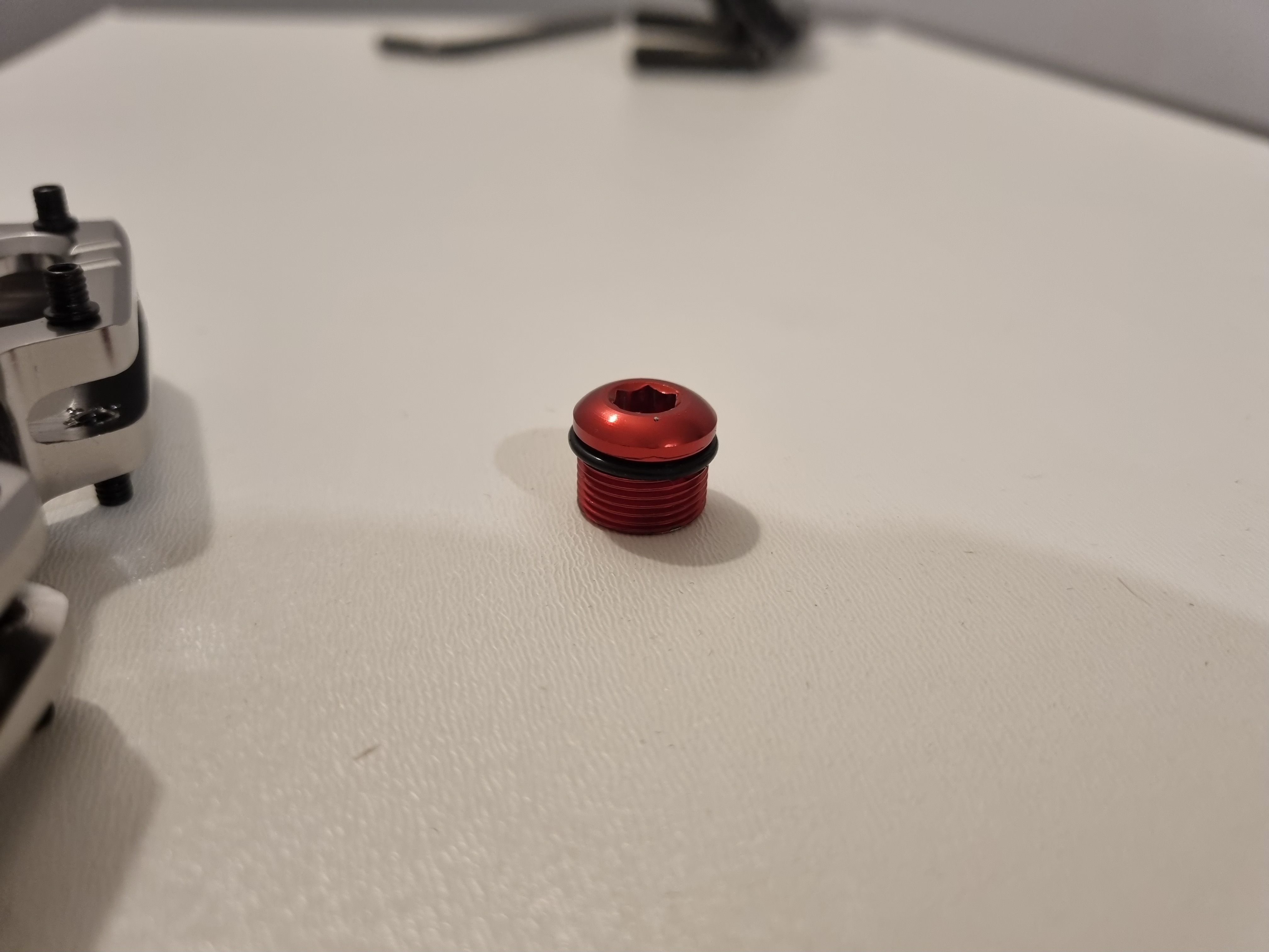

Seems to be good quality. Has different density zones (some are harder, some are softer) like the legit 3D-printed saddles. I'll see if it's any good.
LOL

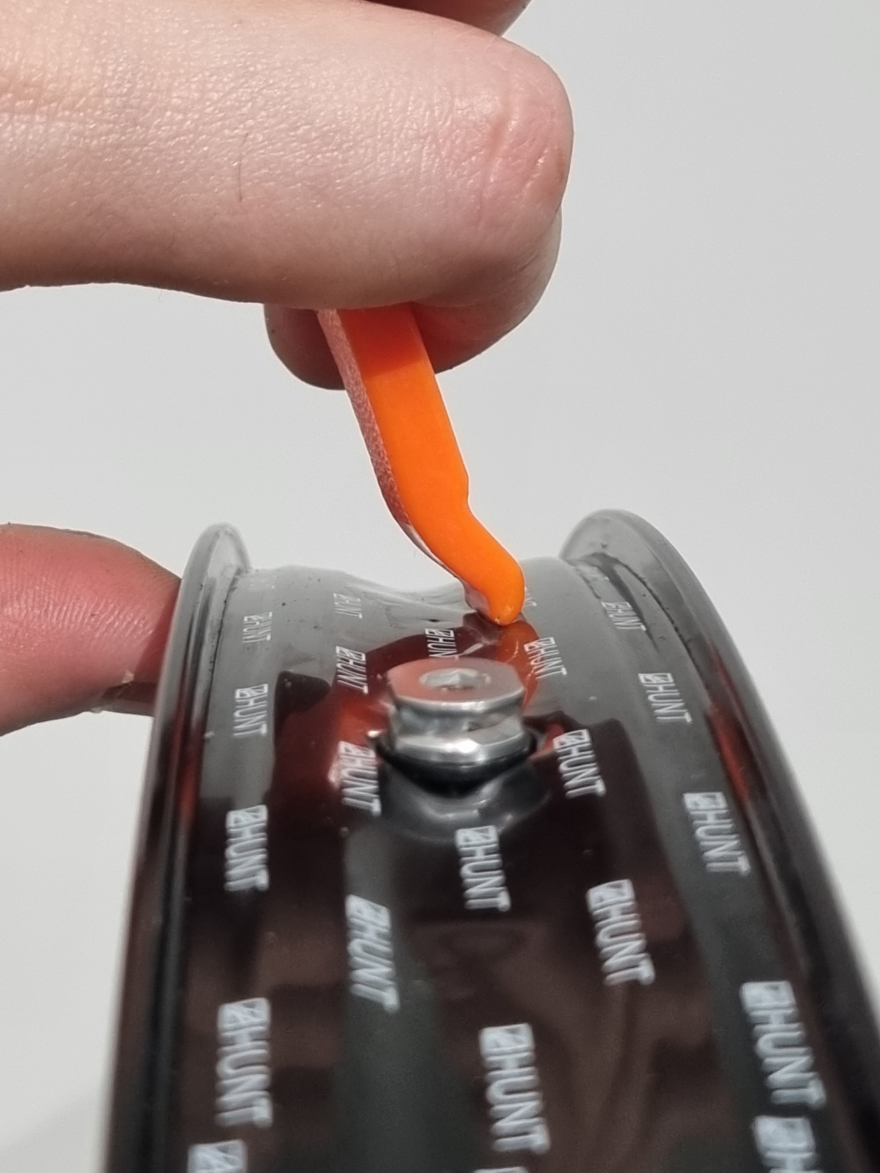

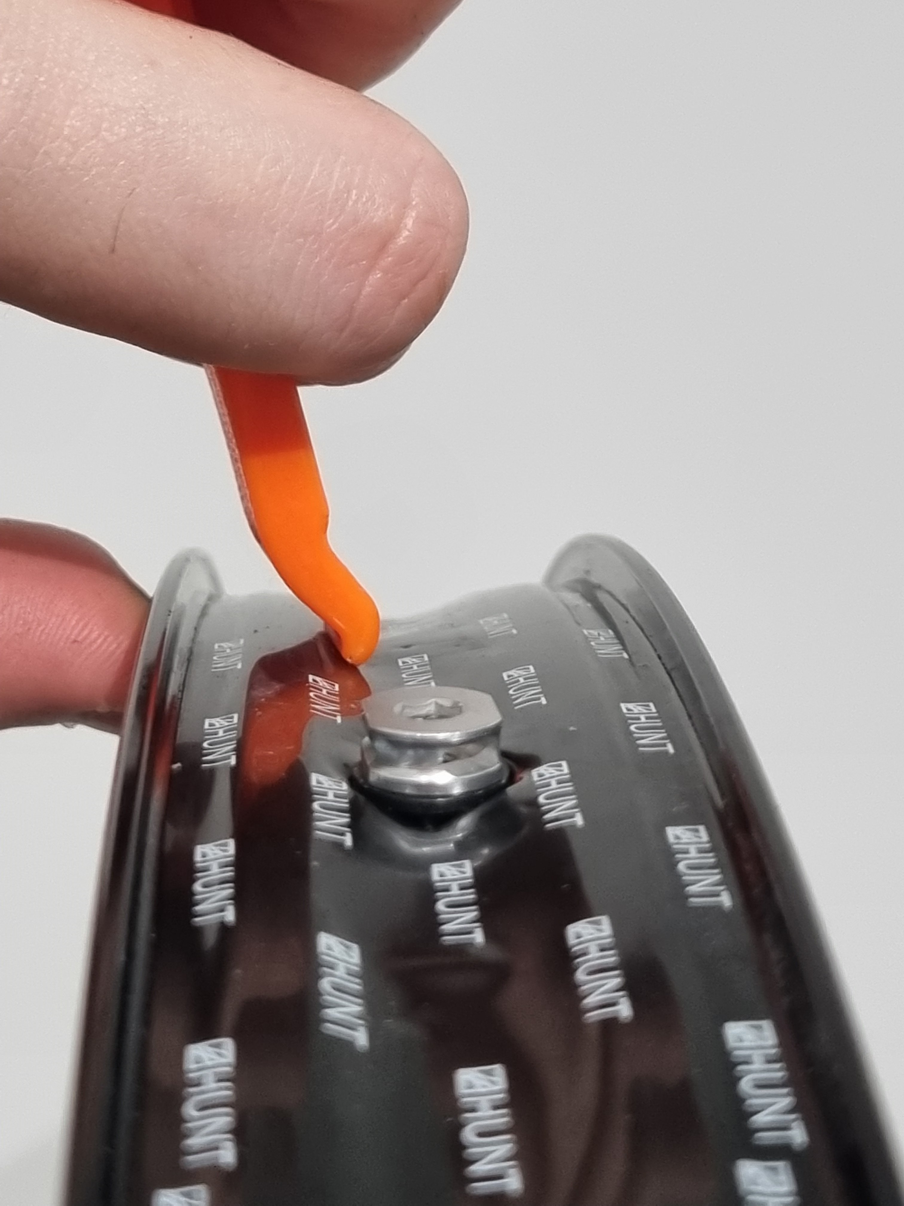

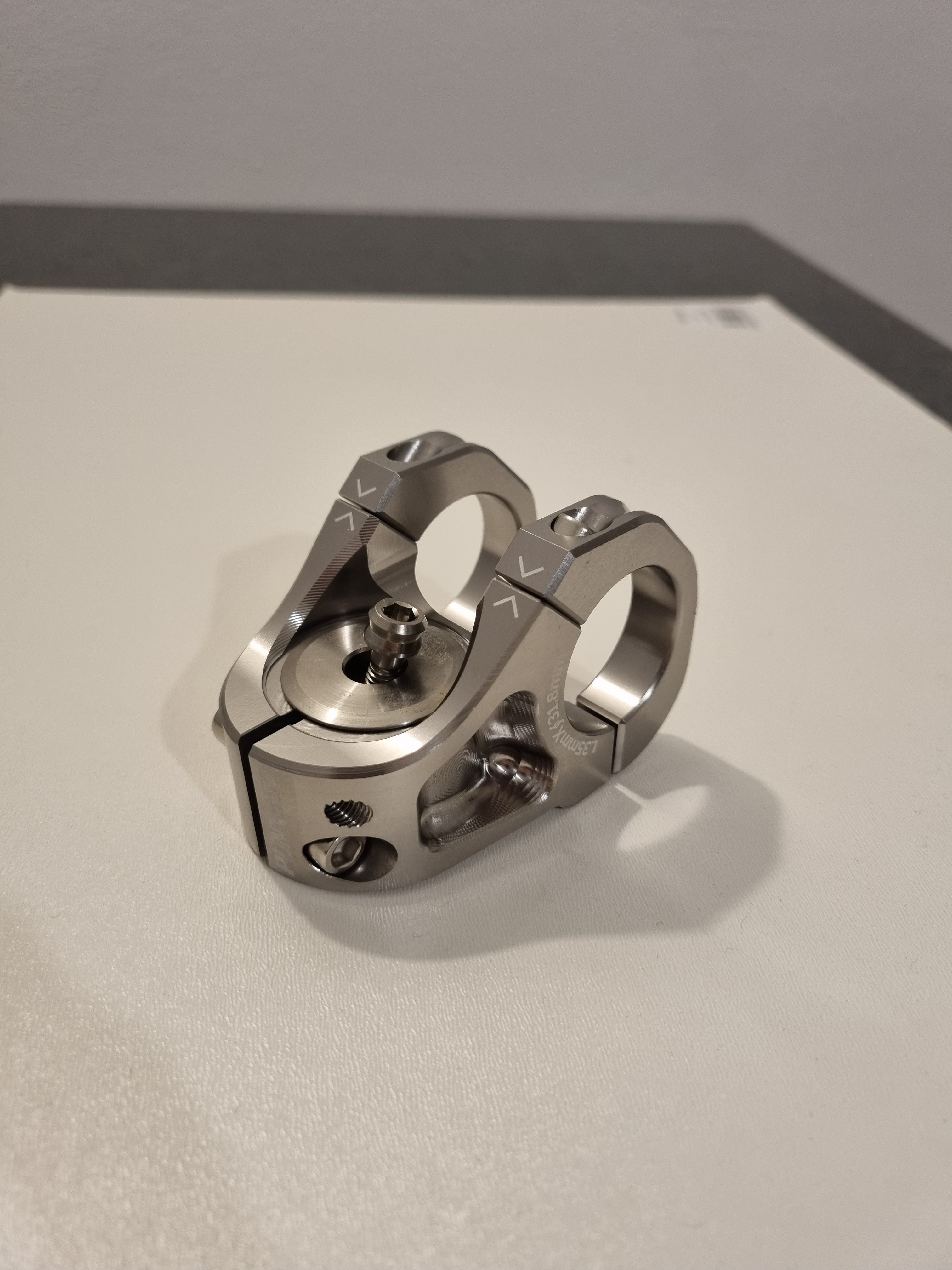

Rear wheel with Tannus insert (just so it can take the correct shape).
Yep, she needs a deep cleaning. I'm waiting for the bearings to arrive before taking it apart.

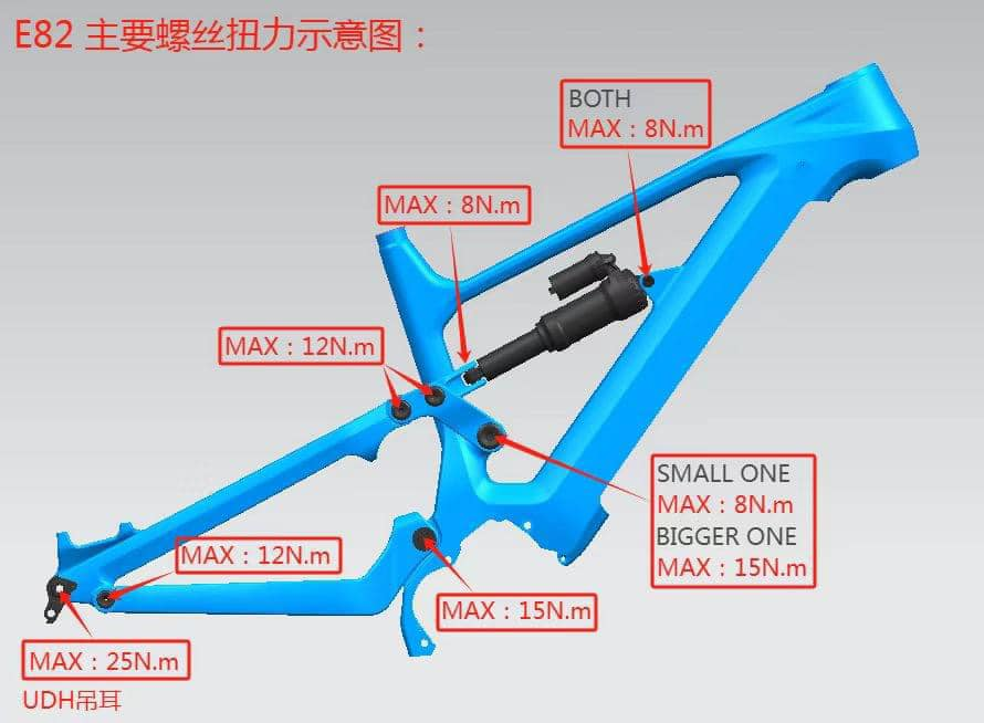

Chili Shen confirmed that the torques specs for the e82 are the same for the e10 (picture above).

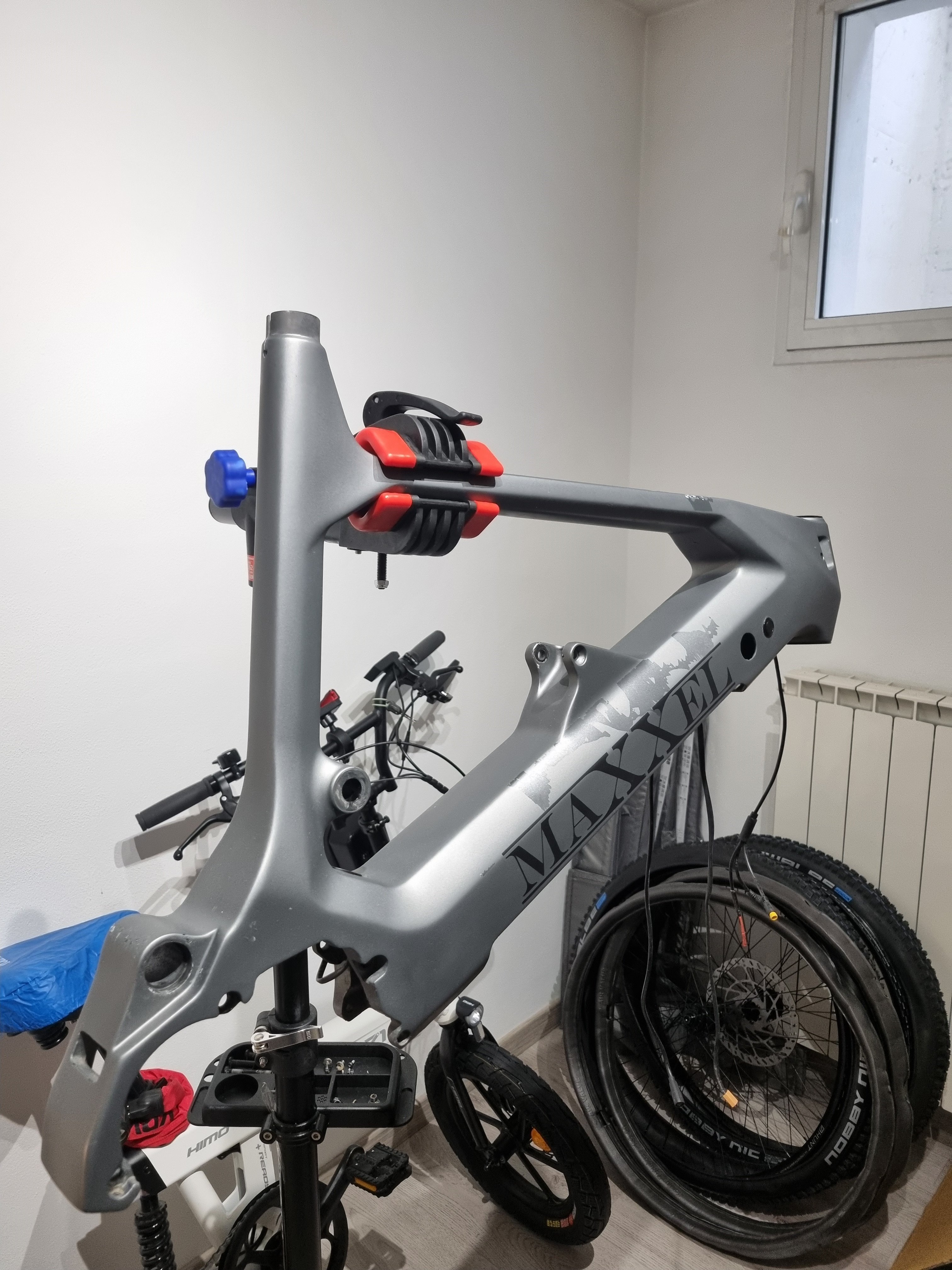

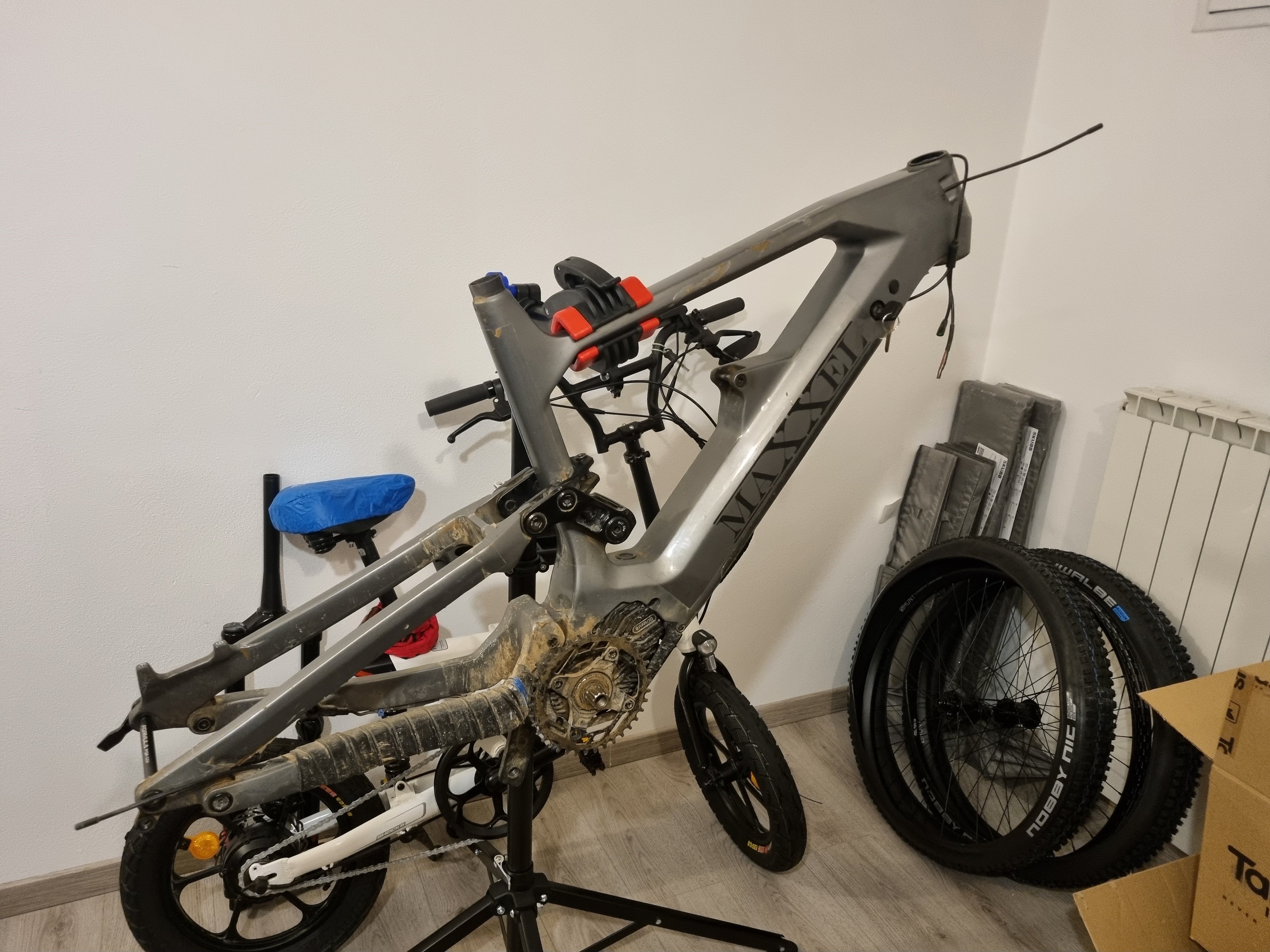

A bunch of not-so-good updates:

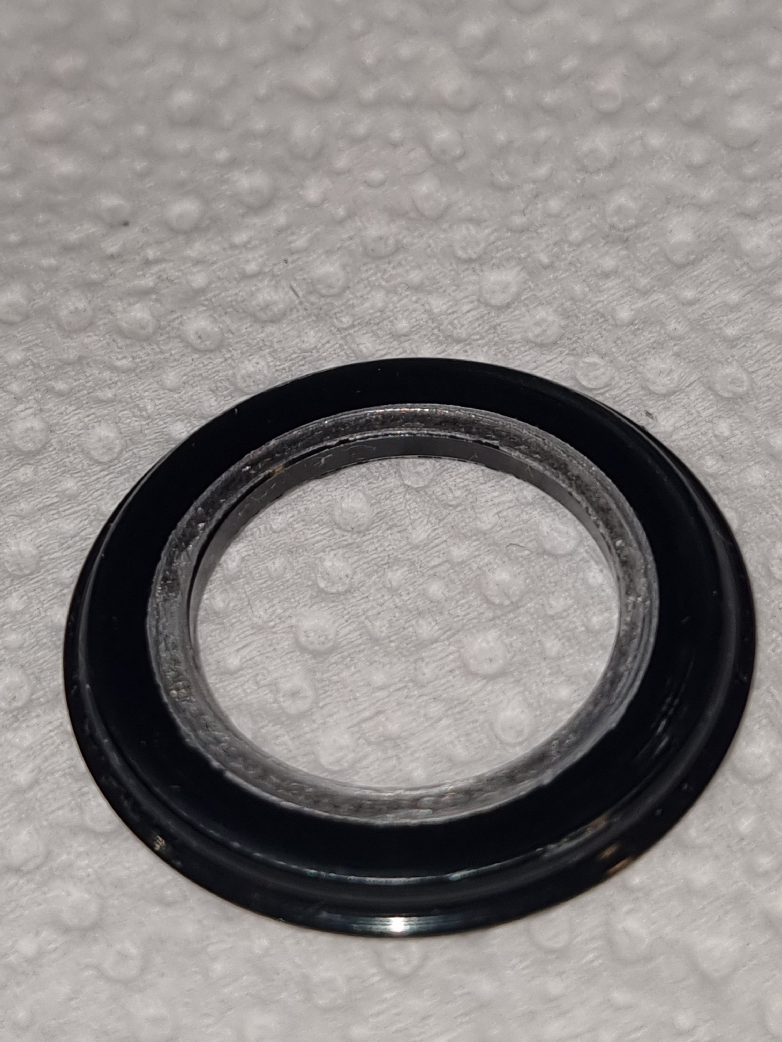

I took apart the frame and removed the old bearings. Some were completely locked, but they returned to work after I pulled them out. I guess the puller unlocked them.
Anyway, I noticed that some of the bearing caps have grooves where they contact the inner race. I guess because they were rubbing against the locked bearings.
I can see two potential issues with this:
1. If the grooves are deep enough, the caps could end up rubbing against the bearing seal. So far, that does not seem to be happening.
I could sand the caps a bit to reduce or remove the groove.
2. The width of the cap is "reduced". But it's such a small change that I don't think it matters.
Chili Shen proposed a new set of bolts and caps for 28$ + 20$ shipping. I will get that if I decide to get a new motor from her so I can avoid paying the 20$ shipping.

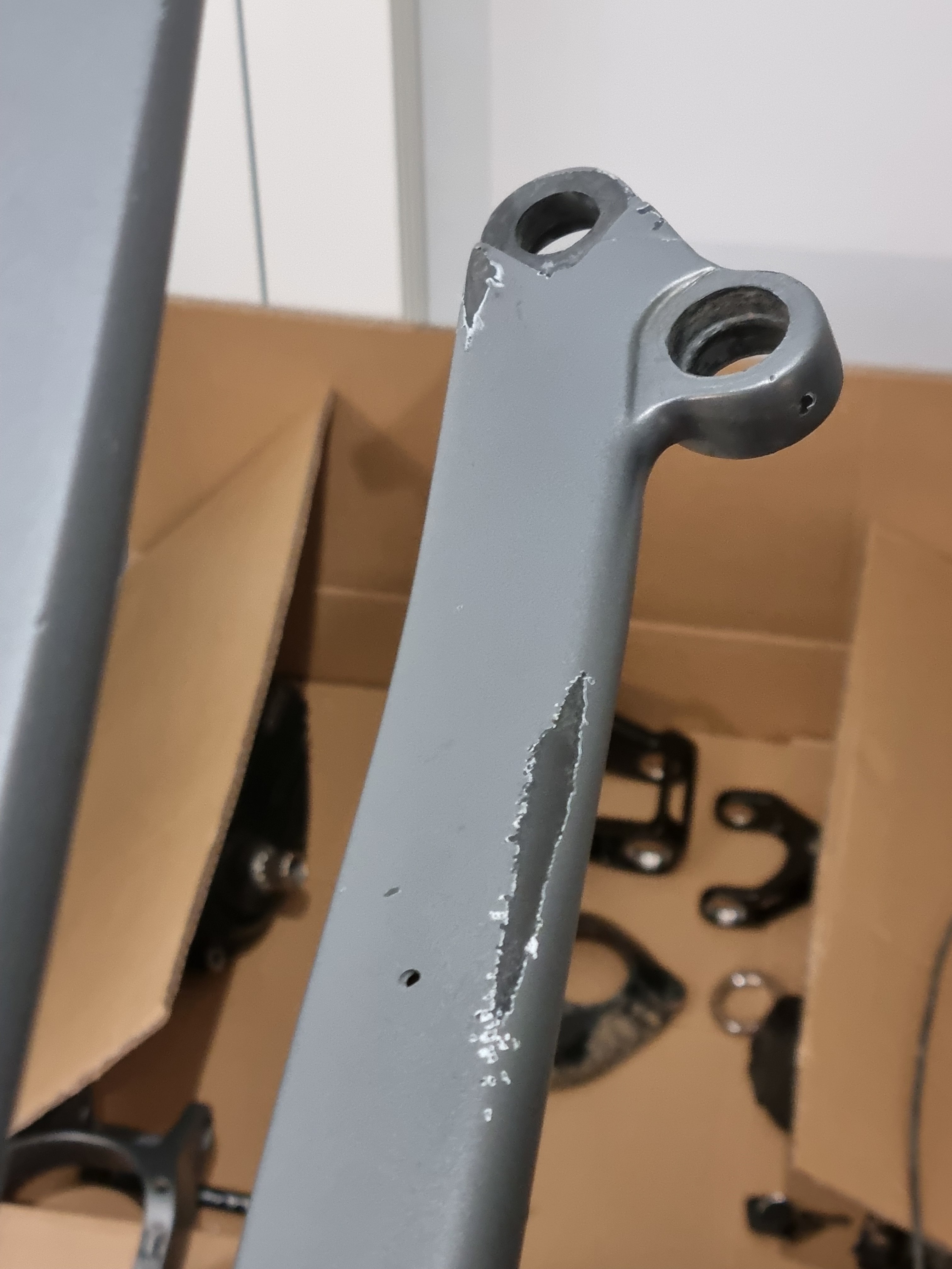

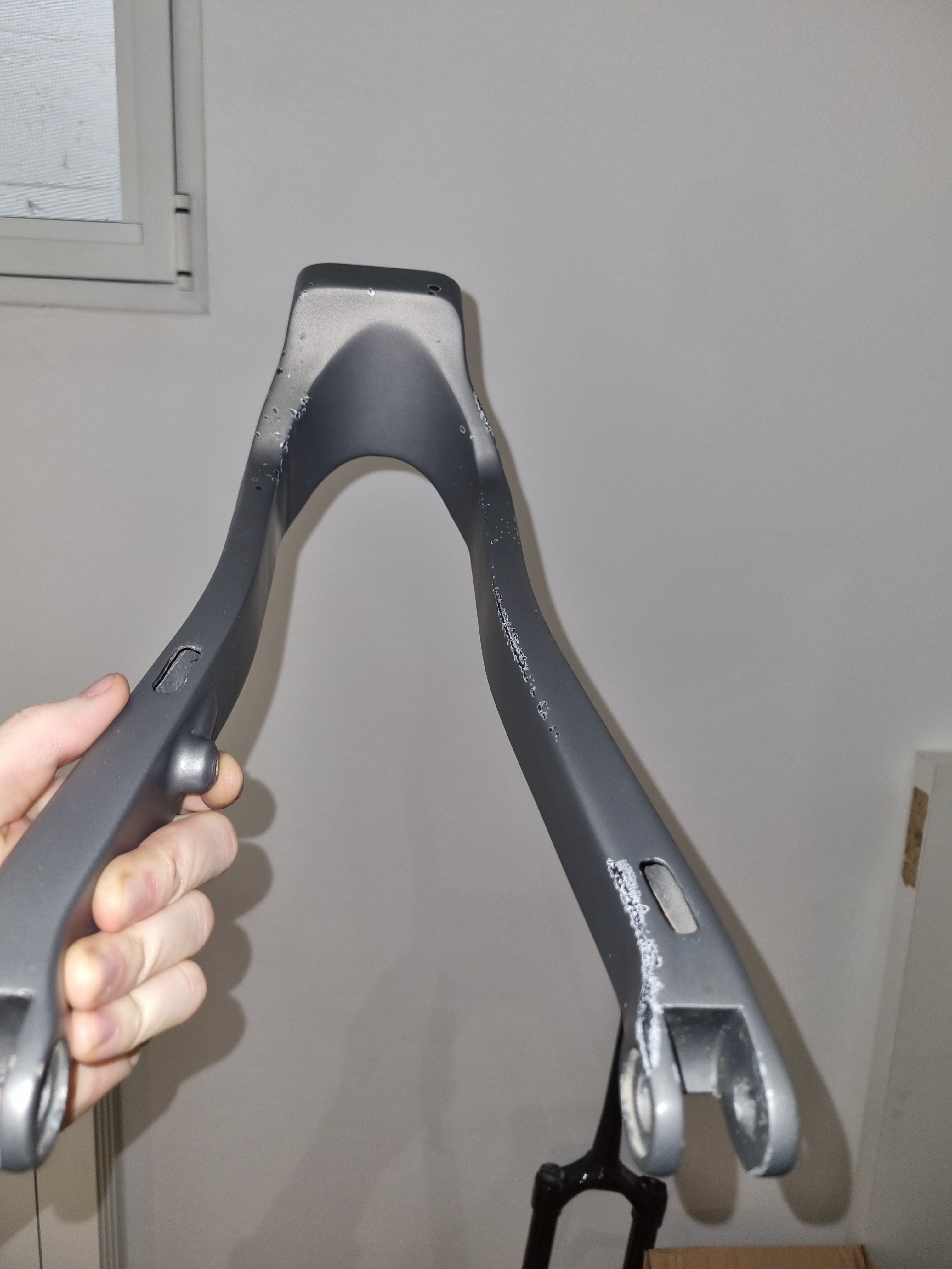

The paint has seen better days:
Also, when removing the old paint protection film, some of the paint peeled off. How ironic!
I'll just have to cover that mess somehow. Maybe with a sticker. Or I might repaint the whole thing in the future, but I heard that's a PITA to do.
Is this normal? Should I be worried about this?

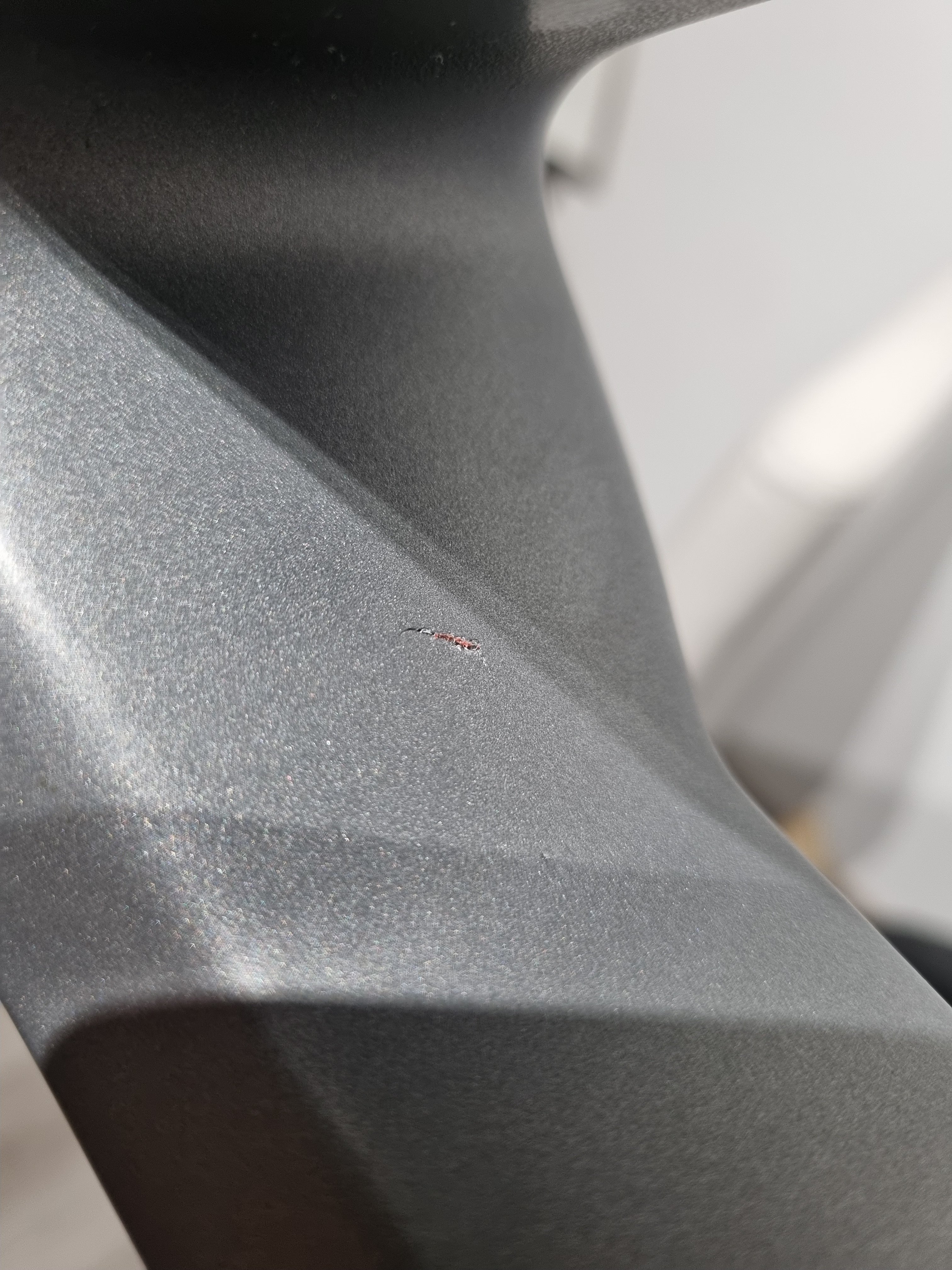

Lastly, I noticed a small crack under the top tube.
I will use my favorite tool to fix this: prayers.
Not necessarily, more like the bearing are full of crud and rust, pop the face seals off and have a look.
It may not have been Dengfu that painted the frame, a lot of the frames were bought bare and painted by the owners.
Something has spun to create a cutting motion, would I worry about it probably yes if we can see the foam insert. Most of the damage on the rear swing arm is chain damage from derailled chains, thats not normal but it happens. There's a lot of stone damage as well, again its pretty normal unless you protect the frame with say invisi film
Nice bit of impact damage, if the frame was at fault it would have crack extensions from the main damage.

The reason I wrote all that is because this is my building thread, and I'm sharing everything related to that, not because I want to complain.
I got unlucky with the frame, and I'm a bit upset, I think that's understandable. Also, most of the stuff I pointed out wasn't visible without tearing everything apart, so there was no way for me to inspect things further.
In the end, everything is fixable, but, as I said, it was not worth buying a used frame. This is why I'm saying this:
Option 1, buying from Dengfu:
Frame + m560 + battery --> 2200€
Option 2, used:
Frame + m600 --> 800€
New bearings --> 70€
New bolt set --> 28€
New paint --> 200€ (don't know, guess)
Carbon repair --> 300€ (don't know, guess)
M560 --> 700€
Battery --> 400€
Total = 2500€. If I can sell the m600 for 300€ and if there is nothing that needs repairing on the m600, then total = 2200€.
Hopefully, the carbon doesn't need repairing, and I could do the painting myself. But that is a lot of work I was hoping to avoid doing, so it is still not worth it, imho.
Of course, if I can cover up the damage to the paint with stickers and I end up liking and keeping the m600 then that's a different story.
I don't think that's it. That would have ripped the paint off. Maybe it is not clear from the photo because there is some dirt inside. It looks like a manufacturing defect to me. It's not deep so it will probably be fine.
Thats what happens when the EU wouldn't negotiate an honourable divorce with the worlds 6th largest trading nation, it ferks it up for everyone bar the politicians and lawyers.
Maybe you're right. Maybe the EU is to blame, it always is, right? I shouldn't have started this conversation. I was salty about the frame situation, and when I found out about the customs fees, I got a bit triggered, sorry about that.
kaaskopf
Oct 11, 2024
168
208
Berlin
no need for any carbon repairs
the 'crack' you took a pic of looks like a small scratch. you will get many more when riding the bike and shouldnt affect anything if its not to deep
i have some carbon frames from a few years old and they all have marks deeper than this and still are fine
dengfu frames are famous for bad paint quality. does not adhere well. so pealing of any kind of stickers results in paint removal like you expierenced.
i have seen some dengfu chainstays with the exact same 'damage' looks like not enough filler was used before paint. if it was from damage you would have lost the paint as well, but you didnt so it looks like it was there before painting. my e10 has the same marks
these frames are made with extreme budget cuts in mind, thats why they are new like 700usd. this is the quality we all get, see other build threads
if you bothered by the damages just use a filler , sand and paint it
but it shouldnt affect the performance
seems like you are expecting to much of dengfu in terms of quality and expecting to much of a second hand frame..
all i see is a minor paint scratch and fucked up paint from removing a sticker 😀
if it was my build on a second hand frame i would just build up the frame as it looks decent and replace all frame bearings to start with and maybe sand down the damaged paint and use some rattle cans to make it look pretty again
edit;
your lower chainstay looks fucked ?
did the guy bash the chain into it 1000 times ?
i know dengfu or chili shen sells that part seperatly if you need a replacement. its hard to tell the damage from the pic
i always protect the chainstays with some inner tube to prevent this exact damage. or use a good derailleur with clutch
i sold and bought some second hand carbon frames in the past and inspection is always important so you dont feel sad after
same for m600, i told you its an older engine but if it works it is still a great bike
goodluck with your build 👍
Zayd Proctor
Nov 2, 2024
29
9
Italy
Thanks mate!
To be clear, I'm not posting this to complain. I'm posting this to get feedback from someone with more experience. I don't care about the paint on the chainstay; I saw that when I bought the frame. It's not that visible unless you look for it, and the chainstay protector will cover some of it. And I don't care about minor manufacturing defects as long as they don't affect the performance or safety of the bike. But, like as said, I have no idea if that's the case unless I ask you guys.
I'm a little upset about the paint peeling off because now the bike looks like shit. But I didn't want to sound too dramatic. I know it's fixable. I'll get it done.
I don't think that's a scratch because when I press on it with my finger, it's a bit soft, and that small area bends a little. What I want to know is if this kind of damage usually spreads out and if I should repair it to prevent it from spreading.
What do you think about the bearing caps? Should they be replaced?
kaaskopf
Oct 11, 2024
168
208
Berlin
the bearing cap story is a bit hard to understand for me ;)
not sure whats the problem there
new headset would be wise anyway and would come with new cups bearings washers and everything else.
i always use ztto headsets from ali, its decent quality for the price (14 euro)
you could find a carbon repair specialist and show him the damage on the frame,
i used this service for a cracked chainstay few years ago and let him paint the whole frame for only 200,- including fixing of the cracked chainstay. which in turn did crack the first time riding again.
my advise would be not the repair stressed parts of the frame . but replace instead
your lower chainstay looks the most worrying to me from these pics tho
Zayd Proctor
Nov 2, 2024
29
9
Italy
I'm not talking about the headset cups. I'm talking about the caps that go on top of each bearing of the frame joints. I'm not sure if that's what they're called.
These:
Some are worn out and have a groove where they touch the inner race of the bearing. Like this one:
Really? Why is that? It looks to me like it's just the paint that came off.

Today, I tried installing the tires and inserts following this video:
Excellent video, with lots of great tips.
I installed the front tire, and it all went fine. Initially, a tiny amount of air was leaking from around the valve, but it stopped after a couple of minutes. I then installed the rear tire, and again, some air was leaking from around the valve, and also one spoke. It also stopped after a couple of minutes.
By the way, installing these tires has been one of the hardest workouts I have ever done. And I've been working out for 10 years.
Anyway, the initial air leak got me worried, so I watched a couple of parktool videos and noticed that they recommended removing the o-ring from the valve lock nut. I did that, and the rear wheel started leaking a lot of air from around the valve until it went flat.
Of course, something wasn't right, so I had to remove the tire. Turns out that removing the tire is as difficult as installing it. After wrestling with it for an hour without success, this is what did the trick.

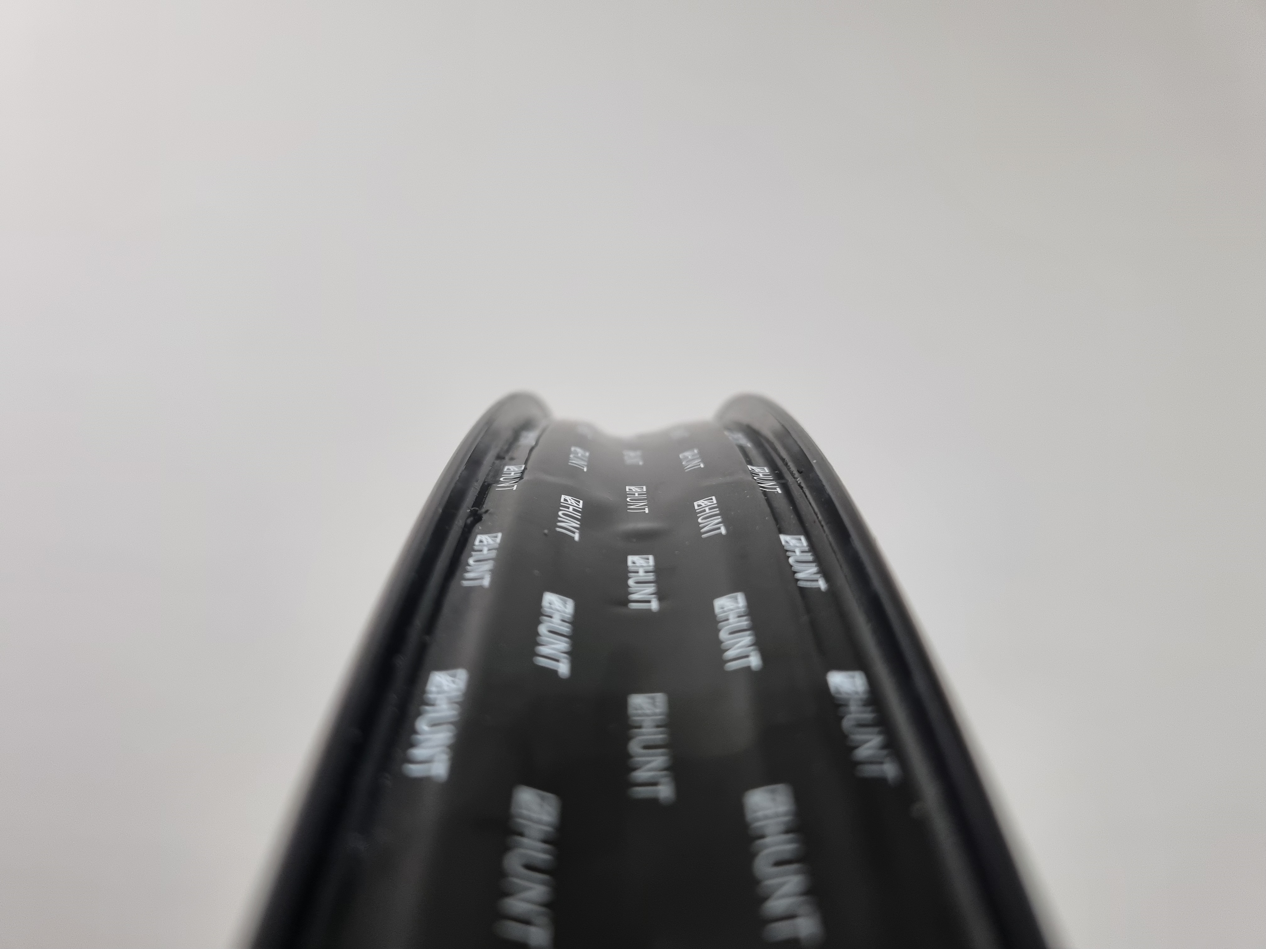

My guess is that the issue is the rim tape.
As you can see, it's only glued on the sides and not in the middle. And there is no way to make it stick in the middle because there isn't enough of it.
In fact, the tape in the middle is a bit stretched, and because of that, when I tightened the valve lock nut, the tape got ripped a little and started leaking.
What do you think?
The front wheel seems good for now, even without the o-ring.
By the way, I managed to spill only a few drops of sealant while doing all that. That must be some kind of record. :cool:
kaaskopf
Oct 11, 2024
168
208
Berlin
running hunt wheels on all my bikes, i agree that there tape job sucks.it needs to stick in the middle for the tire to slide into the middle of the rim
i run these inserts as well and what i always do to make the install a lot easier is putting assembly grease on the the tires bead on 2 sides.
after that i put the tire on the rim like normal and inflate like tubeless setting both sides into place,
after that i remove 1 side and put in the inserts. this way it takes me a total of 5 minutes per tire and they slide in very easily. even with DH casings. because you make a lot more room inside the tire for the inserts to go in.
i always retape mine with wider and decent tape, to stop the problems your facing. its has not been put on from the factory, as i also had some leaking ones, not what you want after putting inserts in....
Zayd Proctor
Nov 2, 2024
29
9
Italy
That's how I did it, like shown in the video I shared above.
I will try that next time, thanks!
The most difficult part for me has been the very last: getting the second bead on the rim with the insert in. I blame that on a lack of experience and partially on this:
What tape do you recommend and what size?
