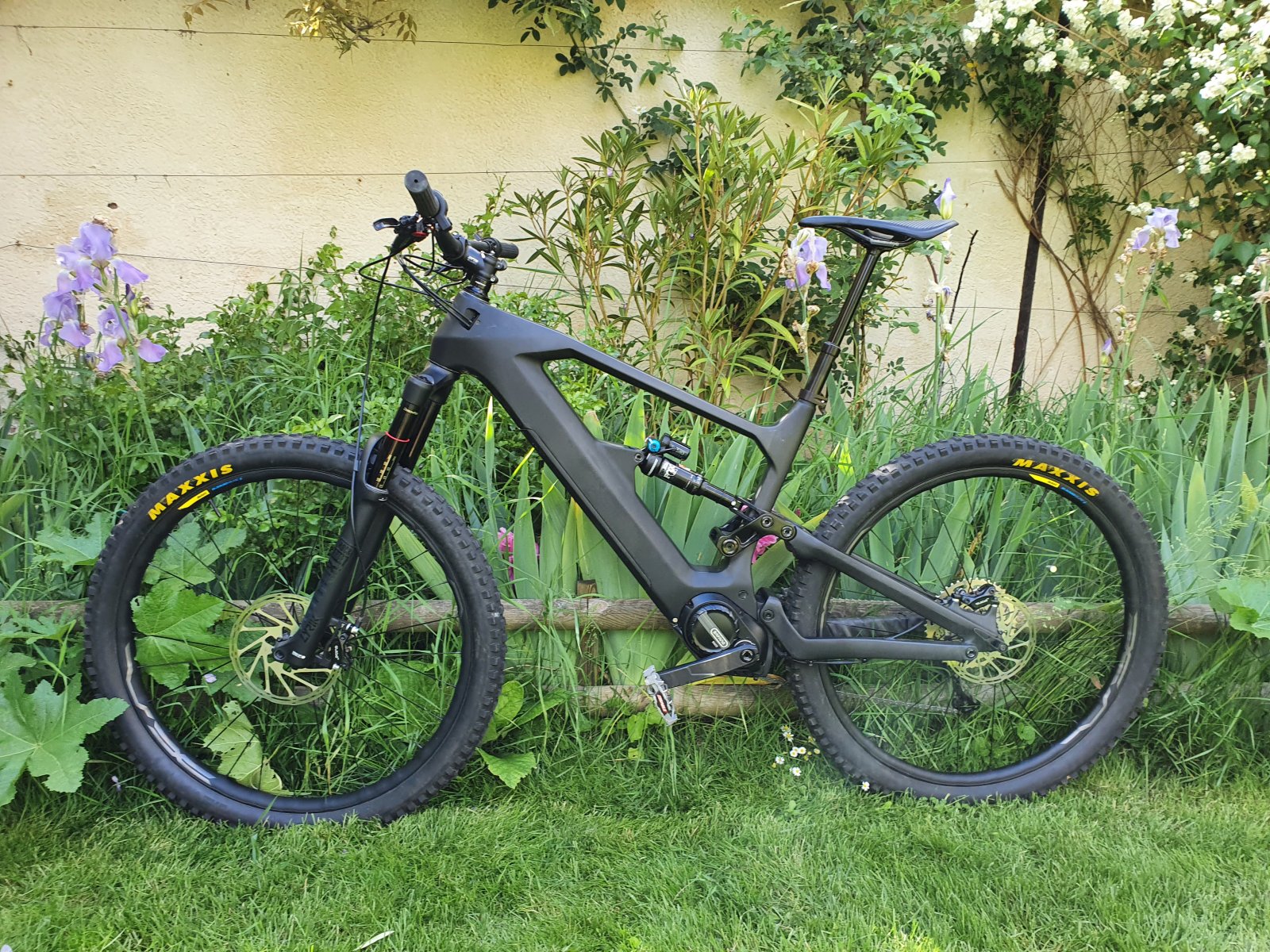

I'm selling my "French CHEEB". It's a very nice bike but it is not what I need to ride the Fontainebleau forest with friends (w/o electric bike) and dog !
I received it late april, clock 120Km. E10 with M600, 29", Lyrik 160mm, Fox DXP2, Shimano DEORE 10s, Guide RE, OneUp V1.
4000Euros, in FONTAINEBLEAU, FRANCE.

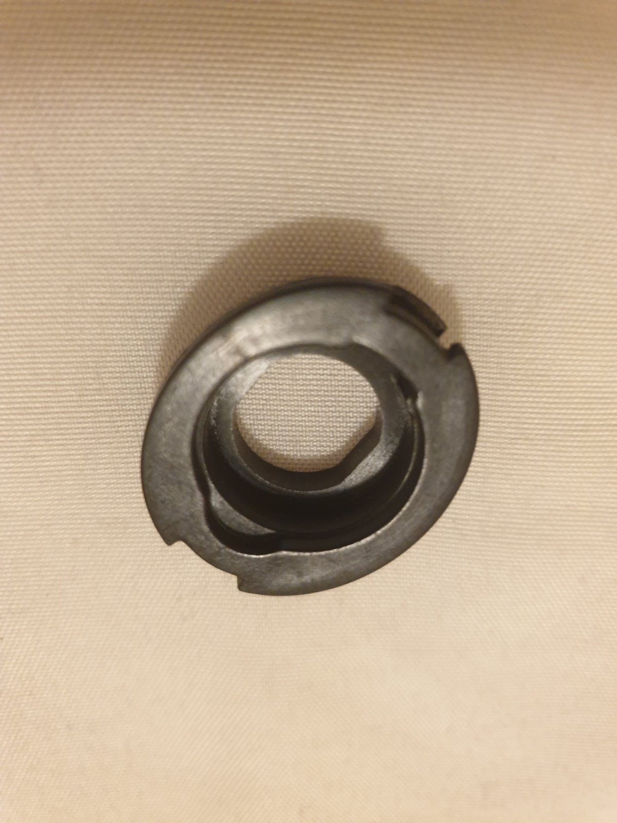

Anyone else got a charge port hole in frane that is much too small to fit the charge port? My port is on the side, near motor. If I file the hole bigger, the carbon also looks too thick at this point for the retaining barbs on the charge port.

make a picture with centimeter/milimeter rule, as I assume your hole is exactly as it should be, you just doing something not correct. DC port on side is also on my bike, but you need to respect there is a bit ovality and put in in correct way. ALso on DC port there is a nut which must goes from inside to hold in place. Make some pictures and we can advise
Yes, the hole is too small to fit the charging port as it comes out of the box. I had the same question as you when I first tried to install the charging port. You need to remove the plastic surround (photo below) and fit only the port into the frame.

I confirm, plastic surrounding is for vertical assembly 1.0 (where DC charging port was located on original CHEEB), where horizontal assembly 1.1 ( located next to motor) does not need it. you use only central part and nut (2 nuts) from inside to secure dc connector. Approach is just horrible, but you can use small fingers to hold/rotate nut or some kind or ultra narrow pliers.

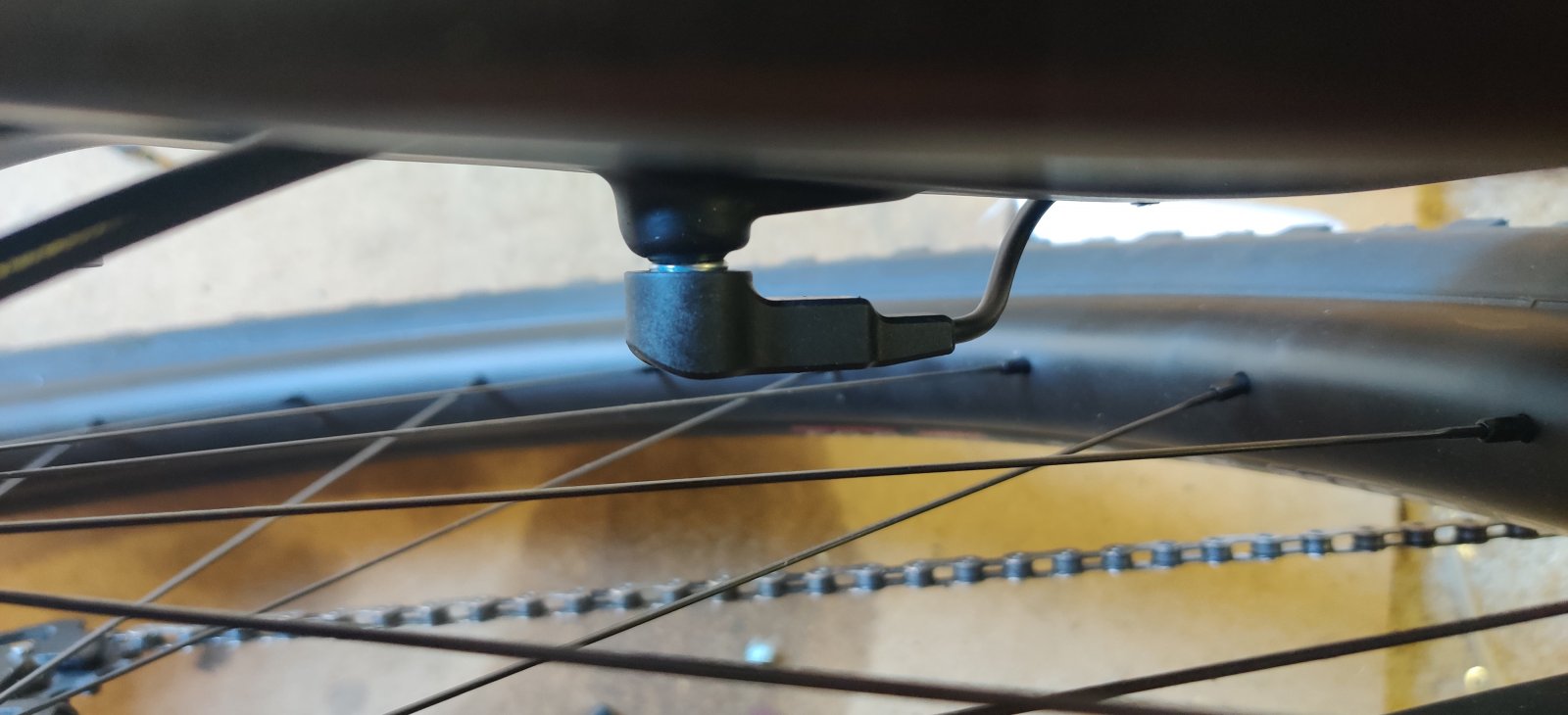

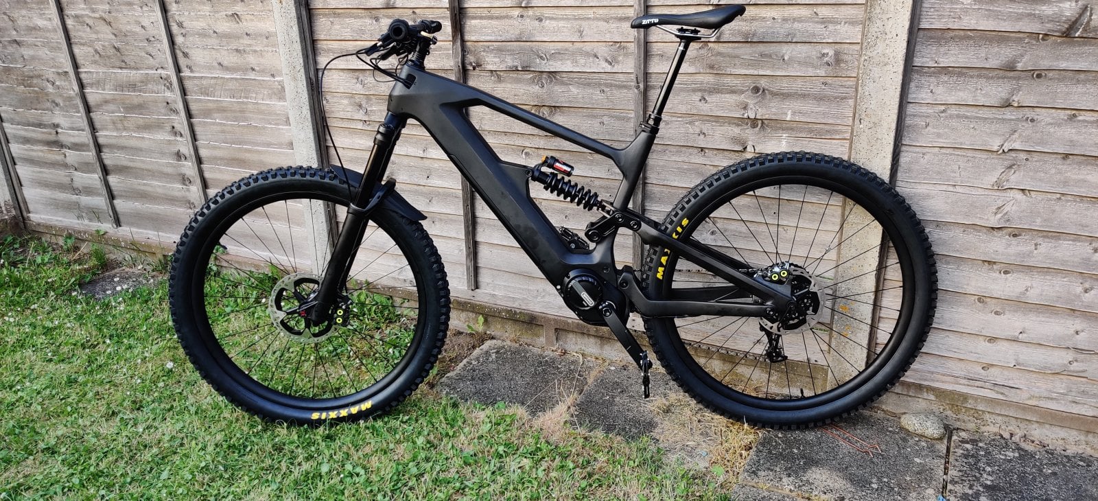

Getting nearer to completion, first short ride tonight. At first I had error 21, speed sensor error, and discovered that bottoming out suspension to fit chain had pulled apart the speed sensor connector.
I used 118 link chain which was just enough for 11s 38T front with 10-42 on the rear.
Second issue was fixing speed sensor magnet in front of round area where it bolts to frame, this is wrong, needs to be fixed in front of sensor body.
Lots of power even on level 1, as others have said, but it's a bit erratic on/off, I can see the speed reading jumping about from 10kph to 50kph and back to 10kph in an instant, so still some issues with speed sensor I guess. I tried sticking a washer behind the sensor to get it closer to the magnet, but still erratic performance. Anyone else had this issue and managed to overcome it? Still I'm pleased with progress this evening :). Once everything is working OK I'll tidy up the build

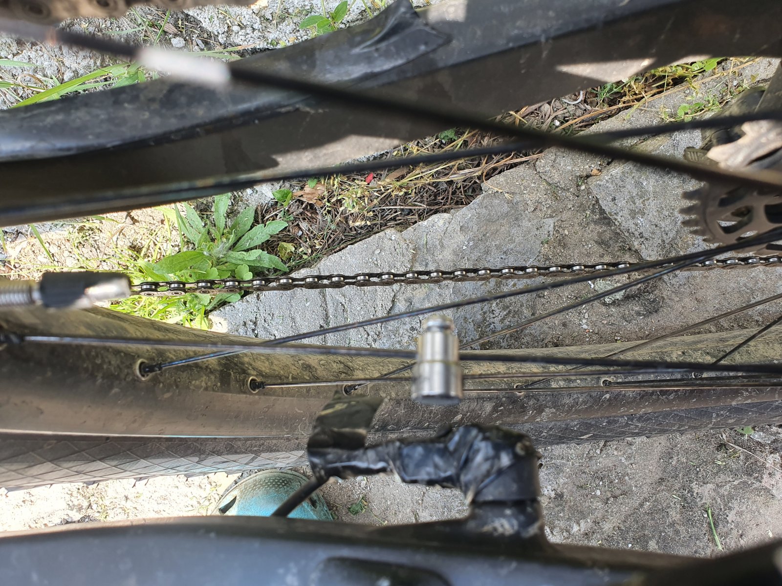

Usual case here is that your speed sensor is not correctly lined with magnet on spike. See attached picture. Tape there is just to prevent dirt.
If align is not the case, you can have:
- invalid sensor -> first check connection to motor. Use contax spray for proper contact to motor and good pliers to insert connector to the end. Usually people are putting it just into 1/2 thinking thats enough. Not, you must do it to the end with pliers (electrical ones).
- invalid controller.
From above i think its either not proper magnet alignment or just not ok connector.

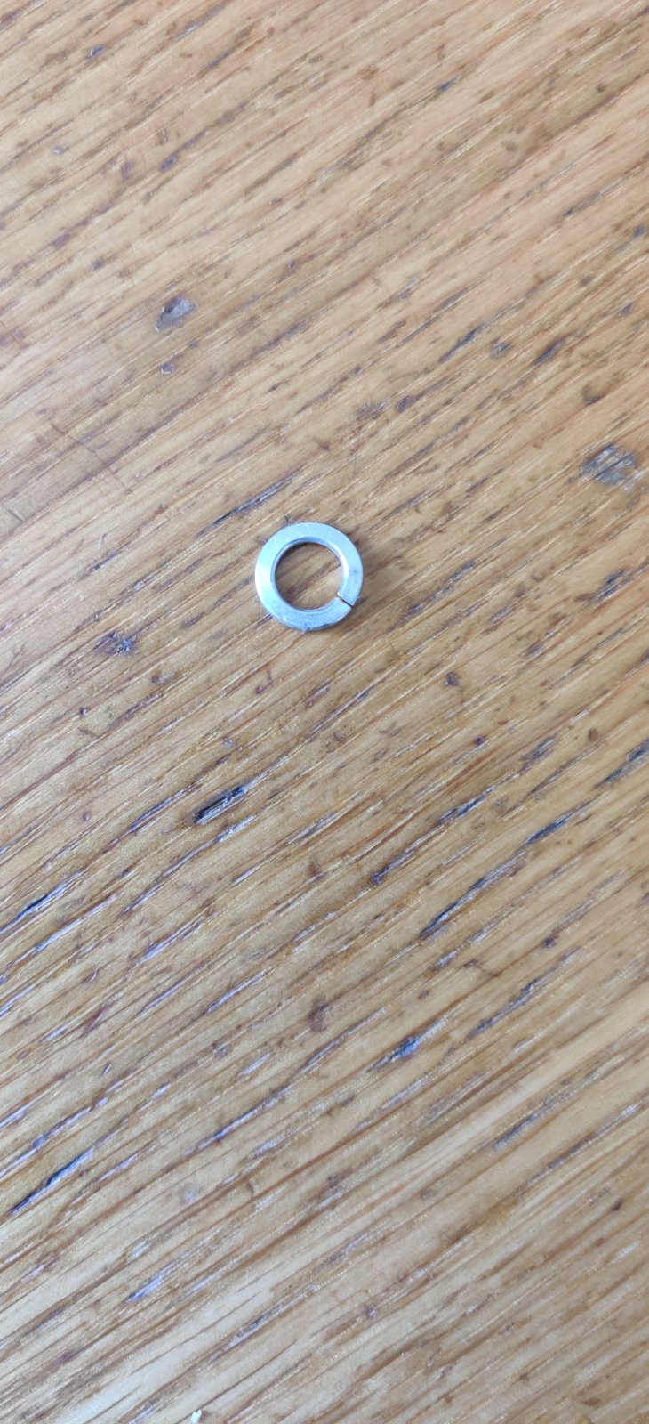

I just past first 1000km mark yesterday, last trip was 128km (with some battery change). Only issues noticed:
- torque NM for motor and pedals -> I respect markings and, but after some km (100km) motor was loose and pedals fall off. Lucky me I found washers on route, so no problem. On evening i disassemble bike and make more torque (saying classic russian ones..) from that time no problem.

Thank you mgx, my magnet looks like your picture so I don't think it's magnet location problem. I will check connection to motor and push again with pliers

OK I've fixed it???
Magnet was not close enough to sensor. I added 2x washer behind sensor (each washer about 1.5mm thick, so 3mm total. One washer was not enough, final gap to magnet is about 3 or 4 mm. IMG_20210608_150514.jpg
