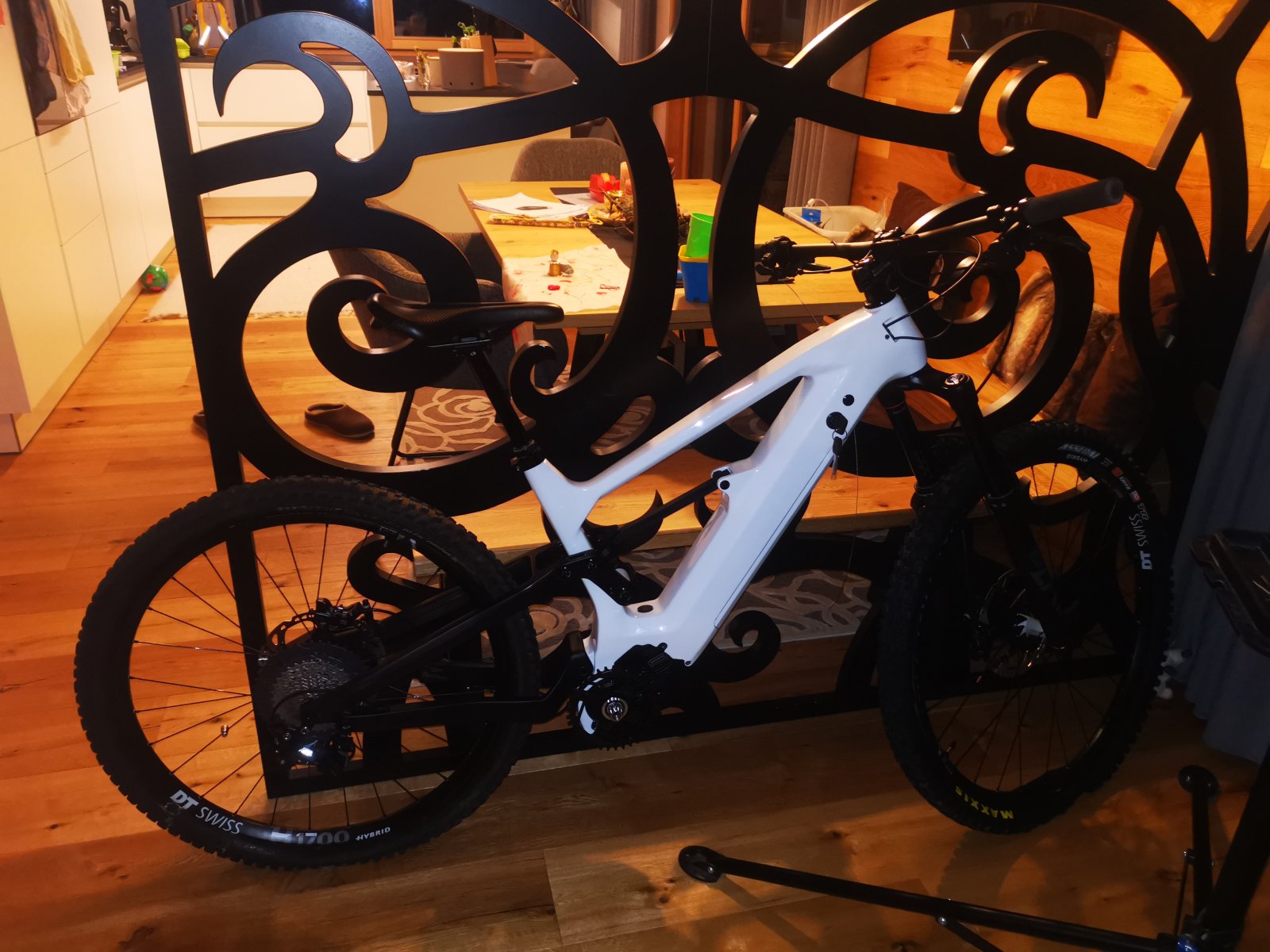

Finally, Battery arrived today! 1st testride successfully done, its a BEAST! 180/29“ front, 170/27.5“ rear. Cane Creek DB Coil 216/63, 2 mm Offset bushing reducing to 214 shock length. Minimal rework on rear shock link needed. BB heigt at 360mm, Head Angle exactly 64 Deg. Almost 25 kg with 840 Wh Battery. Manitou Mezzer Fork. Feels like a flying carpet!

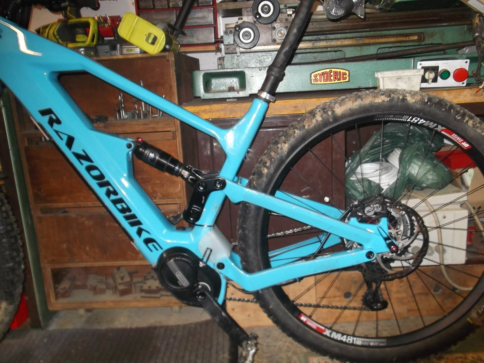

the swing arm heurt before the wheel (here 29" with 215x60) 216x63 pass

Enough of guessing, now I measured it. Shock length 214 mm (with Offset bushing) - 63 mm shock travel is 151 mm shock length fully compressed. I measured the vertical rear travel at the dropout between 214 mm and 151 mm, and it is as calculated, 170 mm! Plus / minus a couple of mm related to the tolerance of my measurement :)

I‘m running a Mullet setup with 180 mm Manitou Mezzer on the front. Head angle at 64 degree, BB height at 360 mm. Perfectly balanced in my opinion. If You run a 20 mm shorter fork, the head angle will increase by appr. 1 degree in Mullet setup, expectation is 65 degree. If You run 29“ front and rear, Your head angle will be at factory spec 66 degree plus 1 degree ending up at 67 degree - not a good idea. With a160 mm fork I would use the standard shock length of 210 mm / 55 mm travel for better balance.

i'm using XL with160 front, 216x63 normal bushing, 29 front rear in 2.4 / 2.5 and i appréciâtes a lot. Tried with 27.5 rear and i find it a (very) little bit less secure front. but it is with different tire, may be the raison, in any case not great differencies.
My recomandation: try and chose that you prefer. It havn't magic recipt. the track, the practice, the speed, the technical level, frame size. all these different parameters can done that coresponding to one can't satify other

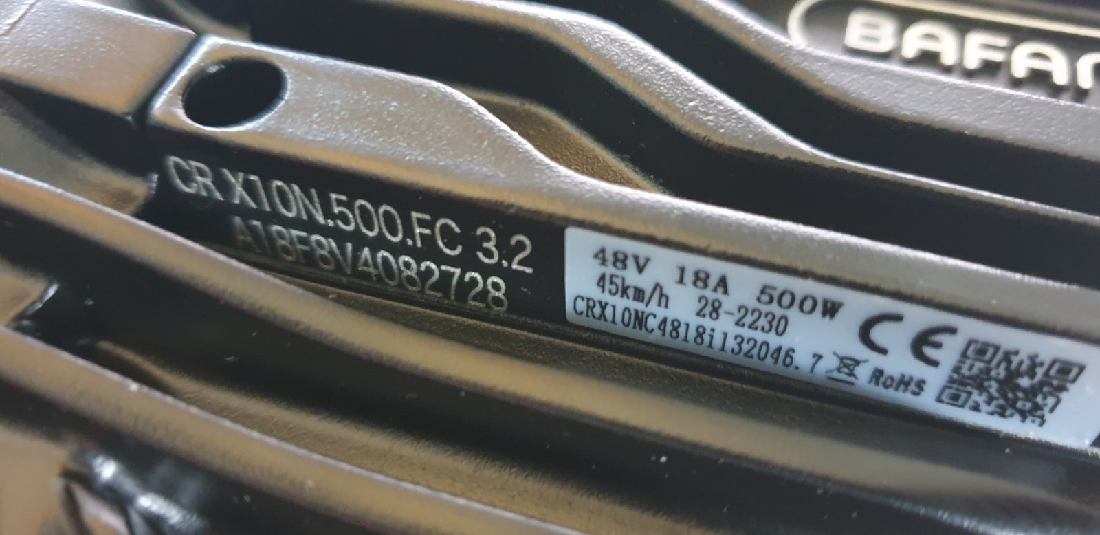

Well my M600 motor and accessories arrived safely today from Dengfu - many thanks Melody :)
Ordered 15/04/21 so fairly quick turn around.
Just the frame to go.
Here's a photo of the controller showing the latest version from Bafang.
Serial No. A18F8V4082728.
Software version:- CRX10NC4818i132046.7
