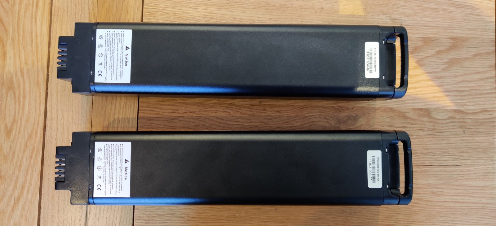

840Wh Battery arrived today, received notification via email a week before that the job had been created from DTDC and then got notification that it was out for delivery from DPD (UK). Beforehand, I thought it might be the frame, but there was no info as to where it was from or what it was in any of the email or SMS notifications.
Weight of battery is 3894g - just waiting for the frame now :)

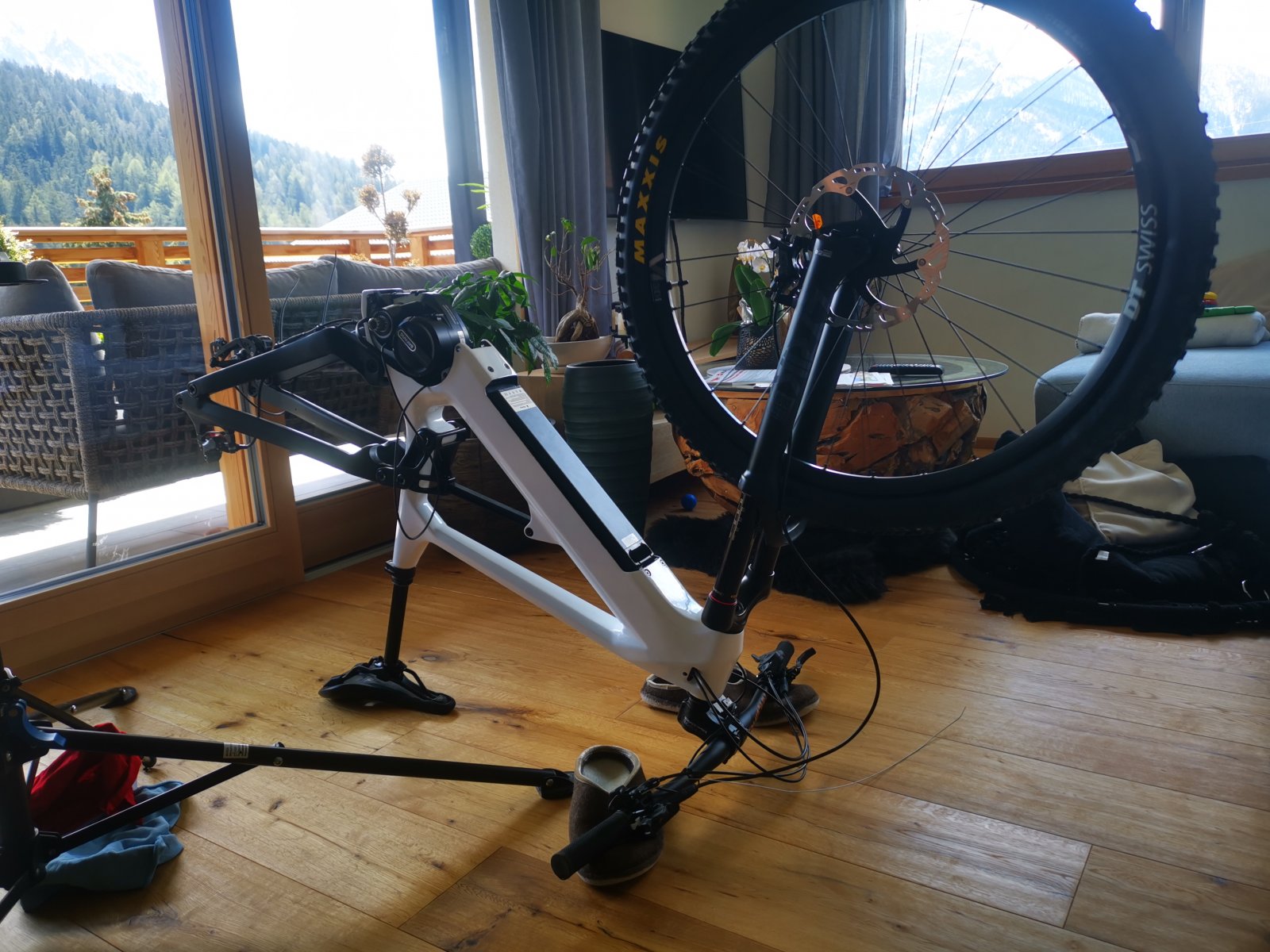

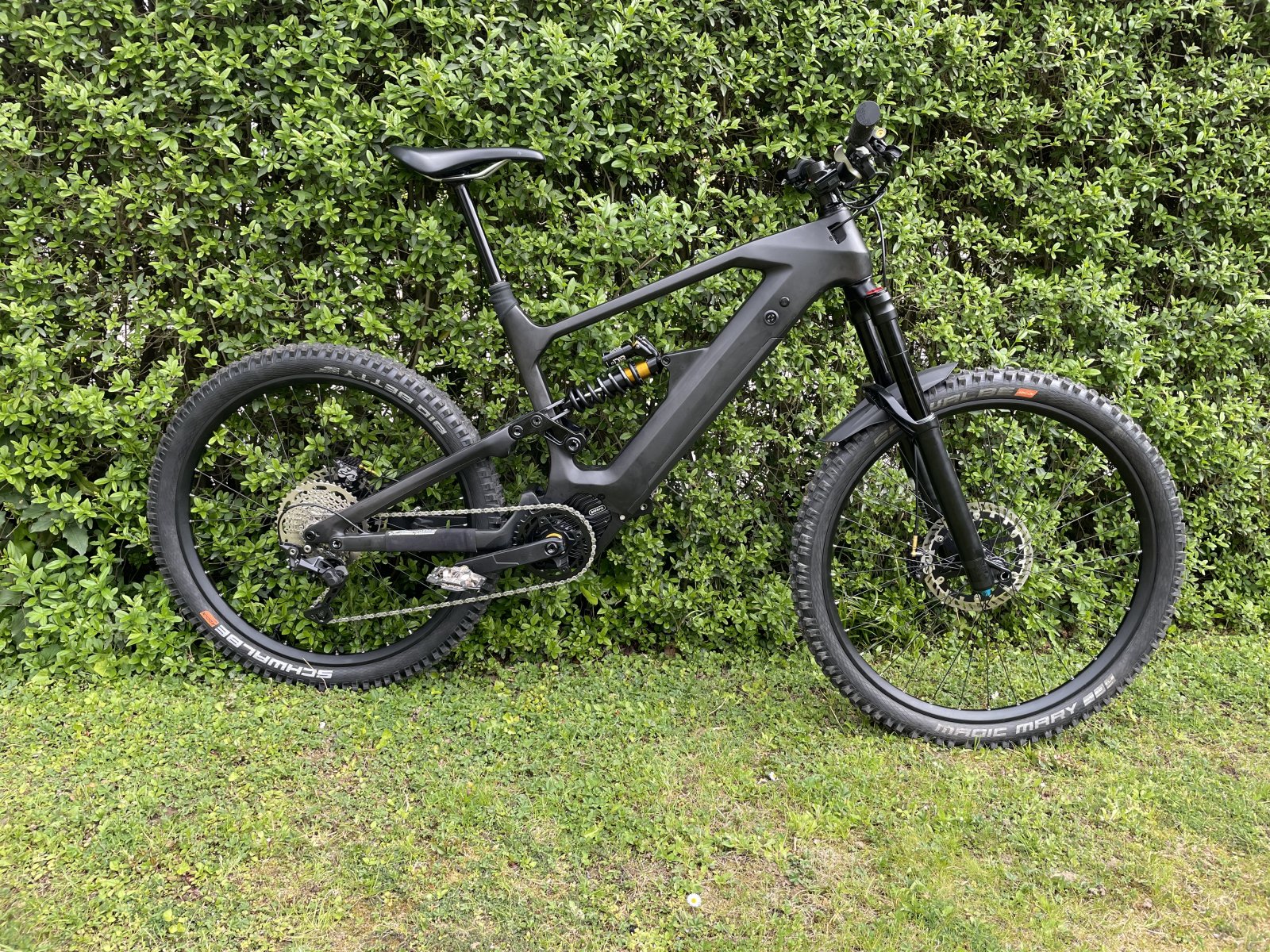

Finally, Battery arrived today! 1st testride successfully done, its a BEAST! 180/29“ front, 170/27.5“ rear. Cane Creek DB Coil 216/63, 2 mm Offset bushing reducing to 214 shock length. Minimal rework on rear shock link needed. BB heigt at 360mm, Head Angle exactly 64 Deg. Almost 25 kg with 840 Wh Battery. Manitou Mezzer Fork. Feels like a flying carpet!

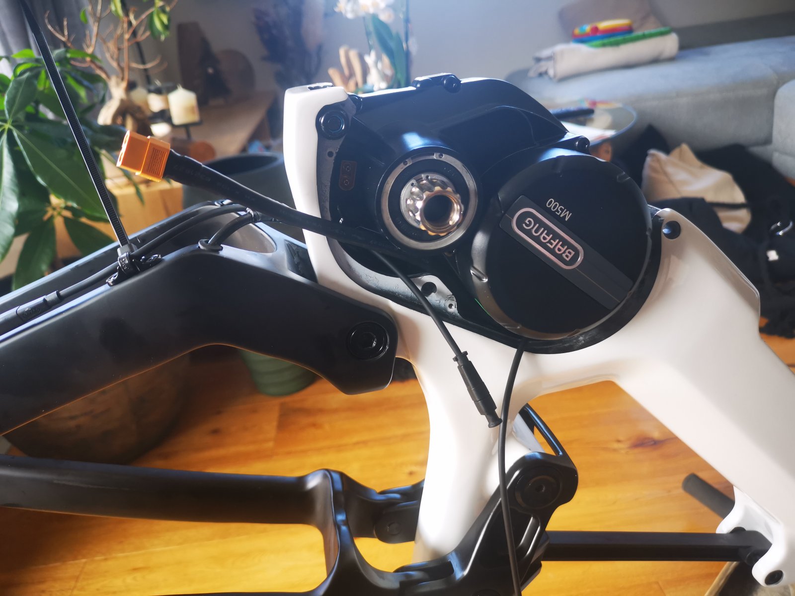

Great ??. Can you give me some advice what for this two parts are? And how did you wire the cables around the motor? Maybe you can send me some detailled pictures?

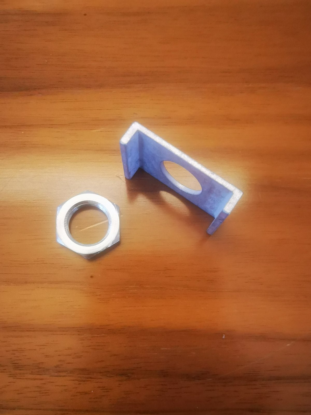

I didnt use this part, I think installation of the on/off button is easier because of tool access. Cable is very easy:
- Cable from Display left connection on Motor. 2nd from left unused. 3rd from left is speed sensor. Then last one is power connection. I disassembled the battery mount with the key lock completely. More to follow. I‘m done for today, almost 12h of bike work beside my job the last 2 days. Frame protection and chain guide tomorrow morning and then: Lets get it on!

But did'nt you already test it? What can you tell us about the differences between other ebikes and yours?
Is your charger also so loud and getting really hot ??

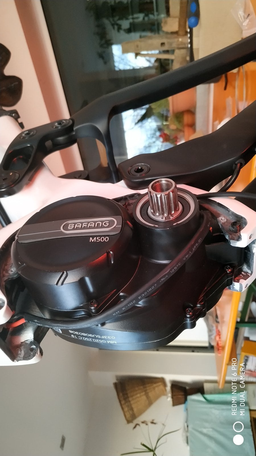

Cables: I wanted to ask how you guided the cables around the motor as recently I saw a pic (see pic) whit a cable that was guided under the motor and was wondering if this is correct.

Yes the charger fan is noisy. So make sure to charge the battery in Your wifes room ?All cables are routes above the engine, rear shifting cable and brake line as well. Ensure that the cables are on the left side in driving direction above the motor, so they dont get dammaged at the engine mount. If You do it correctly, Only the power line and the wire from the display have to be routed over the engine. All others con be hided within the frame. My buddy just told me engine support and feeling is bettee then his new Conmencal Meta Power with EP8. For me its the first Ebike, so no real comparison possible. I think it rides really great! Very natural an powerful.

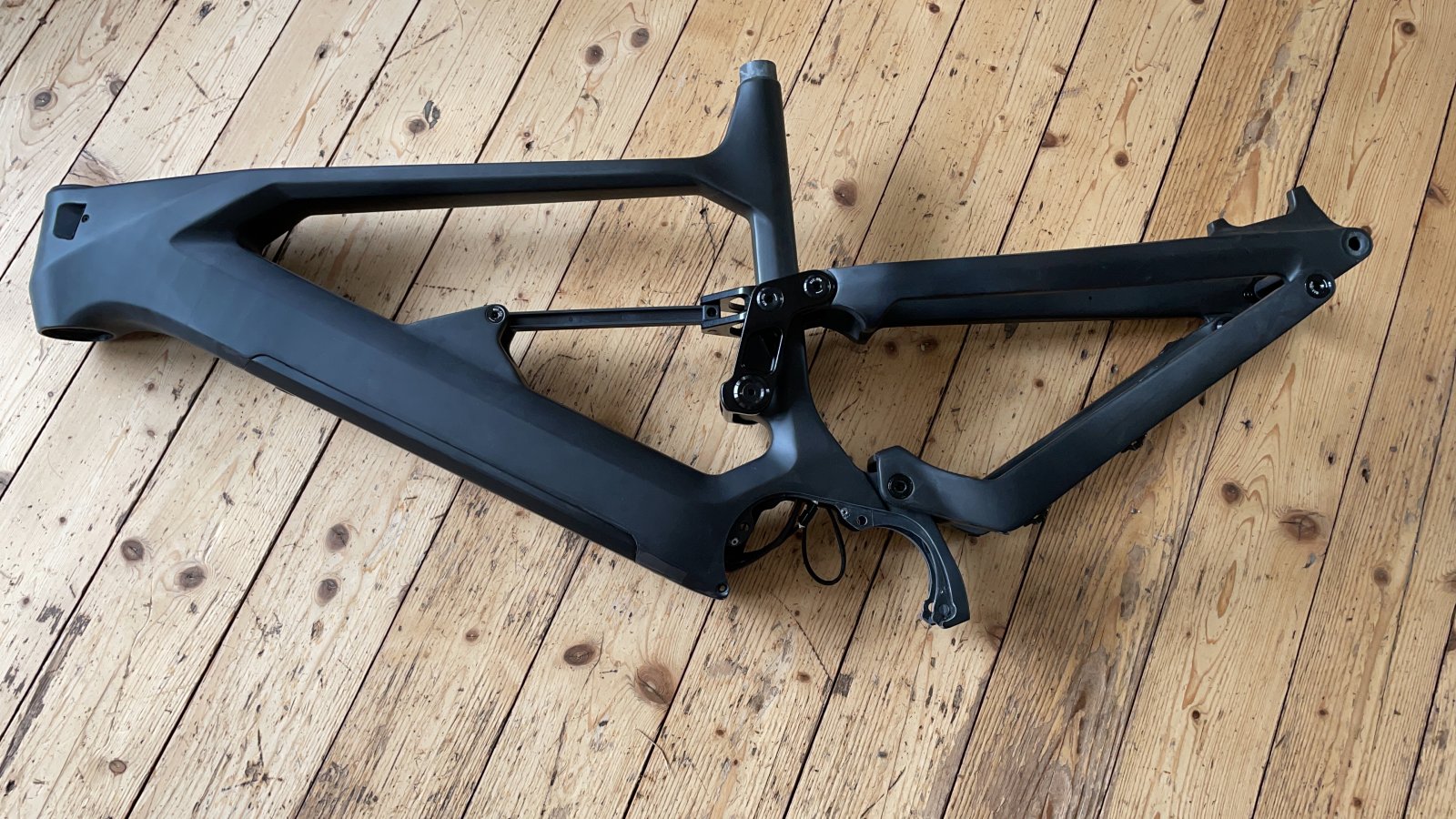

Very nice man! I see you left the bike unpainted. I am starting to like these matt black builds we see here.
I would like to know know if the frame itself already has any clear coat or does it not require any clear coat?

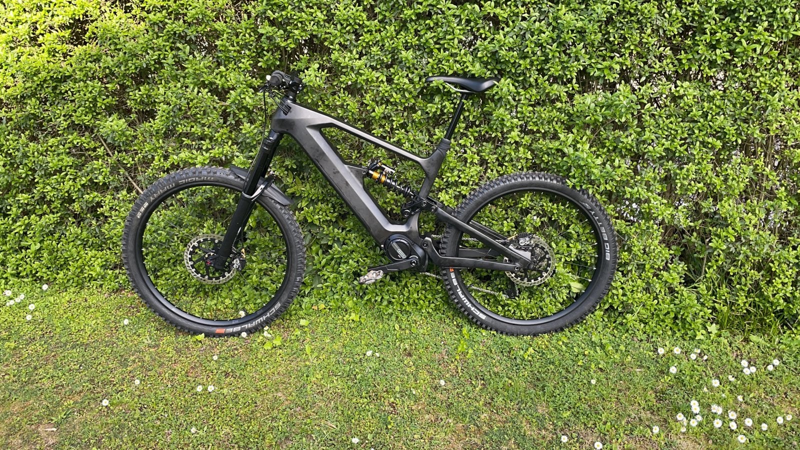

2 h ride on my hometrails. Compared to my very well equipped Rotwild R.GE 1 180/180 this is insane, ironing the trail! Zero Problems, motor power for me is more then sufficient. Battery consumption is very low, 36 km, 600 hm, mostly on Level4, 70% Battery left. Great fun and I‘m really happy!

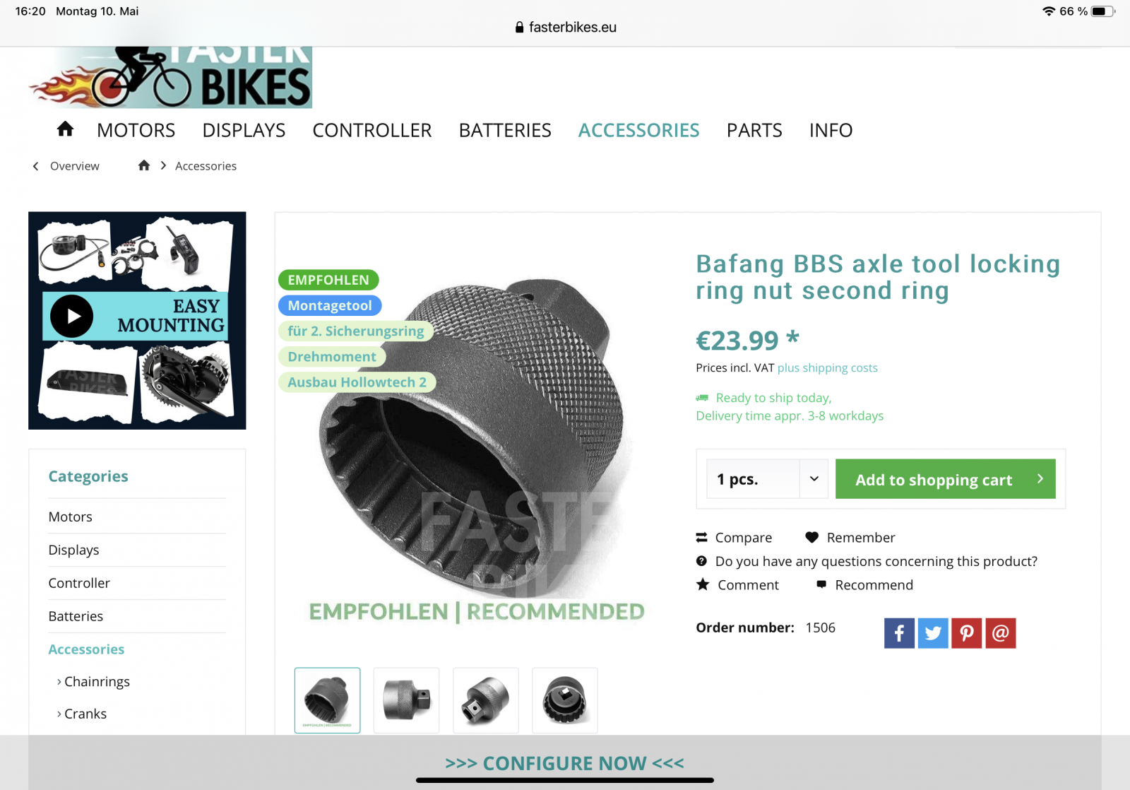

What tool are you using to put the crank nut on???
