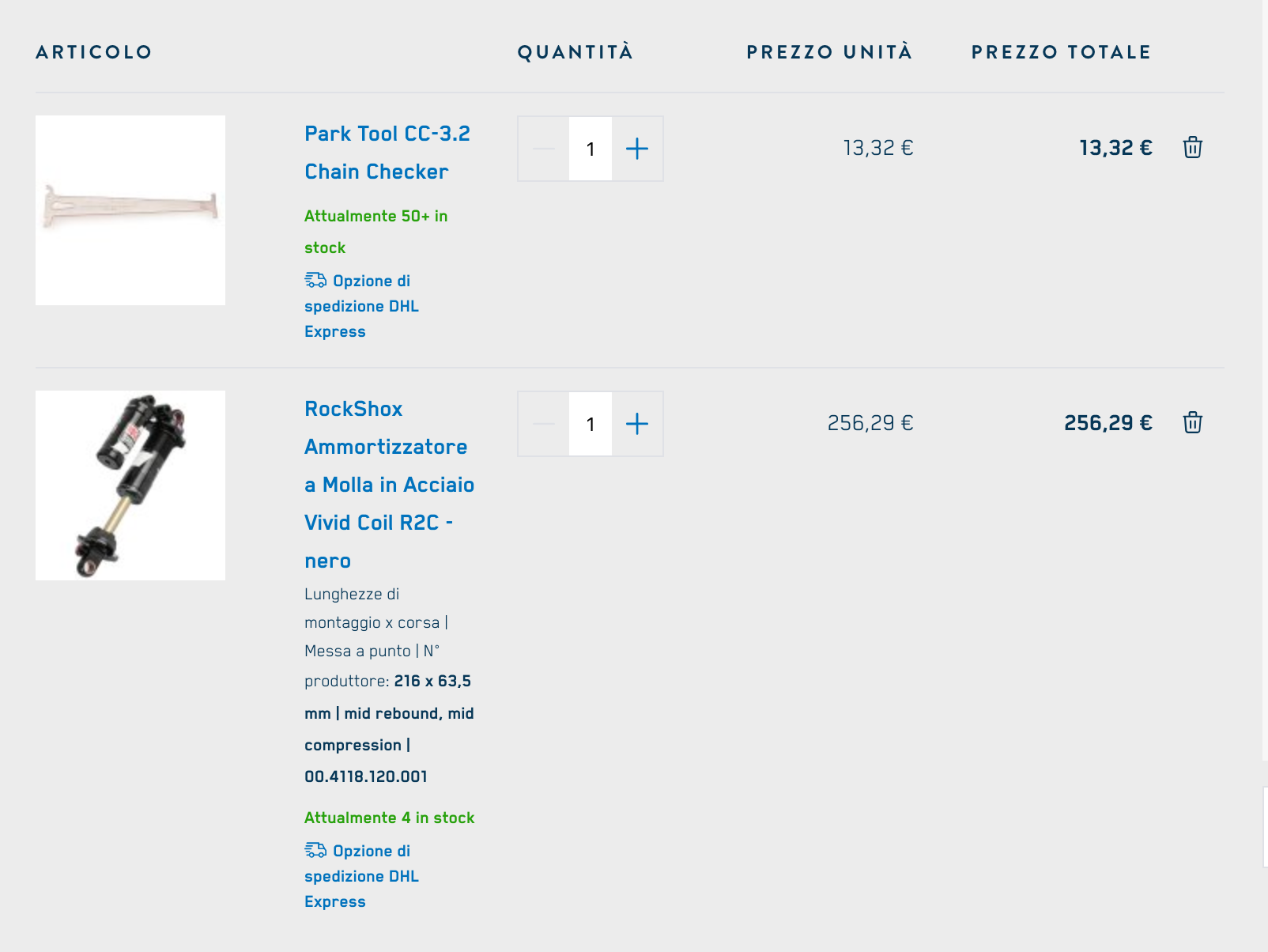

Ok, so final components:
As always, suggestions are welcome.
I decided to go with the rockshox coil because the price is too good to be ignored. The Marzocchi didn't go on sale, in fact, the price increased to 333ā‚¬.
Some of the pivot bearings feel rough, so I decided to replace them all. The best deal I could find is from Trailvision, Blueseal bearings.

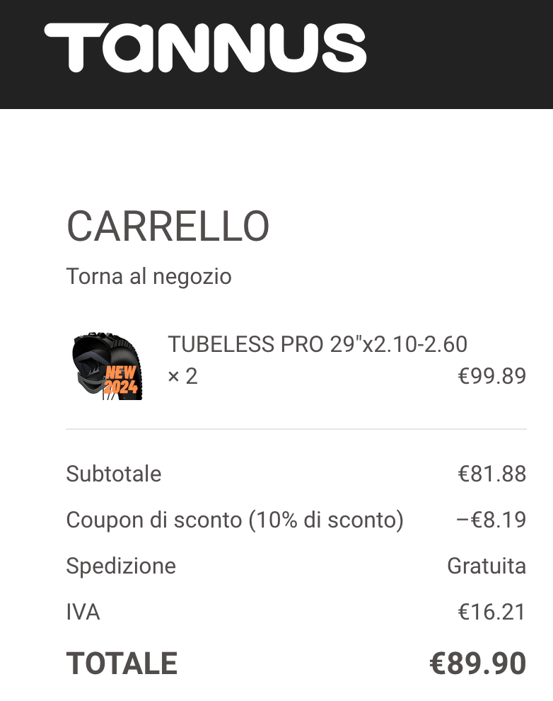

There are a few tyres on sale. Not sure what to get.
What is the biggest 29" tyre I can fit in the back? 2.6"?

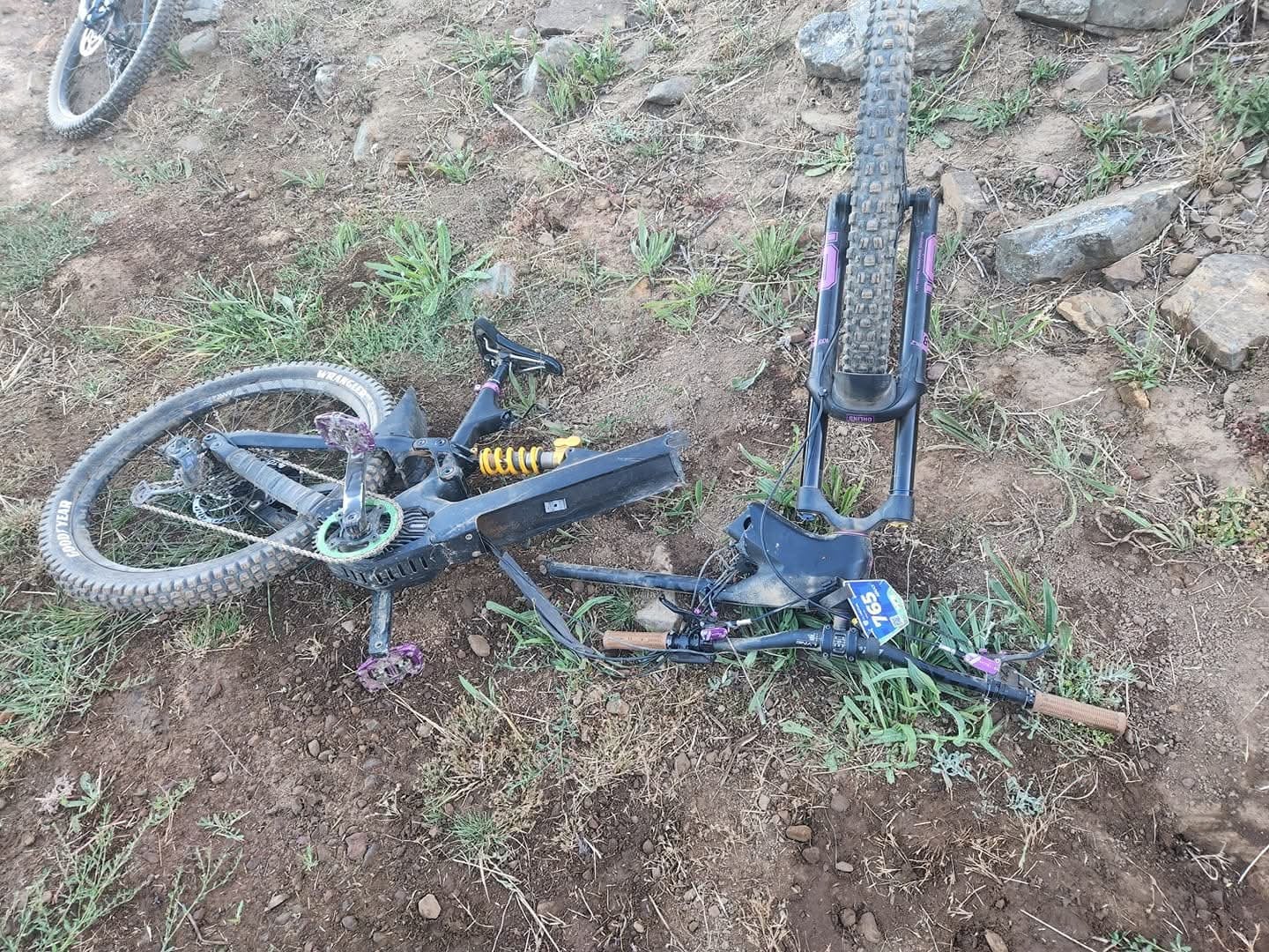

Does this look normal to you? Dengfu are telling the person he hit something. They are right. The ground. The owner had two other people that seen the bike snap in half off a landing. They are refusing warranty.
patdam
Jan 17, 2019
945
608
france
I can't said nothing, i was not here when the frame brake. I can just said mine functioning well (and i know that it have lot of other).
About warranty. pity but by experience i don't trust china company warranty, mostly in this time where the market dying. I trust more the return of the customers for identify company who sale quality product. To be honest at this time i never found after sale support from china supplier. A little from bafang, where the necessary spares to repair my motor has not available. after long fight they take directly in charge my problem. But if that occur one more time, i will prefer to purchase an spare new motor.
This doesn't really surprise me. What does surprise me is that someone who does 9m jumps would entrust his life to a Chinese frame. The warranty thing is nothing new either.
sandnap
Dec 23, 2023
131
129
Herriman, UT USA
That looks painful! I hope the rider was not seriously injured.
Broken carbon frames are not that uncommon, even among name brands. Heavy ebikes exacerbate the problem and having a frame with removable battery, especially with a key lock presents an additional engineering challenge. You only have three surfaces and one of them has a large hole in it.
Poor warranties are also not uncommon, especially with lesser known Chinese brands. I don't think it's fair to say all Chinese manufactured frames are bad though. One also has to consider that you can buy 3-5 of these frames for the price of a name brand frame.
If I was taking hits like that on a regular bases I would be looking for frames that have a solid safety record. For most riders though, a good quality Chinese frame will serve them well. I don't own a Dengfu but I inspected my LightCarbon very carefully inside and out and confidence that it will be fine for the riding I do.

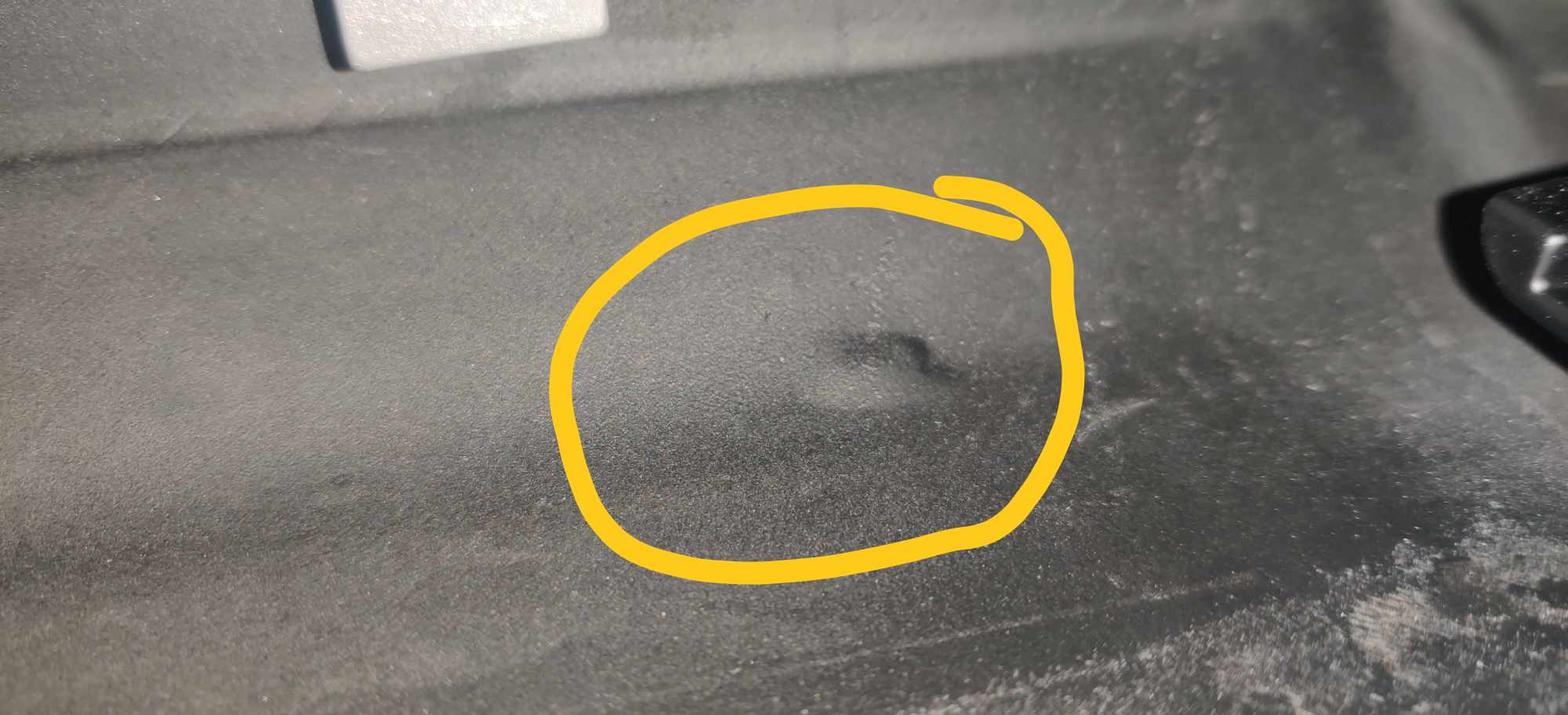

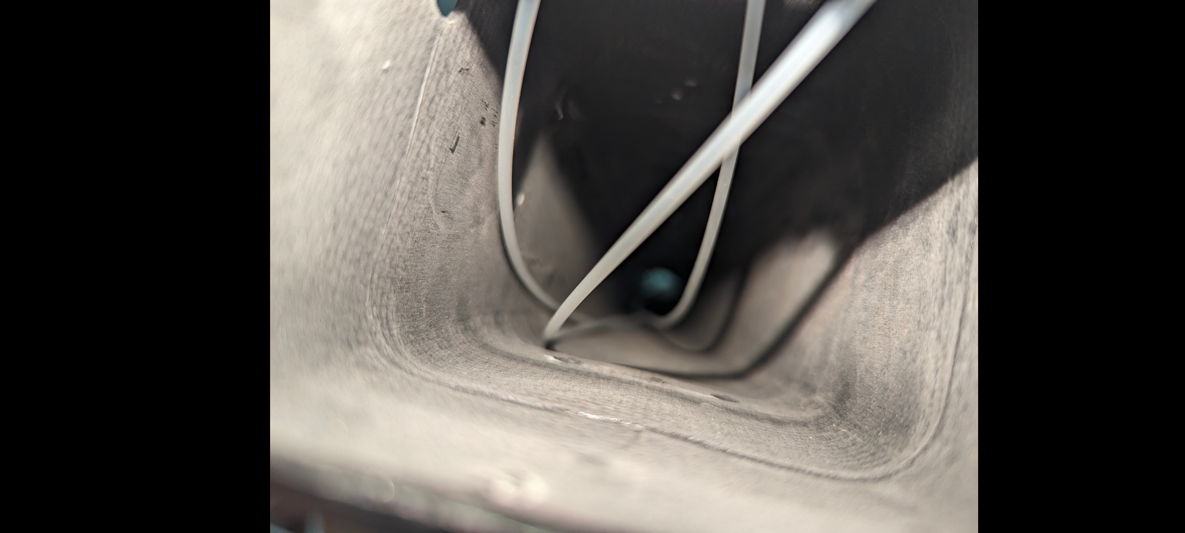

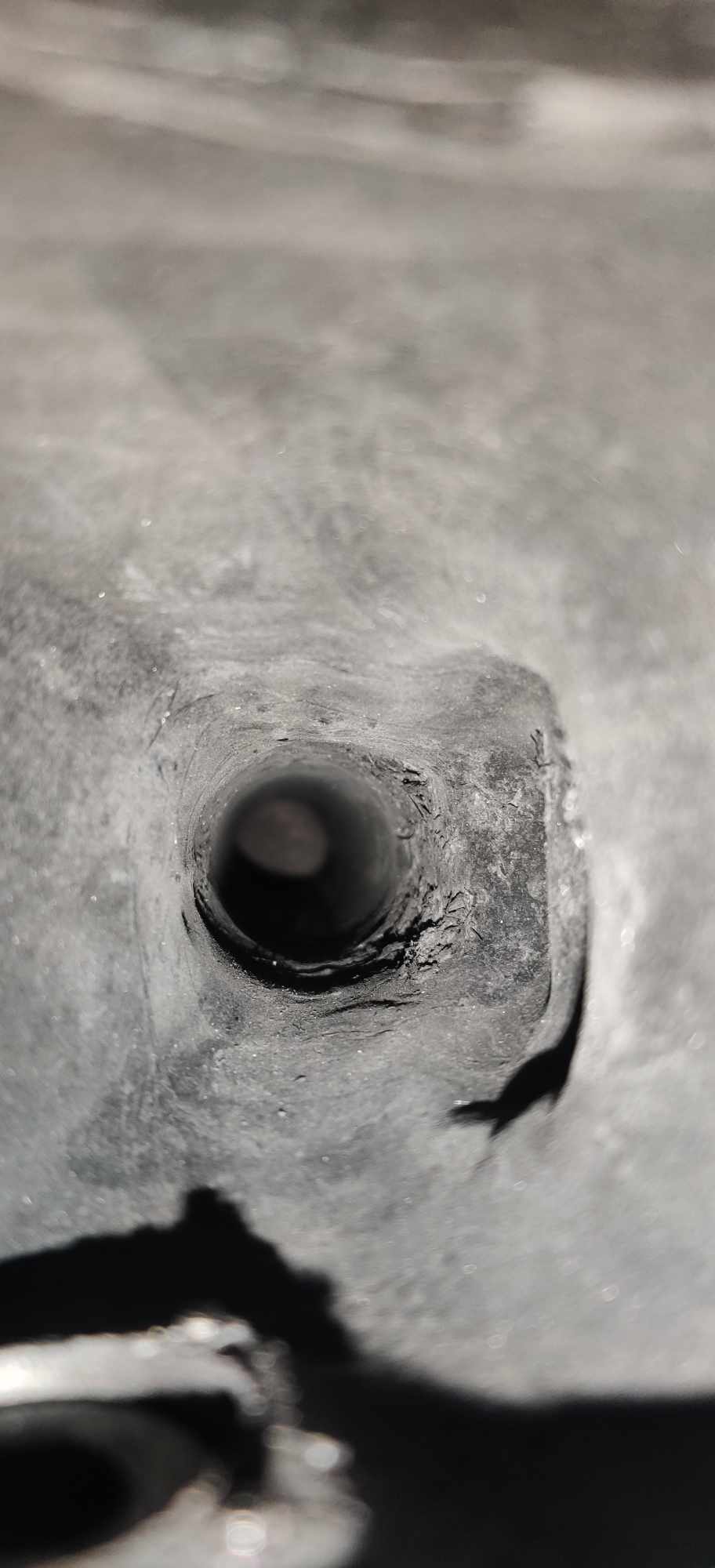

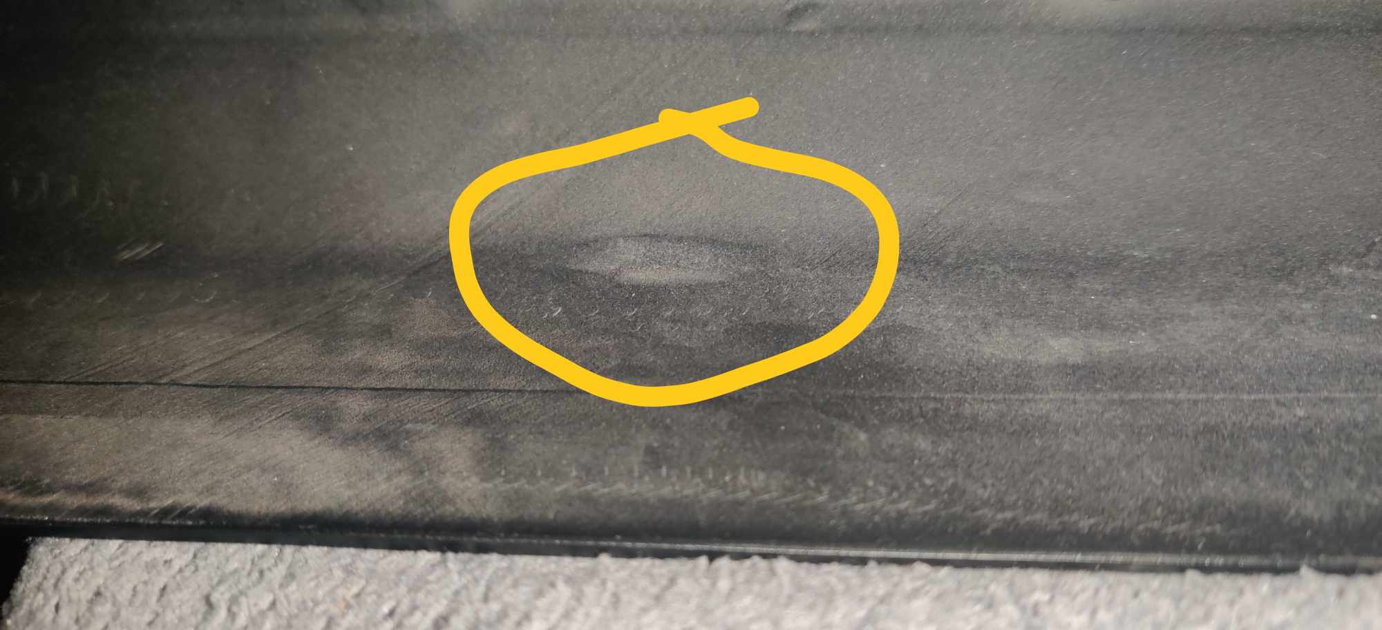

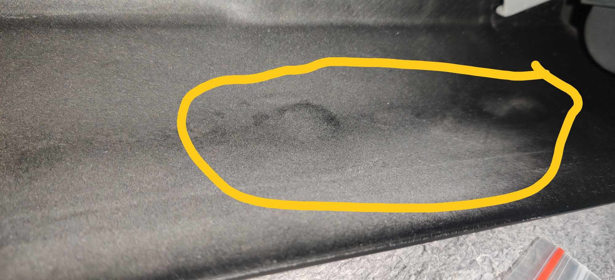

This is my E82, if anyone's considering one of their frames I'd rethink it
Messenger_creation_796A1648-E23B-4922-9C56-5DB416F2AD73.jpeg Messenger_creation_04D2CD6D-EAA2-43DC-8058-E363FE4ECEF6.jpeg Messenger_creation_F85EBB29-1DF8-4DD5-B8D3-571796638F1D.jpeg Messenger_creation_98B6DDA3-116F-4116-B7CE-843CFBF8EE14.jpeg
dazirl
Oct 31, 2024
35
22
Ireland
That is clearly poor quality work. šŸ˜¬ Is this a recent problem? They have sold a lot of frames over the last few years.
