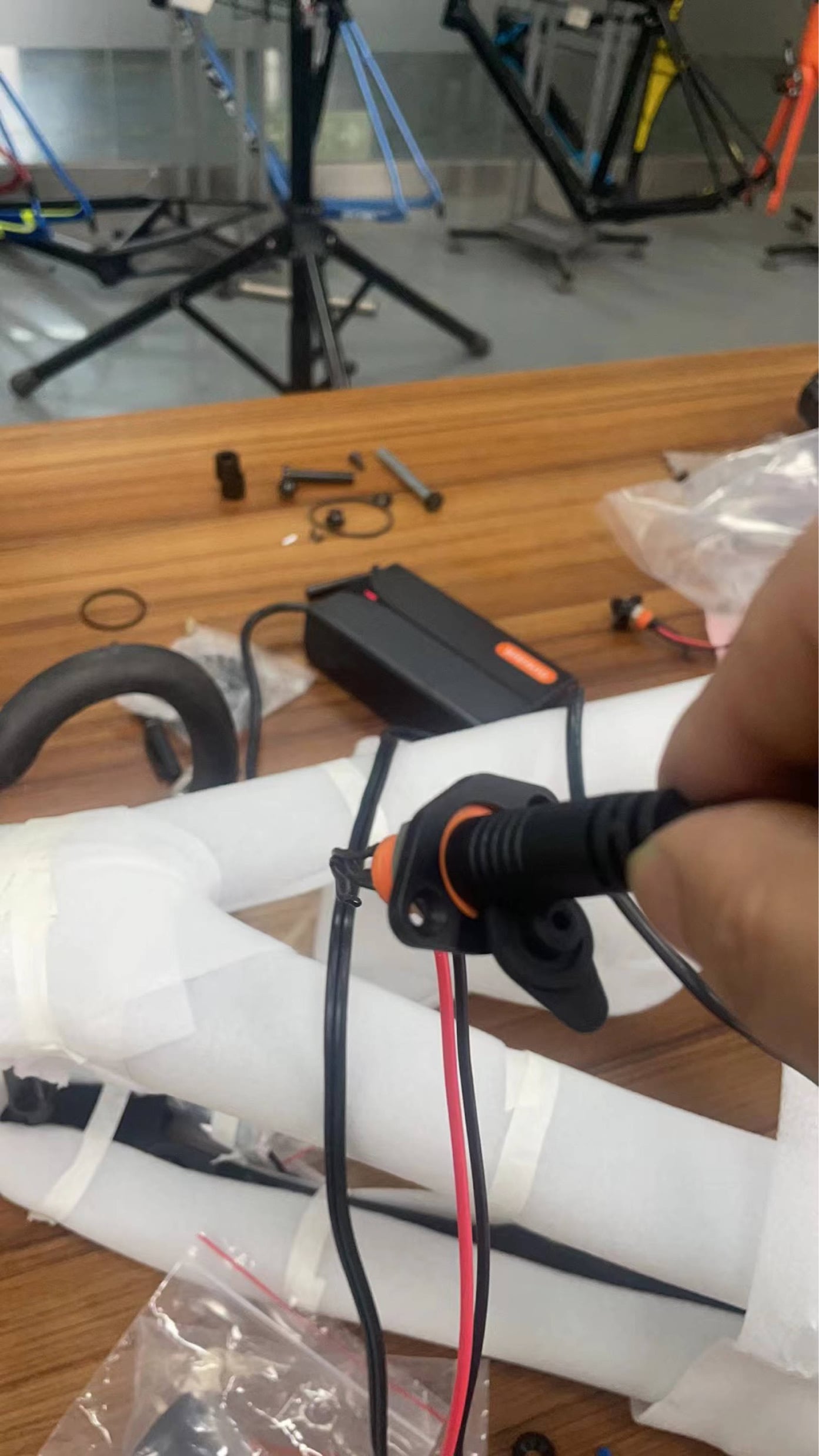

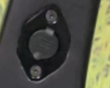

Bro, u ever ask Linda closer photo of charger port on CEF50 and ask her about the spare? worried about the charger hole cover not lasting long like Dengfu. Or is there any subtitute for it.
This is the best shot of it so far. You could ask to get a close up with the cover open to see more details. I doubt it's more than a plastic/rubber cap and hinge that could break off far before the lifetime of the frame.
Maybe somebody can create a DIY version. Perhaps, imbed or glue a magnet and metal spacer on it to help keep it covered securely for a nice bike hack?🤛

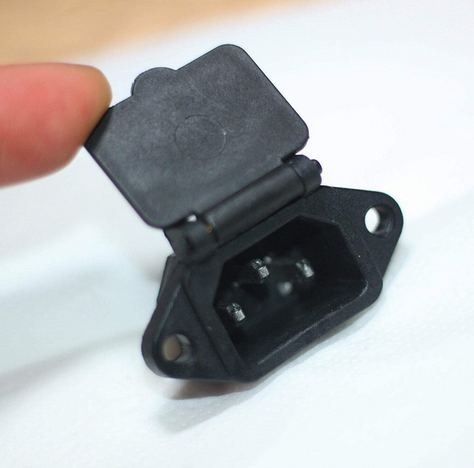

I don't like that one because the door just slides over the socket. The Bafang appears to push into the socket forming a seal.

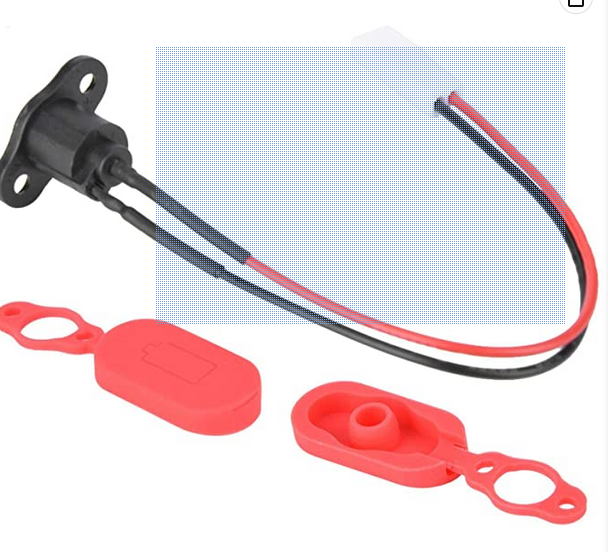

From the specs my charger is a CHG C01.2A.EN which has a plain two conductor 8x12 pin. No fancy monitoring. So any two pin connector that fits the opening and has the current capacity should work. Go weather seal is important to me.
Maybe:

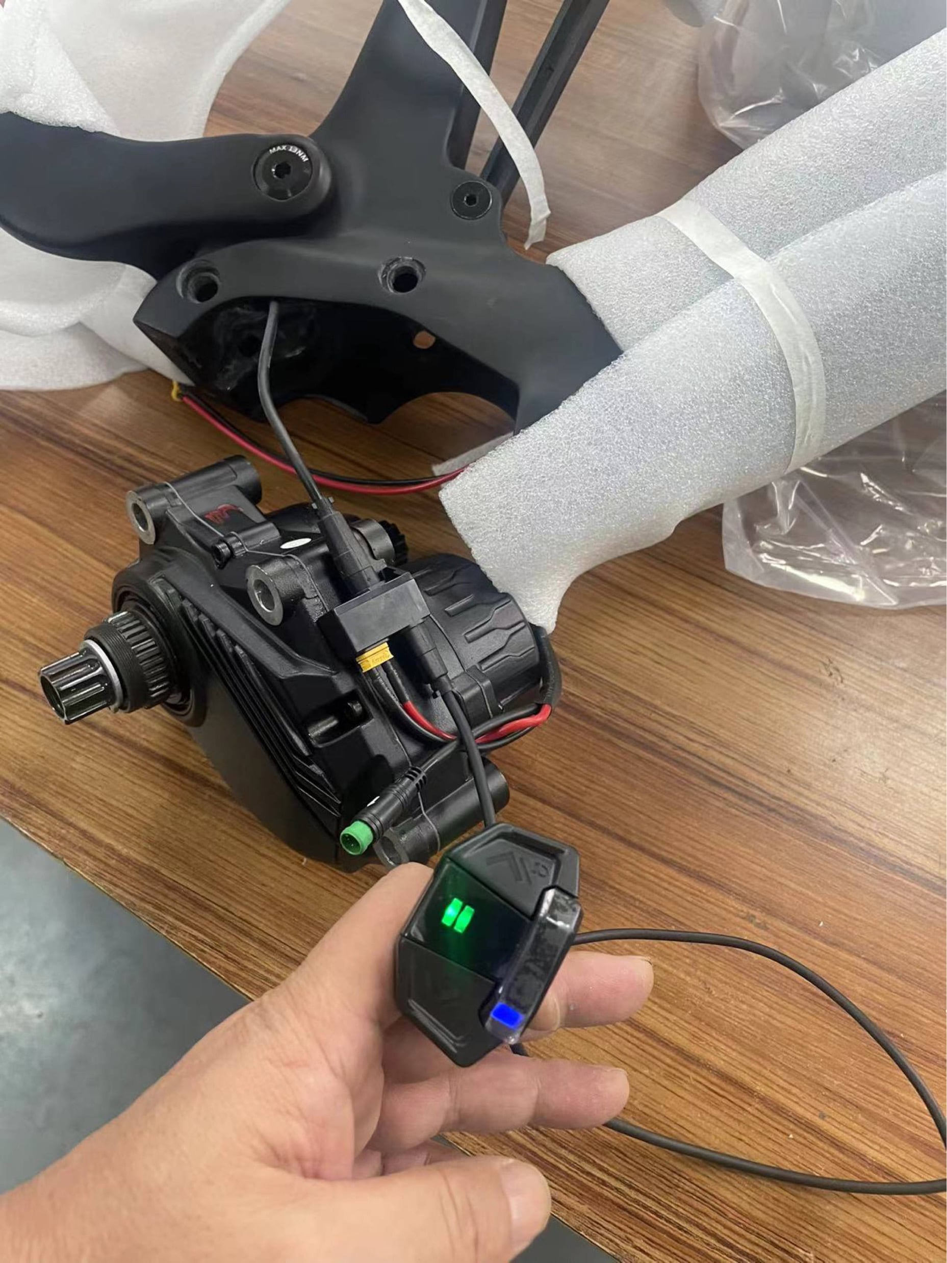

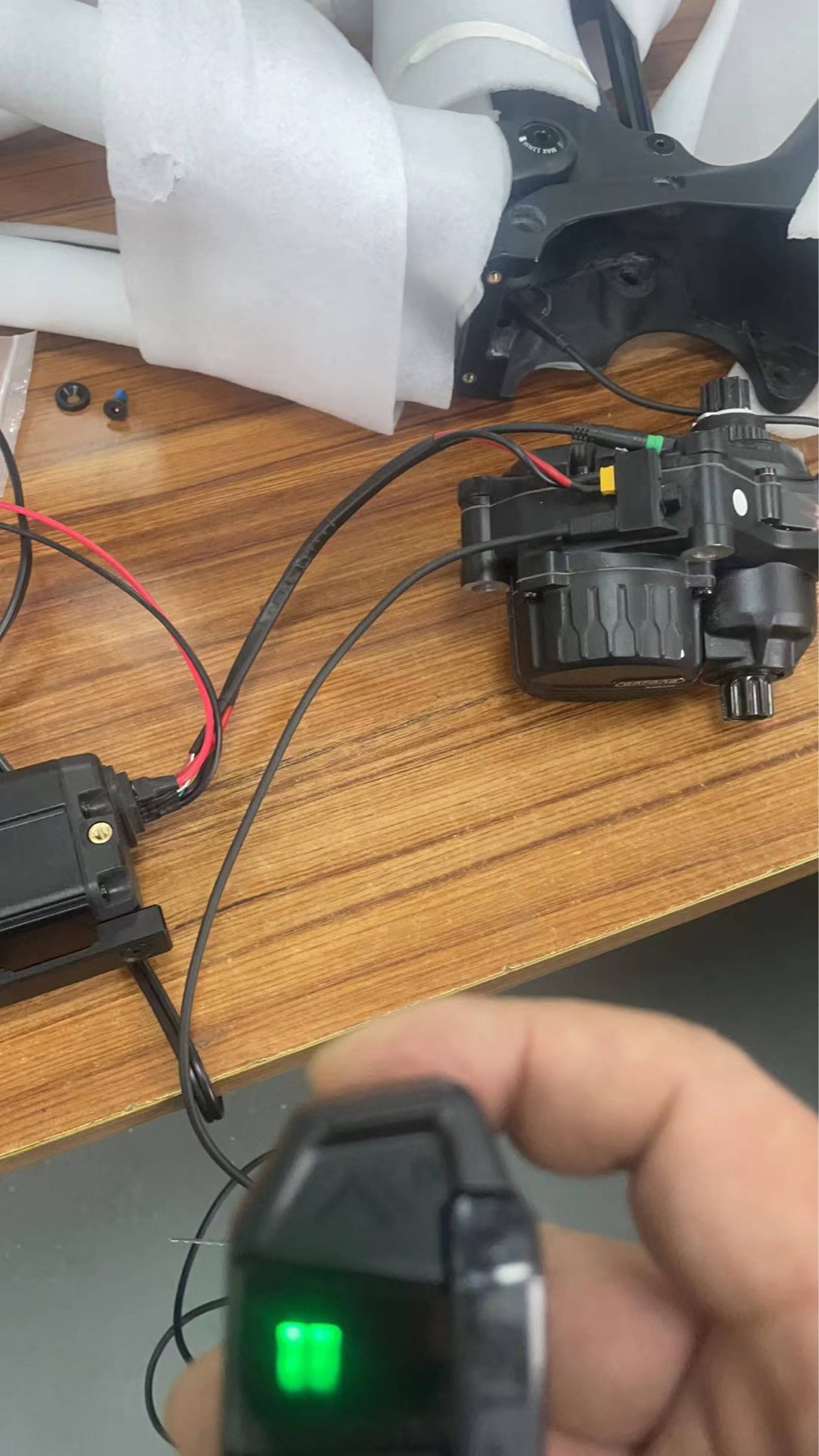

To those who have assembled an emtb before. Is the controller a separate box or will it be inside the motor?

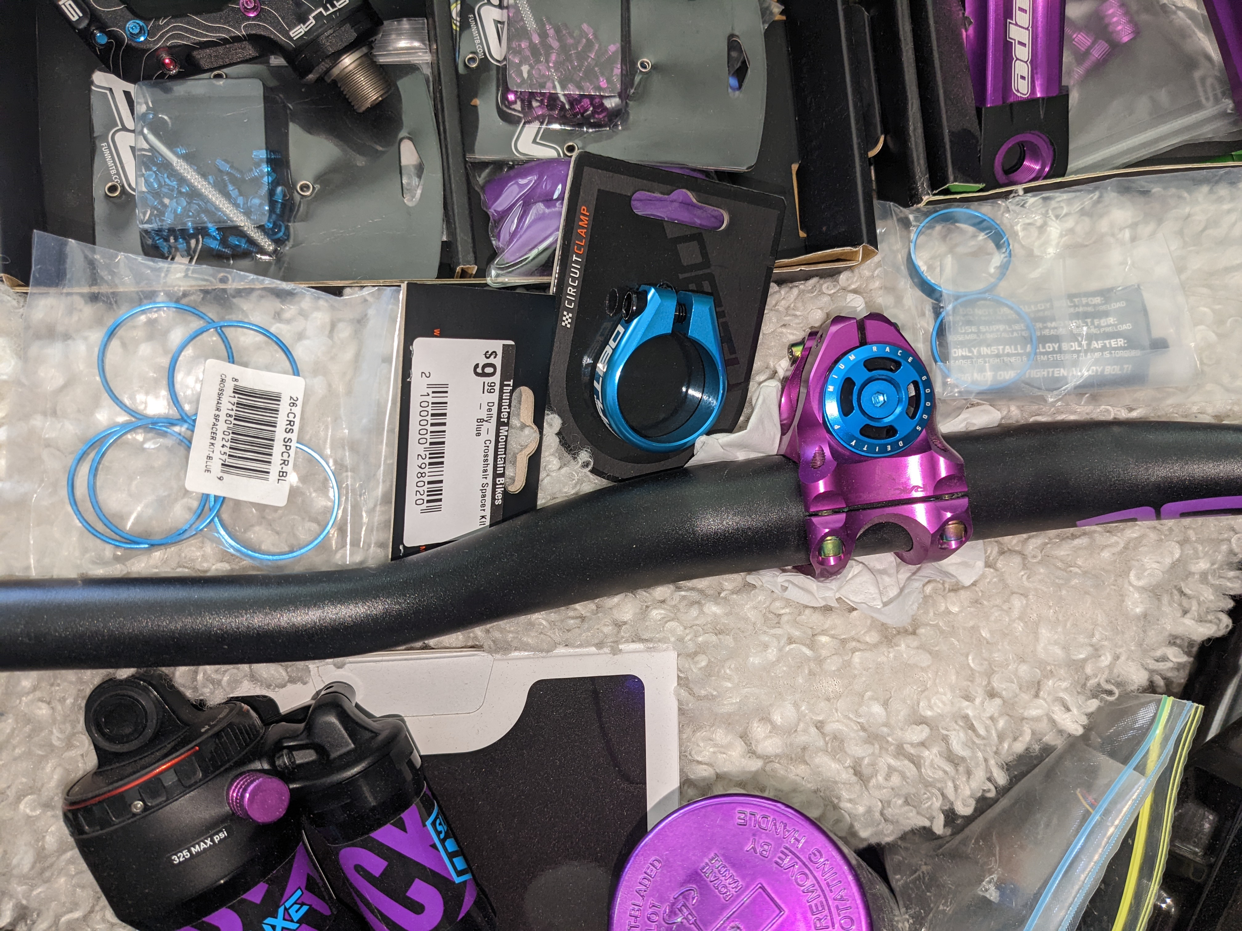

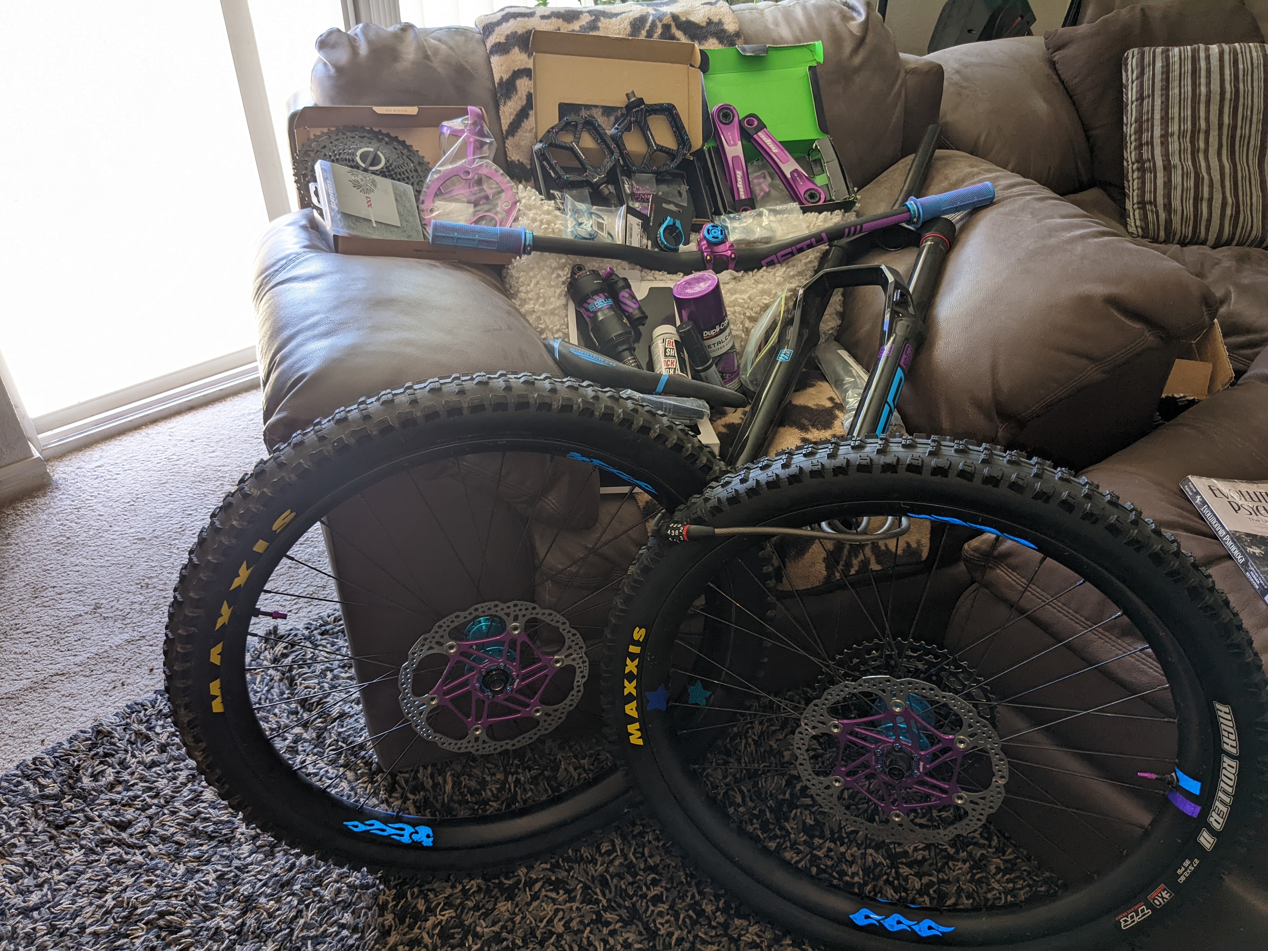

Alright...I'm ready to build up my CEF50 720Wh Enduro build! 🤙
The last few pieces of blue bike bling (all matching Deity seat collar, headset cap and spacer set) came in the other day to further bejewel the living room couch with my "shrine of mtb eye-candy".
It's been steadily collecting dust since late December '22. Finally it's almost time to mount them up for bike install... just waiting now for the frameset...and waiting...and waiting!😁

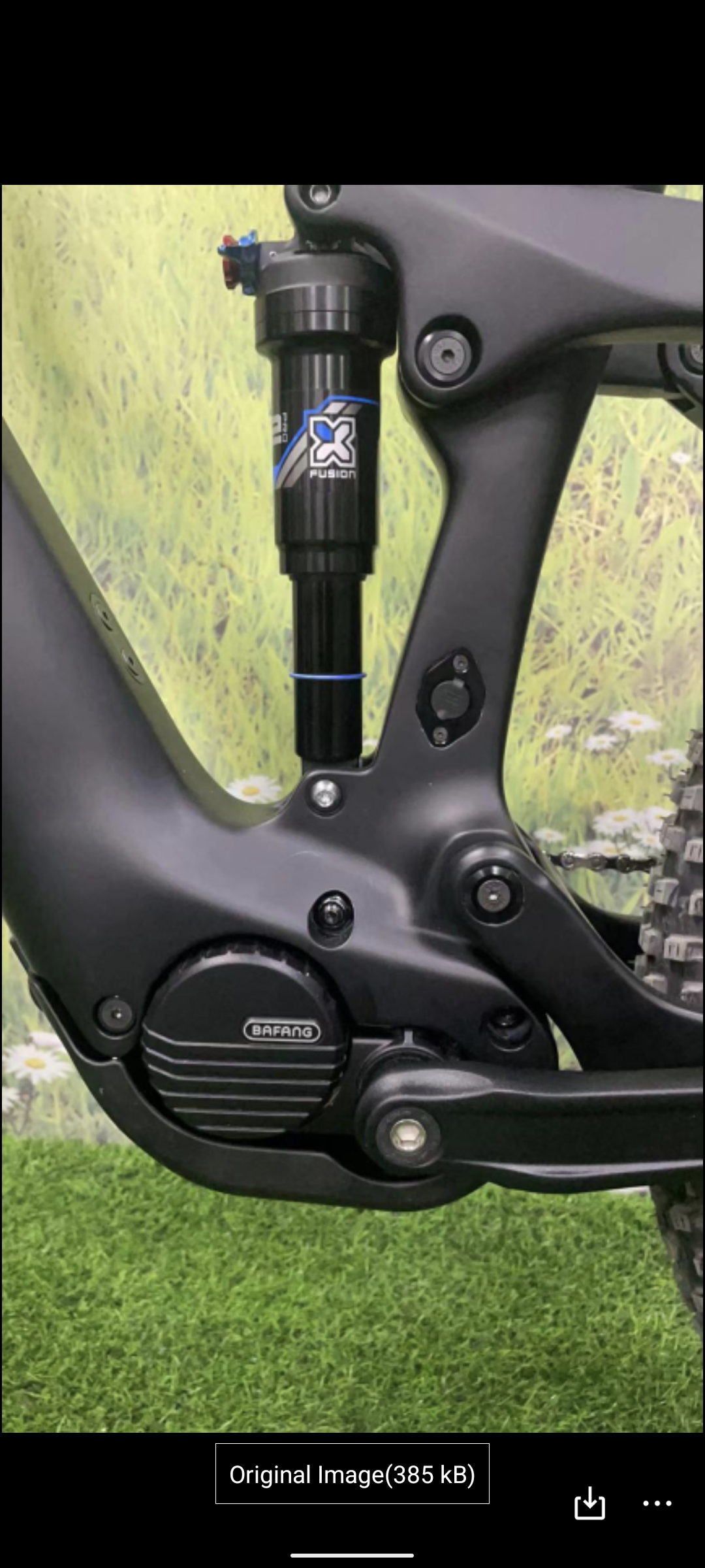

what do u think guys if I put Rockshox Pike Ultimate 29er 140mm on this frame and 27.5 rear? Me not going jumping, just adventure riding. U think with 170mm default crankset will often pedal strike?
TCFlowClyde
Feb 26, 2022
1,397
923
Mesa, AZ
My m600 at 150 mm (30% sag) had big pedal strikes at stock 170 cranks. I went down to 155 mm....much, much fewer.👍
