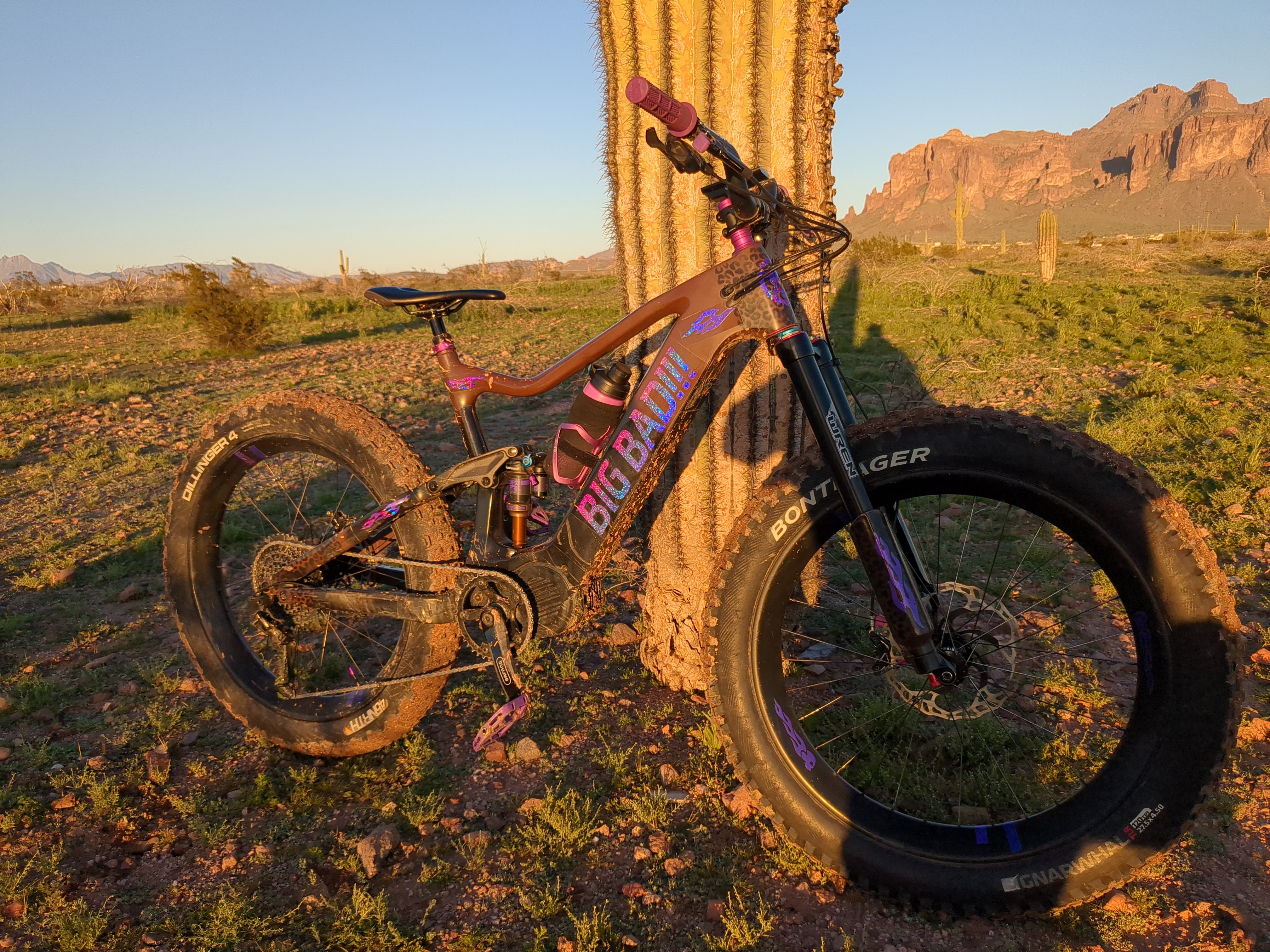

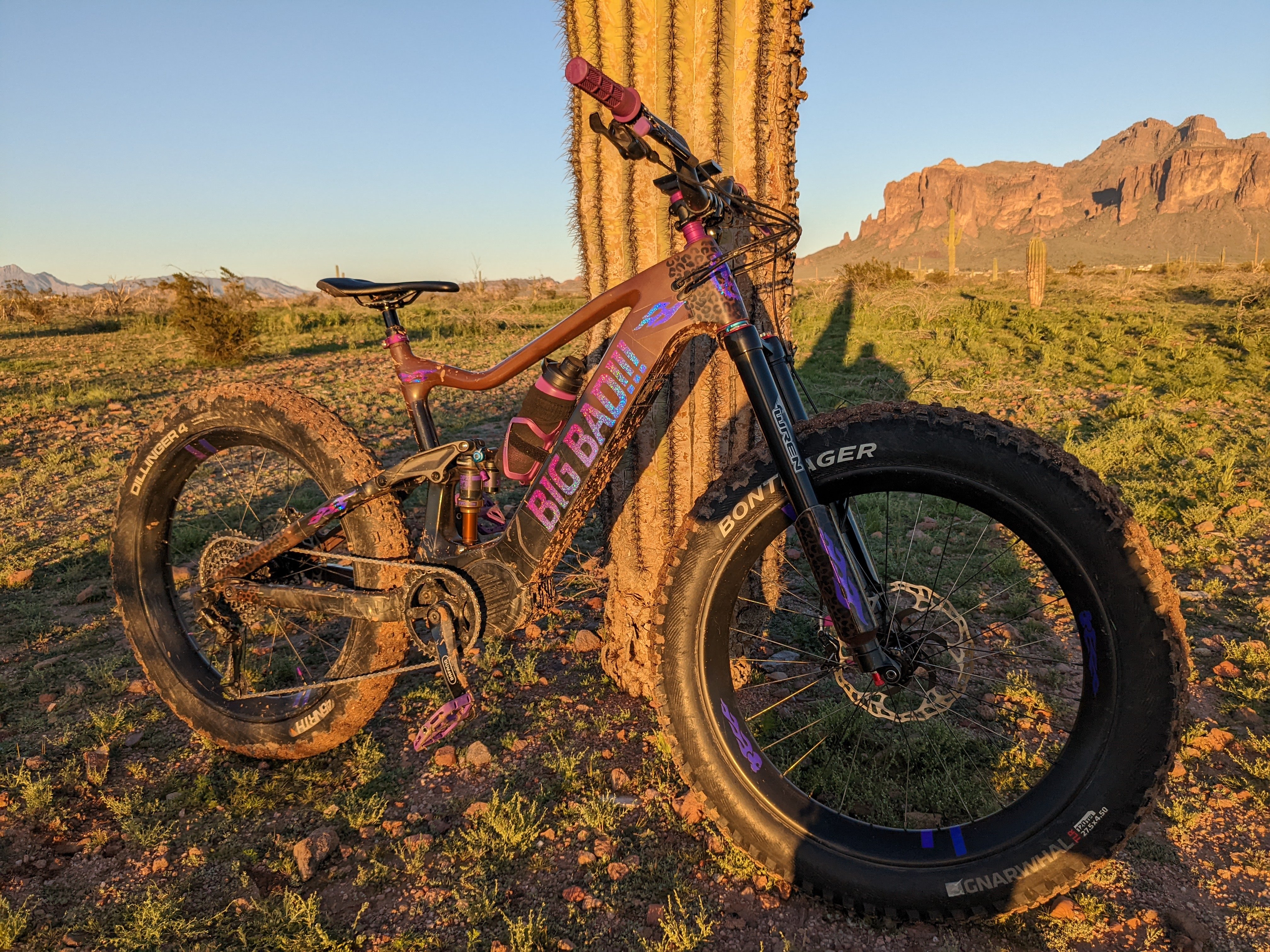

My fade paint job still holding up...$25 of paint.... But customer sticker expensive.💵💸💰
PXL_20230228_010005430.jpg PXL_20230228_010012885.jpg PXL_20230228_010030348.jpg

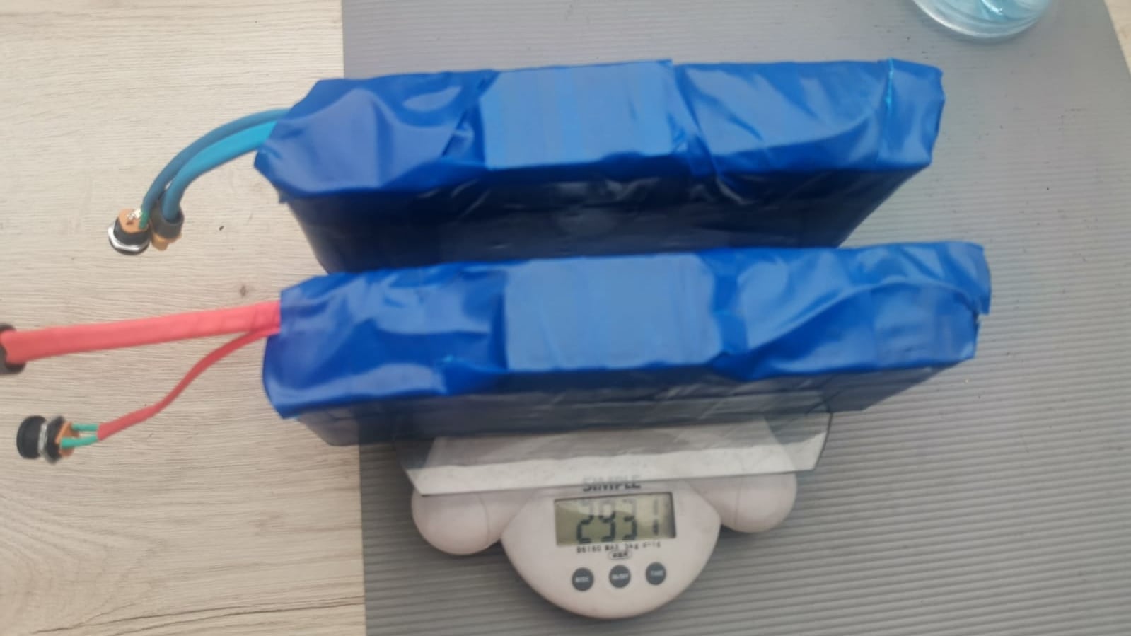

The batteries for the CEF50 are ready. The main one is at 10Ah and the range extender is at 10Ah. If the batteries pass the tests, you can make cases for them.

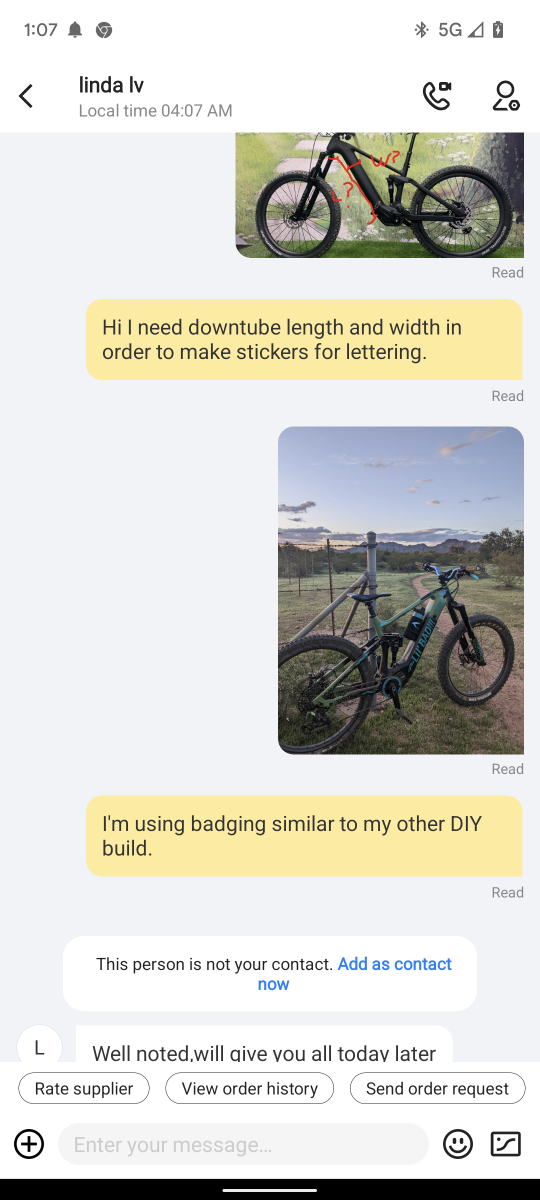

Well sure, Linda responds when in their office time zone on Alibaba messaging too...I just Google Beijing time and contact in their working hours. But here's today: see Convo below a few hours ago.
Then I'll have to ask again in another week or two due to no follow-up. These are very basic, yet critical build questions that should be known to the sales team at the outset.
Maybe you have the *touch" ? 😉 If so, can you ask about the shock bolts sizes please and post here?

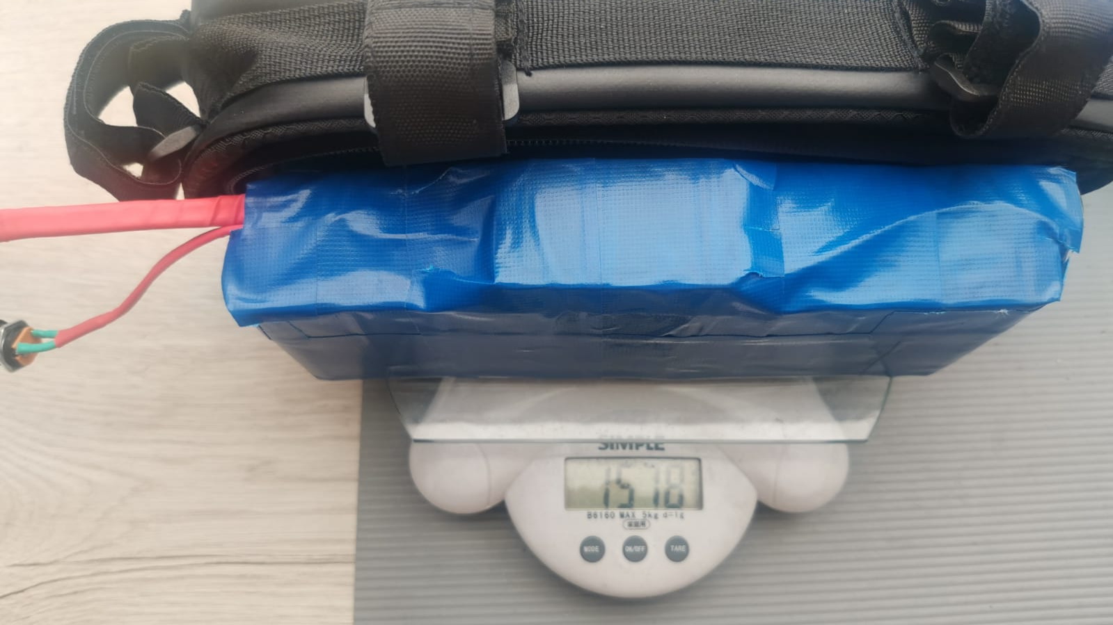

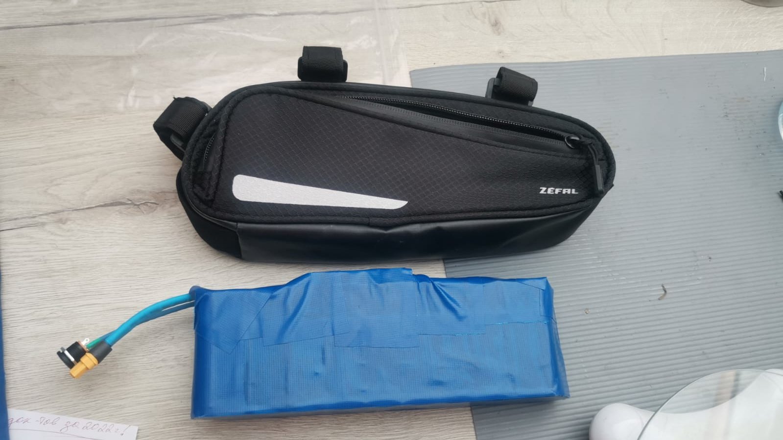

BT F050.B360.C this is also for m820 weighs under 2kg 360 wh .
You won't have enough of this battery. You hang up the range extender, it's heavy. Total + 4000g of weight you will add. How will you charge your bike if you go to a hotel for a rest?

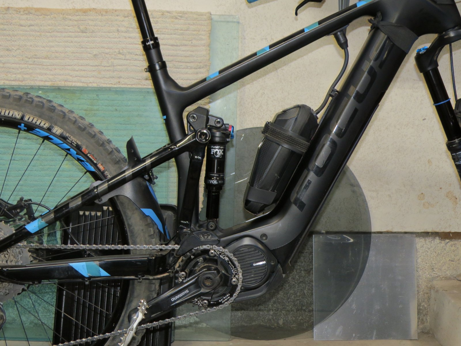

if this battery is really ok and under 2kg ,i rather pick this one, because of the nice integration.Extender will be Diy if i needed it.something like this
Waynemarlow
Dec 6, 2019
1,125
902
Bucks
Savas, do you know what extender that is, my mate has a Focus Thron and is unable to buy an extender ( we keep running his 625Wh battery out). Thanks

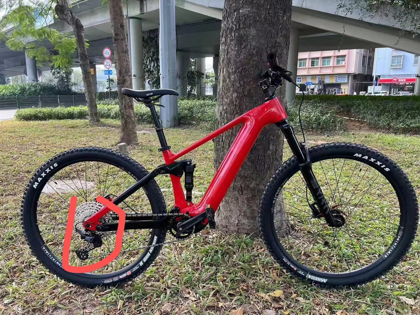

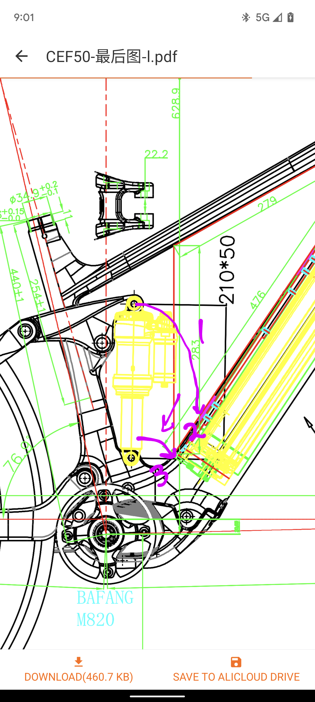

Update: On bigger air-can and/or coil shock enthusiasts here's my mock-up of the CEF50'S probable shock pathway courtesy of their engineer.
Apparently, a full CAD motion illustration was not to be had...they're producing frame orders and probably lack time. For what its worth.*
Note: poorly drawn purple lines are mine.
1. Should be the general arc of the top shock (rocker arm).
2. Travel compression direction.
3. Clearance of the damper body that should allow complete compression w/o rubbing the seattube.🤞
*If you're worried you might want to wait prior to buying a bigger air can upgrade or coil. Personally, I need to see that bad boy in action as it will be the first item to suss out for frame fitment and testing straight outta the shipping box! Then I'll post my findings forthwith.💪

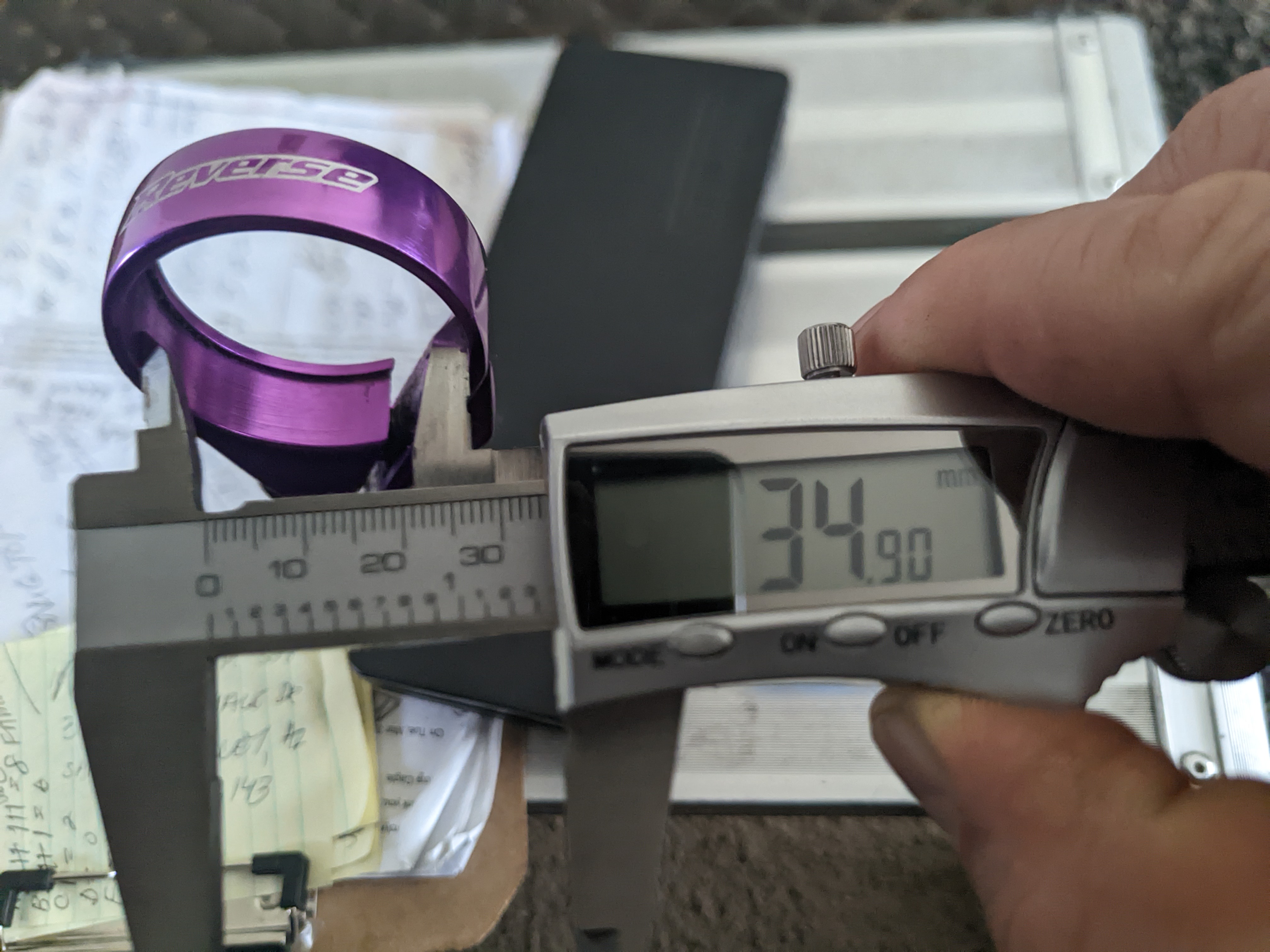

Any reason why your seat post says 34.9 when it was 31.6 in the past?
mike_kelly
Aug 11, 2022
947
782
US
The outside diameter of the seatube, the clamp, is 34.9 and the inside of the seatube or outside of the seatpost itself is 31.6.
