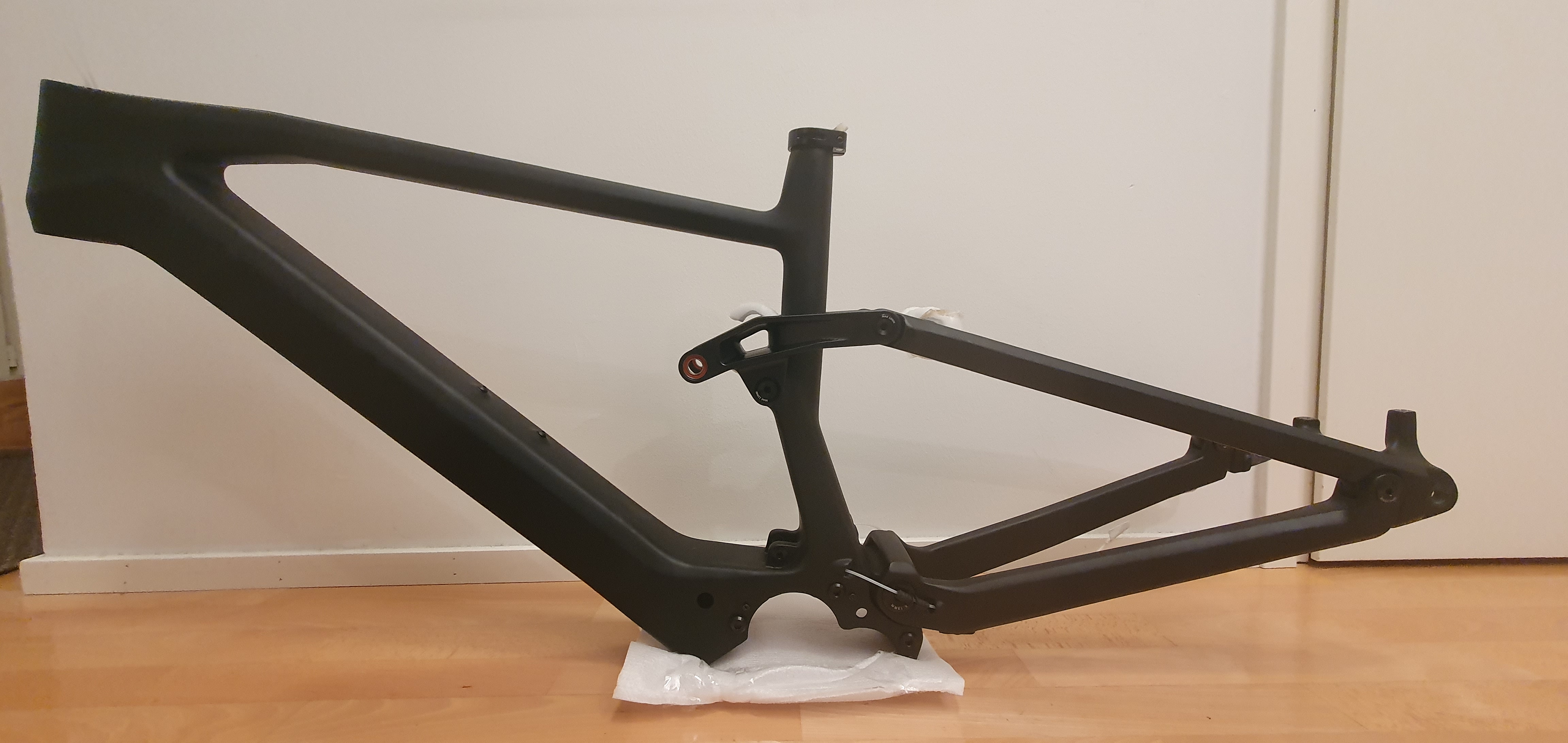

Alright. If you have seen this thread before (previously called Upcoming LCE930 build), you might have wondered what happened. Let me tell you. I will break down the story about my experiences in to a series of around 4 posts. Posts about the buying experience, the production quality, aftercare and maybe later, the build. This post will start with the quality since I received the frame earlier this week and it was not what I expected. And to be clear, I did share my concerns with LightCarbon before coming to the forums. They simply did not share the same understanding.
Part 1: The production quality
General impressions
Externally the frame appears to be quite nice as you can see from the picture. The frame looks like in the promotional pictures and the finish is a matte black. Paint quality is mainly good. There is a very minor imperfection on the paint in one of the cable ports (more about it below) and there is a slight roughness in the inside curve where the top tube meets the down tube. Both of these are things I can live with.
The defects
When I inspected the frame in more detail, I started seeing more and more small defects. Alone any one of the defects could be something I could live with, but together they give the impression that absolutely no quality control has been performed. They also raise the question how many defects there hidden are inside of the frame, which I cannot detect without an x-ray or ultrasound. Let's go through the list. I'm linking to google pictures to keep the thread more readable without all the embedded pictures. Here's the whole album if you want to browse it https://photos.app.goo.gl/TQqWa4vzQqpH2bNv9.

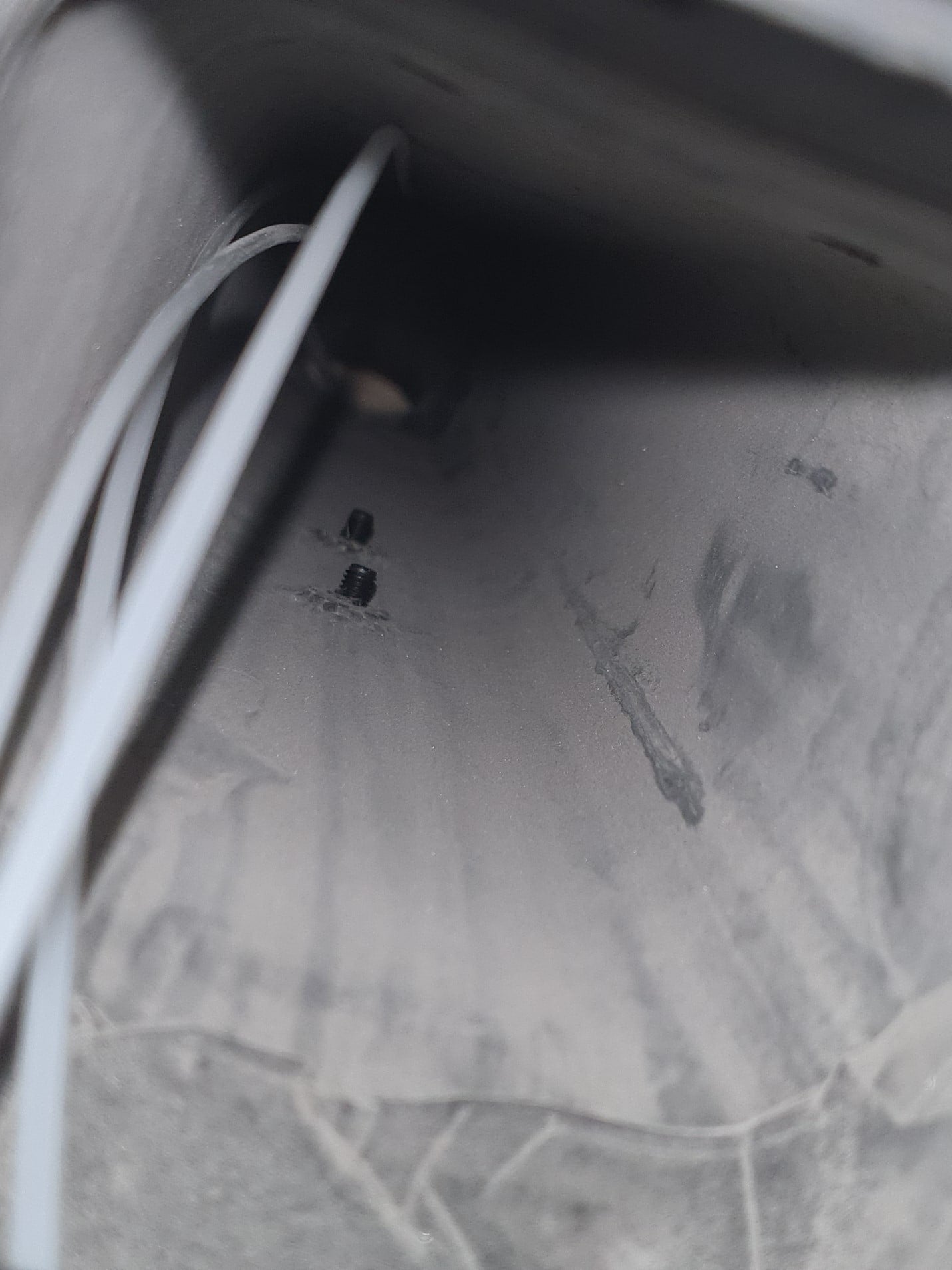

2. Downtube
  • Internal Carbon Dust: Significant carbon dust inside the frame suggests poor quality control and no cleaning during manufacturing. There is no way of inspecting the frame properly if you don't clean it. (File: Downtube dust)

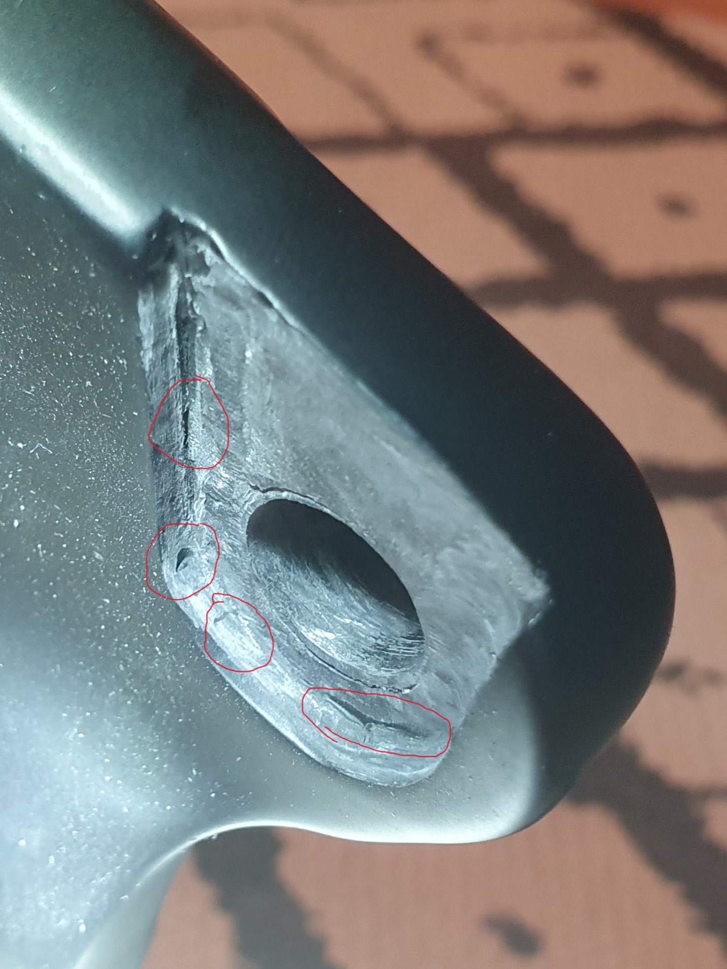

3. Headset Area
  • Lower Headset Cup: Void near a high-stress area adjacent to the lower cup (File: Headset Lower from above).
  • Lower Headset Cup: Some red paint marker, indicating maybe QC fail. Some machining probably done, but it has not fixed the fitment issues. (Files: Headset lower)
  • Lower Headset Cup: Video of bearing knocking back and forth in the cup (File: Bearing knock video)
  • Upper Headset Cup: Uneven carbon, indicating poor quality control and finishing. Some finishing might have been done indicated by the marks, but cups are still larger than need be (Files: Headset upper 1, Headse upper 2).
  • Upper Headset Cup: Video of bearing knocking back and forth in the cup (Files: Headset upper, knocking video)

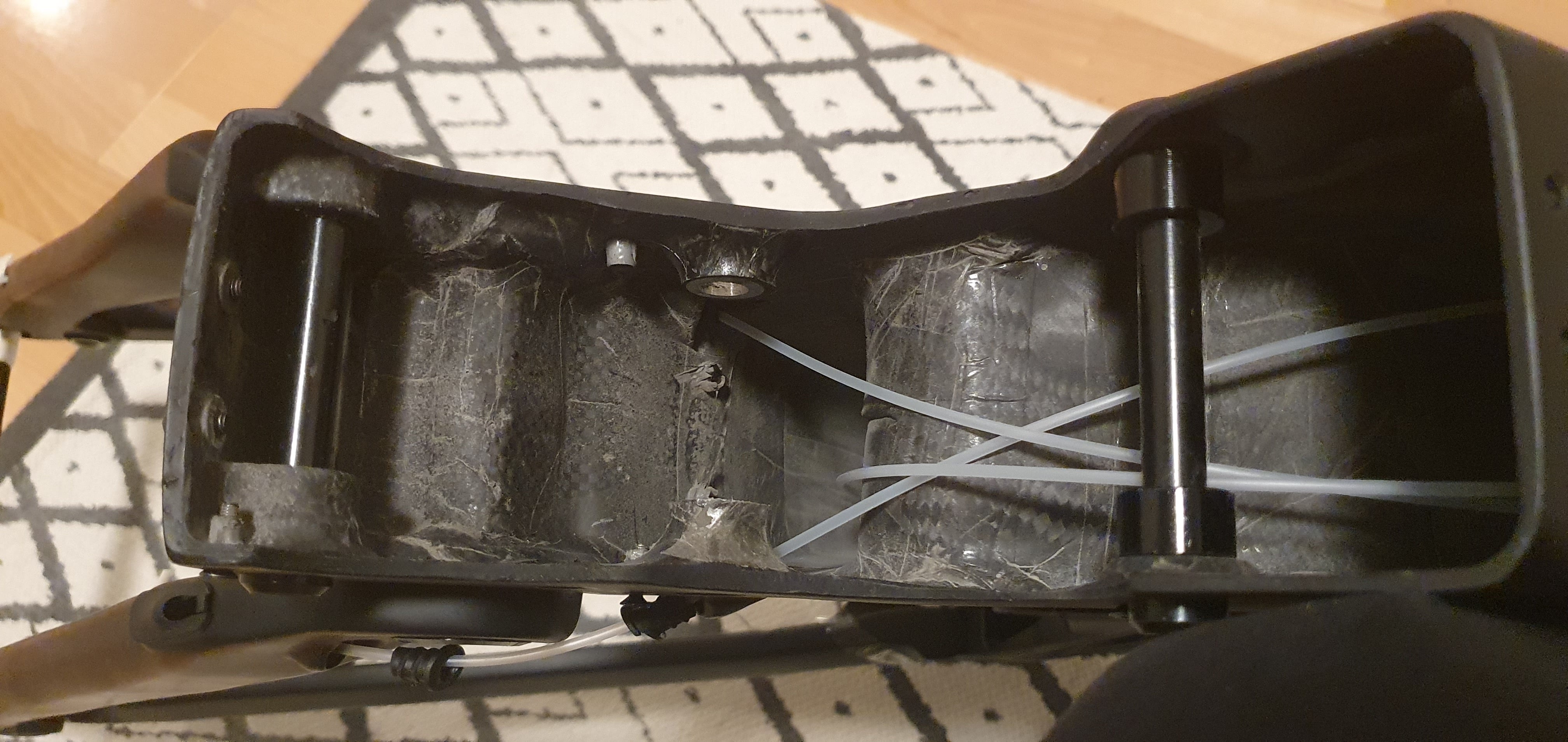

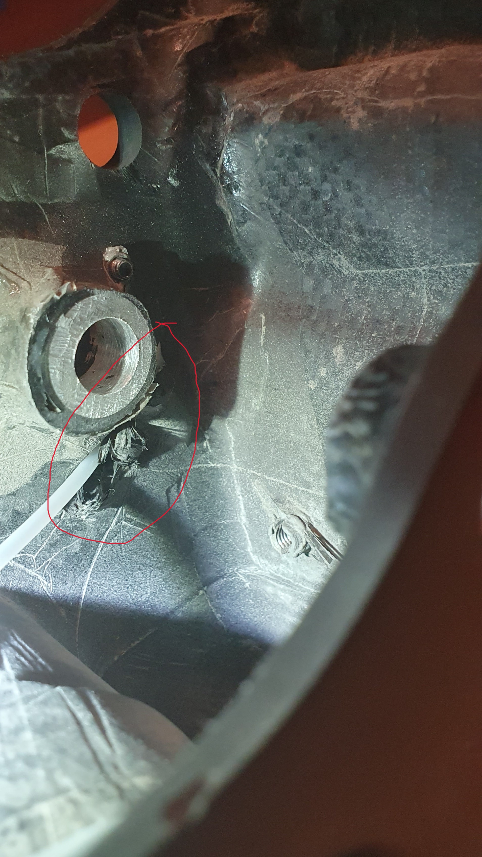

4. Motor Mount/"Bottom Bracket" Area
  • Overview of the motor mount area, showing unevenness, and lack of qc. They didn't even clean the dirt off to see what is underneath. You can see that the carbon sidewalls are uneven, but thick.
  • Drive & Non-Drive Motor Mount Holes: Voids present in carbon at both sides, potentially compromising bolt integrity. Also the metal inserts are not in the center of the supports, weakening the adhesion. (Files: Hole 1, Hole 2, Hole 3)
  • Cable Routing Ports: Delamination and poor adhesion of carbon fibers on both sides of the frame (File: Driveside, Drive side angle 2, non-drive side).
  • Dirt Flap Rivets: Evidence of poor adhesion and misaligned carbon fibers, indicative of weak structural bonding (Picture from inside frame).
  • Seattube Curve: Dent/unevenness in carbon near the curve, raising concerns about structural integrity (File: Motormount seattube curve).
  • Sidewalls: Voids visible in both drive and non-drive sidewalls (File: Sidewall DS, Sidewall NDS).
  • Bolt Condition: A motor bolt appears worn and used, which is unacceptable for a new frame. But still, one of the lesser issues all in all. (File: Motor bolt).
