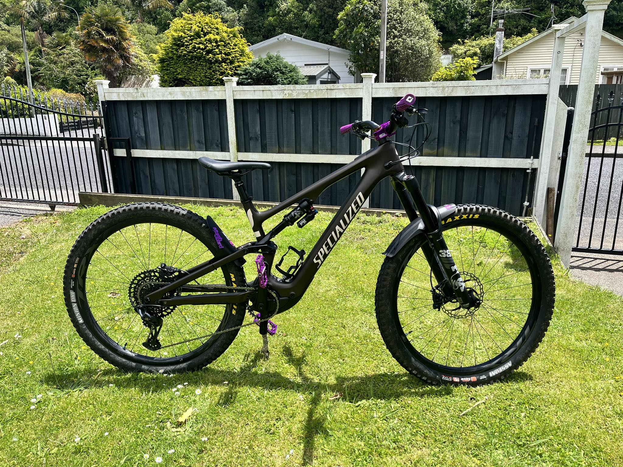

Picked up my SL2, after tossing and turning on if I get a Kenevo SL2 or this. Seat dropper height was the main kicker. SL2 can go lower, and lowest position is perfect for me.
Went Carbon Comp, as I wanted to do suspension upgrades and it's a good bones of a bike (still carbon frame/swing arm), also don't care about fancy drive trains on an e-bike. It chews threw everything faster, so saves my wallet some pain.
For $50NZD, I got the compression dial to upgrade the shock to the expert version, bonus.

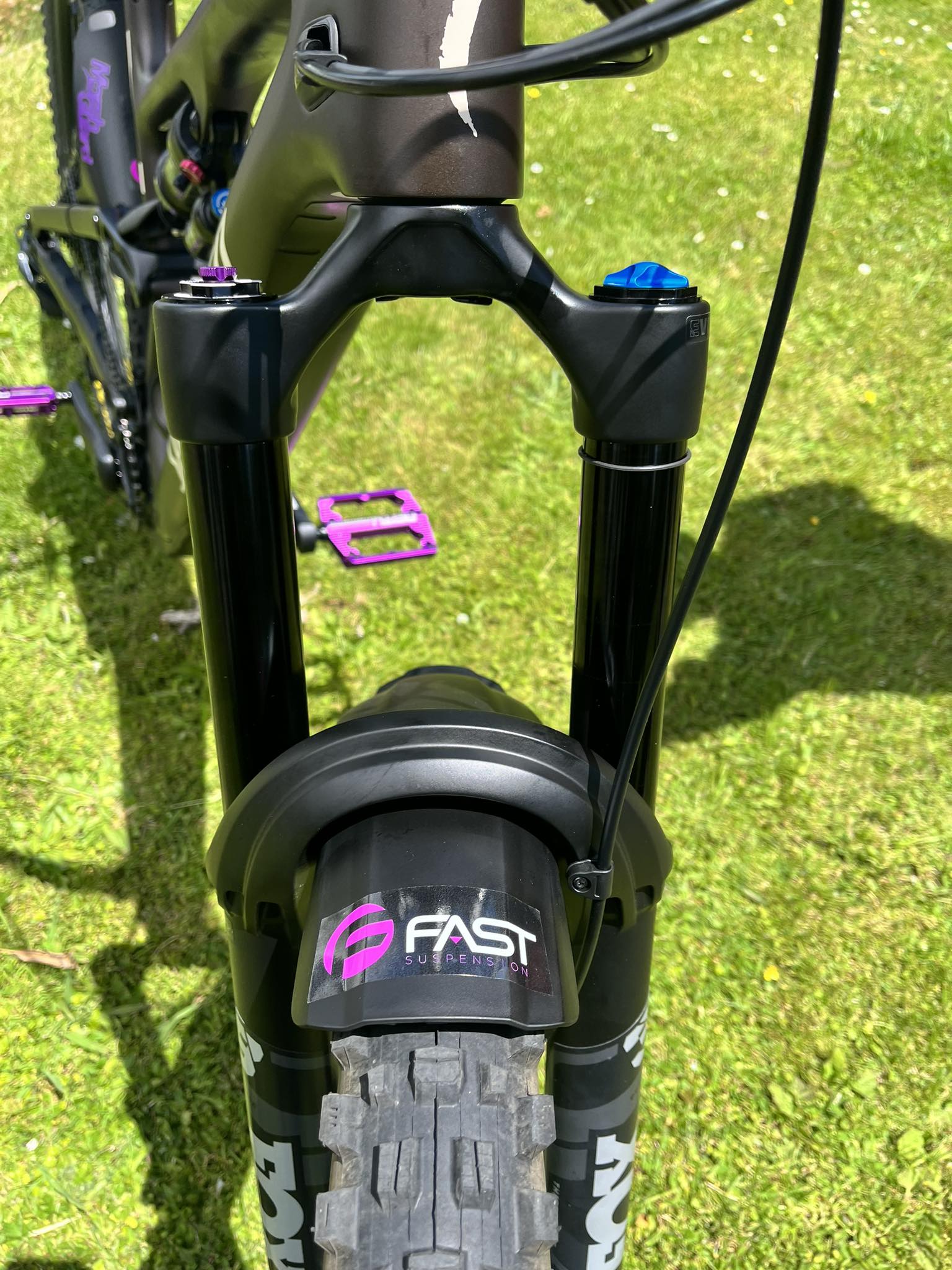

Trying out the Fast Suspension damper in 38's, if I'm happy I'll then commit to their shock also.
Put on my carbon wheels from enduro bike, only weighs 1.2kg more than my Specialzied Enduro Carbon 2019, I'm so happy.
Had a motor error flash up, but then remembered to move magnets across from rear wheel, phew.
Ended up going 29 all around, and it feels so good so far just riding around home and over our jumps/obstacles we have here. First ride this Wednesday.

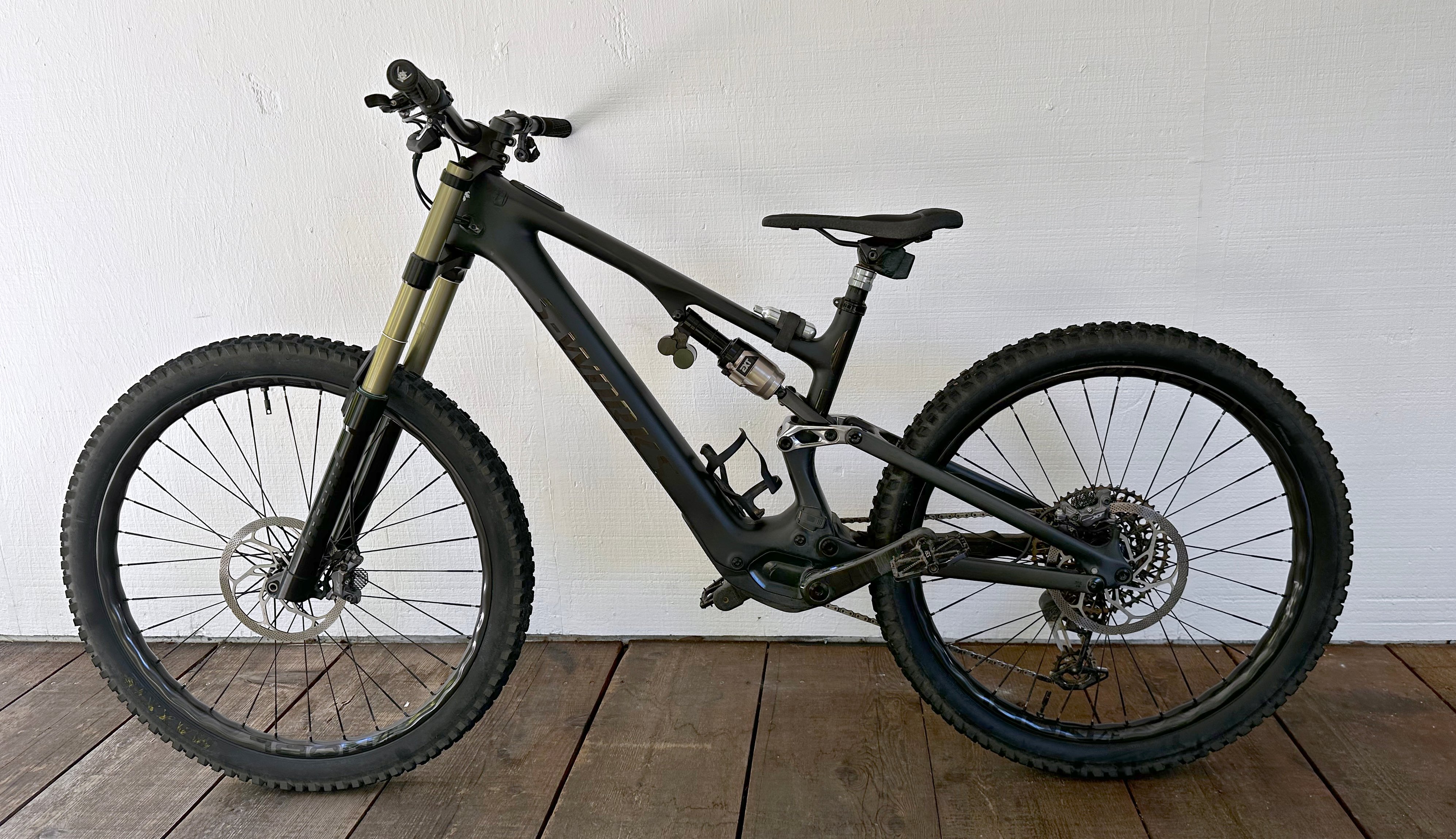

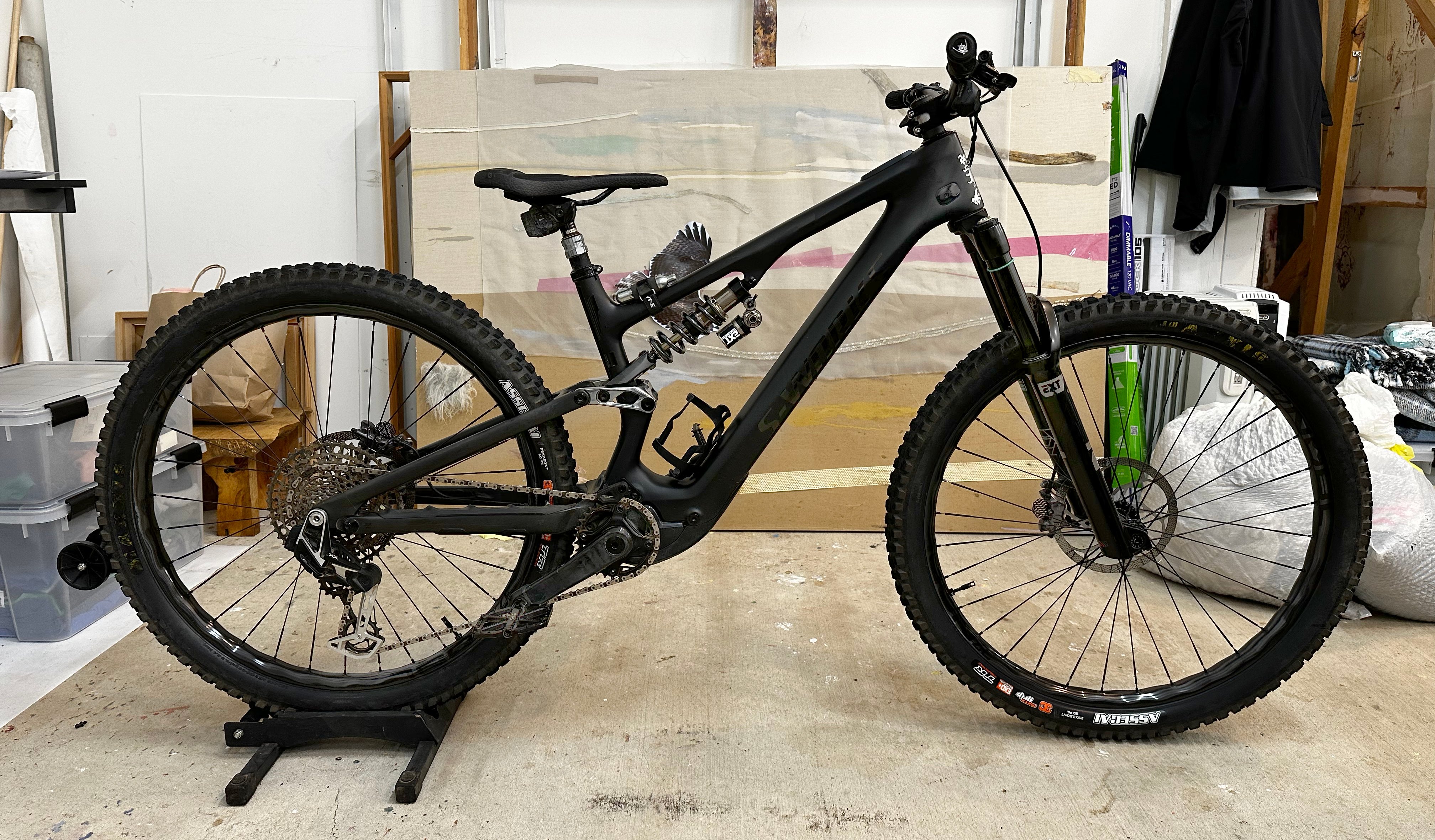

At the moment, I'm running Aria shock, flip chip in low, headset at 0, and a 170 EXT ERA....best set up of 6(not counting rear shock changes) that I've tried so far. (Stock, 29/29, 29/29 with 170 EXT Era, 27.5/29 slack headset with EXTEra 160 & 27.5/29 slack head,flip in high with Intend Bandit)
The Era 170 is only 11mm longer than a fox 160....so you geometry nerds can tell me what that all works out to mathematically but it works amazingly...on most things.....like 97%.
A fantastic one bike solution.
Running 29/29 is smoother on most accounts but makes it feel very similar to a sized down KSL...especially with a 170 in front.
View attachment 130340 View attachment 130341
That's a bad ass looking bike. I used to just stare at mine sometimes while I was on my computer and it was parked across the room. Mine was black too. I do not like the new colors coming out now, though - yellow and orange, etc. I'm in Japan, and the colors are pretty bad.
The top set up is wild!

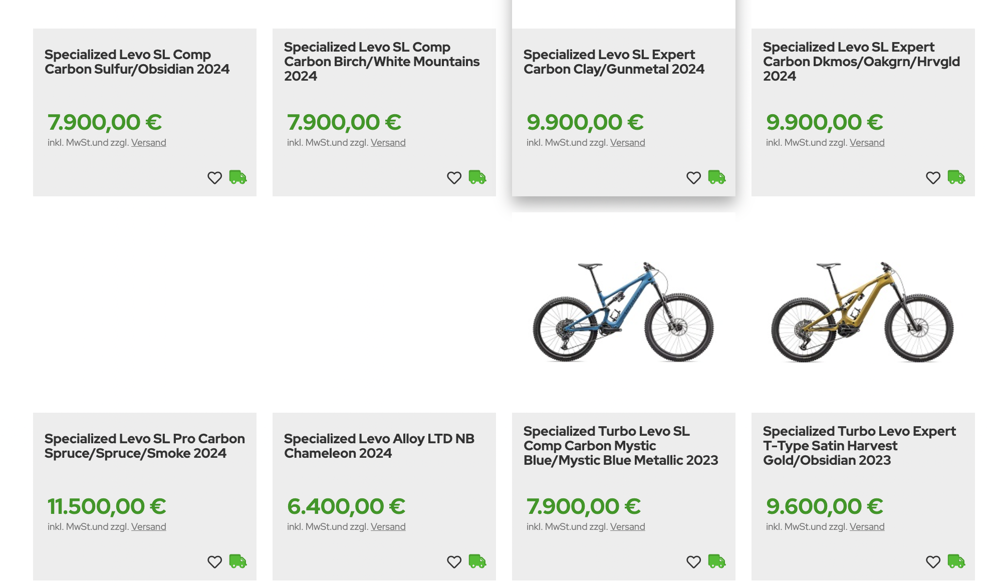

Who's taking bets on new colors for 2024? I've been waiting for an "In Stock" notification on an Expert Gloss Smoke S4 for two months now. I'm assuming some other colors are on the way causing the delay. My next choice is the Satin Mystic Blue from the Comp Carbon but I really want GX AXS Transmission.
Losiak
May 26, 2022
38
42
Szczecin
I am waiting for new frame set colors.
Randeken
May 9, 2023
Karlsruhe, Germany
here is what i found on german site bunnyhop.de some days ago..
