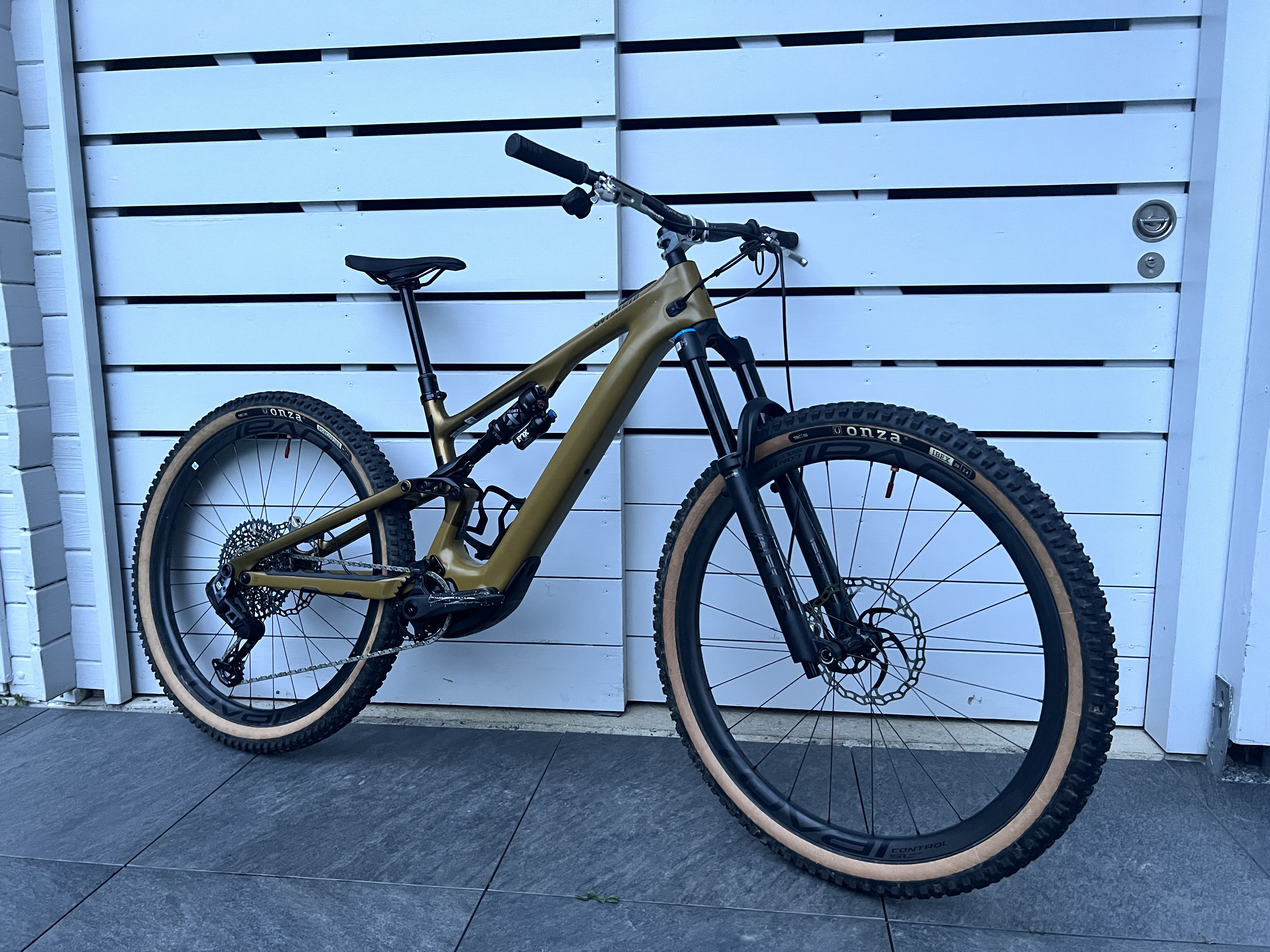

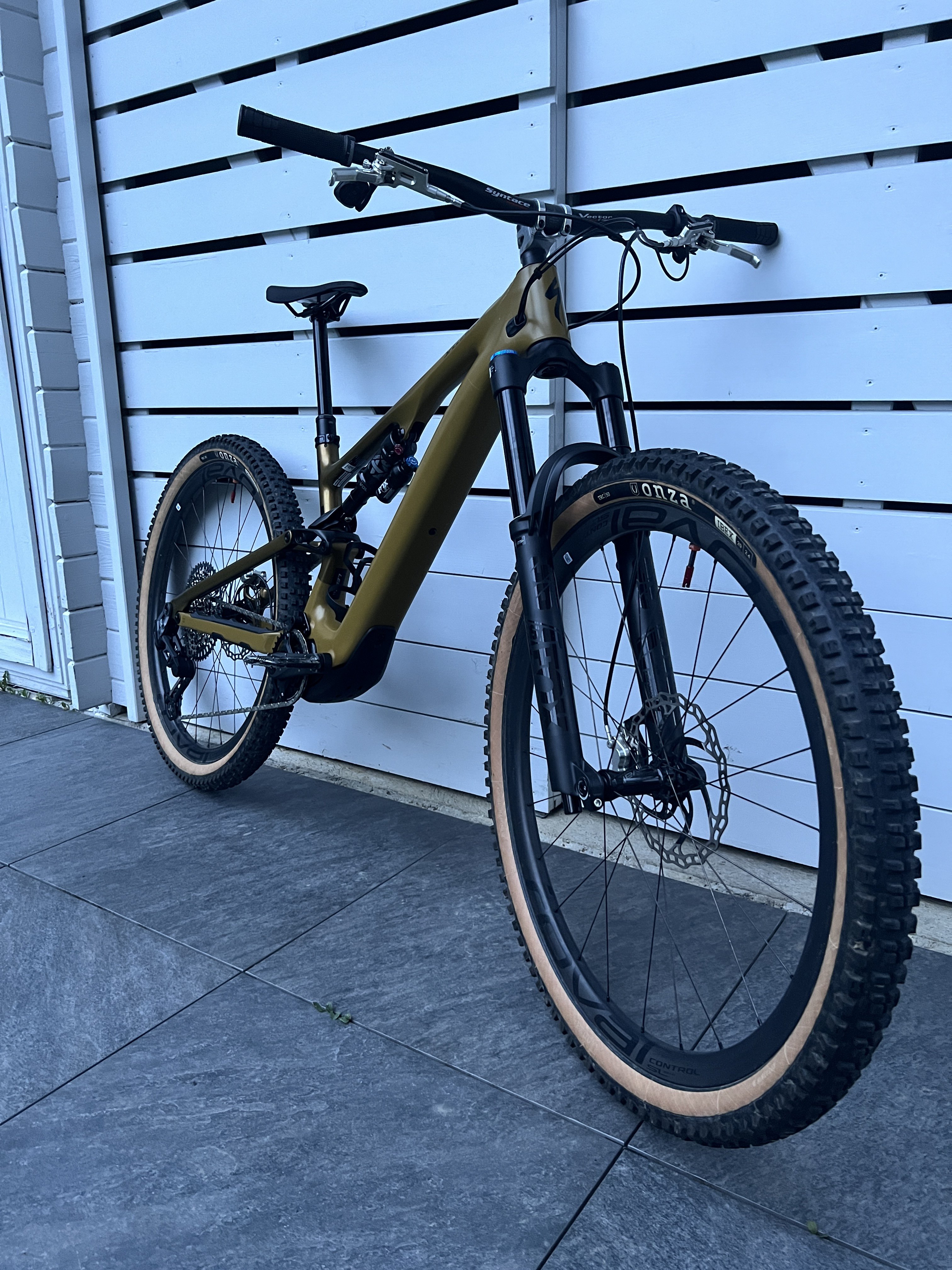

After spending the first 2 months with a 29 rear wheel, I have swapped over to a 27.5 out back, I guess as the makers intended it. I think I like the mullet set up more. Most of my riding is twisty undulating single track, and it now seems to tuck into the corners better and be more fun. I guess I have lost some 'free' speed with the smaller wheel, but it feels that I can ride the bike faster through the turns.
Was wondering whether this improvement is just my imagination - I need to give 29' another try just to check - or whether the general consensus is that mullet is best.
I thoroughly tried full 29 and mullet on the GEN3 and I felt exactly the same as you.
On the SL2 I am delighted with the mullet wheel in HIGH + LONG, I don't even feel like trying the 29 behind

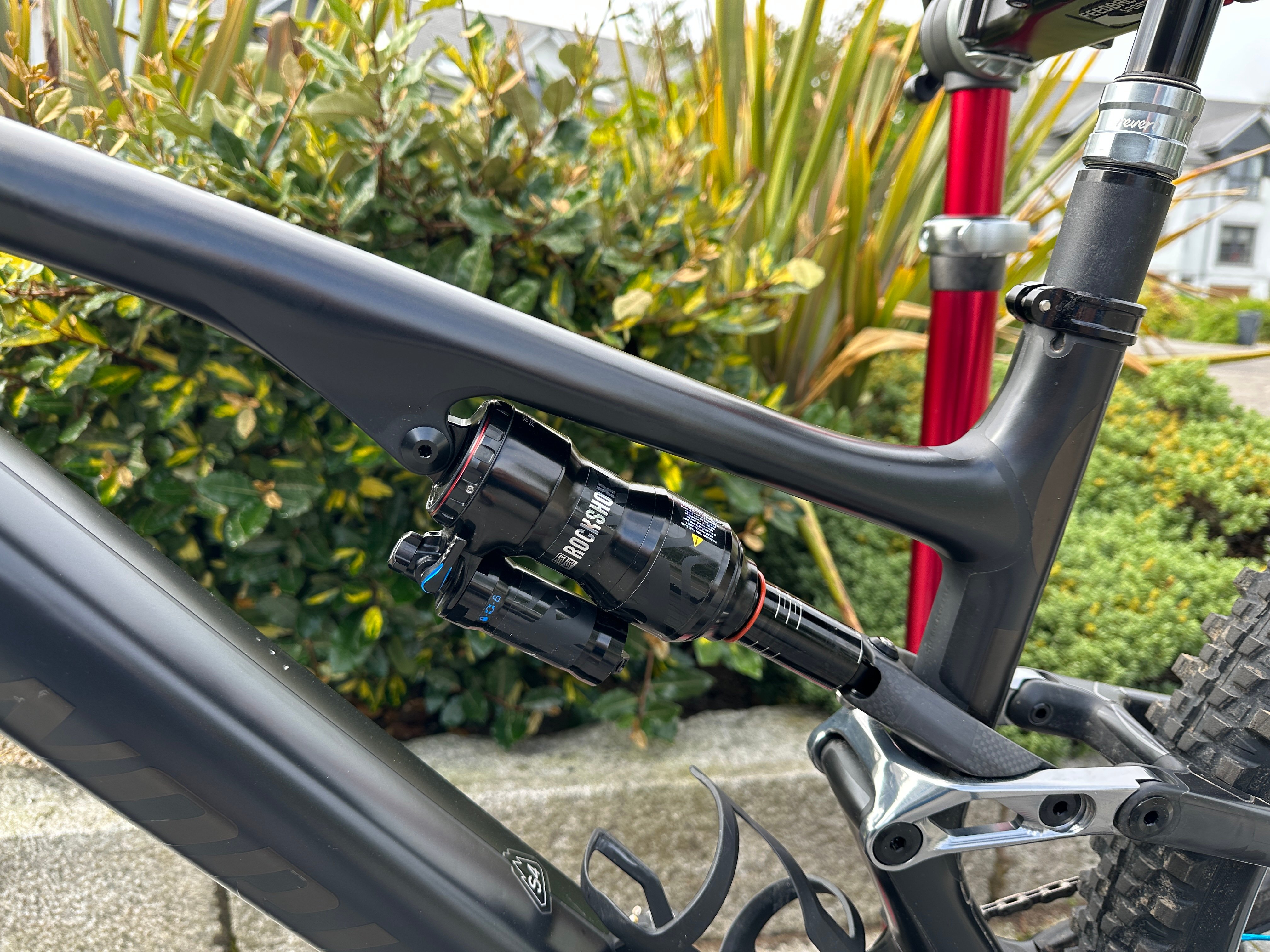

Not sure about the coil, but the air version works great. I’ve got an S4 frame and it clears the Range Extender. Not sure it’d clear on an S3 though, as there’s not a lot of space.

I have the S3 and the coil doesn’t rub or hit the range extender. I am more asking if the rockshox coil could potentially damage the frame or yolk. I can’t find anything about it.
Thanks!
Rich-H
Apr 3, 2023
151
110
Hampshire
Thanks!
Rockshox sell a version of the Super Deluxe Coil (C1) specifically tuned for the Levo SL.
00.4118.359.048
RS Super Deluxe Coil Ultimate RC2T - 210X55,Prog Reb/L1Comp,320lb Lock,Hydraulic BottomOut,NoBushing, Standard,90Deg (8x20)(Spring Sold Separate)B1 Specialized Levo SL 2022
Older versions of the shock (Pre-MY23 Super Deluxe Coil (A1-A2)) are not compatible with yoke/strut on the bike but all 2023 (C1) and newer versions are.
00.4118.359.048
Thank you very much!

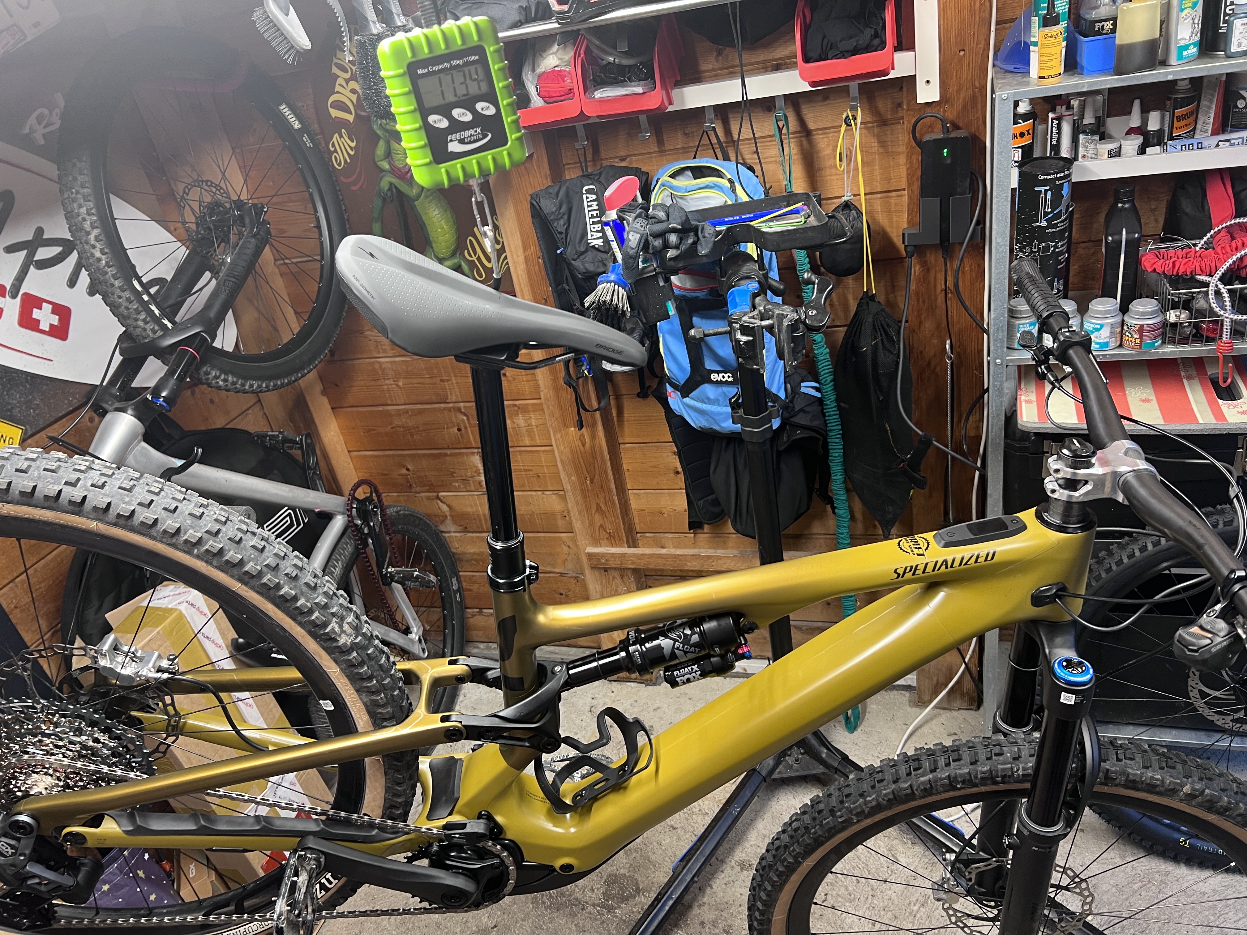

I am struggling to get anywhere near full travel on the rear using the Float X shock, pressurized to 30% sag (16mm). The most travel I got on the shock so far is 43mm out of 55mm - 78% or about 120mm wheel travel, which is a bit frustrating. I weigh 160lb with shock pressure at 190psi and 6 clicks of rebound, and 0 clicks of compression. Volume spacer has been removed. The shock has been set up with Shockwiz and gets OK on pressure and rebound, and requires less compression damping, which I am stuck with. Note shock has been relubed, and it can physically achieve the full 55mm with air pressure removed.
The bike fees OK over the small bumps, and ramps up over the large hits - but only to 78%. My riding is not extreme - mainly undulating woodland XC trails. I think my aging body would be struggling to deal with really big hits that it seems I need to do to get near full travel.
Seems to me I need a shock with a larger air can volume - not sure which. Reducing pressure might solve the travel problem, but will increase the sag above 30% which IME isn't great, leading to a low BB, pedal clipping and wallowing.
I recall reading that the Gen 1 suffered from blowing through travel and bottoming out. I wonder whether the Gen 2 link geometry has over compensated?
I was wondering whether anybody else has similar experiences?

That sounds fine to me. If you are riding gently then not using all the travel is rather to be expected surely? If you still have plenty of travel left then surely your "aging body" will be somewhat cushioned if you want to try pushing on a little harder?
How is the fork? Are you using all the travel there?
May 23, 2023
Kent
I wouldn't call my riding gentle! I more fast and flowing. :) It would just be nice to get somewhere near the advertised max travel without my contact points being in pain. I suspect that my body weight and riding style is on the lighter end of the design spectrum, and removing small 0.2in spacer specced within the shock does not leave much room for tweaking the spring curve. I have had similar, but not as bad, experiences on other bikes, and have normally fixed it with a larger air can - not an option with the Float X.
