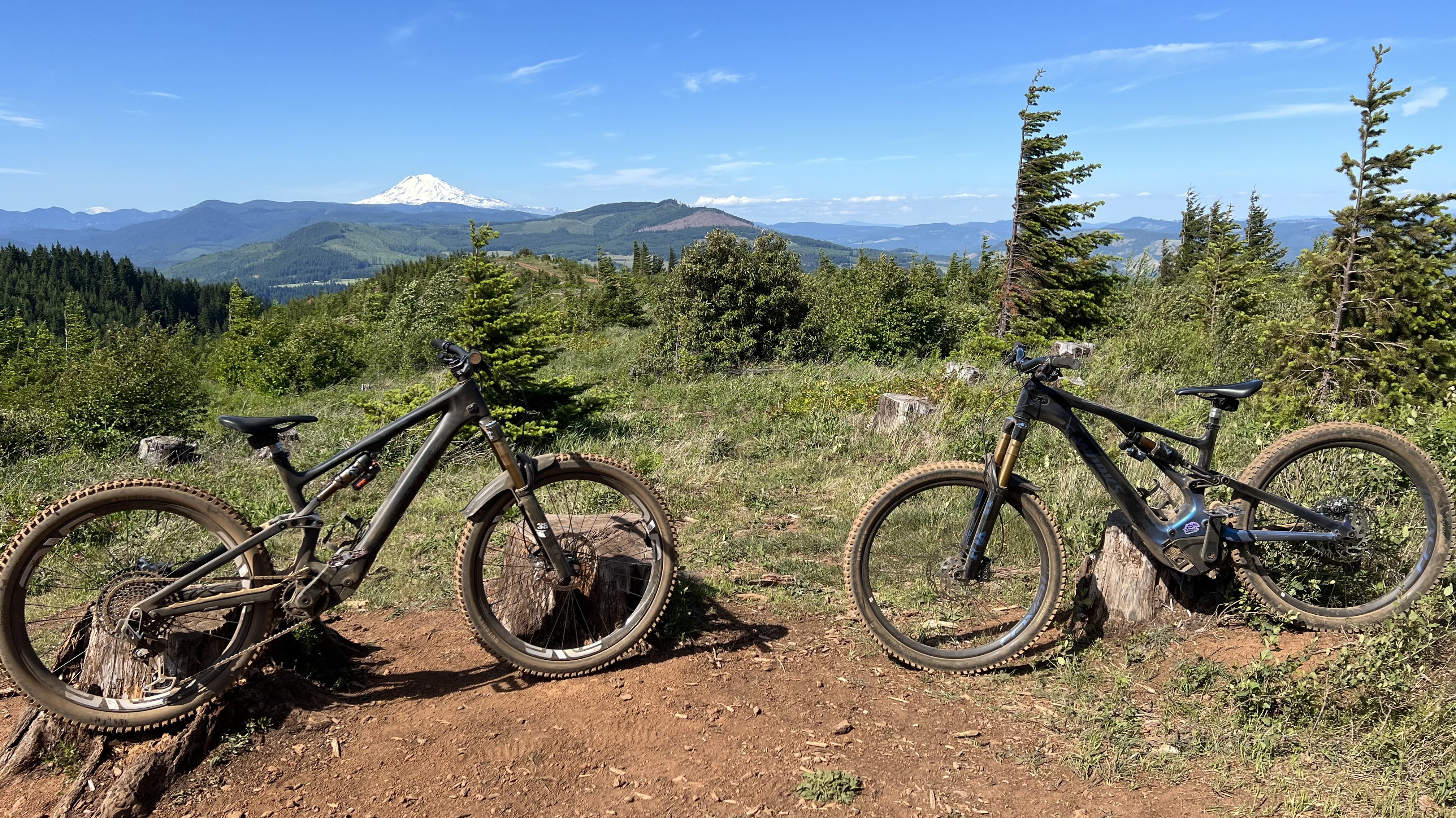

Nice bike stable there. Looks like you have some good terrain to run the E-bikes!!
Thanks. I’m touring Oregon trails for the next few days and they have great trails here. Back home in Cali we have nice trails also but nothing like what’s out here. The further north along the pacific west the better the dirt. Can’t wait to bring this bike to British Columbia

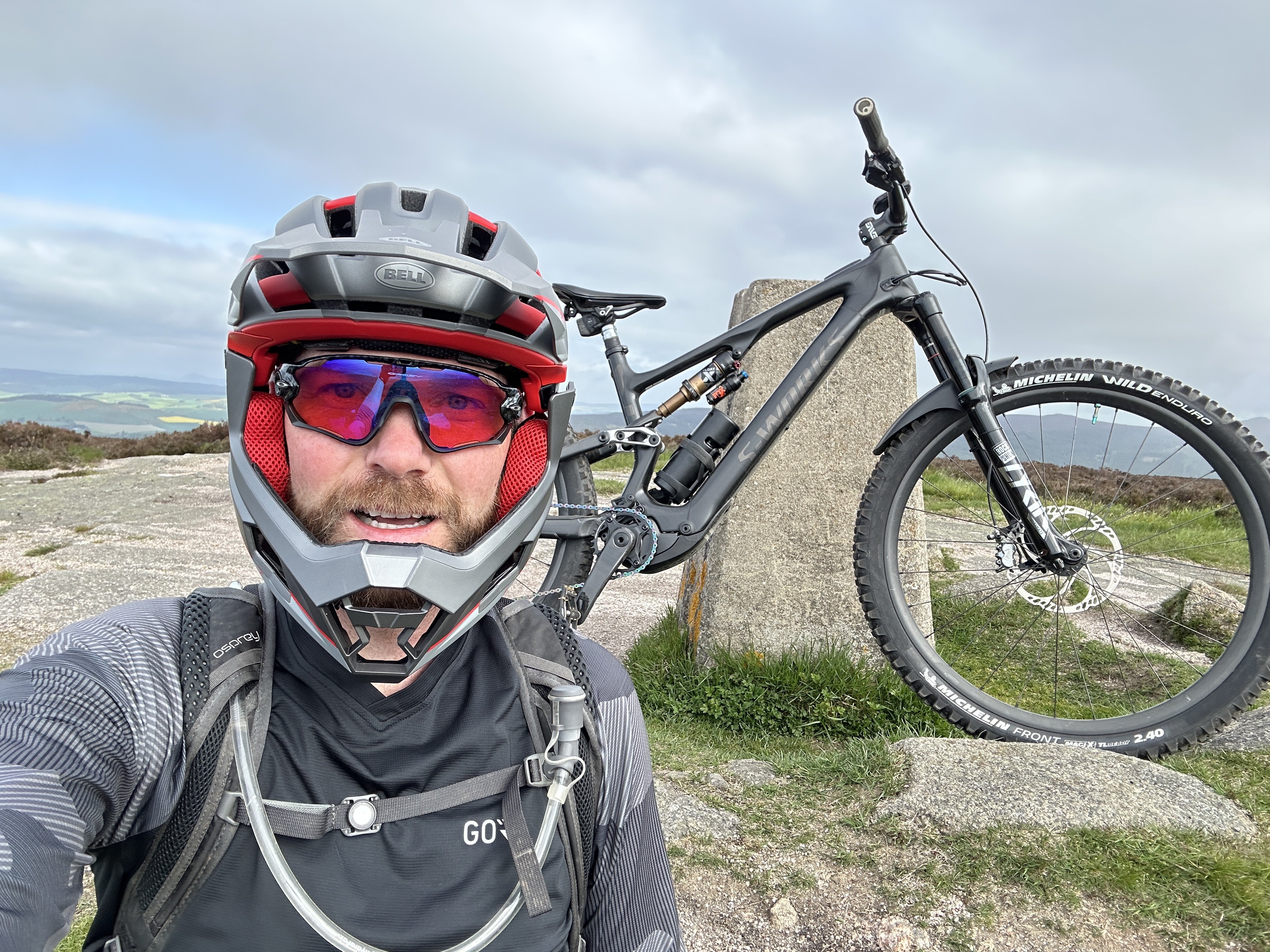

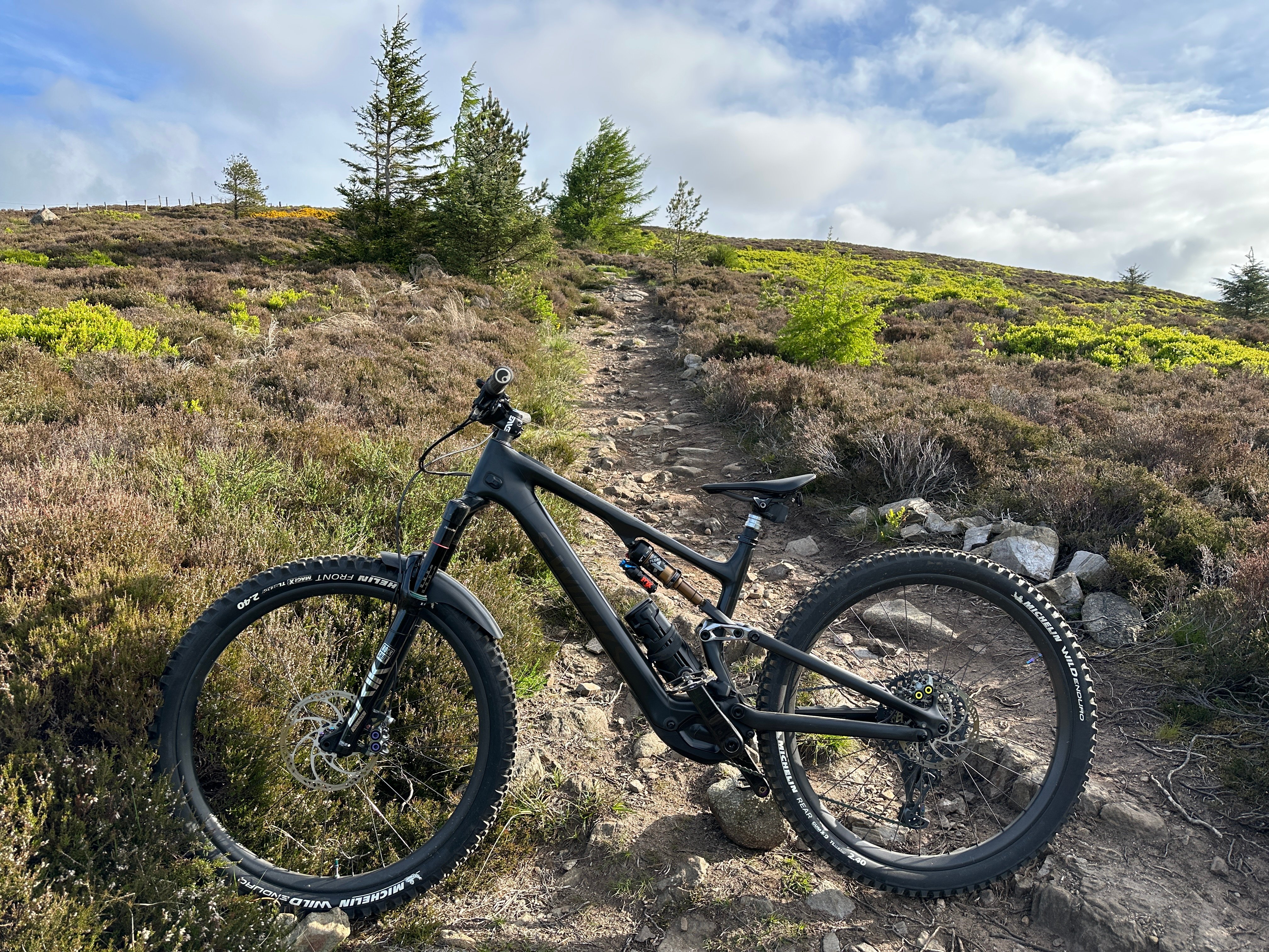

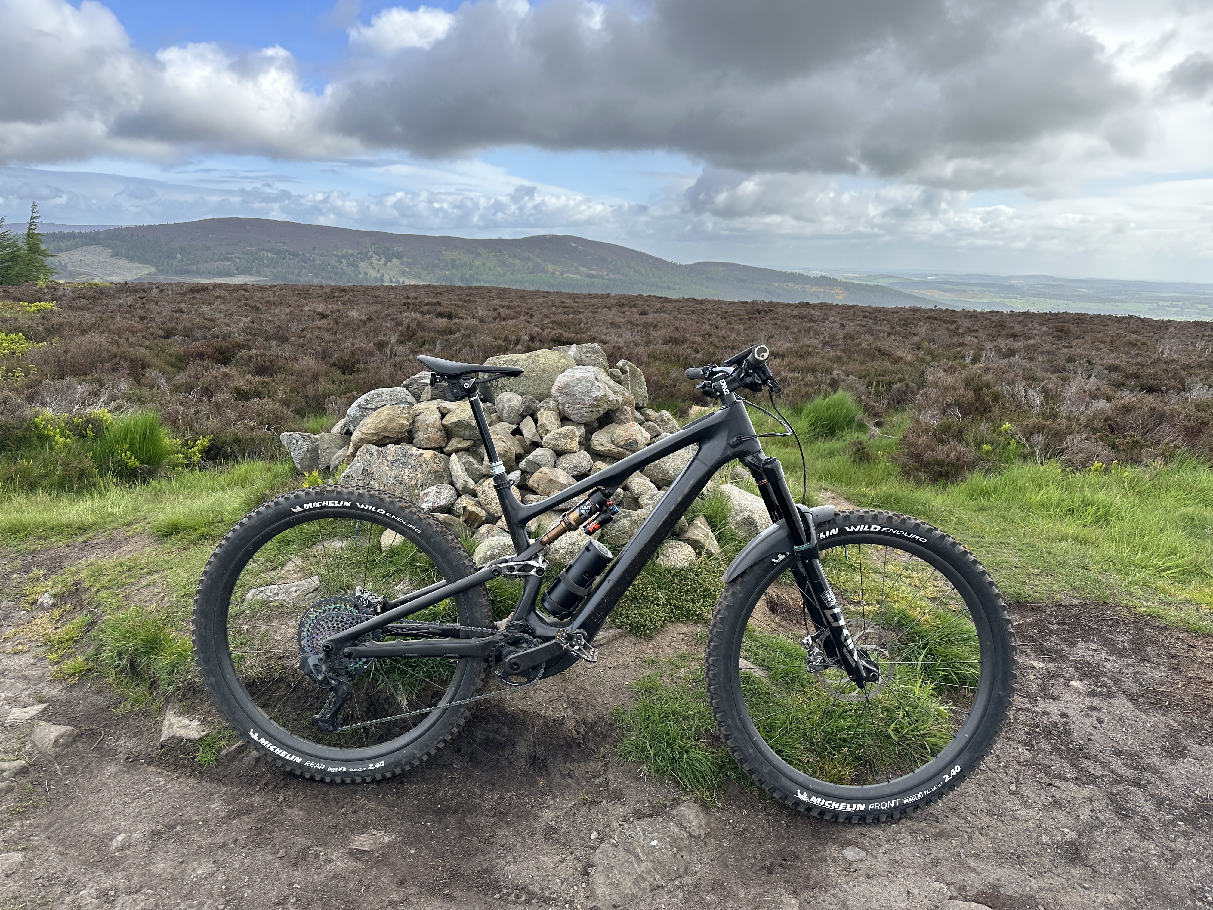

I finally managed to take my new Levo SL 1.2 out for a ‘proper’ ride yesterday, so here’s what I thought…
Please bear in mind I’m almost 6ft 2” tall, and am going from an XL framed SL 1.1 to an S4 1.2. I currently have it as a 29” front and rear wheel… and have the head angle at the standard cup.
This is also the first time I’ve done any serious trail riding for a while, so my fitness from riding cycle paths and forest roads isn’t quite up to what it should be in the trails!
I have set Eco @ 20/80, Trail @ 60/80 and Turbo @ 100/100. My previous bike was Eco @ 10/50, Trail @ 30/80 and Turbo @ 100/100.
I never rode Eco at all, unless I was with someone on an analogue bike… and it was mainly there for if my battery was at ~25% and I still had a long way to go! 98% of my riding was in Trail, with Turbo being for emergencies if I had a really tough technical climb that I was struggling with.
I left the car park with the range extender plugged in, and set to drain the RE first. The bike showed 150% for battery, but my Garmin was just 100%. My Trail @ 20/80 felt a lot more punchy than my previous Eco @ 30/100.
The noise of the motor when peddling along flats is significantly quieter than the 1.1… however when getting to the hills, the whine increases. Perhaps not as loud as the 1.1, but I certainly wouldn’t say ‘whisper quiet’ like Spesh advertise.
Within a couple of miles of flat and climbing I was beginning to think I’ve made a wrong decision… both with the size I picked, and actually purchasing the new bike. My XL bike felt better for cruising round the trails… but perhaps this is just something I need to get used to.
When getting further into the ride I got to more technical climbs, and the S4 started to feel more manoeuvrable and useful. The noise of the motor whilst under a heavy load still seemed pretty loud though… and I’m comparing it to a SL 1.1 motor that was replaced at the end of last year and has only done 400 miles. My previous SL 1.1 motor had done a couple of thousand, and was MUCH louder than my current one.
I felt like the battery was going down pretty quick for a start, but seemed to settle down once I got nearer about 130%.
Eventually I reached the top of the technical climb to the top, had a break for a few mins, and started the technical descent. It was at this point I realised this bike was the right size… and my XL was too big. Much easier to ride, tackle obstacles and attack sharp bends.
Once at the bottom of that, I was then able to climb a relatively short ascent to the downhill track, and have a go at that. I took it quite easy the first time… and then went up for a second shot. The fire road from the bottom to the top of the downhill track is about half a mile long, and varies from about 15-19% gradient (according to Garmin), so I tried that in Trail and then Turbo. There was an obvious difference between them on that climb… but it wasn’t so obvious or even noticable at all on some smaller climbs.
Another trip down the downhill track with a bit more speed, and again - notable how much better the bike handled than my SL 1.1. Is this purely down to me changing size… or is it that the bike actually handles much better? Difficult to say.
When climbing the next bit - a very long fire road with anything between 5-10% gradient, I felt like I was pedalling with no assistance. I looked at the battery, and it was 106%. I then tried Trail, and Turbo… but neither really offered much. I stopped and unplugged my RE and switched the bike back on - and suddenly it burst into life again. It seems the RE being low put the bike into some sort of safe mode.
After that, I had a climb that I don’t normally manage on my SL at all as it’s really steep with massive rocks everywhere. Pedal strike galore. When I had a Trek Rail, I could romp my way up it… but the SL didn’t have the guts.
Today, I tried in Turbo… and got about 95% of the way up. Much further than my SL 1.1, and being very careful not to catch my pedals / cranks. I definitely noticed the extra power there.
After that, it was a straightforward run back to the car. Same again - on small hills and flats, the SL 1.2 motor is not noticeable above the sounds of the tyres on the trail. It’s just when you’re pushing it, it starts the high pitch whine.
A few things to sort out before the weekend…
Raise my seat post maybe 1cm.
Try moving the saddle back on the post a bit to make the cockpit feel a little bigger when cruising.
Minor adjustment to rear derailleur as gear 5/6/7 were a bit reluctant to change up.
Bleed rear brake again as it was a bit spongy compared to the front.
Make Trail my 20/80 setting to I just have 1 press to change to Turbo 100/100 since the Turbo button on the remote isn’t there anymore.
Take a little air out of rear shock.
Longer term goals…
XX Transmission on order - due in about 3 weeks.
Confirm whether I want to run 29/29 or 29/27.5 (although I think I’ll probably stick with 29/29) and then order a new wheelset.
Send my Rockshox SuperDeluxe Ultimate back to J-Tech and have it retuned for this bike and have the hardware changed for mounting.
Try the -1deg headset cup and see what I prefer.
Change all my oil slick parts back to regular.
Bike is sitting at 17.43kg just now with invisiframe, garmin mounts, mudguard and pedals, but will increase a little when I put the Transmission on it. Hopefully the new wheels will counter that, plus a little bit more.
Well done if you've got this far... and apologies for the excessively long post!!

You need to lower the chain guide 😉👍
Longer term goals…

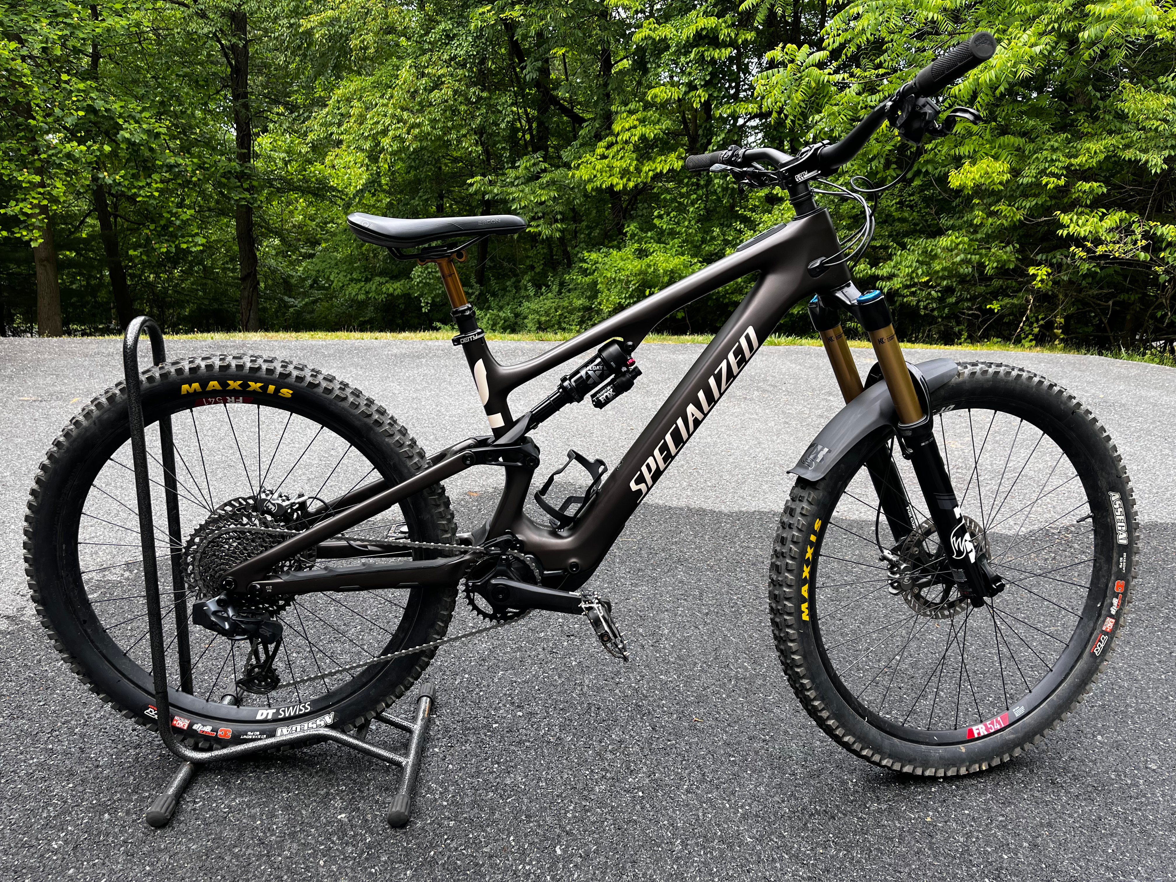

What a refreshing build :- ) ! Thumbs up fellow KidsRideShotgun owner.
FR 541 Alloys (best rims on market), dual Assegais, good brakes, tall stack. Person who likes to ride, not just shave off grams. Past 20 pages were effectively "How much lighter and/or more expensive can I get my generic S-Works?"
Thanks, George. I appreciate your attention to detail and your affirmation of my choices really satisfies my self diagnosed bike OCD :-D … 44.0 lbs as it sits with heavy magnetic pedals.. I could shave 0.75 lb by going clipless or flat pedals but I like the remtech a lot so F it I’m keeping them on.. heavy hubs, heavy fox 38…
