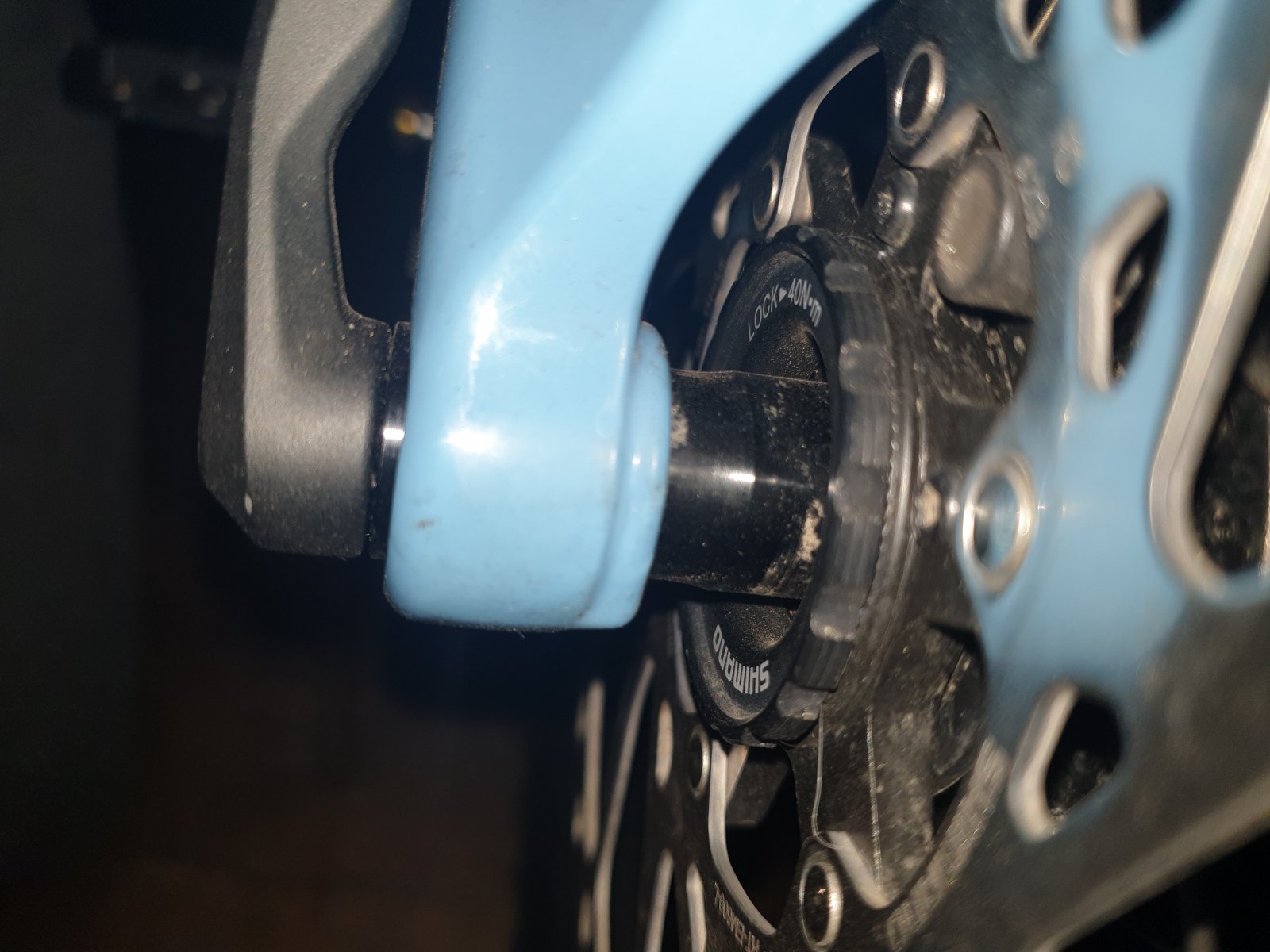

I have a turbo levo comp 2020 model and I bought the speed limit increaser and works very well ! Now i want to change my rear brake from Hope 20mm rotor will this fit or will I need an extra part to fit it for the clearance ?
JR33
Apr 20, 2020
Sana Cruz CA
Yeah, the thicker rotor will reduce the amount of clearance (but only 0.2mm so it should be ok), but the rotor arms will also be different so the LSS clip likely won't work on a 220mm rotor so you'd need to use the universal rotor mount. But this is all on top of it also being a 2020 Kenevo which I'm not sure if it has other differences / surprises vs a 2020 Levo. So it would be perhaps better to get it working on a stock Kenevo first if possible.

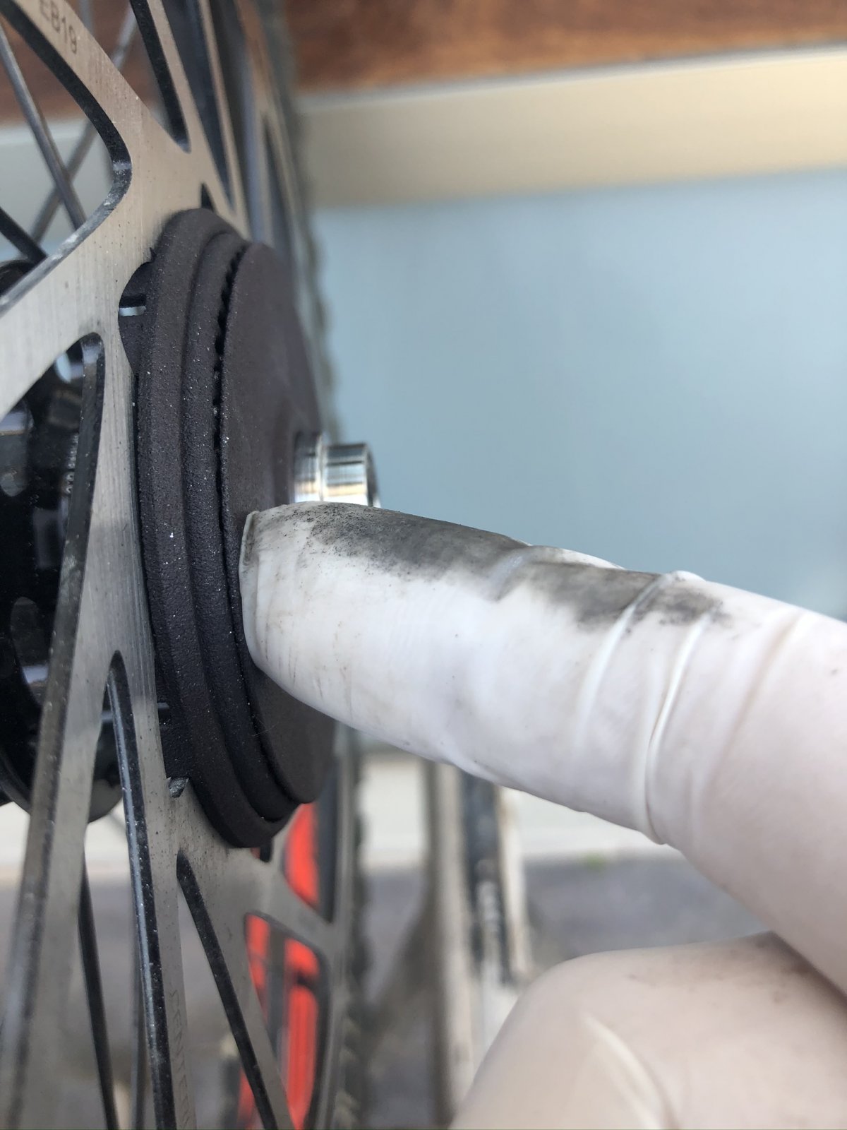

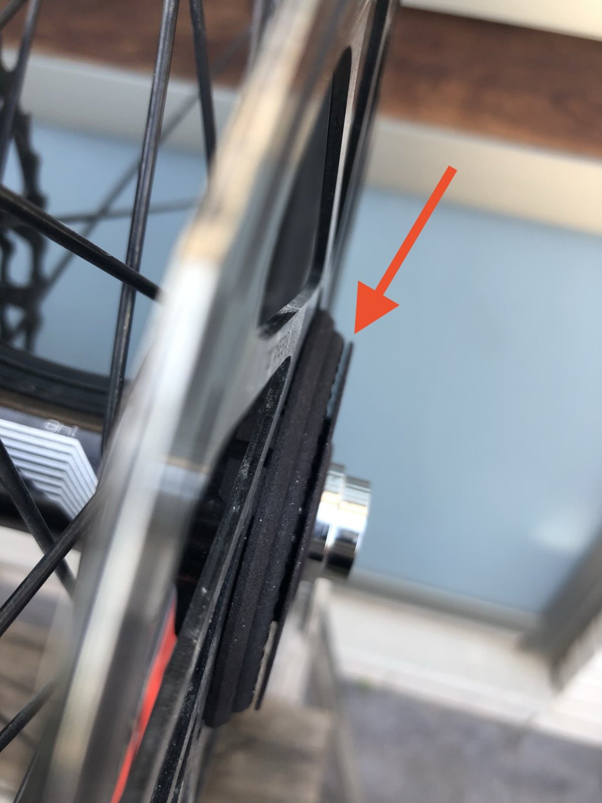

Hello
Buy Beta - LSS Gear Set for Levo 2017/2018 and confirm that it works properly. I'm delighted. The only thing I can find a little opening on the closing cap I think you should find a solution so that no water and dirt can be found and that the inside of the planetarium is more stagnated.
jd_3d
Jul 12, 2018
279
342
California
Thanks for the feedback @Angel Perkins. I'm glad its working for you. I wouldn't worry too much about dirt/water getting in as many people have been riding it for a year without issues. Its stays pretty clean in the spot it is in. But I always try and improve the design, in fact the LSS 2.0 for the 2019/2020 models have a much smaller gap.

would it serve the 2019/2020 cover for mine?
(LSS Gear Set for Levo 2017/2018) being more airtight. could I buy it?
thank you very much and good work
jd_3d
Jul 12, 2018
279
342
California
The LSS version for the 2017/2018 is a different size than the 2019/2020 version due to the magnet being in a different location, so unfortunately the covers are not interchangeable.

ok, I've done about 100 km and the perfect operation. There's no sign of wormwear from the planetarium that I lubricate with dry graphics and no dirt inside despite the small opening of the lid.

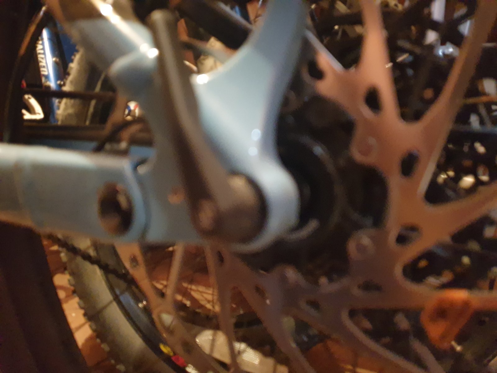

hi ive got a scott genius ( i know completely different bike) my speed sensor in in a simler place do you think this would go on roughly?
