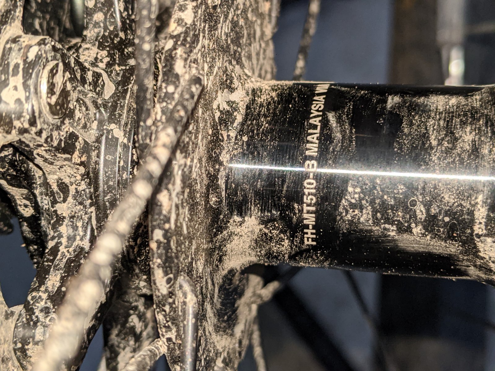

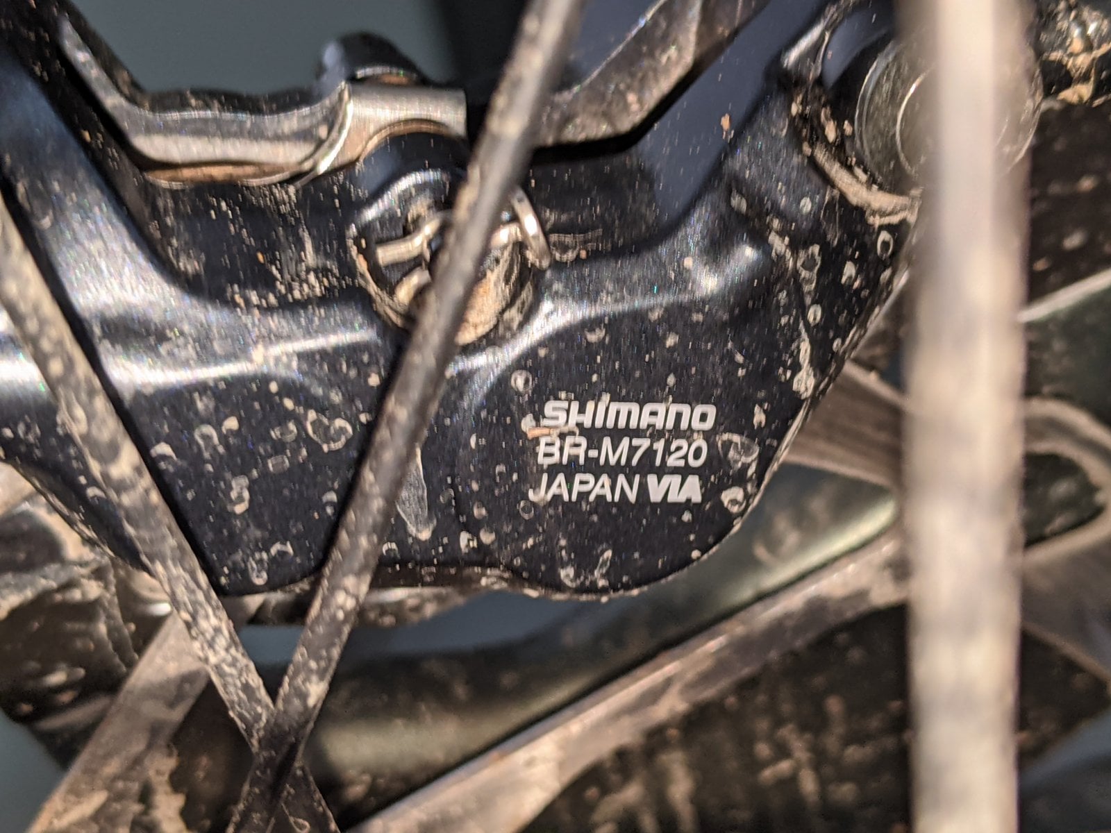

Hi @Dr_BoB_rD, I'm still trying to make sense of all the new 2021 Levo models. It seems some of them now come with Shimano centerlock hubs/brakes (i.e., the Levo comp is listed as having centerlock hubs) which wouldn't be compatible with the LSS. However, on some of the other models they still like SRAM components like the 2020 models.
Which version of the 2021 Levo do you have and can you confirm the hubs and rear rotor you have? That could help me to determine if one of the LSS versions would fit.
Hi jd_3d,
I have a 2021 Turbo Levo Comp. Any chance that any of the LSS versions might fit?
The hub is a Shimano FH-MT510-B and the rear disc brake is a Shimano BR-M7120.
See pictures attached.
Thanks for your help. I really like the design and idea behind the LSS. Hope I can make it work.

Hi @teutonic,
Does your rear rotor use centerlock? If so that is the main difficulty in getting the LSS to fit. The space that's normally reserved for the LSS is taken up by the centerlock nut. If you were able to switch to 6-bolt rotors I bet we could get the LSS to fit. You can PM me if you are interested in trying this approach.
-JD

Yep, it's the stock center lock rotor. I don't really want to change the brake rotor at this point. I'll just go with the planet3 kit for now.
