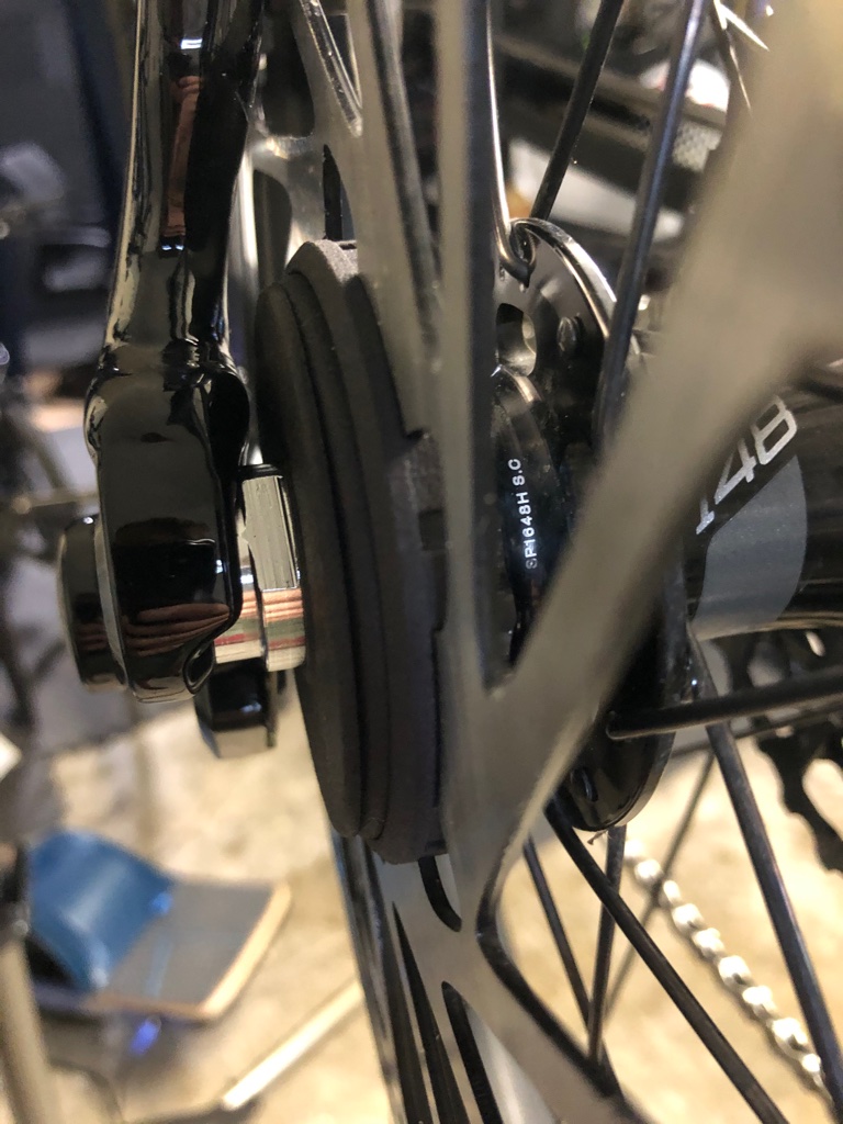

Hey @jd_3d , I decided that i will switch change the brakes since the Sram Guides are being such a headache (the rotors have warped, the pistons get stucked, low performace, noise, etc). So, have you designed a piece to attach the LSS to a magura MDR-P 203mm rotor? (See link below).
Is there a way you can think i can attach the LSS?
Thanks!

Hey @jd_3d , I appreciate your response. Any thoughts about it would be helpful.
Hi @Martin DH, sorry for not responding earlier as I missed the notification of a new message. The best way I found to support all the rotor options out there is with my universal rotor adapter:
You just need some small zip-ties and the part above and it should allow you to attach any rotor to the LSS.

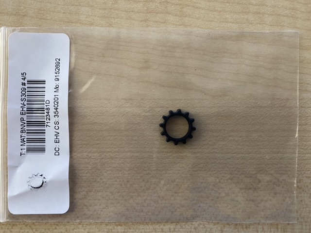

Ahoj, mám otázku ohledně instalace sady LSS DT verze 2.0 - Planetární soukolí.
Na youtube jsem našel video, ale v části zvané „slunce“ je malý rozdíl (T: 1 MAT: BNVP EHV-S309 # 4/5). Ve videu je slunce plné (se spodkem) a magnet je přilepen k této ploše, ale mám jen obrys slunce. Mám tedy přilepit magnet do stran nebo ho vůbec nepřilepit?
Prosím dej mi vědět. Děkuji předem, Paule.
Hi @Ap Pawell. Yes, I recommend using glue on the sides of the magnet and the inner walls of the gear to keep them firmly attached.
I bought your universal rotor adapter for my Magura 220s, and it's not acceptable. Incredibly fussy to attach, and the zip ties have be threaded in from the middle of the wheel or the zip tie heads rub on the frame. I'm using very small zip ties - the heads are 3.8 mm thick. I can't imagine having to do this every time I need to remove the rotor.
Please don't treat this adapter as your final solution for Magura brakes!
Really good feedback @RebornRider. You are only the second person I've heard from that's used it (the first was the person I worked with to develop it in the first place), so its very helpful to hear that it is a pain. There is just so little clearance between the rotor and frame its hard to come up with a good solution besides trying to design a new clip for every single rotor out there (there are so many). I've been busy with my regular job lately and haven't had much time to work on the LSS.
I'll do some thinking and see if I can come up with a solution for a universal mount that doesn't rely on zip-ties. Now that I'm thinking about it I wonder if I could do a 3-part piece with 2 c-shaped backing plates that sit behind the rotor and clip to the front piece. If I design something new I will PM you and ship you a copy if you are interested in trying it.
Absolutely interested! The bike is less fun without the LSS.
