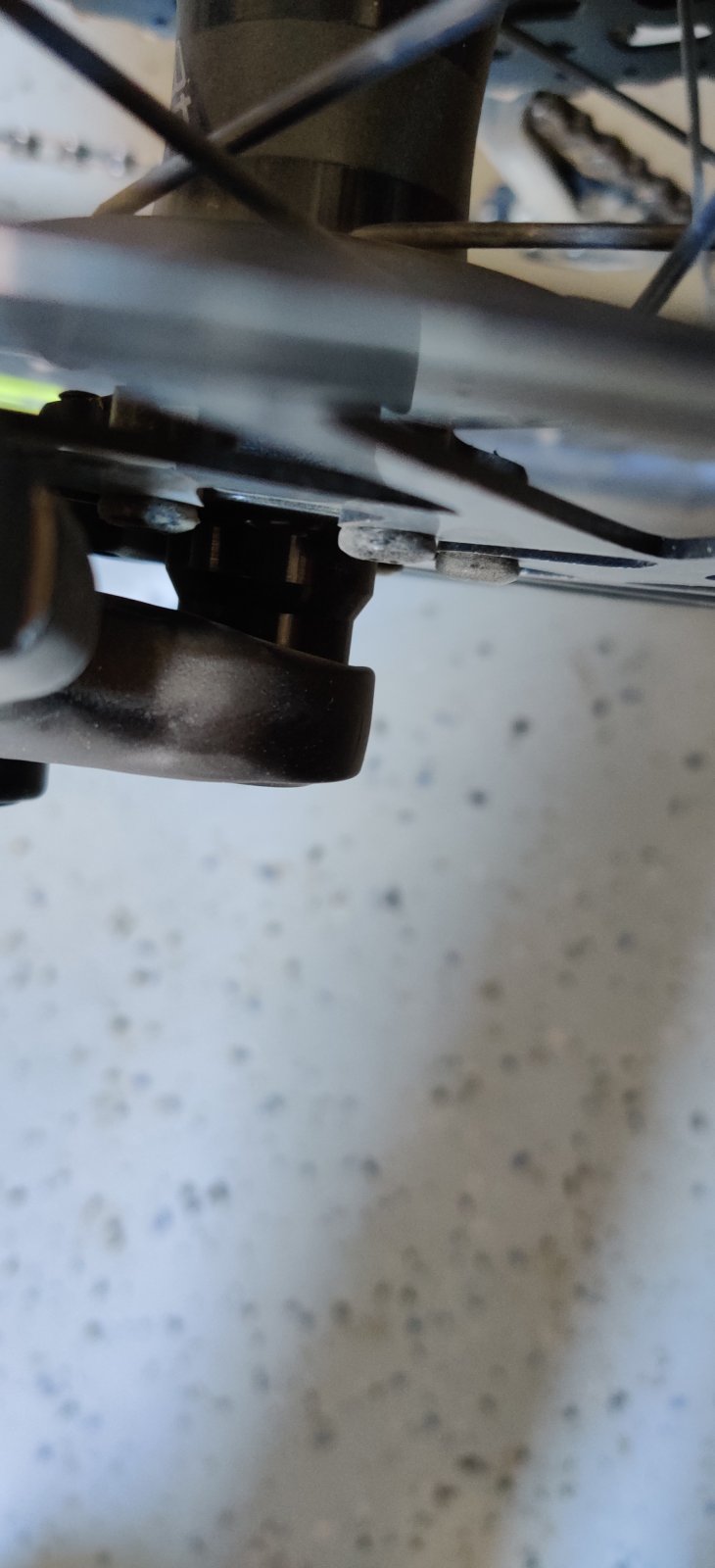

Yes I would like to try this out, although I am considering running a 220mm rotor out back as well. If I were to stick with a sram rotor would this be an issue? Although now that I think of it I think the 220's are 2.0mm thick compared to say a 200 witch is 1.8mm? Here is a picture of what my hub looks like, it does taper like you were talking about. View attachment 25612
Hi @Clint026. It seems the attachment didn't come through. Could you re-attach? A 220mm rotor could be a problem as I don't know anyone who's done that and I'm not sure the implications. Is 220mm on the rear necessary? You must be doing some insane downhill for that :D
Lol I'm a bigger guy... But I would like to think I'm doing some insane down hills! Let me see if I can figure out how to just load the pic on this reply. Just for curiosity, why do you think a larger rotor could affect it? Would it just be the fact that it is slightly thicker?
Yeah, the thicker rotor will reduce the amount of clearance (but only 0.2mm so it should be ok), but the rotor arms will also be different so the LSS clip likely won't work on a 220mm rotor so you'd need to use the universal rotor mount. But this is all on top of it also being a 2020 Kenevo which I'm not sure if it has other differences / surprises vs a 2020 Levo. So it would be perhaps better to get it working on a stock Kenevo first if possible.

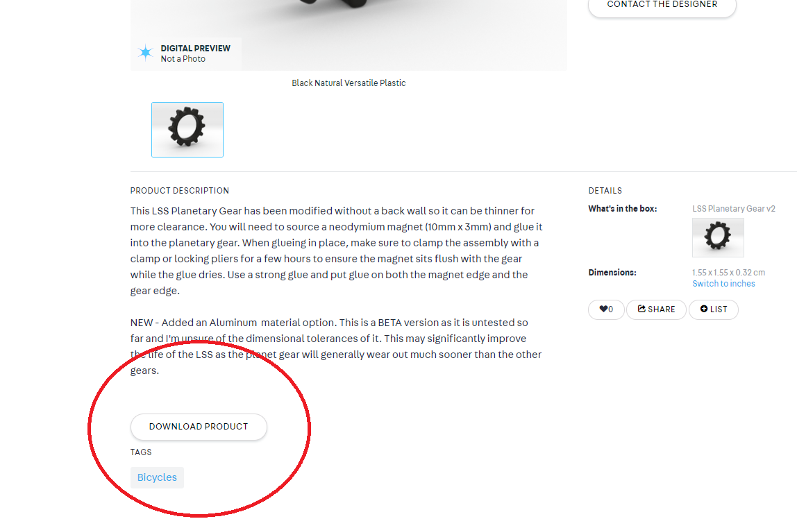

EDIT: You need to be logged into Shapeways to see the download option (creating an account is free). I think they do this for security so bots don't just download all their files. Once you are logged in, it is right below the description, see the circled area in this image. Tagging @AleksEU
What a great idea! You can then print in 3d your replacement piece, thank you very much! Jd_3d
