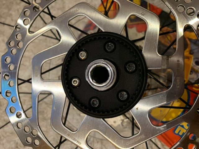

Update - snapped a picture the other day of my LSS with Al cog with about 500 miles on it - it looks pretty darn good showing very little wear so far - I have gotten into the habit of blowing it out with compressed air between most rides just like I do with my brake pads - of course no way to know if this makes any difference but I do see visable debris fly out when I spray the air - haven't been riding my ebike as much lately because we've been getting a fair amount of rain and I tend not to ride my ebike too much in wet conditions
jd_3d
Jul 12, 2018
279
342
California
Thanks for the update @Eljay! I agree, for 500 miles I can hardly see any wear which is great news.

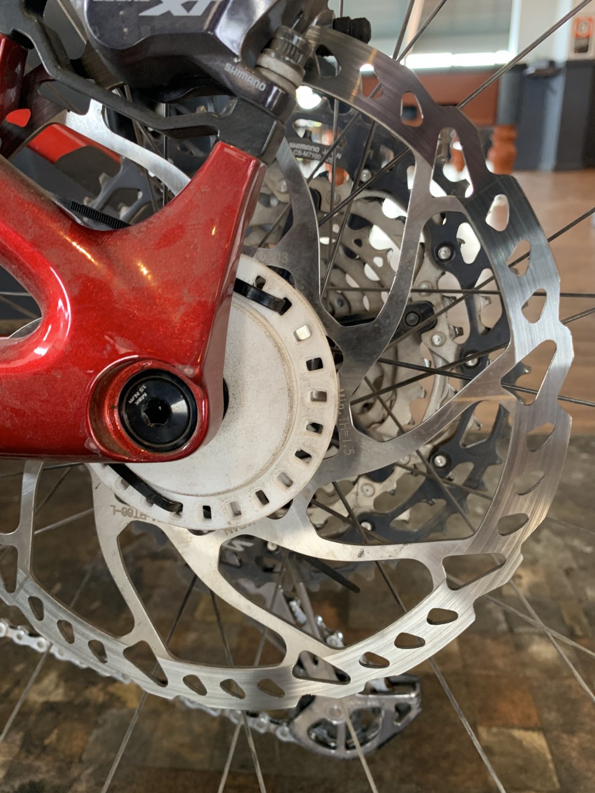

rod_922
Jan 28, 2020
B0ll0cks1
Hi
Is this not made to fit the Turbo levo Hardtail 2019.
Just tried fitting, I have a different rear disc, shimano not sram, so doesn’t clip in?
VeloMikey
Apr 21, 2019
18
9
So Cal
thanks for the reply. These are stock on the turbo Levo hairdtail.
so I’d need to change discs, and then buy that clip above?
Yes, I replaced my Sram components with Shimano XT. JD prototyped the Ice Tech mount for me. I have 1250 trouble free miles on my LSS.
jd_3d
Jul 12, 2018
279
342
California
Hi @rod_922, as VeloMikey said the LSS is designed for the Levo Full Suspension with the 203mm SRAM rotors. You could get the Ice Tech rotors and the special clip, but another option is to get the universal rotor mount clip here:
Universal Brake Rotor Mount for LSS - Slim design by JD_3D on Shapeways
I recently re-designed it based on feedback from someone to give it more clearance for the zip-ties to fit (you'll need 6-8 small zip ties to attach the clip to the rotor). So far its working well for them.
