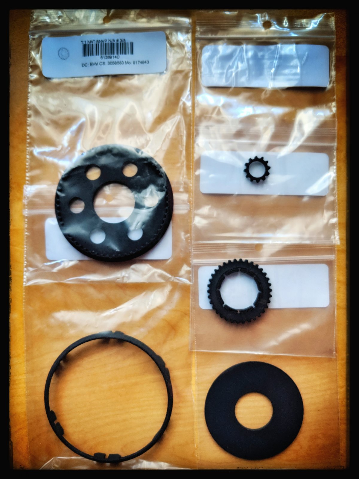

Hi, JD.
I received my order today and found that one Ring Gear and sun gear are thicker than what I ordered.
Following is what ordered
///qte///
Hi jinyoung,
Items we made in the future are now on their way to you!
This shipment includes the following items:
Order #2946230
Shipping Address:
jinyoung park
300 Cornell DR. A8, Hanjin
Wilmington, DE 19801
United States
///unqte///
and after close check up with vernier caliper, it looks like they sent me 2 ring gears for alloy comp model.
other parts all ok.
Please see attached picture.
you can see two thin ring gear and two thicker ring gears.
Please let me know what to do with this situation.
Best Regards
Kemp Jinyoung Park

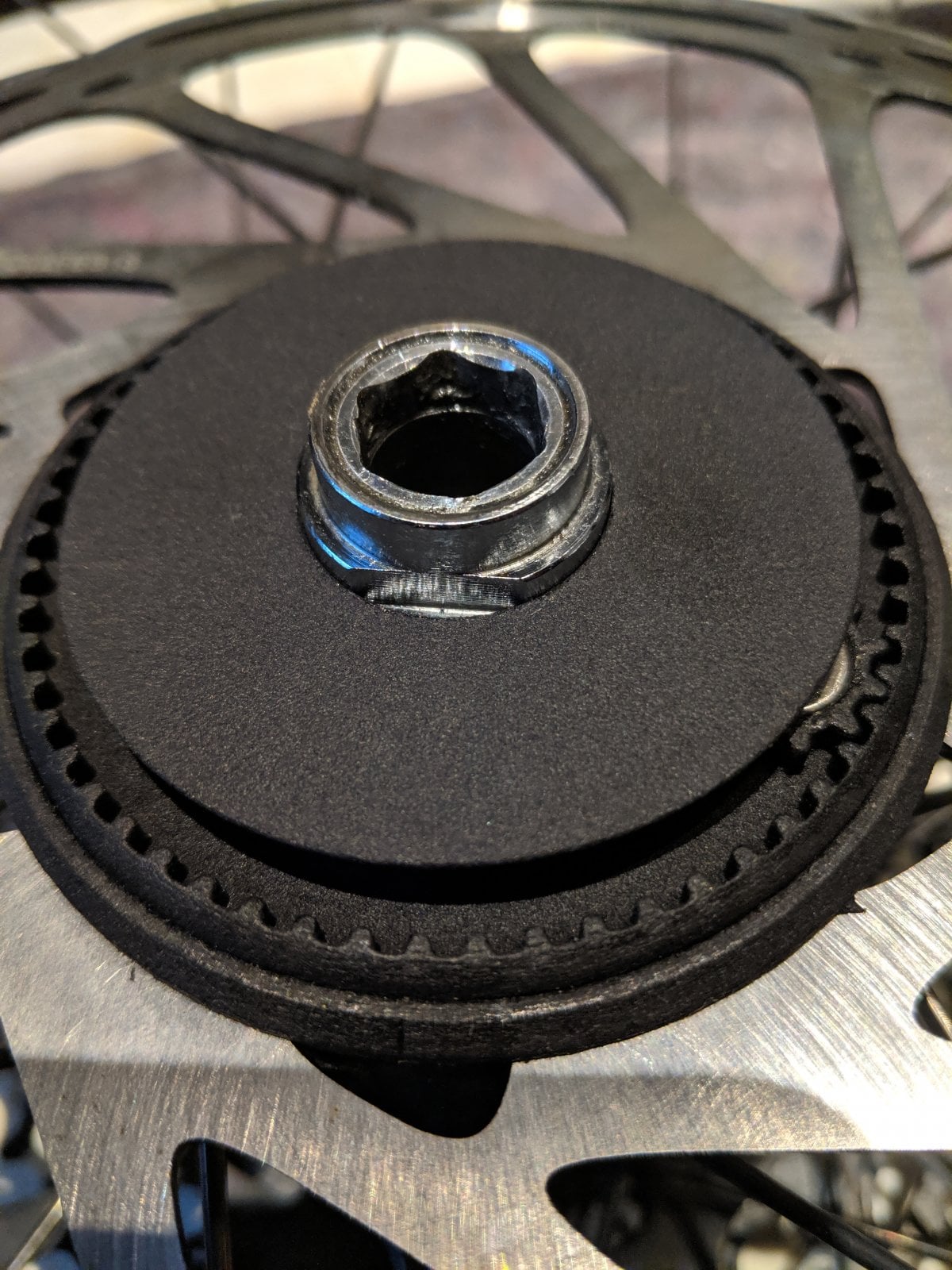

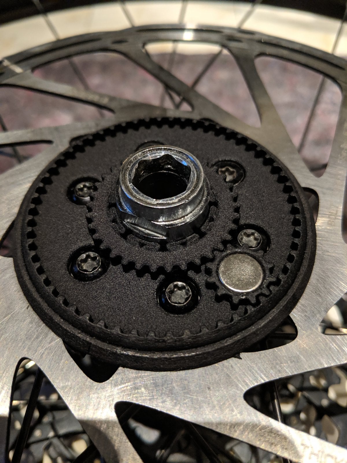

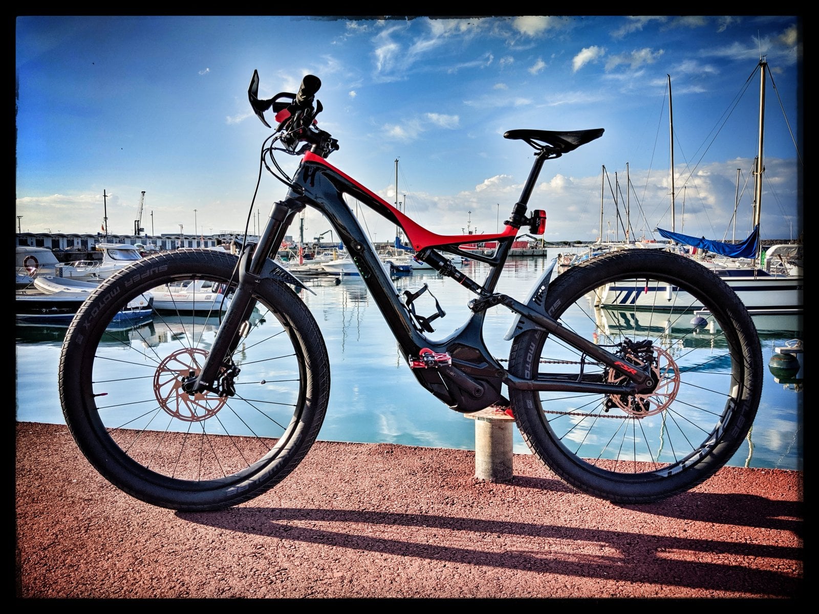

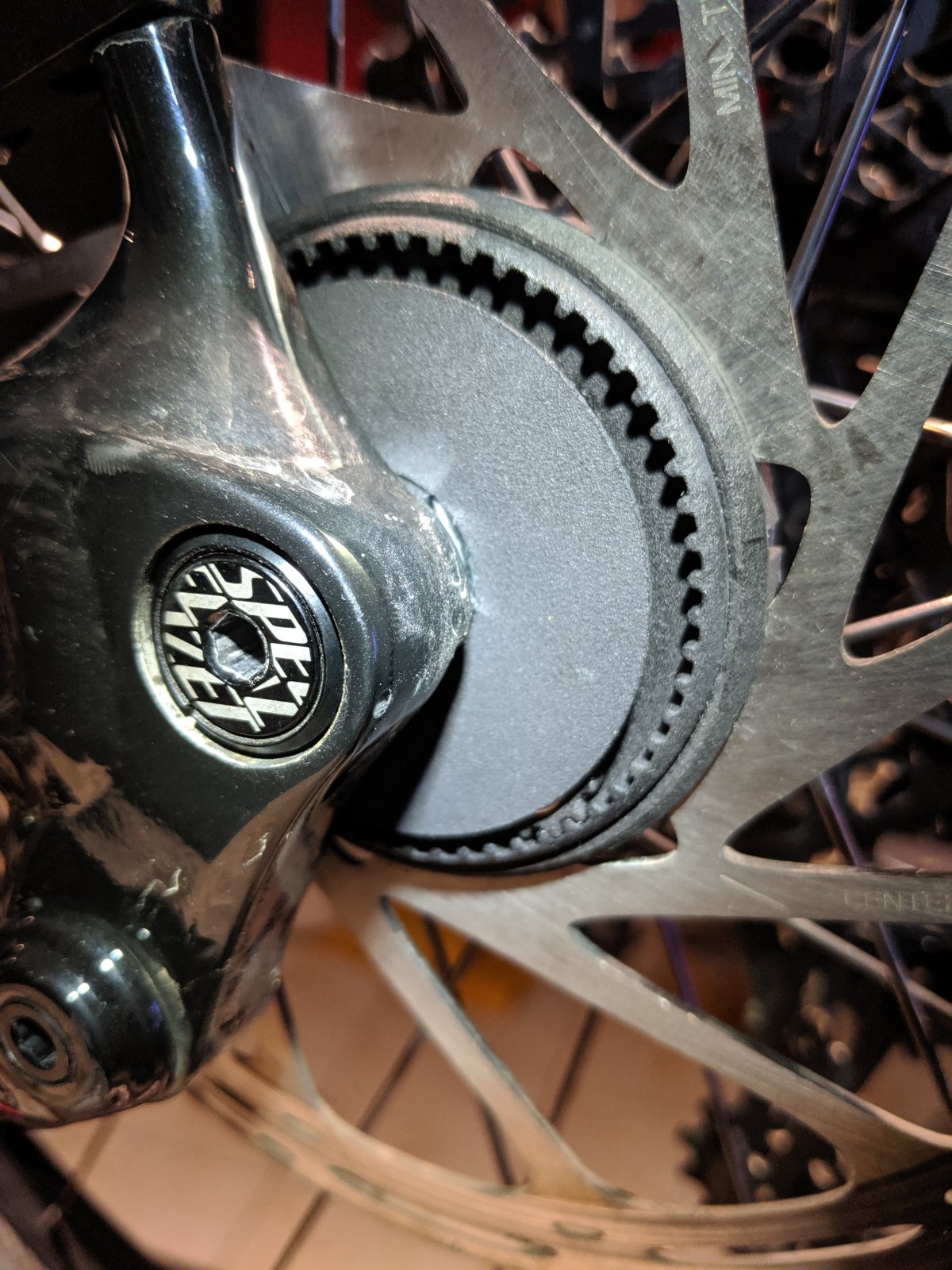

Hello, I bought the LSS model for the TL 2018, and when I installed it I found that the lid does not close well and the magnet is exposed, is this normal? What will happen to the mud? I put some pictures for you to see.
I wait your answer.
Thank you.
I wait your answer.
Thank you.
Hi @Sameroquay! Thank you for not giving up on the LSS for your 2018 TL. I think you are the first person to purchase the new beta design I made specifically for the 2017/2018. Have you taken it on a ride and does it work ok? My biggest worry is whether it would trigger the sensor since it looked like the older model used a bigger magnet. But I did try to get the position of the magnet as perfect as possible. The clearance with the frame is also ok?
Regarding the lid / cover, it looks like Shapeways sent you the wrong cover! I'm guessing they mixed it up with someone else's order, so now someone is going to receive the cover that was intended for you :( This will be the second time they mixed up people's orders. Can you contact them using the link below and ask them to send you the correct cover?
Shapeways: Contact Us
Please let me know if you have any trouble with their support.

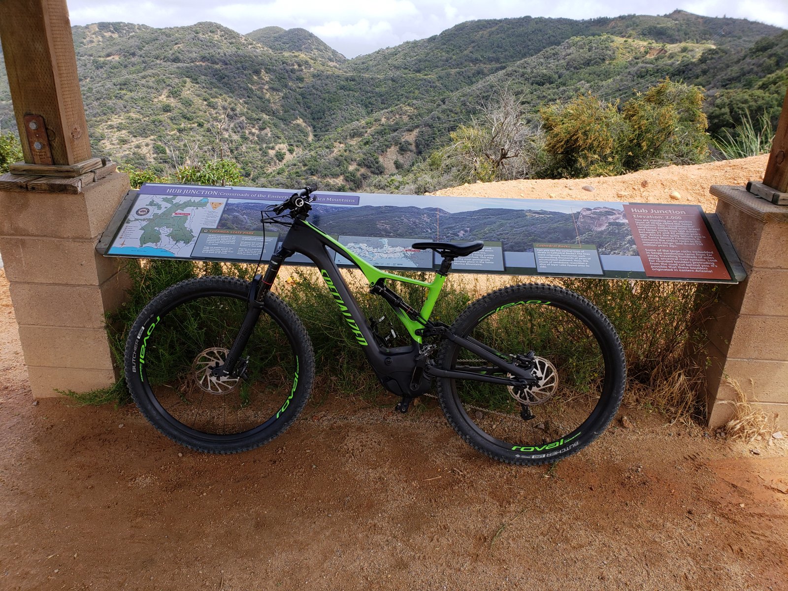

Hi JD. As a follow up, I installed the LSS-DT on my 2019 Turbo Levo Expert and all as described in this thread without a hitch. A couple of notes for you and others:
1. Initially had to take the bike to the LBS to get the firmware re-flashed to get above the normal 17MPH.
The service guy said that the settings were correct but that most of the bikes had to go thru at least 1 re-flash to get the bike to do closer to 20MPH (but not quite to 20MPH).
2. After installing the LSS-DT I was able to get to 28-30MPH.
All speed measurements were using the GPS settings in BLEvo
But clearly the motor kept normal output well beyond what it did prior to LSS-DT installation.
3. Which brings me to the only issue I have had which is that BLEvo now losses connection with the bike after I go over say 20MPH and then slow down.
I have to restart the bike and then it reconnects. This did not happen prior to the LSS-DT.
I am not sure what to attribute this to or if anyone else has experienced this issue, any ideas JD or @PaoloBLEvo ?
I will continue to test as I have two sets of wheels (one with the LSS-DT (DT Swiss 240 hubs - no problem) and one with the original sensor on the original wheels). My issue with BLEvo notwithstanding, this is an amazing product and recommend to anyone wanting to increase the speed at which the motor shuts off on a Levo in a very straightforward way. Hats off to JD as simple is not easy - great job!

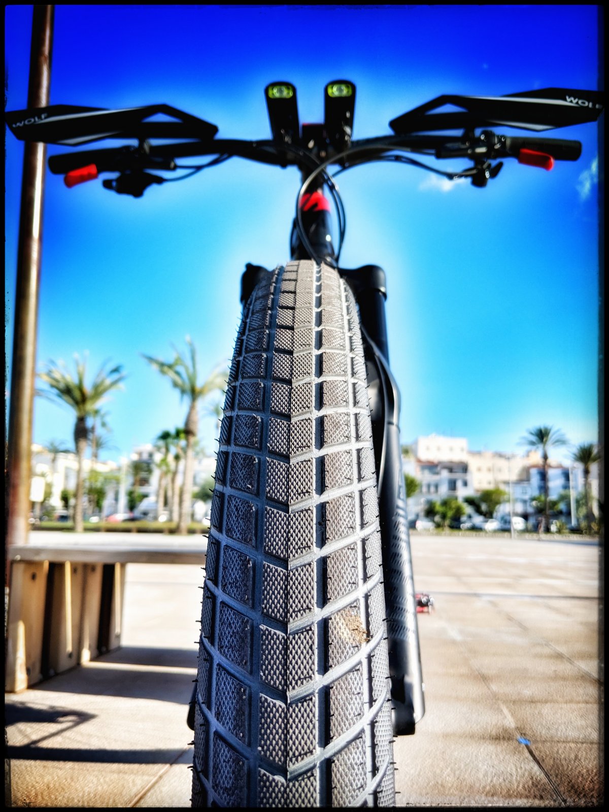

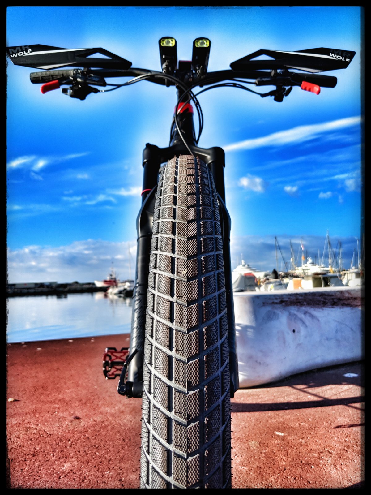

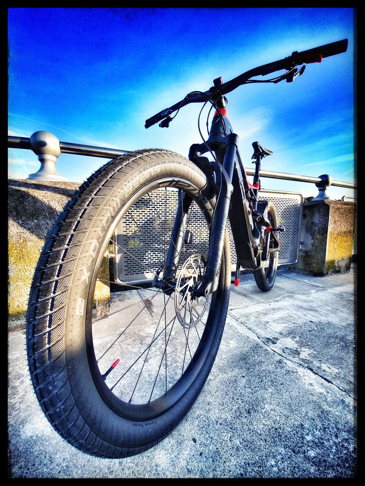

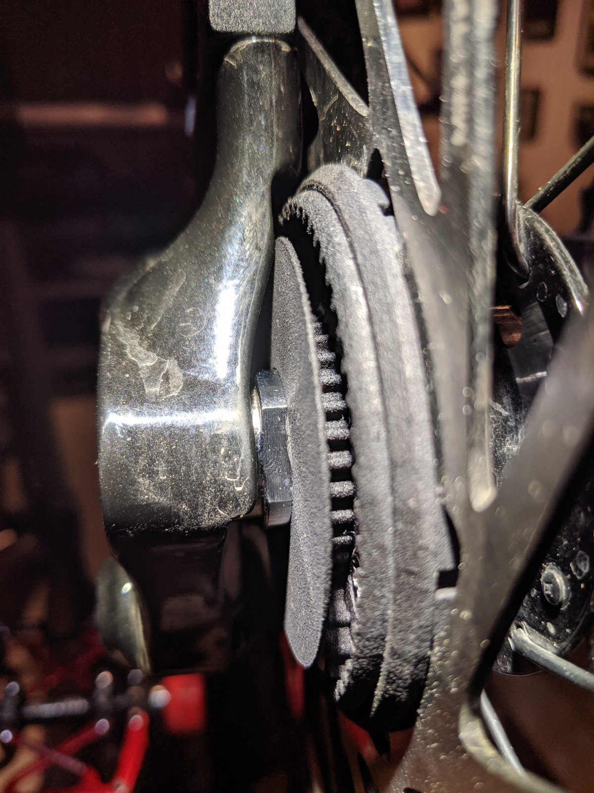

Hello, thanks for the answer. I've tried it and it works very well, the TL doubles its speed. If sometimes when I turn on the battery it seems that it does not synchronize well and does not assist, then I have to make a Reset and it works again.
Regarding the frame, I see it very fair, it seems that something is touching, but it is not like the LSS of 2019, it can be said that it is fine, although I would like to try it with the cover that corresponds to me, not that small.
I will ask for a change to Shapeways, now I am not too worried about dirt or mud, since I have mounted some road wheels on my TL, and at the moment the first sensations are good.
I send you some photos.
A greeting.

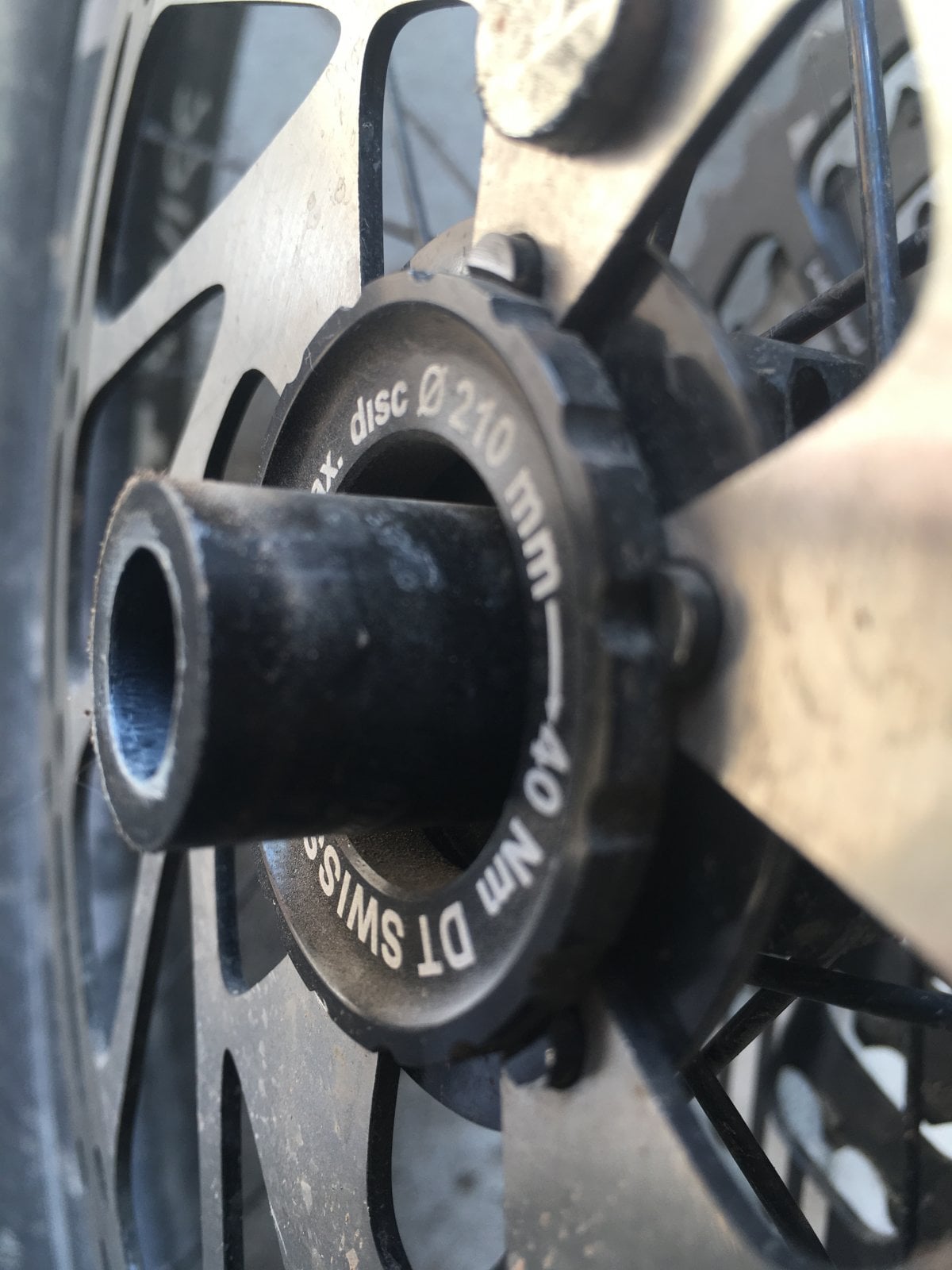

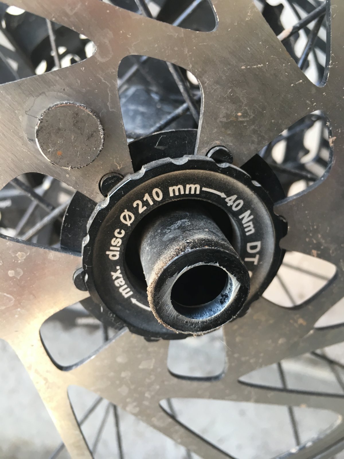

@jd_3d

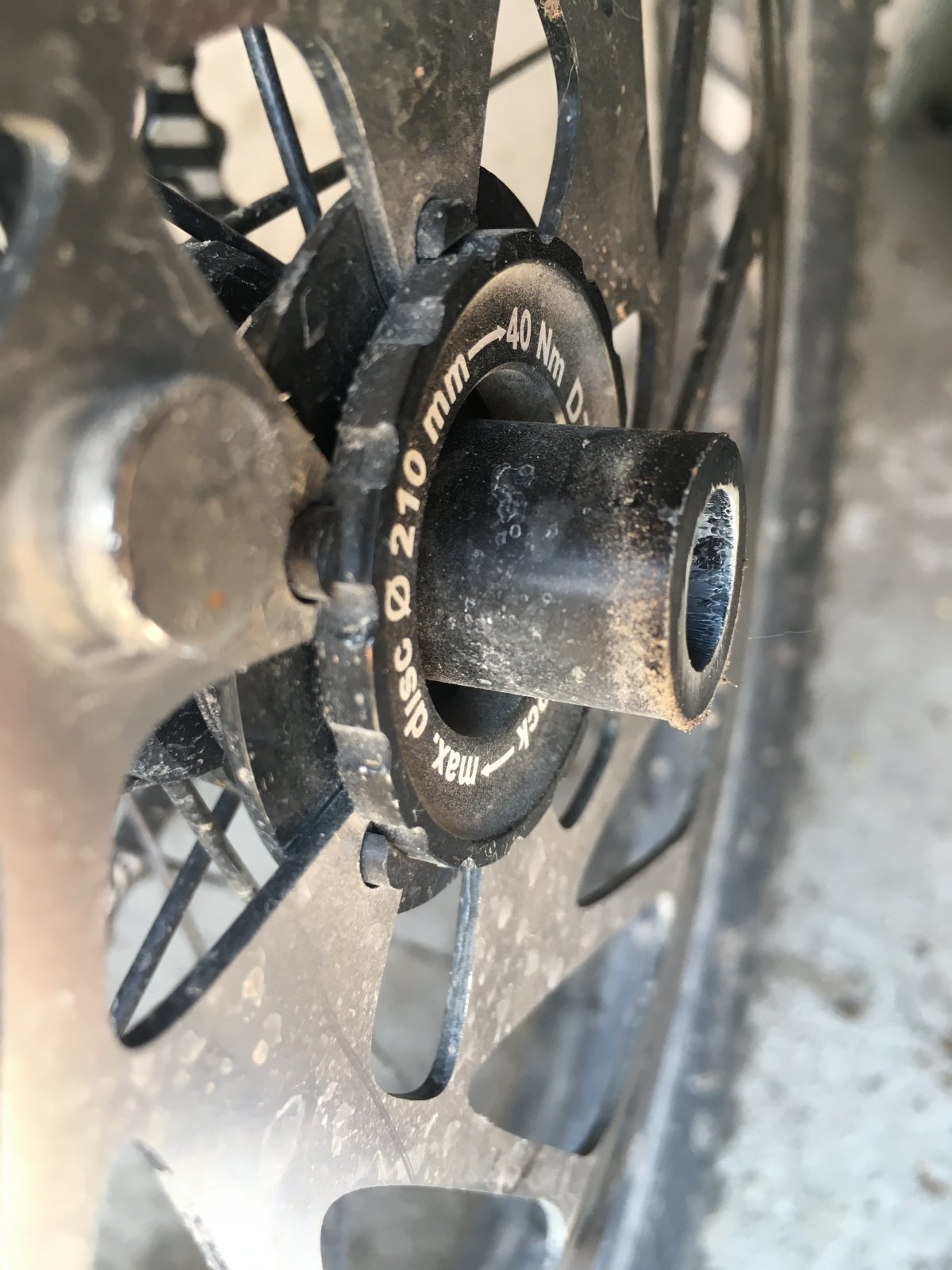

Do you think it might be possible to do a version for DT Swiss hubs with Centerlock adapter?
I'm using the EX1501 rear wheel (DT Swiss 240s hub / 19mm axle / stock rotor).
I'm attaching some pics of the rotor with centerlock adapter to give an idea what it looks like. If you need some measurements please let me know.
For me the LSS solution would be really cool for various reasons. As you might notice on the pics I just sticked the magnet onto the rotor as there's no other possibility to fix it with centerlock adapters. Although this worked just fine for more the last 600 kilometers it's of course not the perfect solution.
Just le me know what you think please :)
Cheers
Andy
Cheers
Andy
Hi @Hannes_3000, I've thought about this previously and the main issue is having enough space for the LSS to fit in there due to the center lock ring taking up additional space. I think it would be possible, but would probably require a complete re-design to make the LSS bigger so that it goes around the lock ring. If it goes in front of the lock ring I don't think there would be enough space for it to fit without hitting the frame. Do you have a pair of digital calipers you could take measurements with? Let me send you a PM and we can discuss in more detail.

Hello, the answer from Sapeways :
"Hi Samuel,
Thank you for your patience. After speaking with our production team, the model was printed as designed so a reprint will result in a similar situation.
Since we're only the manufacturer of models that designers upload, we don't run end-user tests on any models printed and can't guarantee it will work as designed.
My best recommendation would be to reach out to the designer directly.
I hope you understand and please let me know if you have any other questions."
... do not I understand? .. How can I get a lid that closes properly? .. What will happen when I enter mud?
I await your news.
Thank you.

Hi @Sameroquay. It really was Shapeway's fault as they printed the wrong part, but let me contact them and see if I can help get it resolved. If I can't get them to help then I will create a separate product of just the cover and send it out to your free of charge. Let me PM you for your order info so I can contact them with additional information.
